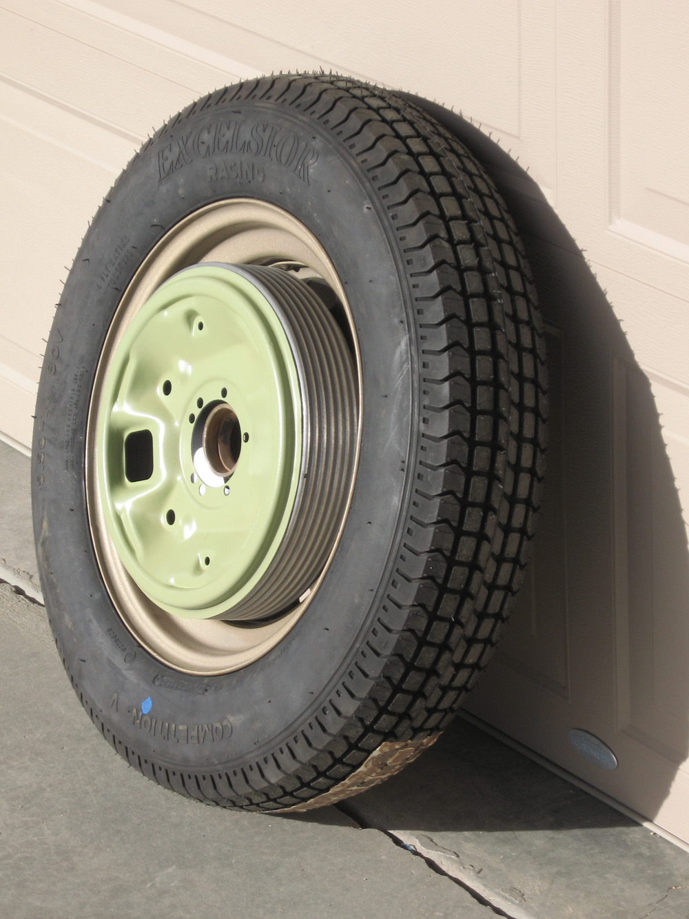

    Here are three photos of components from my track roadster. The project began 14 years ago, with the purchase of the 32 frame rails and the engine.
    The only important parts that have not been modified are the tires, Pete & Jakes ladder bars, engine block, crankshaft and cylinder heads; otherwise extensive modification to all components.
    Shown are one of the custom brake drums, the Dodge D500 Hemi with hand fabricated pipes and a view of a torsion bar arm and the steering arm. The headers and the steering arm are nickel plated, the torsion bar arm is nickel plated then "bronzed" using a pickling process....more to come.

    Killer lets see more of those drums

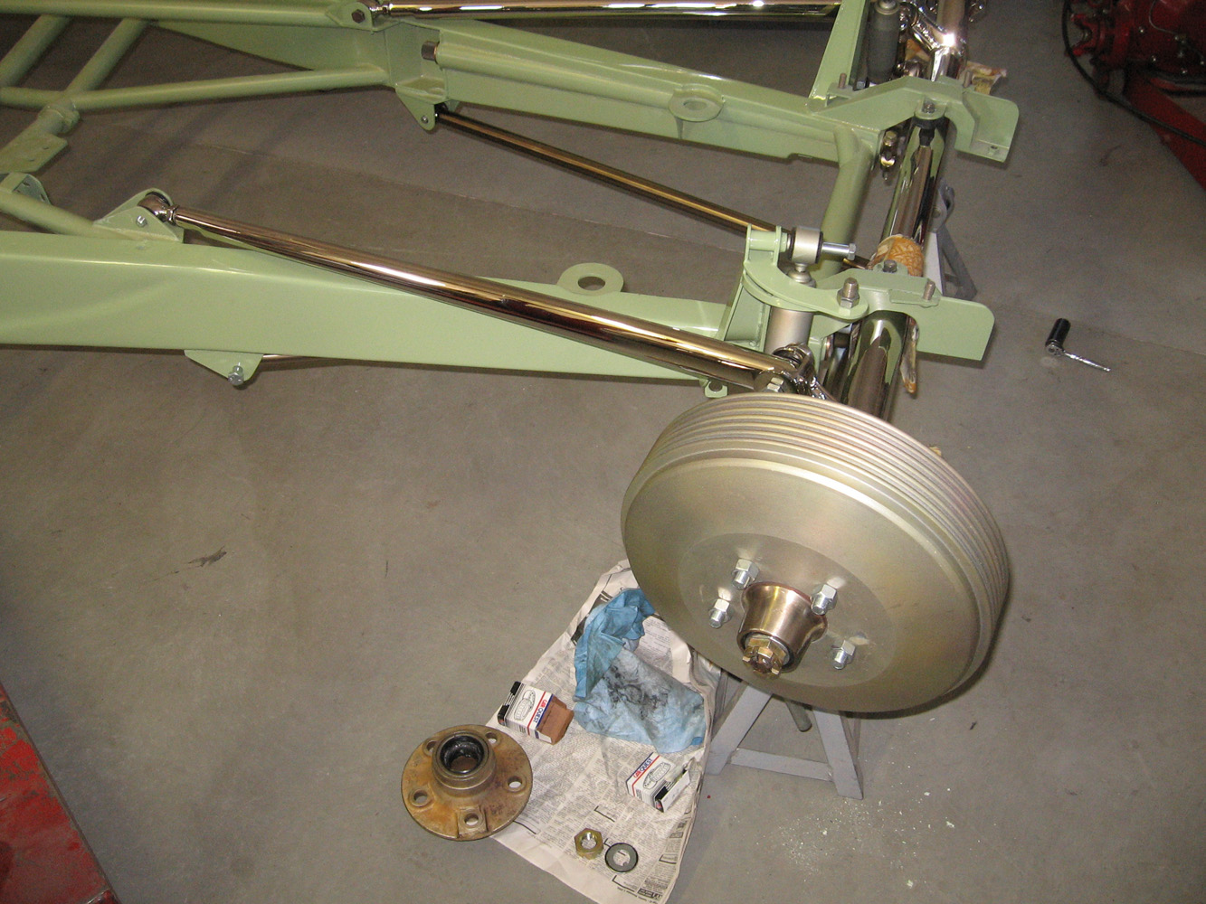

    Here is a photo of the front right corner showing the cast aluminum drum, parallel locating arms (in the horizontal plane), shock towers and tube axle. The opposite corner shows the torsion bar hidden within the frame rail. When viewed from the front the roadster will appear as if it has no suspension. The Miller Indy cars of the 20s were the inspiration for the front suspension layout.
    The other photo shows the Lockheed type center-plane brake assembly as used on most of the 50s Mopars and some British cars of that era.

  7. Shifty, I hope your prophecy will be correct. After all I've had 14 years to sweat the details. The fabrication was all accomplished by Jack Presse at the Street Rod Place, first in Denver and more recently in Stevensville, MT. At some point in the last few years Jack "adopted" the roadster, but he still lets me visit and make suggestions...just kidding... he's a great guy. Make no mistake...the craftsmanship is his and his alone.
    The drums were made by an eccentric englishman. He cast iron hoops, then cast the alum housing and machined the final shape. I had a hell of a time finding him and getting the drums made; it was a major PITA, but worth it.

    It's surprising that more builders don't use the sprint car torsion bar suspension components as you have. Infinitely adjustable for ride and height not to mention the simplicity of that design. Of course I happen to have for sale all the parts needed to complete a setup like yours. :D

    WOW!!! That is very impressive so far. Keep us posted on where you plan to unveil I'd love to come check out that front suspension setup! Never would have thought of torsion bars...

    I love what I've seen so far and can't wait to see more.That torsion bar front ends is the tits!

    Hi,is it possible to get the Drum makers address/phone etc ?
    We restore mercedes and a lot of older Mercs have gold plated brake Alfin drums which are getting impossible to buy nowadays. Some one who knows how to cast iron lined drums would be handy to know.

  28. Dirtynails,
    Regarding the aluminum brake drums, here is the web address for Typecast Engineering Limited in the UK
    << http://www.brakedrum.co.uk/ >>
    The fellow I dealt with told me he was "selling out"". This was about four years ago...which, in this case, is good news, if true. He was honest and talented but a procrastinator of the highest magnitude. From the modern looking web page it appears as if Typecast is on a more businesslike footing.
    I faxed an engineering drawing with all dimensions and he sent back (eventually) two perfect drums. I was especially please by the old world look of the alum casting, very nice. The fellow was also adamant about using exactly the correct brake shoe lining material, which I was able to find (eventually).
    What made me decide on Typecast is that the owner did not use a bonding agent to affix an iron hoop to an alum drum. He claimed that he used a fixture to locate the iron liner and then poured the molten alum around the assembly, thus no bonding agent was used.
    As you may know there are some US companies that heat the alum drum, press in a iron liner and use a proprietary adhesive to from the iron-to-alum bond. I have no reason to believe that this latter process is unsuitable, but the composite metal-to-metal process sounded superior to me.
    Also the early Datsan 240 GTs used an alum rear drum, which might be suitable for some hot rods and restorations.
