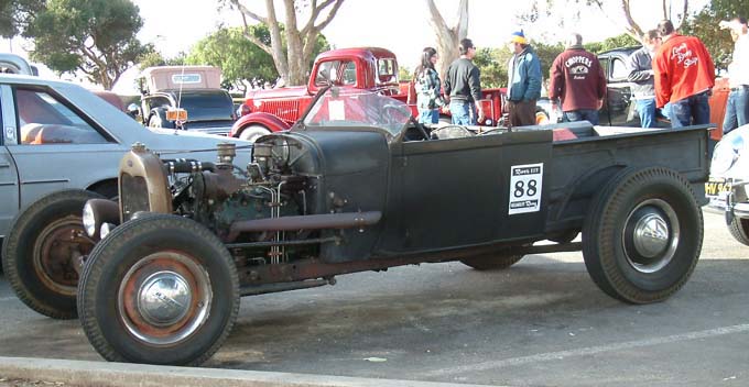

  11. the reason to use a drive shaft is that the resonant characteristics are much better than those of a traditional exhaust pipe. next time you build an exhaust smack the pipe your are going to use and see if it rings...
    attached is a speedster with a model T torque tube as the exhaust pipe.
    (i like to use organ pipe for my exhaust tubing, though it usually works for the end of the exhaust, rather than really close to the engine)

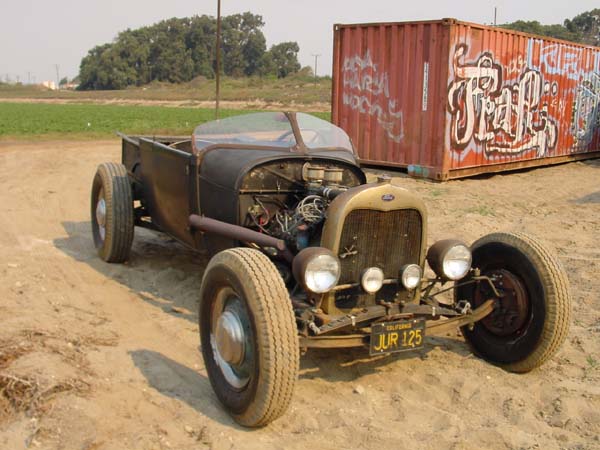

    Heres one of my friend Jims, he's on the HAMB but has only posted a couple of times.
  19. Muttley

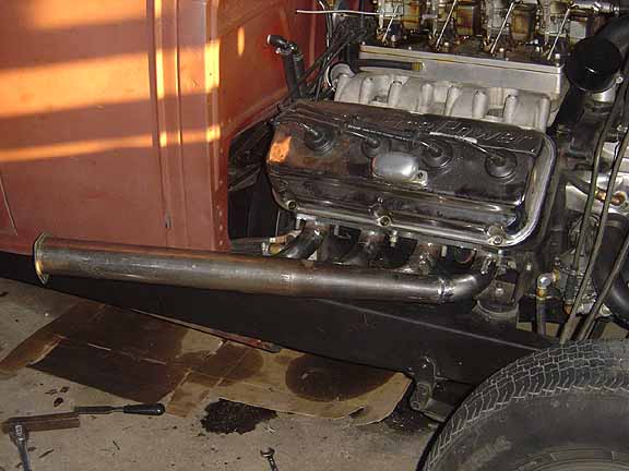

    Here's my new exhaust system I made for my roadster using a '36 hollow driveshaft. I cut it in half and welded some pipes to connect to the headers. I'm now working on end caps to divert the exhaust under the car to the straight tailpipes.

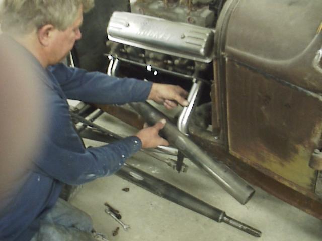

  26. Here's a picture of mine while I was making them. 36 Ford driveshaft, cut in half.
