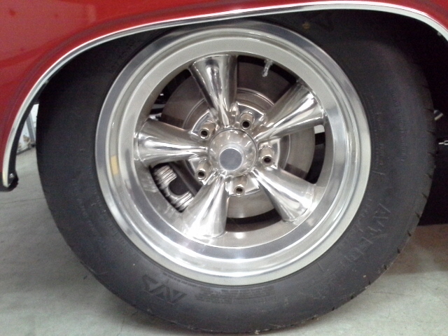

    These are the repop Torq Thrust TTO straight spoke, 15X5 and they clear disks just fine.
    You can tell the difference from the countersunk lugnuts and the large center cap pattern.

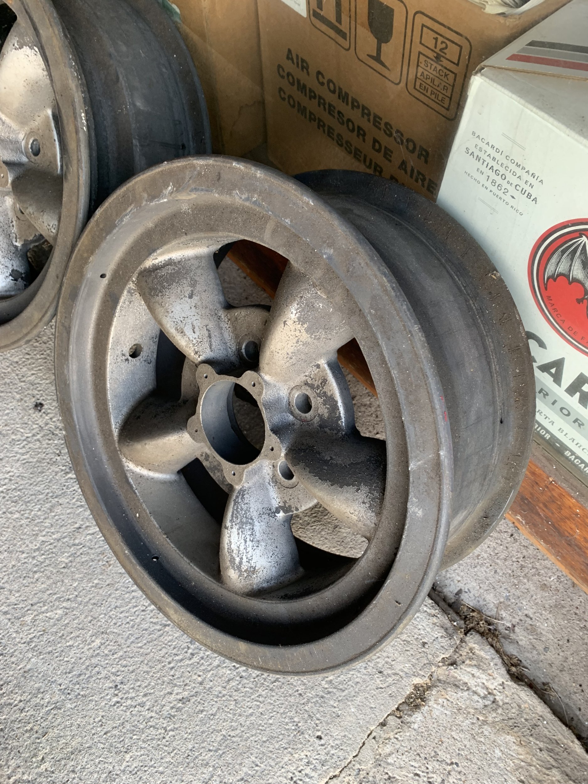

  10. The first series TT-D were magnesium...
