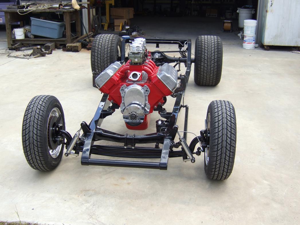

    Most people are familiar with bump steer. I have no problem what so ever with bump steer. What I do have I'll call torque steer for lack of a better description. If I jump on that Hemi it pulls right enough that it takes about 1/8 turn of the steering wheel to the left to keep it straight down the road. When I back off the opposite takes place, pulls left requiring a turn to the right. I have checked to see if the wheel base is right, rearend square with the world. Everything is tight. Panhard bar on the front mounted from the left frame rail to a bracket welded on the right radius rod. Panhard on the rearend from the left frame rail to a bracket welded to the rearend as far toward the right frame rail as I could mount it. Ladder bars with coil overs on the rear and a monoleaf spring on the front. I really don't have a idea what to look for next other than take it to a front end shop and have them check to see if everything is in the chassis like it is suppose to be. I don't think the frame is flexing. It is 3/16 box tubing with 11 ga duece style frame covers welded to the front part and the body has 16 ga floors with a 1x1 and 1x2 box tubing reinforcement. The car weighs 2800 and change. Any Ideas?

    sounds like bad steering geometry. when you jump on it, the front lifts a bit - right. When you let off, it drops - left.
    how is your drag link hooked up?
  5. jbtine
    Joined: Nov 22, 2005
    Posts: 214
    jbtine
    As far as I can tell with a tape measure the rear is square. Thats one reason I may take it to a front end shop and have a 4 wheel alignment done.
    The steering box is a new vega type with cross steer. The drag link is parallel with the tie rod car at rest.

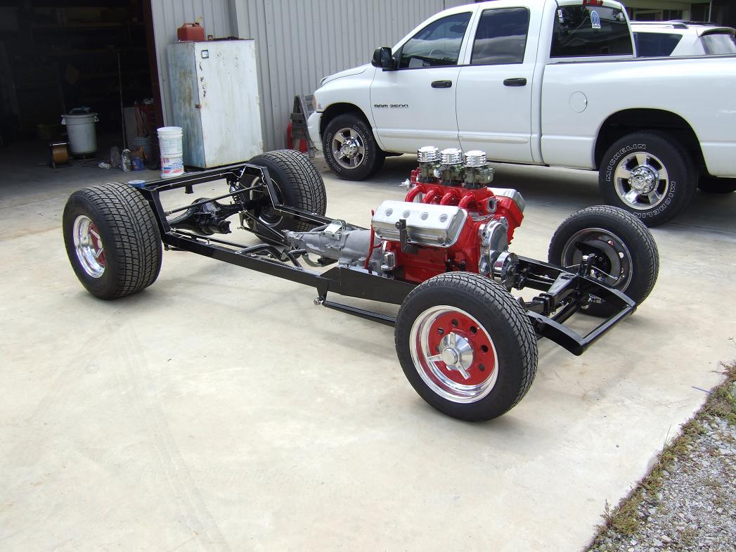

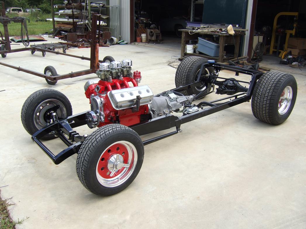

    you might try to straighten your ladder bars ,seems as they pivot at the same center point. just a thought

    My money is also on the frame or ladder bars flexing and moving the rear end out of alignment. The right rear tire is almost certainly moving forward under power. I know having the ladder bars angled in at the front reduces bind in roll, but I'd like to see a good picture of the ladder bar's front mount.

    The ladder bar mounts need to be out nearer to the axle flanges. And a lot beefier.

    I would check your ladder bar brackets on the rear axle housing for signs of flexing. If those single plate brackets are not causing problems now,they almost surely will. I would strongly advise going to boxed double plate bracket where the heim joints on the rear of each ladder bar are bolted between two axle housing brackets. Most of my experience is with drag racing setups and I can assure you that your current setup with a single bracket with a clevis would not hold up. Remember all the torque is transferring through those brackets to the ladder bars and then to chassis. That makes those brackets the first potentially weak leak.

    Mr Hackerbuilt is playing it safe and I'd have to agree with him. Esp if the panhard is both long, and level when it's loaded. The lower outer rear shock/spring mount looks like a better region to consider for a mounting, then carry bars forward to a [K] braced form of heavy section crossmember?

    I would look at frame twist. Had a more door car did the same thing. After driving the car for several years with white knuckles I built a new frame and installed a large heavey wall K member and had a great driving car for another 60K miles.

    First guess would be, the torque twists the frame and picks one front corner up, throwing the front geometry off kilter.
    Second guess, the front goes 'way up, and the cross steer link pulls the steering to the right. The Panhard bar should prevent that, though.
    The car is open-wheeled, get a buddy to ride and watch the front end closely while you work the throttle. Sharp eyes might see the movement, where-ever it is.

  23. I have looked at the pictures of the frame and to me it is quite simply really. When you get on it the front end unloads and raises up. This in turn lengthens the distance from the steering box to the spindle arm. Since the steering box is rigid mounted the car can only do one thing and that is pull right. Hence you must put some left turn in it to bring it back straight. When you get off of it the suspension settles and the left turn you put in before is now making it turn left and you must put the wheel back to the original position to achieve straight ahead.

    A quick glimpse of the picture you have provided and the description of you problem first assumption is that it is a rear steer issue as the chassis rolls from engine torque. Quick look of your chassis and your description indicated that you have a panard rod operating at an angle to the rear axle. This rod must operate parallel to the axle housing for best results. First guess is that as the chassis rolls, the rear axle skews left because of the distance change of panard bars operating alignment shortens. The change changes the lateral position of the axle thus driving to the right. Do not disconnect the panard rod as you do need it for lateral locating. Just reposition the axle mount parallel with the axle and you should find that it drives much better.

    I don't see a substantail K member, it looks like there is some kind of tube associated with the trans mount but it isn't very effective. Look at what ford did when they put a 60hp flattie in thier chassis, they have a huge K member.
    Other people have noted different problems: panhard bar angle, direrection; single-plate axle brackets; steering arm geometry etc all of which are mentioned enough that i am thinking that all of the above are factors into correcting your problem, the hard choice is which one to go to work on first, and i would choose the K member.
