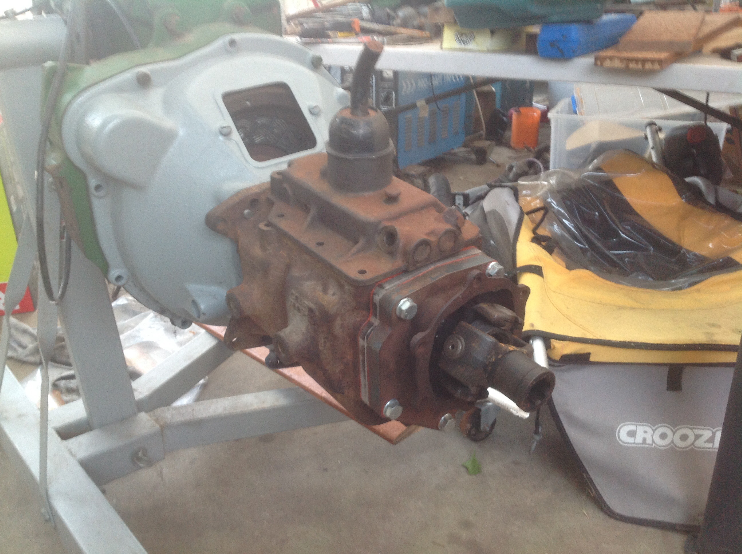

    I did a 3 speed Toploader to a AA bell housing to torque tube conversion ,,, image.jpg
    John Heckman and Lil'Alb like this.
  15. Fabber McGee
    Joined: Nov 22, 2013
    Posts: 1,020
    Fabber McGee
    Oooh, nice job Roddy, what was the 3 speed from with that front face and a top shifter with back up switch provisions, is that more Jeep stuff? Speaking of shifter, that's sort of a short stick ain't it? Haw, haw, haw. And, what's the bearing retainer/ball socket from?

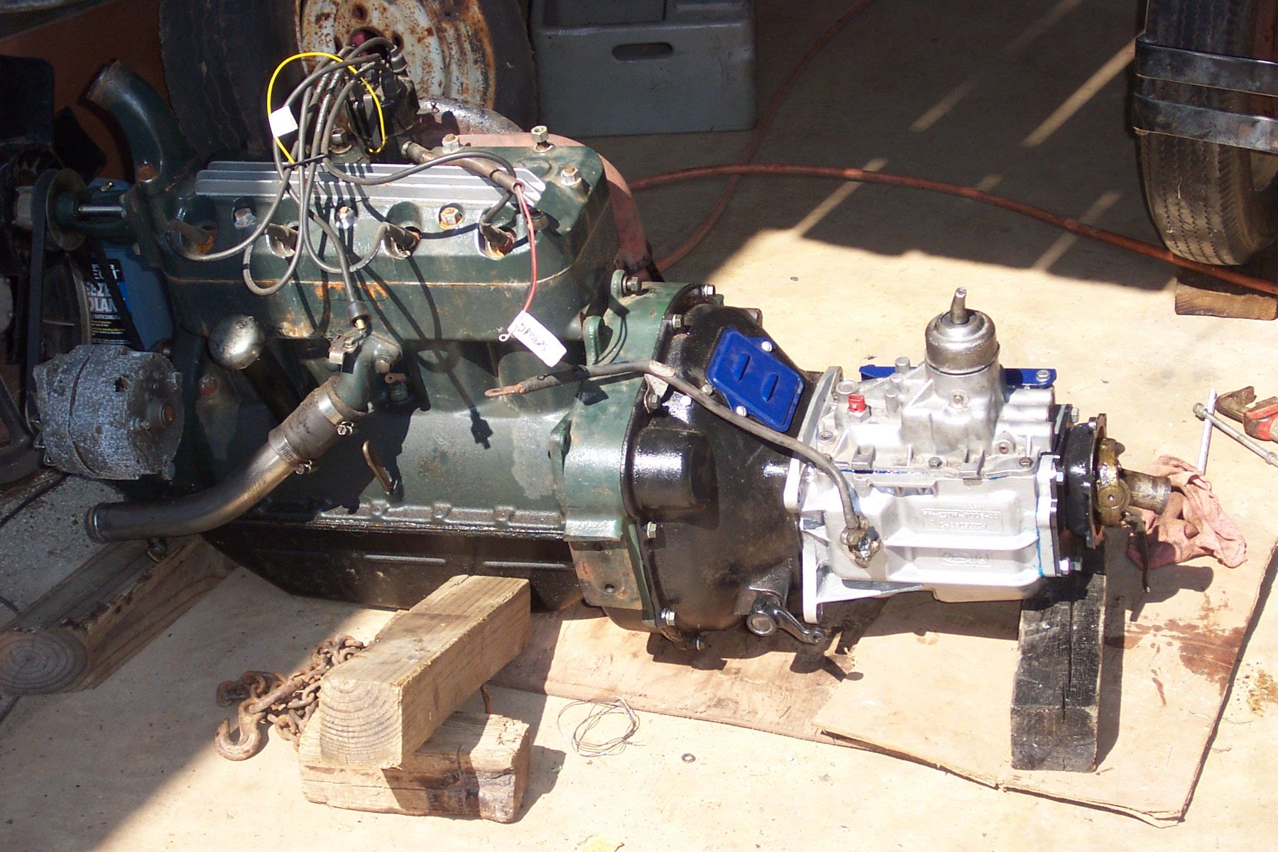

  18. Brendan1959
    Joined: Jun 26, 2008
    Posts: 288
    Brendan1959
    I saw this picture in Aussie street rodder, have you got it in the car yet?
    Did you have to shorten the torque tube?
    Did it clear the cross member?
    Brendan

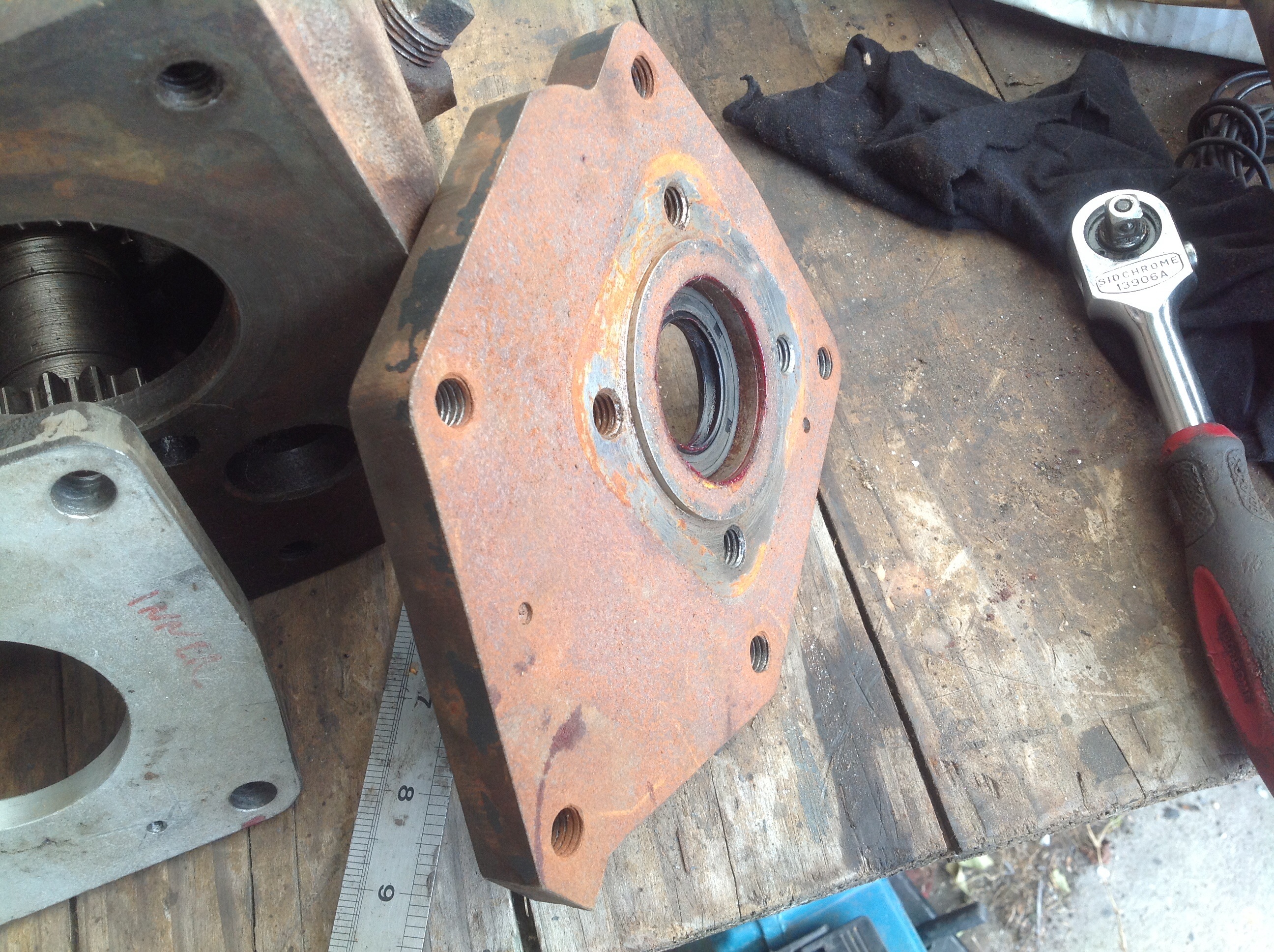

    I understand that this thread is about 4speeds and a 3speed, but both have a 1:1 in high gear so I used a 3speed with overdrive in my coupe. Its out of a 84-87 F150 and works very well. I made a rear adapter like RODDYs but used a 1/4" plate because I didnt want to alter the crossmember and the F150 trans is a little longer than the A. I still had to shorten the driveshaft about 1 5/8". I have lots of pictures

  20. RoddyB34
    Joined: Oct 13, 2009
    Posts: 542
    RoddyB34
    image.jpg the trans is a 3 speed Mustang/Maverick type ,I wannted the F150 type O/D but they not real plentiful in Aust. and you got to get the right O/D ratio for the A model,,so I copiedthe info I could find on those conversions ,,shorten front shaft slightly ,,shorten rear shaft and cut spline for the ford universal ,shaved the extension housing as to keep rear bearing retained as original made a 25 mm thick plate to mount the ford clam shell and incorporate a shaft seal,,I think it will clear the crossmember ok being a 3 speed it's short ,,but driveshaft needs about 43 mm out of it,,I haven't installed it yet but am going to start this weekend so I might do a few pics,,,the shifter is T150 Jeep and bolts on with no mods,,
