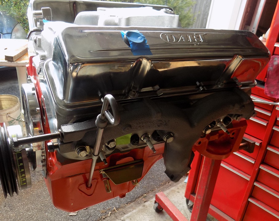

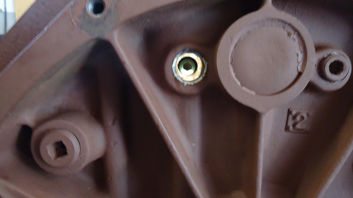

    On a 331 Hemi (and probably the bigger 354 & 392) make sure that there's a plug installed at the rear of the oil galley. If it hadn't been for reading about this on-line, I would've missed it. It's not apparent until you look closely inside the distributor well.
    Pic shows the rear of engine where a 3/8NPT plug is installed ahead of a where a second plug will be going in the rear engine casting.

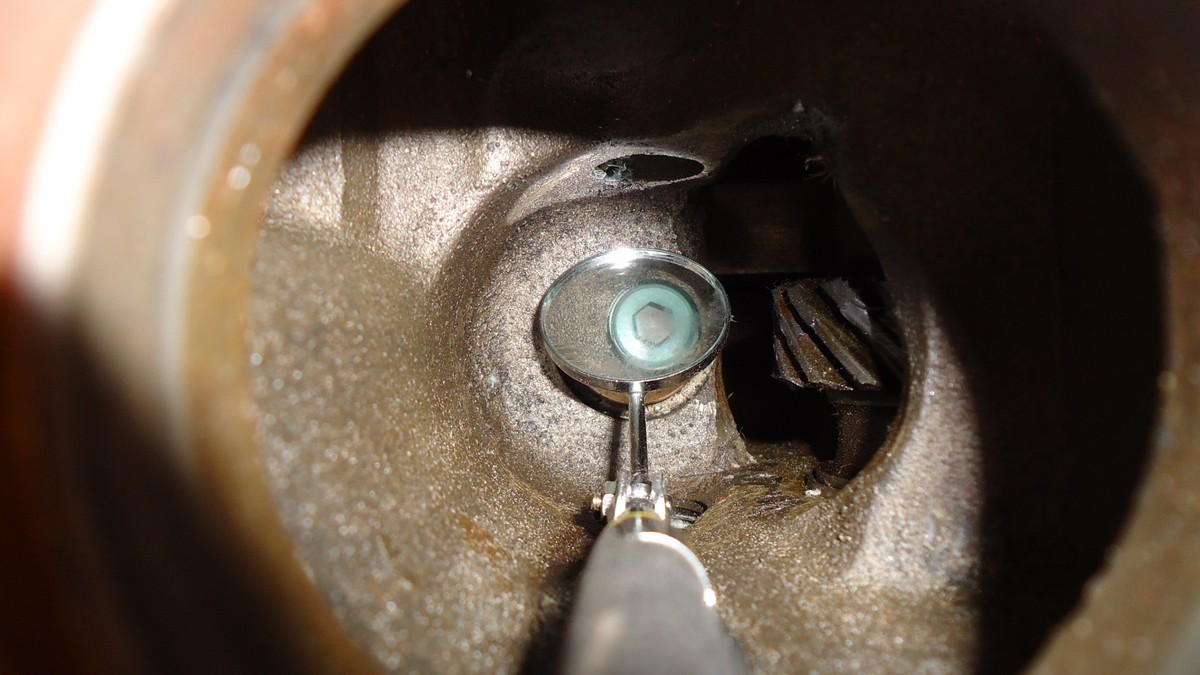

    A view using a mirror down inside the distributor well. Right below the mirror is the distributor gear thrust bushing.
    This is why it would be hard to detect unless you knew about it, especially if someone had already installed the bigger plug at the rear casting; which was the case in the Hemi I bought.
    No plug....no oil pressure

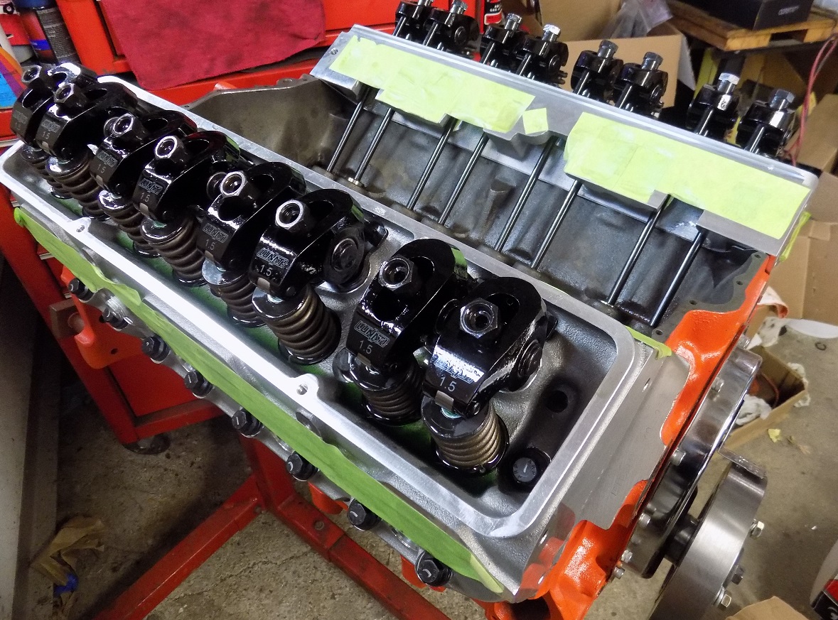

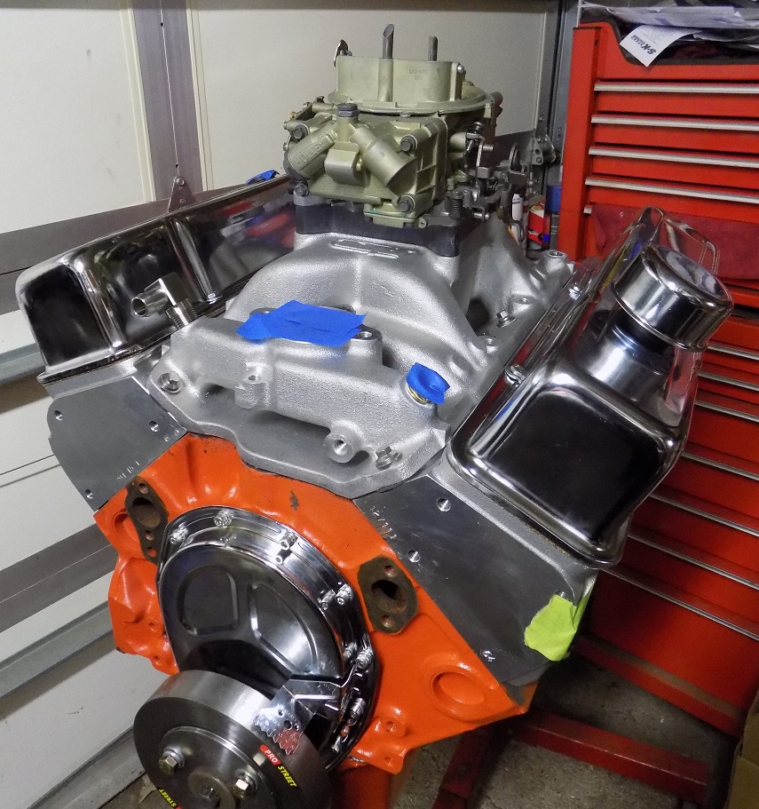

  12. I had my 355 Chevy short block built by a shop, but assembled everything else on it. Clean and clean is good advice. If not working on it, cover it up so things don't get into it. One guy I raced with draped off his garage like an operating tent when engine assembly was being done. Old white sheets everywhere.
    Keep track of small sockets, don't leave tools on the cam valley if the intake is off. Tape off any external holes so things can't fall in.
    I used the cam lube for the lifters, this thick assembly lube for everything else. Might have been a Comp Cams product. But really stayed put on anything. Lunati said to soak the roller rockers in clean engine oil, and I did using an old chinese food plastic container.
    Used the Right Stuff for the Dart intake end seals. It has a 5-minute window once it goes on, so everything has to be clean and ready to go. I used a couple of home grown studs (bolts, no head and slots cut in them) on one side so it went on straight.
    All my bolts were ARP, I used their Ultra Torque lube on all of them, also their white sealer for anything that is exposed to the water jacket. Real thick, reminded me of the Desitin we smeared on the kid's back sides to ward off diaper rash. ARP has great information on their site for general torque.
    Adjusting valves, have only one person doing that, but someone else can help with keeping the sequence straight, turning the engine. Have a clean damper (mine is new), use the quarter markings or timing tape so you know when TDC is coming up. Everyone should know how you're adjusting the valves (EO/IC or whatever method you follow). If you can see the rocker stud (no polylocks) make sure the same amount of thread is showing to rule out a gross error.
    Use only a trusted torque wrench and follow tightening patterns. All of my Dart stuff came with that. I had a couple of torque wrenches (borrowed) and bounced the SK and Craftsman off each other, no difference was detected between them. Once something is torqued, I mark the head with a silver Sharpie so we all know it was done.
    Have 2 sets of eyes around for installing head and intake gaskets is a good idea. A 3rd person is a great help to get tools and things for you. Don't work when tired, best to call it a night when you start feeling stoopid.

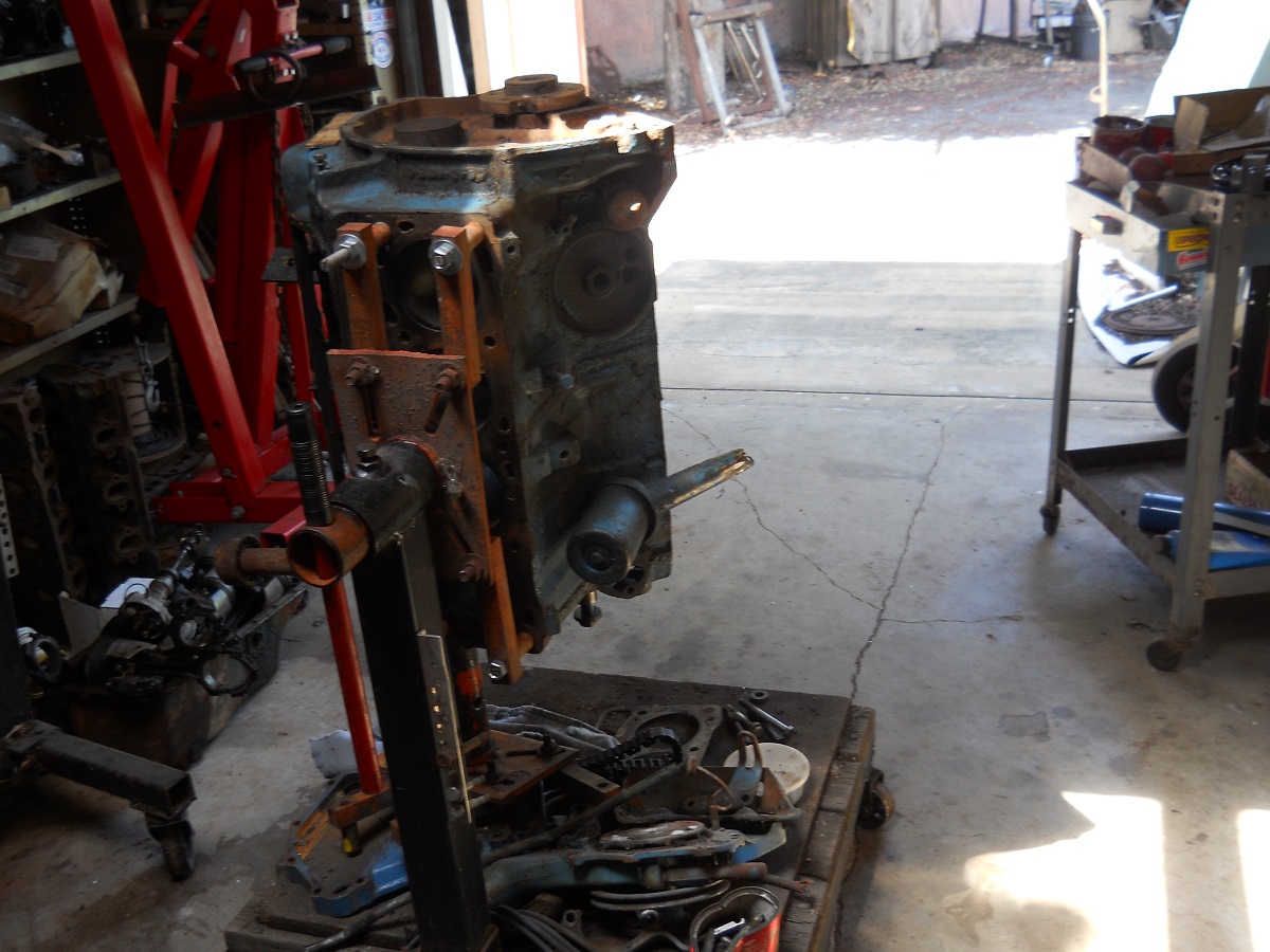

    I am a new engine builder, and my brother says I don't have this block properly mounted on my stand. Is this a rookie mistake?

    Is this for disassembly or re-assembly? Great for dis-assembly, saves your back, you dont have to lift that heavy crankshaft out!:eek::D
