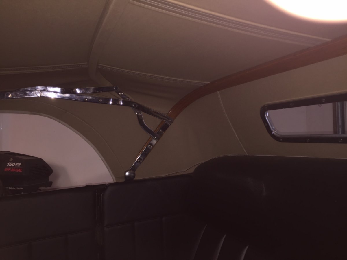

    1932 Ford Roadster. How do you make them so you can entry? i want to use the car with the top down, not of and in the garage. this is a original changed a littlebit for chopped windshield. Pls, Give me pictures. Hj4lW6npQmy1hZPklemrCA.jpg BIxOuhy7SEy72KwitEKnhQ.jpg

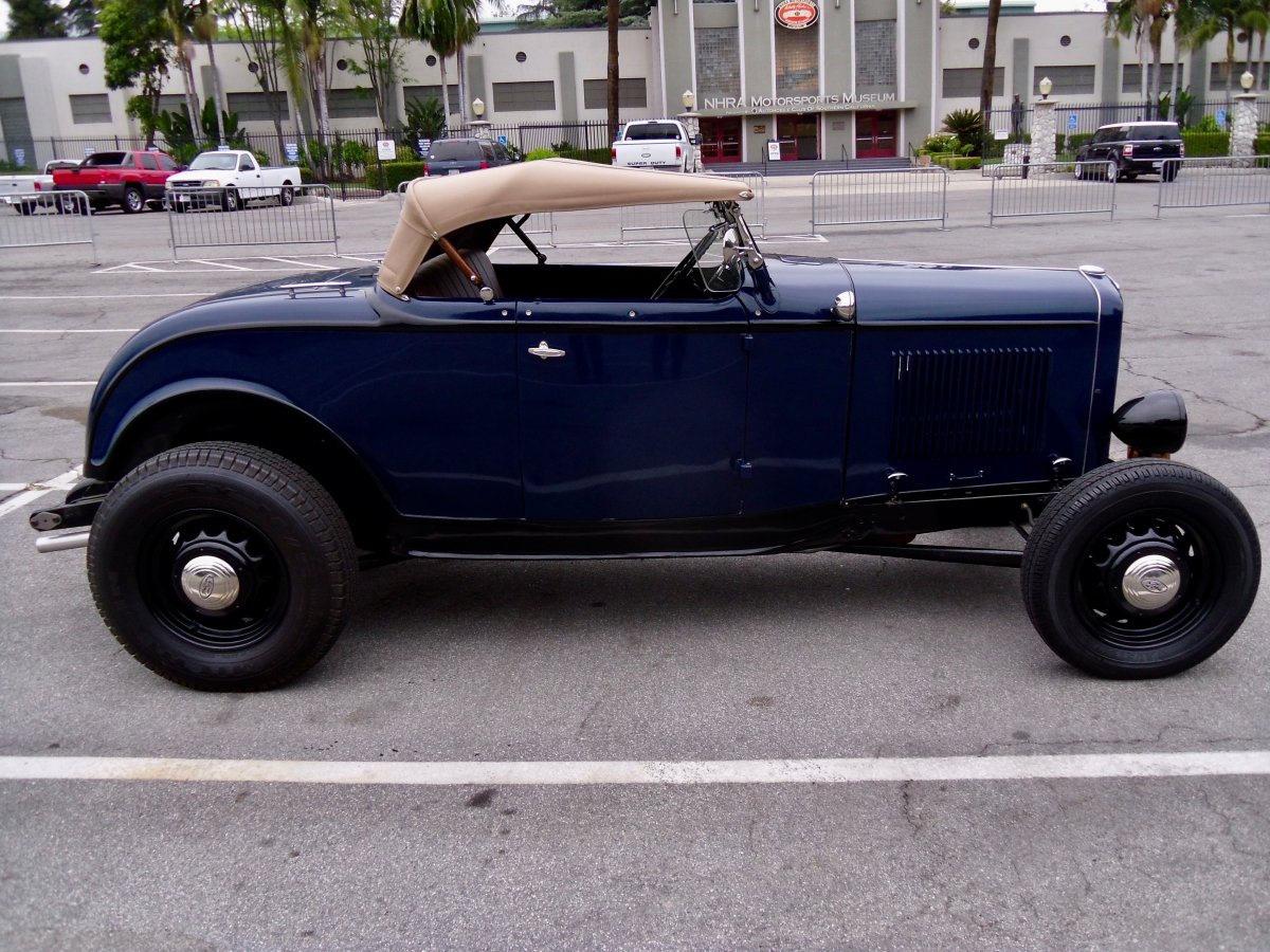

    Jimmy, When the upright of the stock top irons, that attach to the bolt behind the doors, are cut it forces the folded iron to interfere with entry. My '32 roadster has original irons and if I want to fold the top I just remove it and stow in the trunk. Although my car is all original Ford except for the engine I couldn't justify an aftermarket top. They just don't look right on an original Ford roadster. SAM_0429.jpg

    Yes, my main bow is shortened. glass in middle is 4'' and that's to low for driving with top on.. cool attitude, but to low. So far have the top been in the garage when not used, but i drive a lot here and in Europe you never knew the weather. I'm gone to make all new now and don't have any good idea. But there is a lot of roadsters out there and someone with same problem must have the solution. or do i have to invent the wheel again.
    It's a really nice roadster you got. Love them in that style.. IMG_9930.jpg IMG_9931.jpg

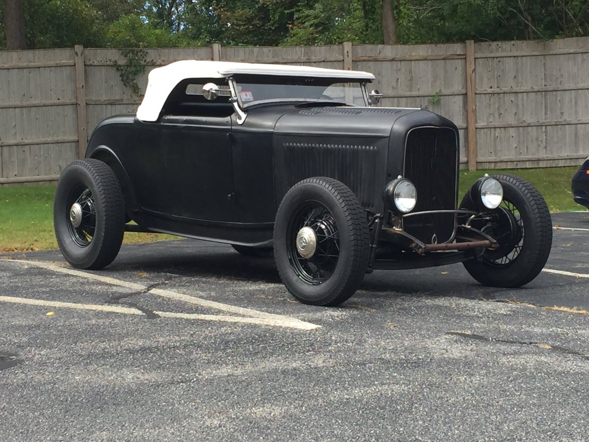

  6. alfin32
    Joined: Jun 20, 2006
    Posts: 1,588
    alfin32
    from Essex, Ma.
    Mine is chopped 3 1/2" on a repro Baron LeBonney frame, and it does not fold flat, which is not a problem for me as I love the look of it up. I'll try to post photos today in the 'folded' position. image.jpeg
