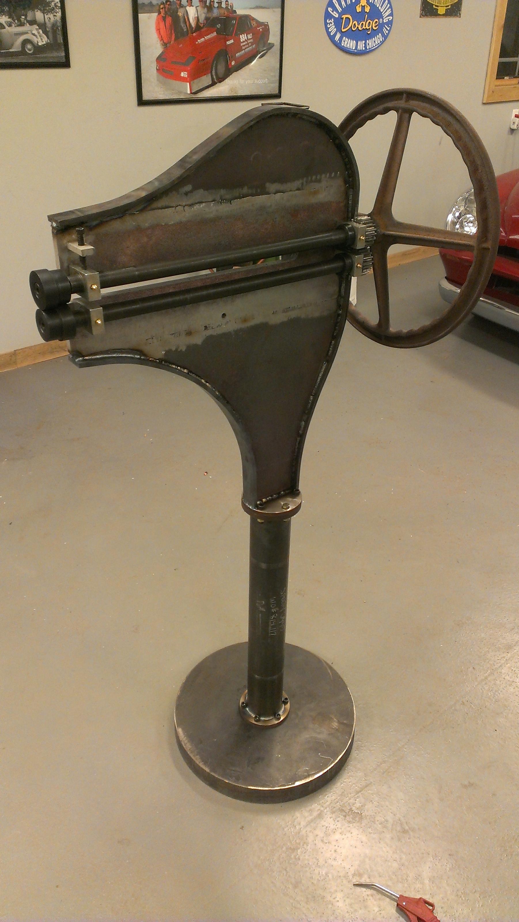

    Here's some pix of mine.
    I cut an exact copy on the cnc and bolted them together. I put a slide on my version to have a back stop.
    And change all those chinese nuts and bolts.

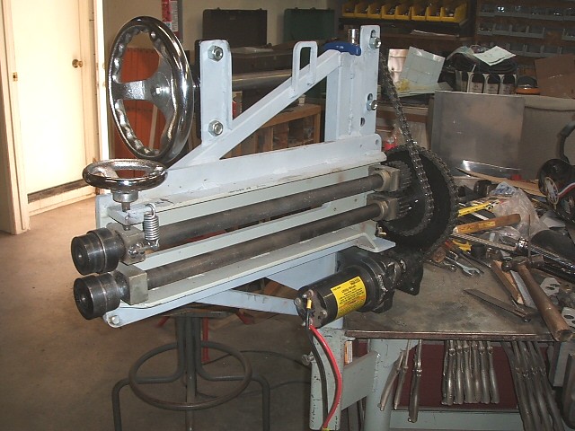

    Here's mine, tried to sell it a while back since I got a Mittler, but it doesn't cost anything to stay in the shop and I still use it on heavier stuff.

    I planned on putting a VFD on mine too but the Mittler already has a motor so I went with steering wheel drive. The upper structure is all bolted on so a motor in the future is bolt on deal.
    Dave

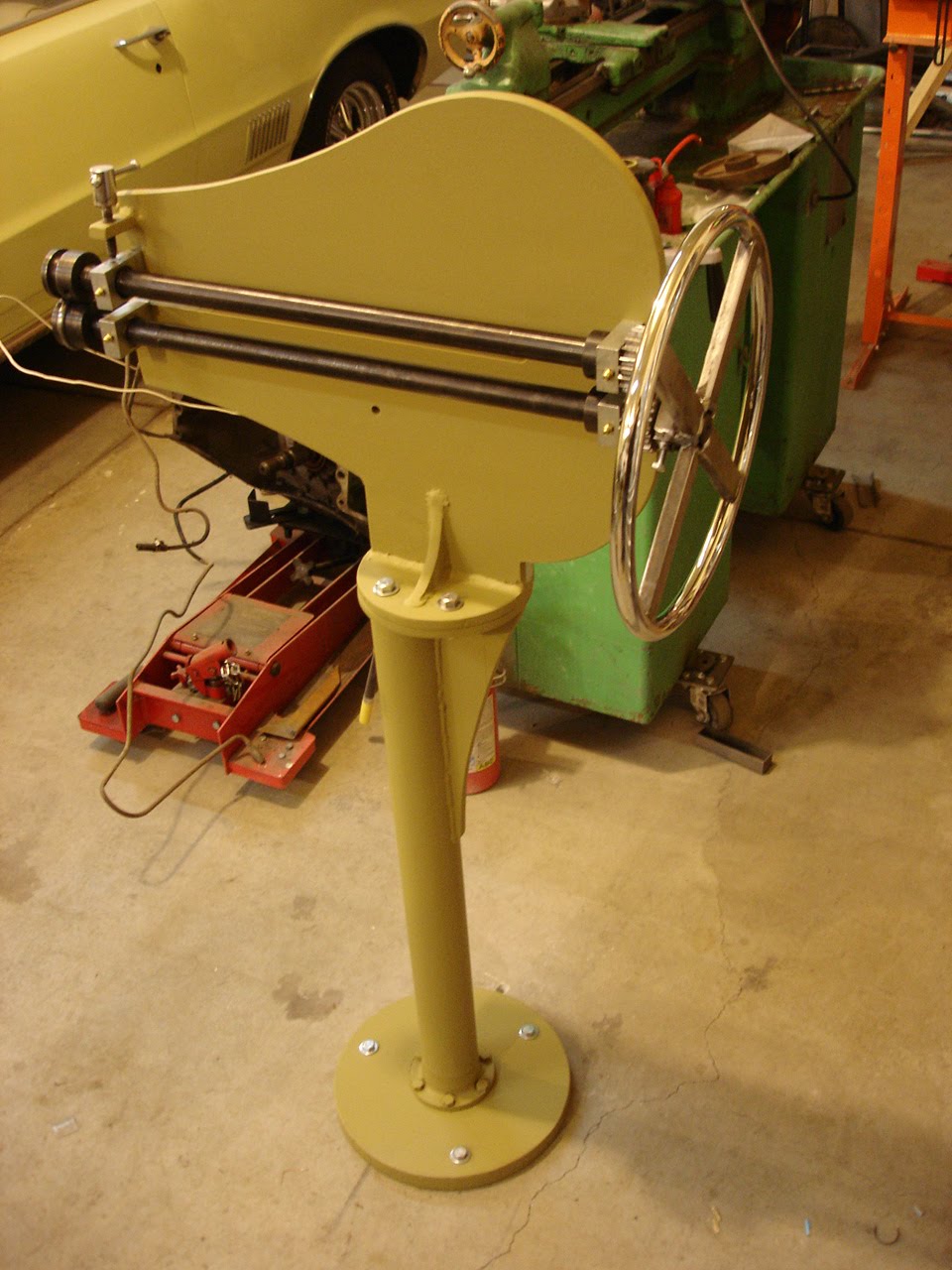

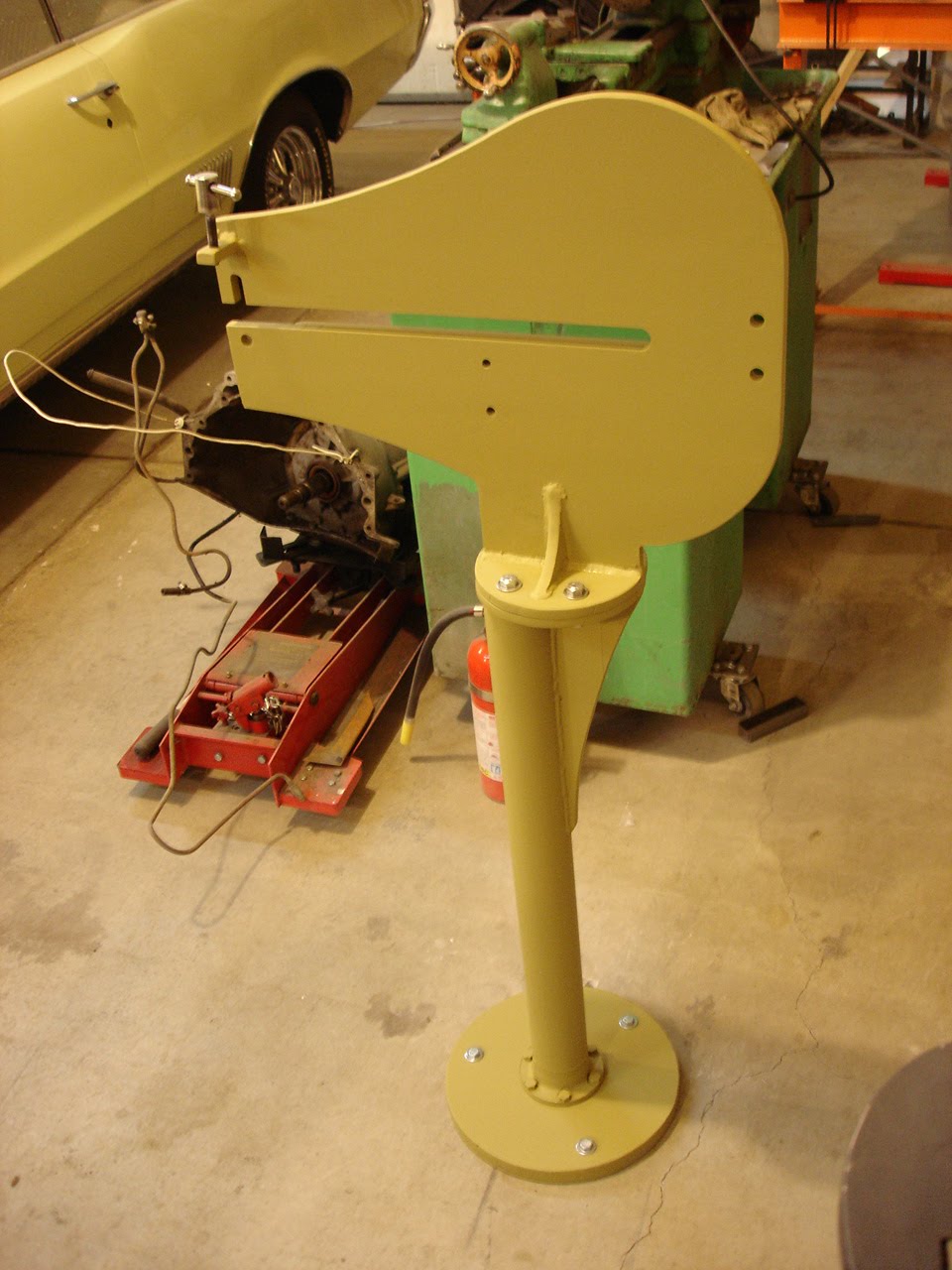

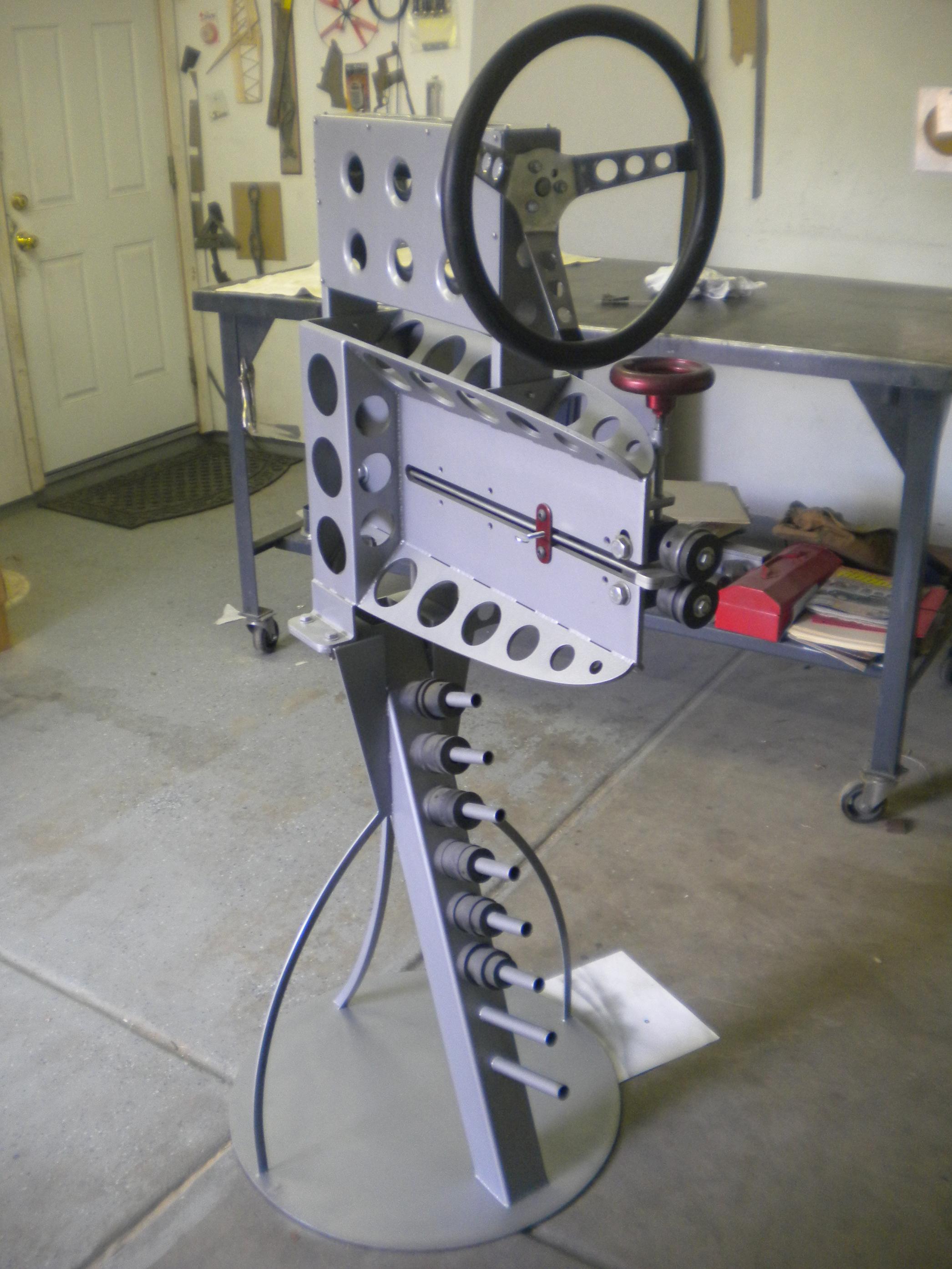

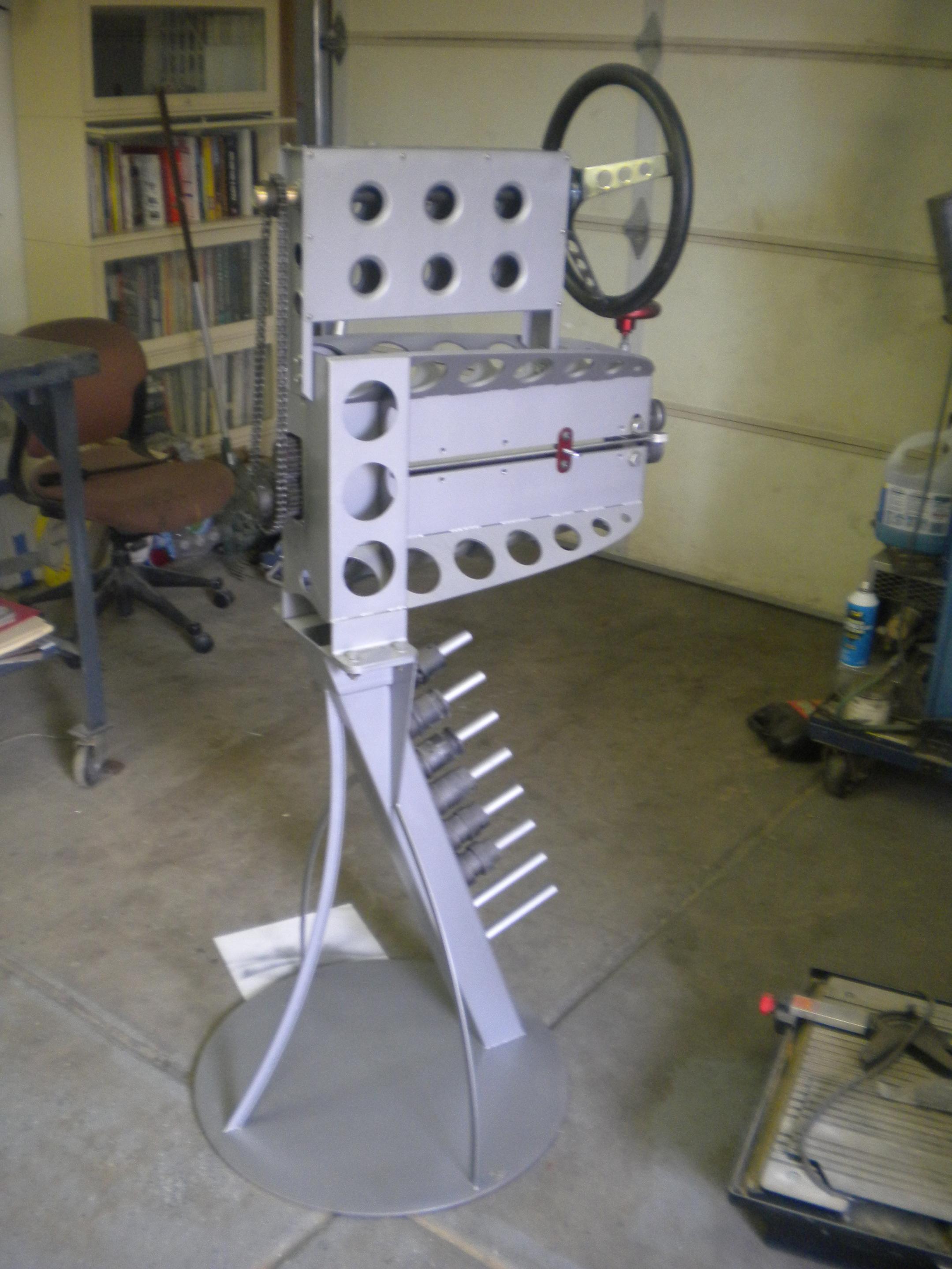

    I couldn't resist the beautiful shape of the green one that started this post. I got the Woodward Fab one (CHEAP from Summit) and started sketching designs. Here's what I came up with. Thanks for everyone posting their versions. I learned much and got the drive to build mine!

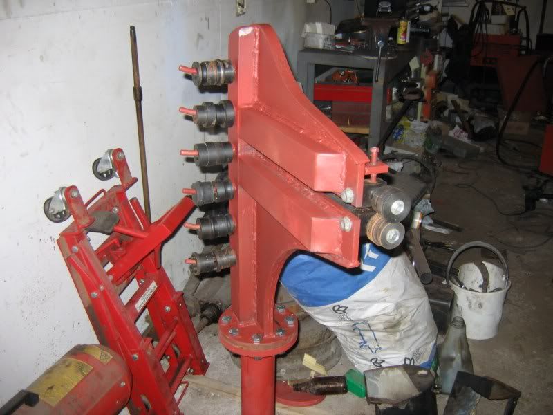

    Here's mine HF based beadroller:
    These pics are 2-3 yrs old.I get rid off the crank and at these days i have a steering wheel from some old bus bolted on

    Here it is actually finished.
  14. Well done, did you make the wheel as well?
  15. CRH
    Joined: Apr 30, 2006
    Posts: 554
    CRH
    from Utah
    No, the wheel was cut off of and old bar stool.

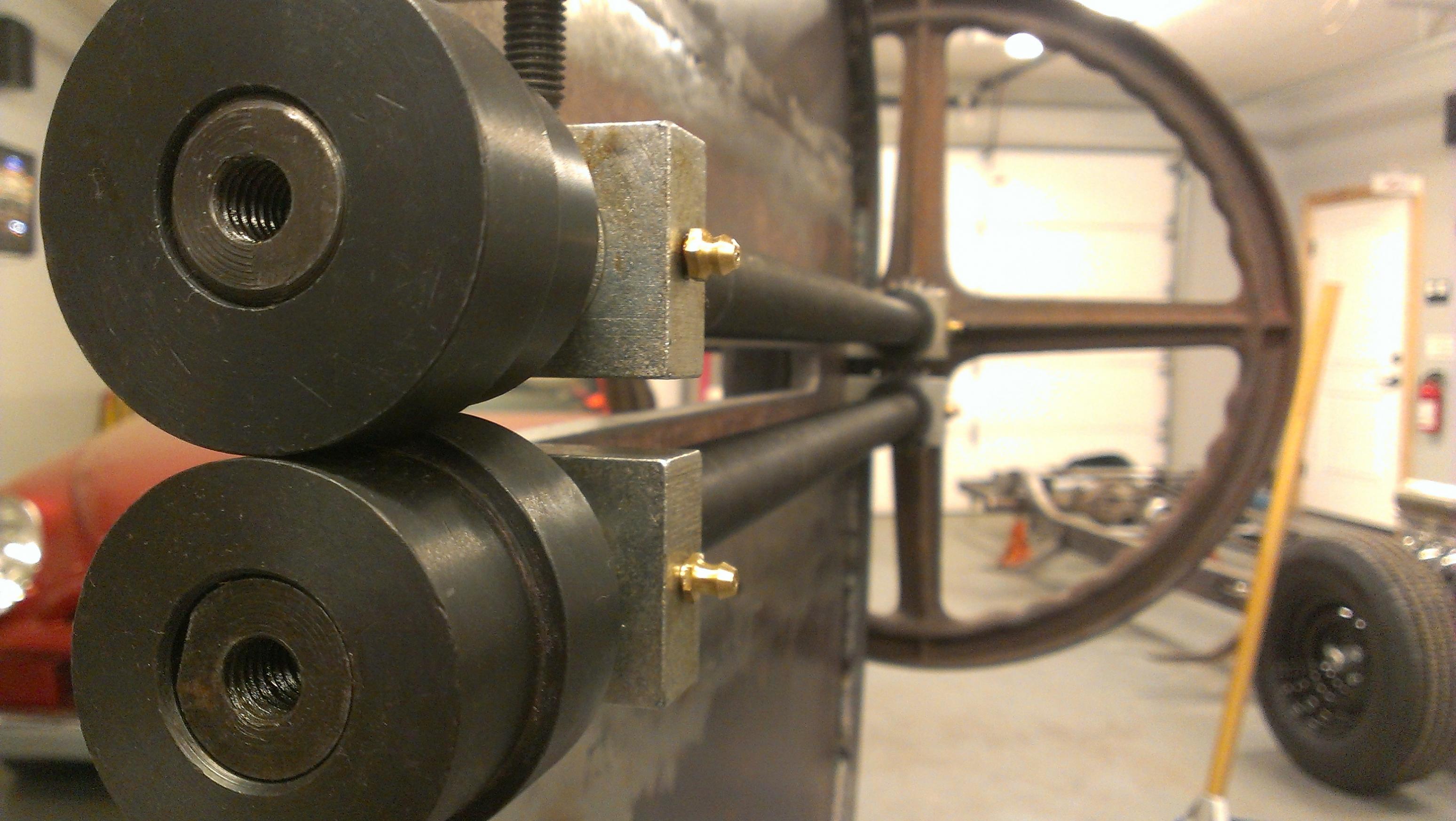

    Well i get zero points for originality. I couldn't help but follow the lines Neal in CA laid out. Im 25 and just getting into this hobby, so sadly i can't say i was able to make it out of scraps i had laying around. It started out as a Woodward fab roller which uses 1/2" plate. I was able to flex the plates 3/4 of an inch at the end using a 24" pry bar before the modification. Now i struggle to tweak them 1/8".
