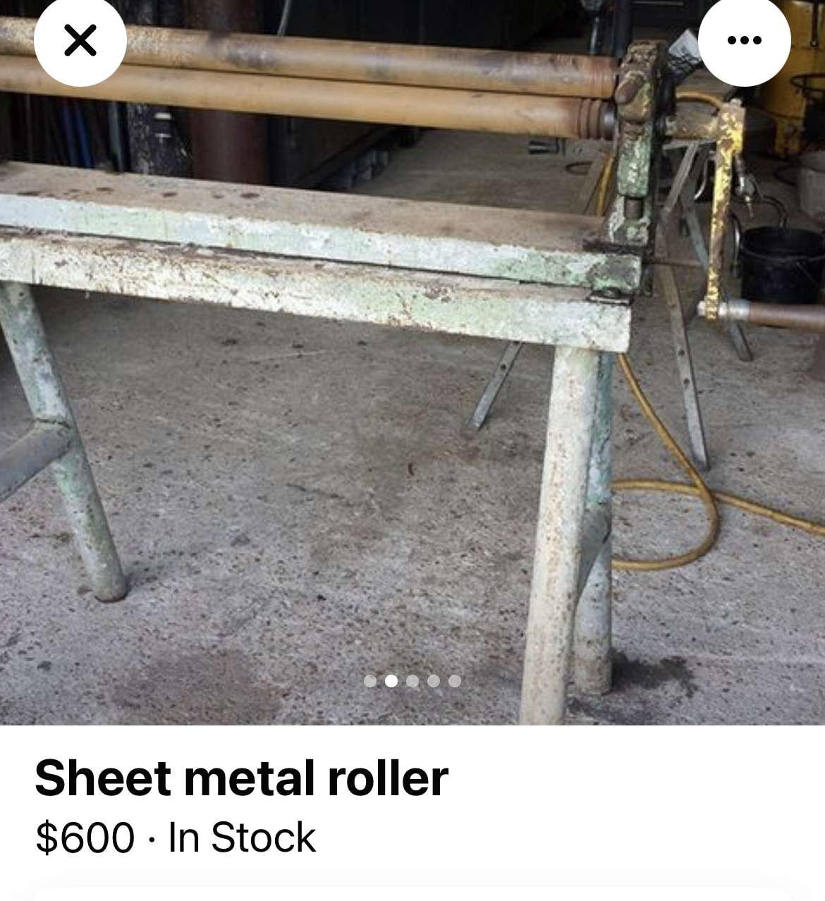

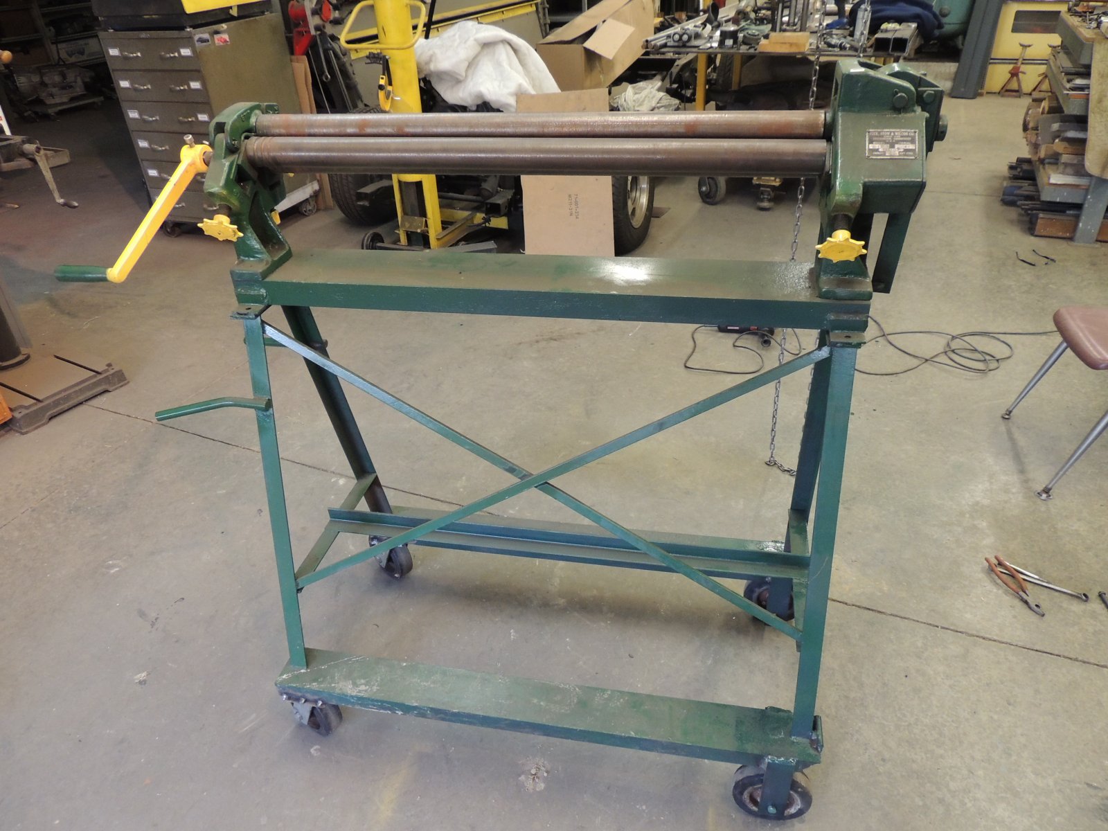

  8. Price is dependent on brand/country of origin
    And gauge.
    an overseas unit that is 52’’ x16 gauge is around $1300
    Most I see for sale are 22 gauge units like this Pexto.

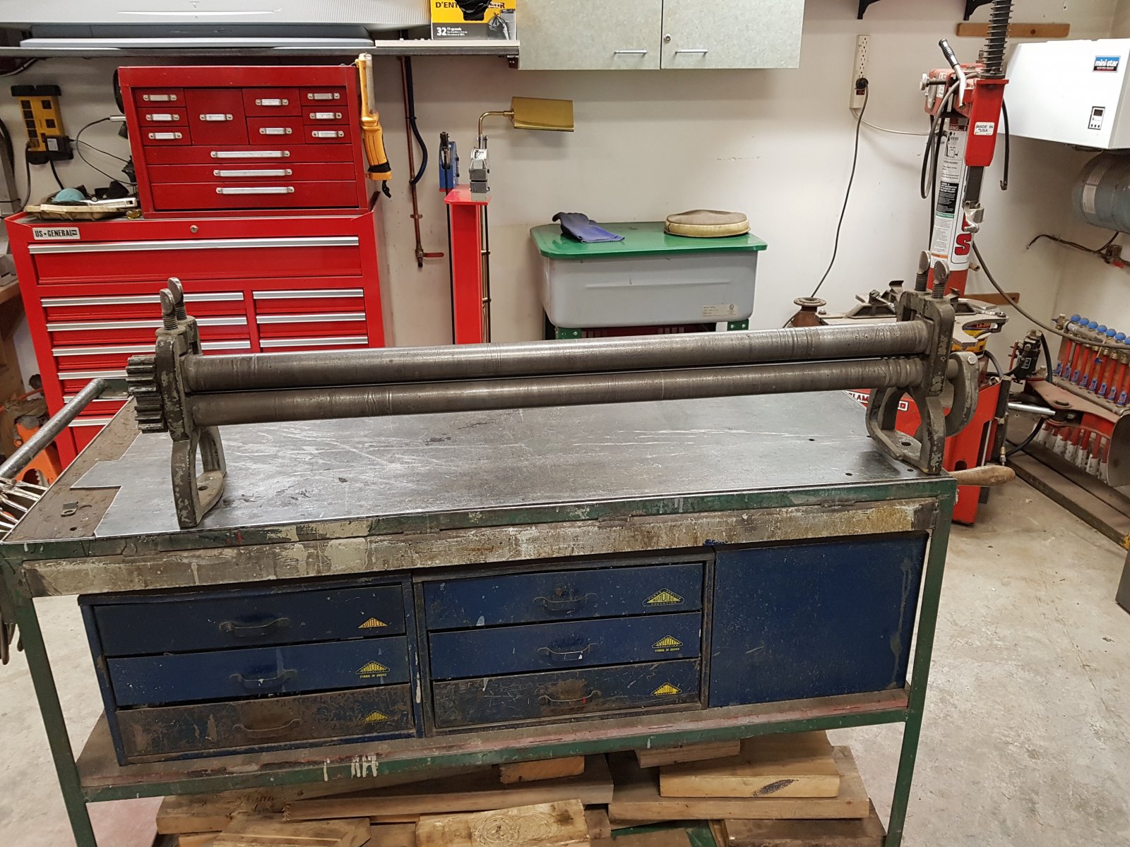

  13. I have this one. I think it's intended for 36" 22 gauge but I've rolled 30+" 18 gauge driveshaft tunnels with it. I get the shape I want by very slowly adjusting the rollers tighter and gradually sneak up on the desired shape. I think I picked it up for $100 about 20 years ago when a sheet metal shop upgraded. 20201214_132817.jpg
    For example...
