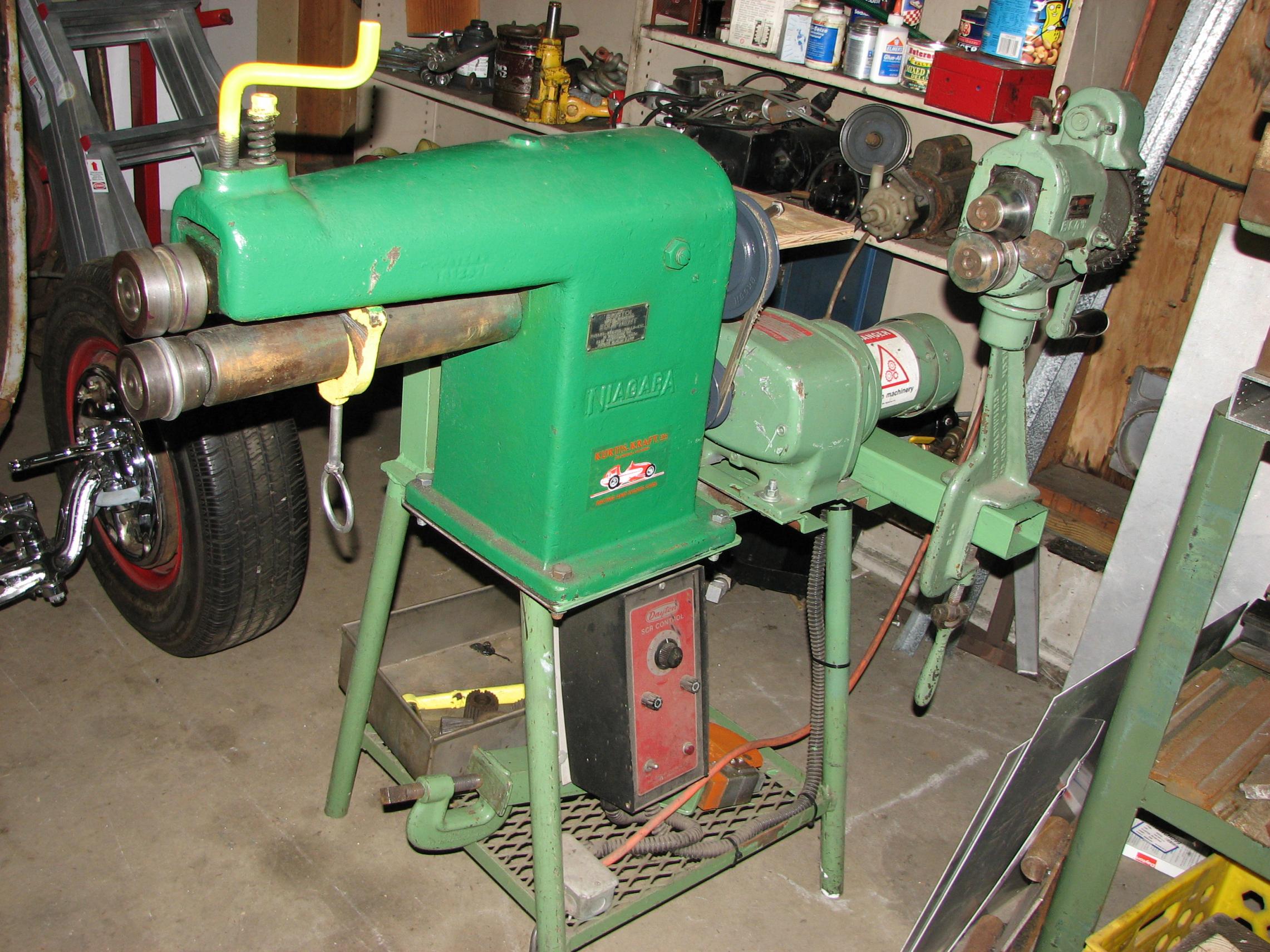

    Here's an antique Niagra bead roller set up with a DC Variable speed drive assembly I got from a plating line shaker. Used to have a Pexto 622 on it , but the old stuff is so much nicer...Guess the safety police guy has never worked in a sheet metal shop, or any where else for that matter.
