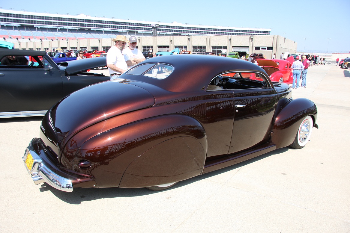

  23. Roadsterpu
    Joined: Nov 10, 2008
    Posts: 895
    Roadsterpu
    Looks great Tony. Love the wheel choice.
    I think it deserves a very rich color
    What about something like this?
    Or

    I like what I see. Stance and proportions are killer on this '40, but would we expect anything less from Mr. Miller's design/taste? I love how drastically better a slightly channeled '40 looks over stock. Nailed it. As for color I agree with Roadsterpu, I would look into the rich browns, golds, etc. A creamy root-beer would be just the ticket, or an Amber Ale.

    That's a spectacular brown, Paul. The gold will never happen; I'm not a gold guy.
    I've been wrestling with the color thing for several years now. On the one hand, my taste is pretty conservative, and I'm happy with quiet colors like the ones on my two Victorias. On the other, I know that the car would command more attention with a more vivid color like the brown you showed, or candy something -- but I have learned not to do stuff to my cars that make me uncomfortable driving them.
