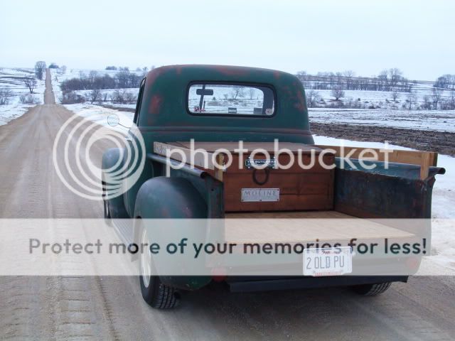

  18. ...I like the storage box idea myself, here's mine in my 47 AD; it's big enuf for a full-size spare tire; still room to haul stuff in bed.

    I had thought about a box but unfortunately I've mounted tha gas tank in the front of the bed and don't want to move it. You've got a really neat truck, I'll bet it's a lot of fun.
