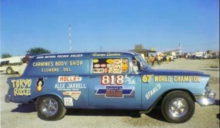

    you may have seen these...
    hendelec and enloe like this.

    Thanks for posting the pictures. I'm hoping we can find a better detailed picture of the charactercher of the Rose.

    Be sure you use a rear bumper from a sedan/hardtop/convertible, and NOT a wagon/delivery rear bumper. For some reason, that's what was on both versions of Tokyo Rose. I am Butch/56sedandelivery.
