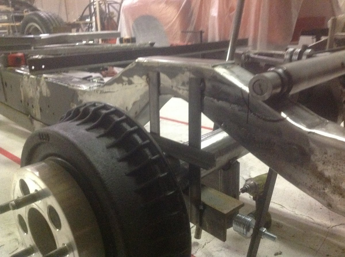

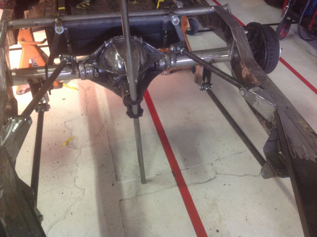

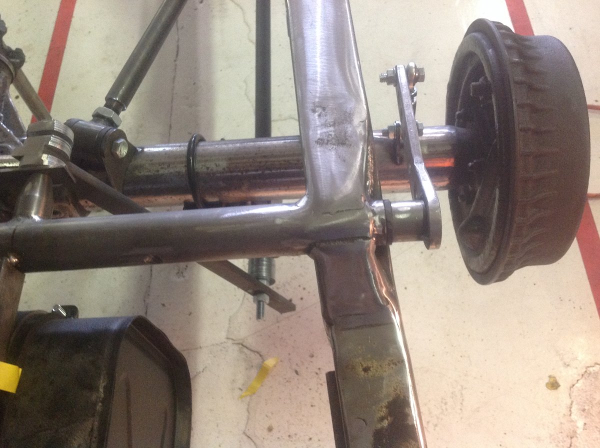

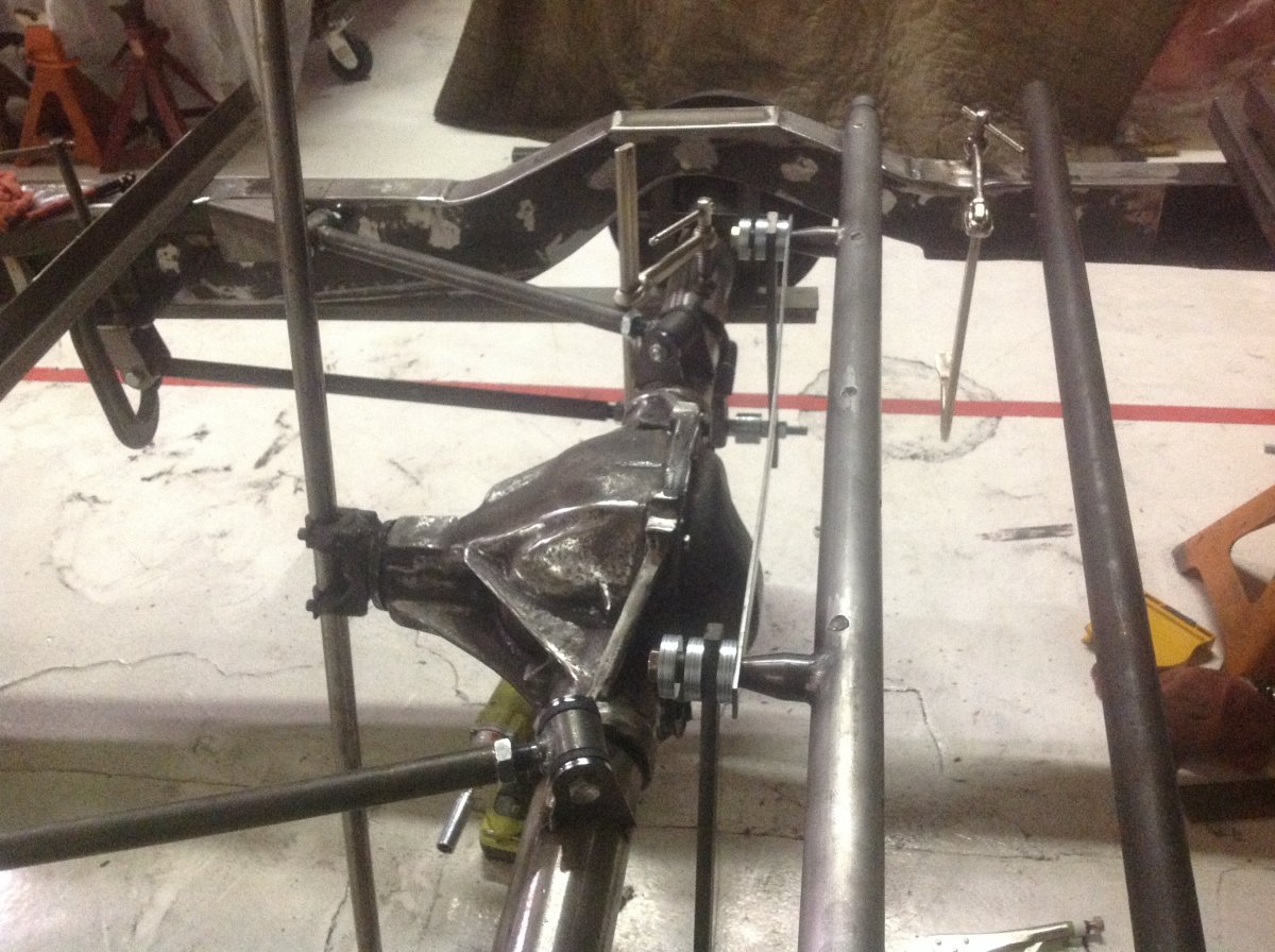

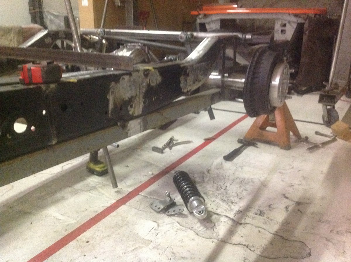

    so I get this 54 Chevy truck in here that's just impossible to drive.
    It won't steer, corner, park, or go down the road. Sorta stopped ok but the brake pedal stayed down. It wouldnt start or re turn to idle either but that's another issue from the very same challenged people. The sad part is its that's it's absolutely beautiful and completely finished after being in body shop jail for T E N years and needs to be completely dismantled then cut apart to correct the issues. The chassis was a mess of a foundation for such a beautiful truck.
    The ride height was a joke being too low in the front and too high in the back.
    The front was on bags and so low that with the suspension fully up and the moving parts bound on the limits it had the bumper about 2" off the ground. It was so bad we had to pop the top ball joints to get the front wheels off. The rear had leaf springs moved under the frame rails and then huge lowering blocks to get the thing down but still 4" too high in the back. Wheels and tires with the wrong offsets and 1" + spacers just to get the damn things in the available bed/fender spaces while running way to close to the fenders. The shocks were at stupid angles mounted to a skewed crossmember binding the bushings and the crossmember was very inadequate of doing its job. The rear sway bar was just as bad.
    Up front- The steering and Arm geometry was off, so far off that the basic principals must have been ignored. The front track width looked incredibly stupid being so narrow. However I think they narrowed it in a feeble attemp to be able get the wheels on and off. This required a new crossmember with proper pivot width and rack placement along as well as a frame modification. Adding 1-1/4 inches in on the bottom and removing 2-1/4" on the top to get things very close to optimal up front with a c notch for the rack. Some control arms
    So most all of that stuff has been corrected at least in theory and mock ups for the most part, until we get to the engine angles and driveline angles .

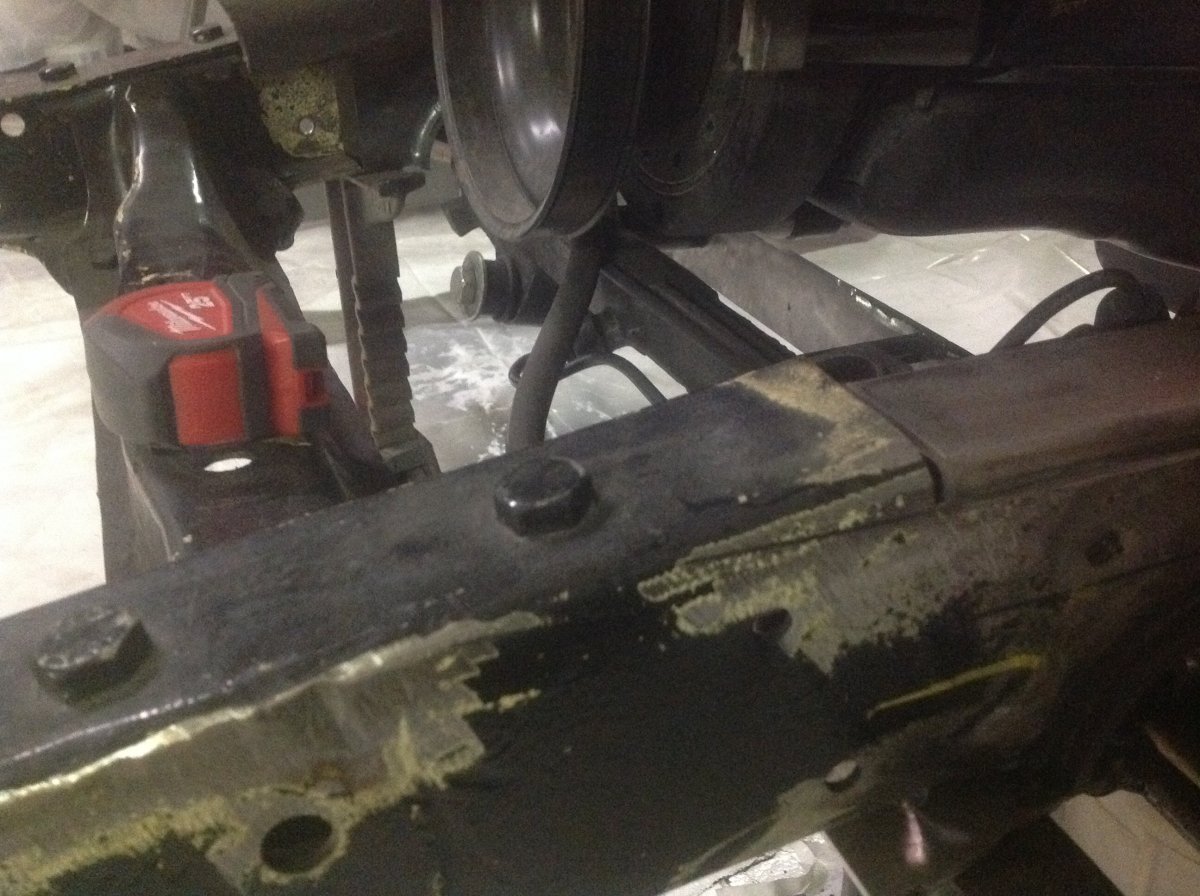

    Before I cut these things apart, I made a jig to get the engine in the same place as it was before I removed it. This is how it sits in its original spot, Why??? Here's why.
    First the front of the engine needed to be raised to clear the rack.

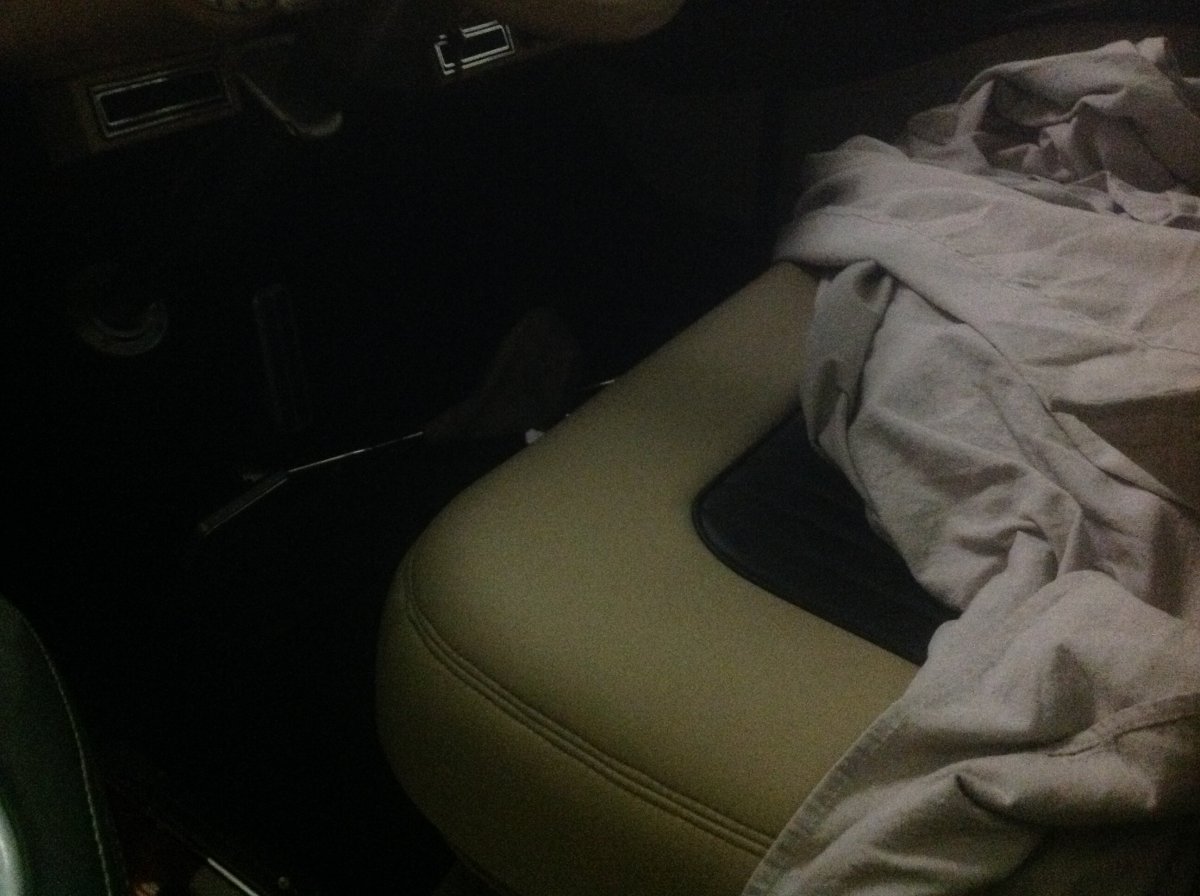

    Next the rear needs to be lower to clear the dead flat floor,,,
    ,,,the finished $7000 interior
    I'm thinking about options:
    1 Dropping the front down, smaller balancer and an exhaust manifold that tucks tighter and clears the frame.
    2 Fix the floor and send it back to the upholstery shop after I raise the back of the Trans up.
    3 Nip the oil pan and set it up rear steer with beefier GM parts instead of pinto stuff and drop the engine.( I'm liking this one the most)
    4 Leave it as is and get New 2 piece drive shaft
    5 Crank the pinion around to match and say fuck it.

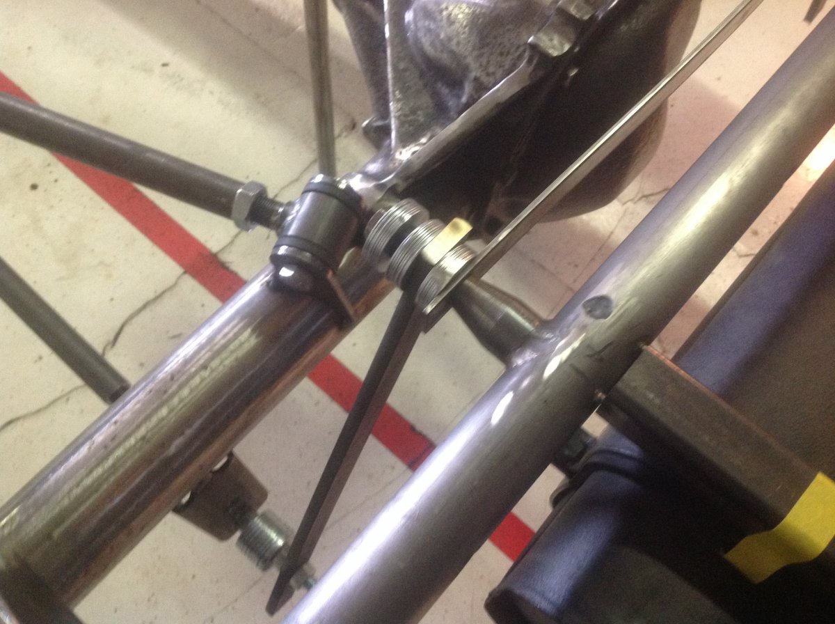

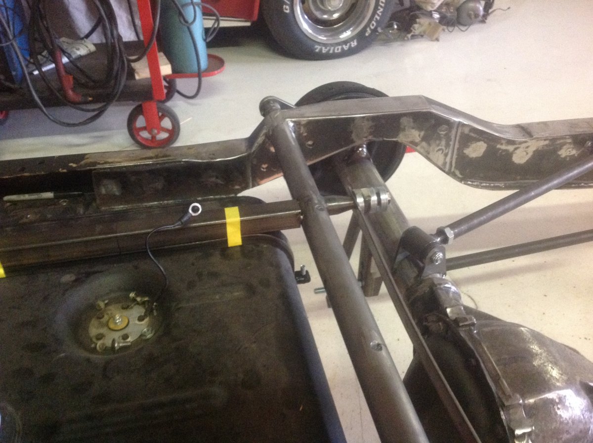

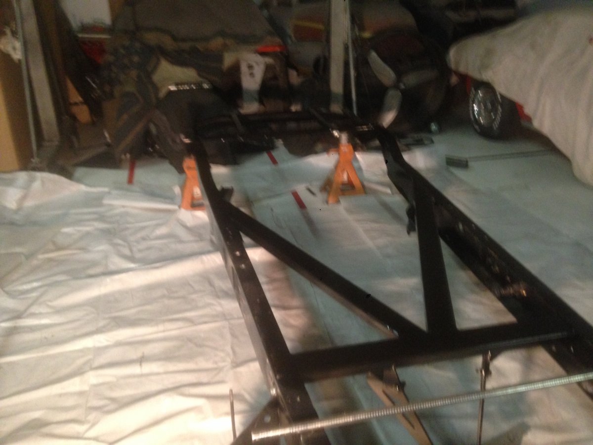

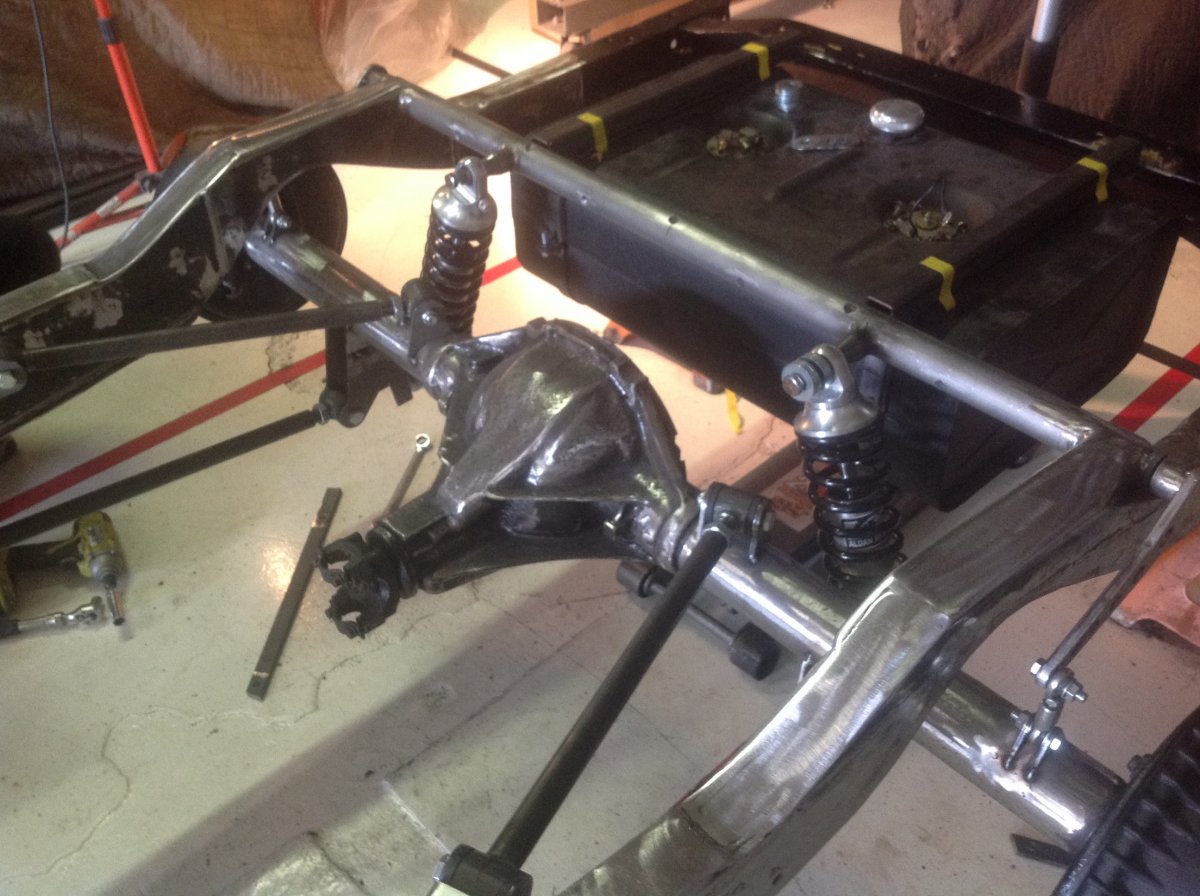

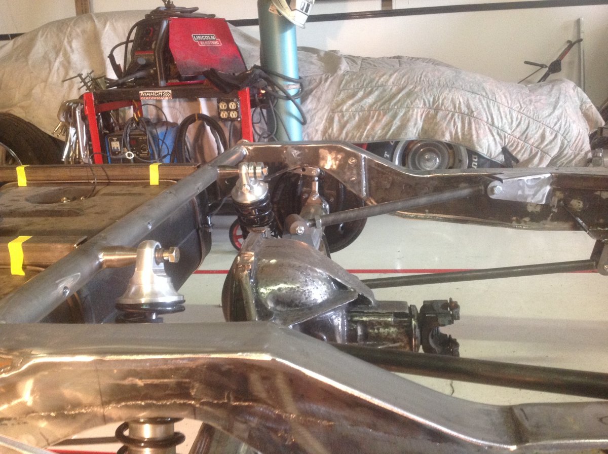

    Here's some of the rear fixes.
    4" more clearance
    image.jpeg image.jpeg image.jpeg image.jpeg image.jpeg image.jpeg image.jpeg image.jpeg image.jpeg image.jpeg image.jpeg image.jpeg image.jpeg image.jpeg image.jpeg

    Good on ya for fixing it, option one is the right way , option 2 of adjusting pinion angle works but is cheating a bit, is this yours or a paying customer?
    Guess it depends on budget

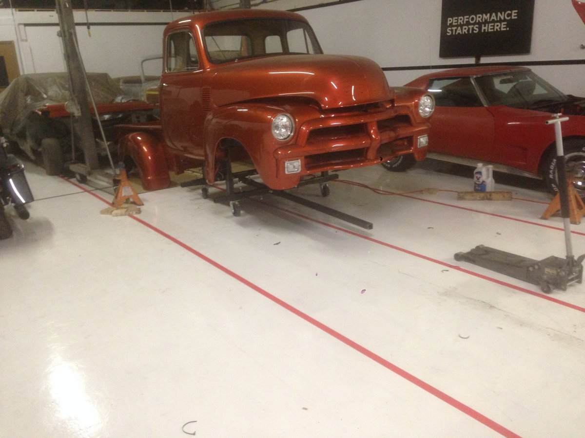

  7. The truck belongs to a good customer who's become a better friend.
    unfortunately this truck was sentenced to body shop jail long before we met.

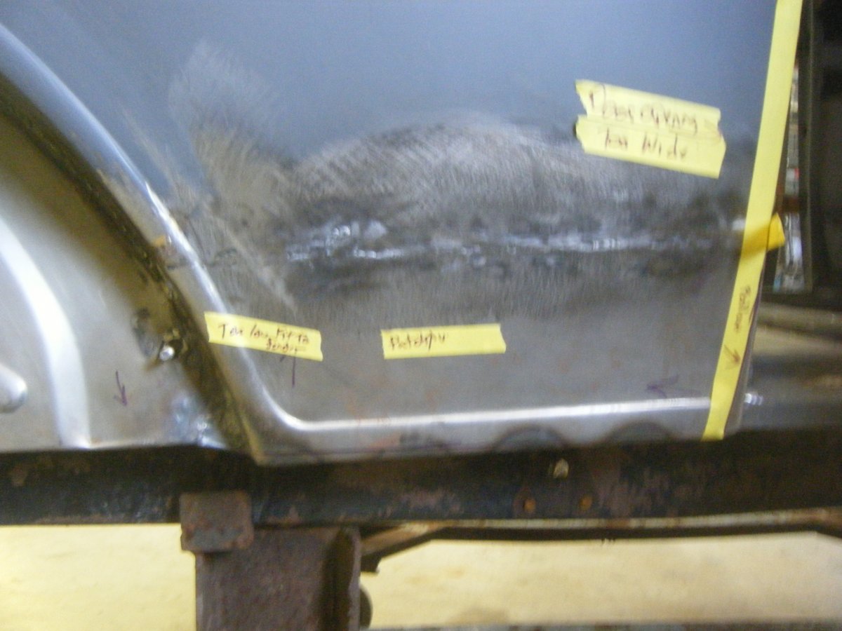

    It was finish painted early summer 2017, from there it went straight to the interior shop for the works. I picked it up from the interior shop in August to correct a few issues.
    Not starting and throttle

  10. This was the first time I saw the truck
    After that
    ,,,, well This is the next time he saw the truck
    I felt really bad for the guy.
    Imagine Spend 10 years trying and fighting to get it done,,,in three different shops over those years. Then it's finally together but just for a few months and all a parts again.
    I asked him for the paint code because I wanted to paint some of the smaller chassis parts body color. He said well "I'll just bring you the paint, I bought 2 gallons of it and have some left" Now check out the date when it was mixed. Bought and Mixed in anticipation of using it at the second shop. 3/31/2010. This can was finally opened in 2017 at the third shop.
