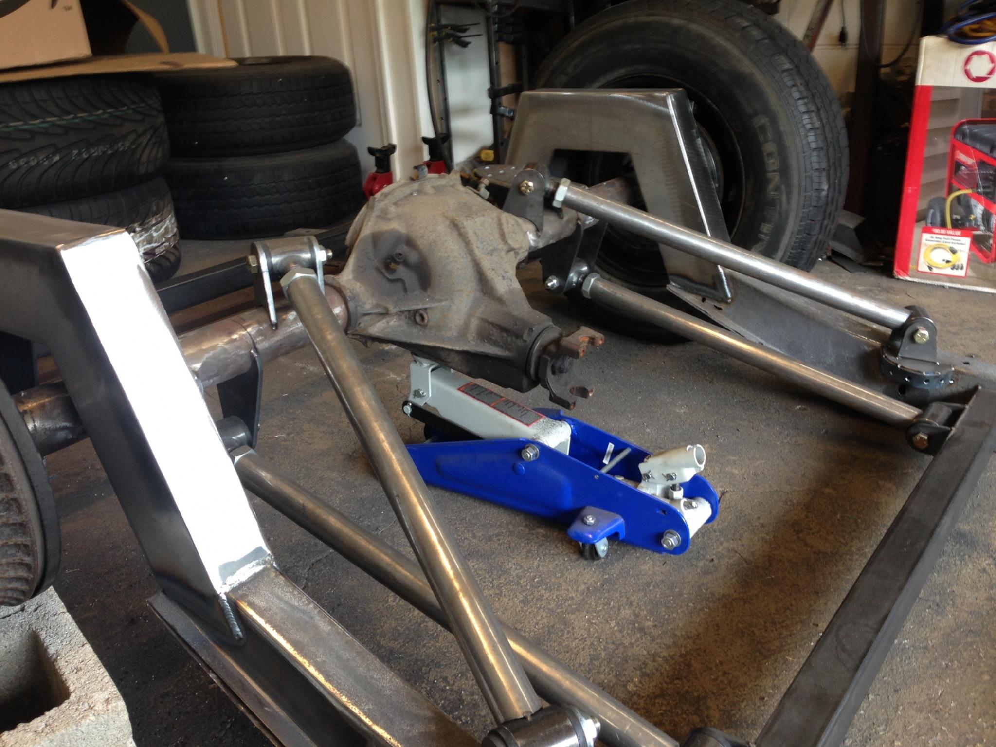

    How in the fudge are u guys running triangulated 4 link in the back of these cars?!? We have trie every which way to make this work but for proper triangulated link geometry it is physically impossible unless u put them way up high in the back seat? When i lay the car out now the rear end shifts forward about a inch that was with setting it up for ride height at 5 inches?!?! I guess im gonna have to run a parallel 4 link with a track bar since i value the back seat just curious how everyones makin theirs work?

    see thats the issue for the upper bars to be where they need to be to be within the correct geometry they would sit taller then the back seat? is everyone just ignoring that and making the best of it? I havent really seen any setups of people running the link a diffrent way. My frame is also sectioned and its setup to run a 28.5" tire is that maybe the issue im having?

    You appear to be dead-on with the setup. I make mini-tunnels over the upper arms. The rear seat is going to need substantial mods anyway. The tunnel is going to cut it about in half.
    I am assuming you cut the "dip" off the bottom of the frame, so you can lay rocker. That means that the engine and transmission are going to need to go up, making the whole tunnel firewall to bulkhead, just that much taller, since the stock k-member was under the frame. By the time you are done with the rear seat mods, you might have two bucket seats. That will be the case with a parallel 4-link, too.

    Now that I have stared at the picture a little longer, do you have the longer links on the top?

    If you want the pinion angle to remain the same throughout the full suspension cycle, all of the joints on the axle need to be on the same plane, and all of the joints on the frame need to be on the same plane, too.
    When viewed from the side, they would appear to have the same length. When viewed from above, the uppers are much longer.
    The upper and lower bars need to be parallel, when viewed from the side. However far apart they are, height wise, at the axle, they must also be so, at the frame.

    the correct way is that the lowers should be a little bit longer then the uppers and the pitch of the uppers should be greater then what u have at the rear end so the spacing should be larger at the front of the link then the rear according to all great suspension gurus. I belive there should be a 2" diffrence in the length of the bars if i remember correctly. I guess its one of those depending on who u ask deals but from the guy here at the local shop that builds all the magazine feature cars and trucks the lower bar at ride height should be level with the ground and the uppers elevated at the front of the link. I see what ur saying though wish i had a concret answer here... but after redoing the upper mount over and over again i just dont think its gonna pan out

    Unless you maintain parallesim, your pinion angle is going to change substantially during suspension cycling. Not making this up. I've got 25+ years in suspension. Some pinion angle change is workable, but an excess is not.
    Having the upper bars run uphill toward the front of the car puts the instant-center behind the rear axle. If you are building for pinion angle, they must be parallel, and equal in lateral run, infinite instant-center. If you are building for performance traction, the instant center needs to be ahead of the axle. Not saying what you have won't work, but what you have been told is far from ideal.

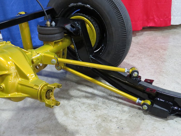

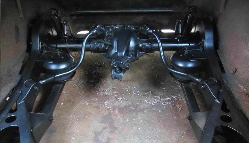

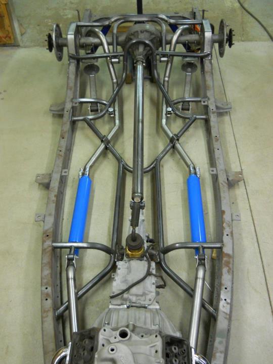

    1. Northwest HAMBers
    here is a picture I took of Gambino's last weekend. notice how the upper bars are placed lower on the rearend
    Here is a picture off a Morrison chassis

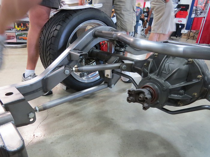

    found a picture from last yrs GG show where Gambino had a chassis and body with the 4 link installed. this one looks to have the upper bar sit alittle higher than how he is building them today.
