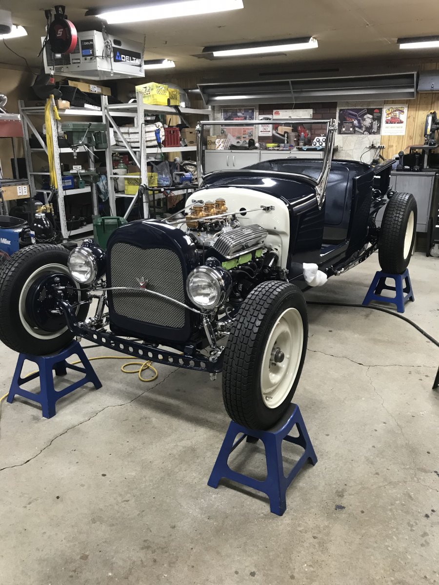

  1. You see how "right" holes look on this one or that one when built with some attitude. 48270329-9494-489B-B344-30F47EC1BC74_zpsrv741tau.jpg 10993091_942633859080071_6606355771179638702_n.jpg 20190531_164537.jpg

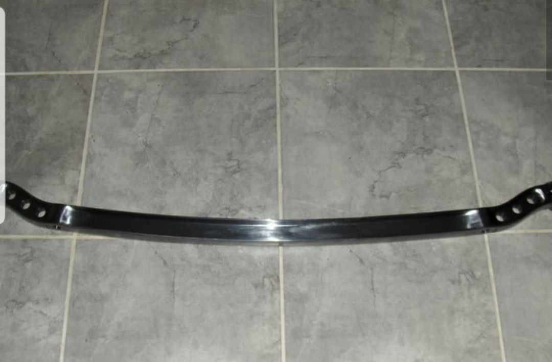

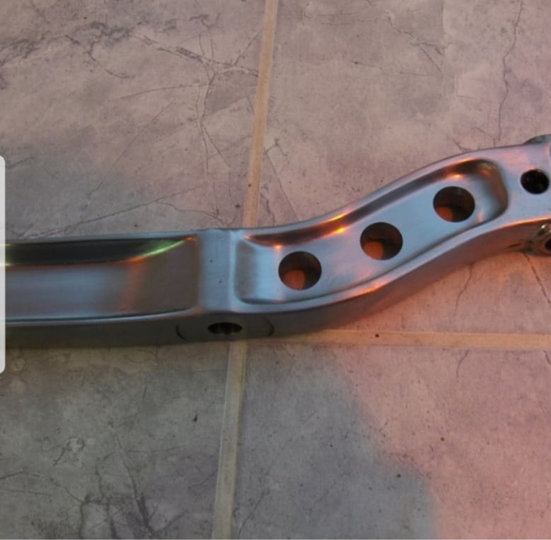

  12. The ends on mine, are drilled. I didn't want it all holed up. I like it, like this. 117Harv's work. Best polisher on the HAMB. I only polish knobs. :) Well ... one anyway. :D
    Top is polished, and drilled. Bottom is finished polished ... Gibbs oiled.

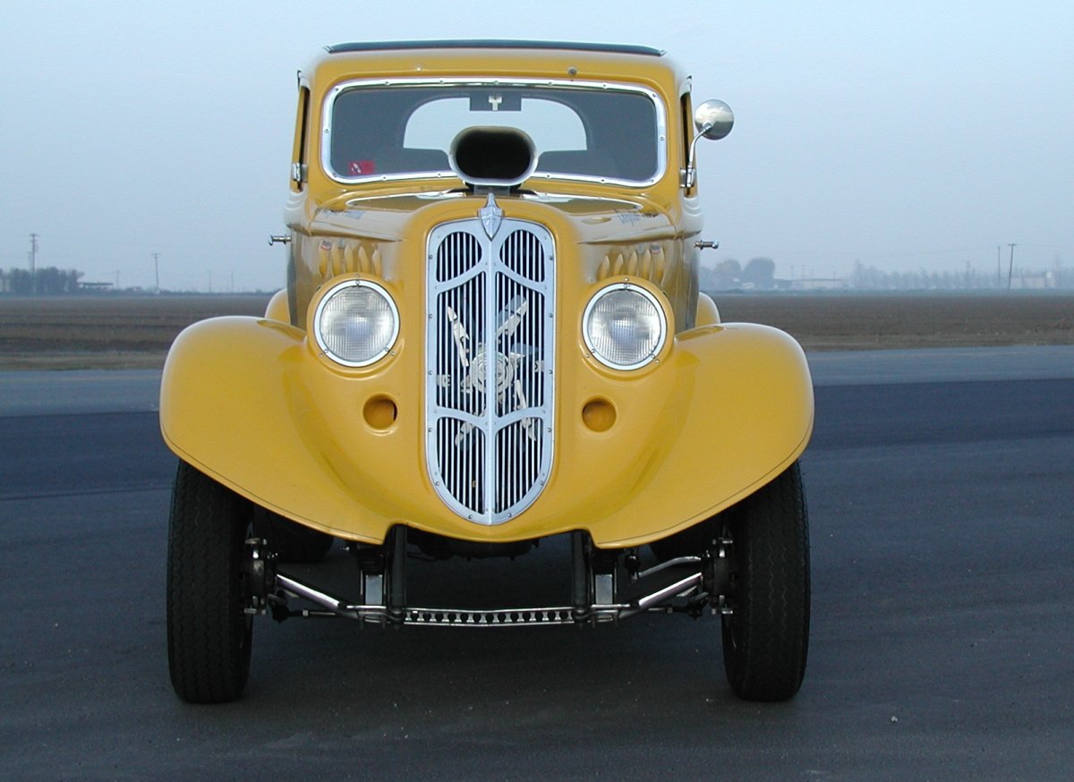

  22. @flamedabone ... HOLY SHIT !! I love it.
