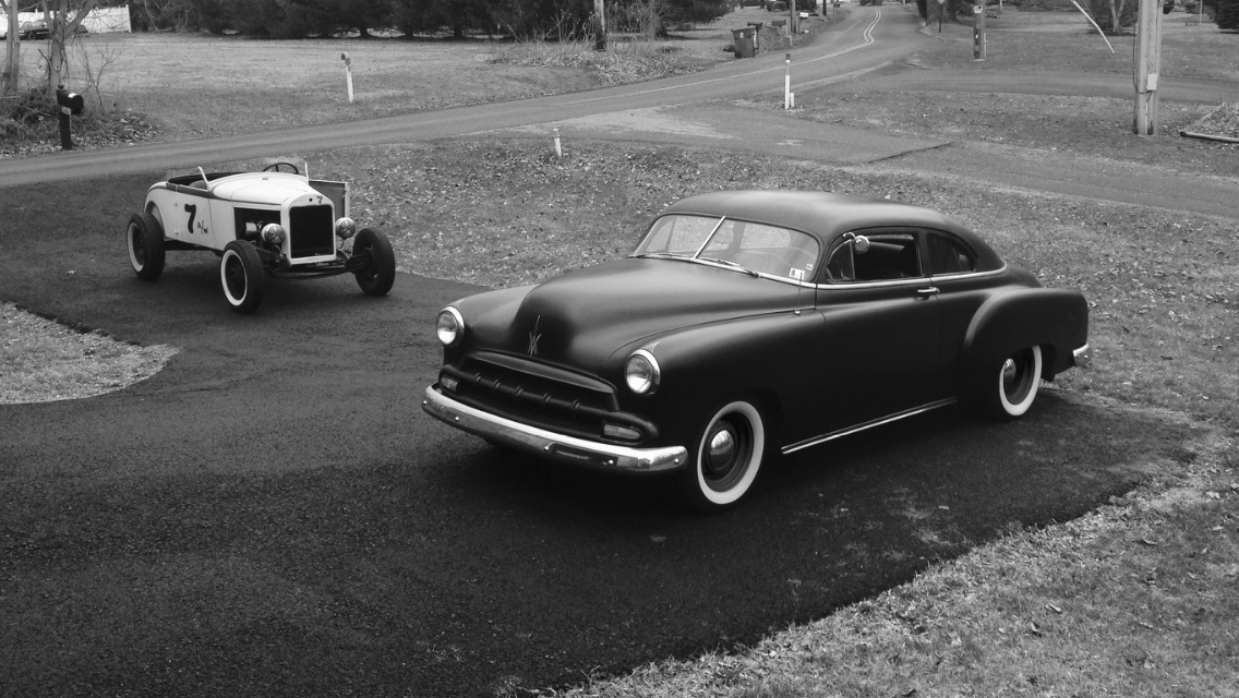

    securedownload-1-1.jpeg This is my daughters 53 Bel Air, 2dr sedan, I did this about 2 years ago. it was a fun project to do for her, but the Bel Air I have now is a hardtop, way different from this and the one on you tube, I do appreciate the suggestion though. I KNOW there has to be a pictorial somewhere. IMAG0177.jpg

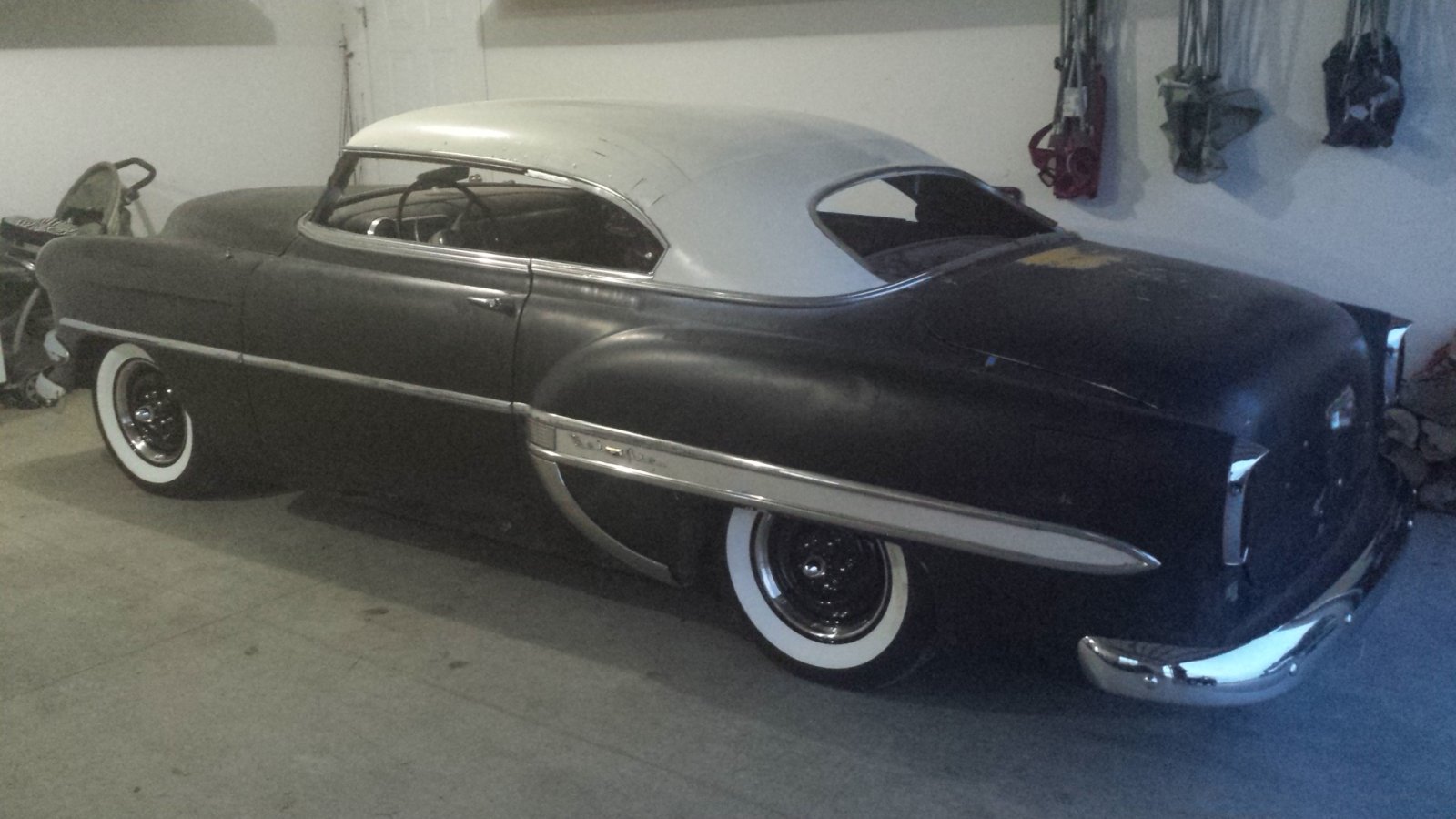

    I'll play.....our situations are similar. I had a 53 sedan prior to my 54 hardtop. I too had chopped the sedan and you are right that the hardtop is a different animal. My car also was rusted badly at the drip rails. I did extensive work to repair and retain them. I hadn't originally planned to chop it, but since I did so much other grinding and welding on the roof I thought why not a little more. Proportionally, mine is inspired by Moonglow but with a different twist on the rear window. I've got a thread going on the progress of the chop and here are some current pictures:
    So very glad I decided to cut it. 20150605_203450.jpg 20150605_170913.jpg 20150605_170855.jpg 20150605_203432.jpg

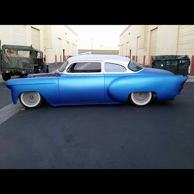

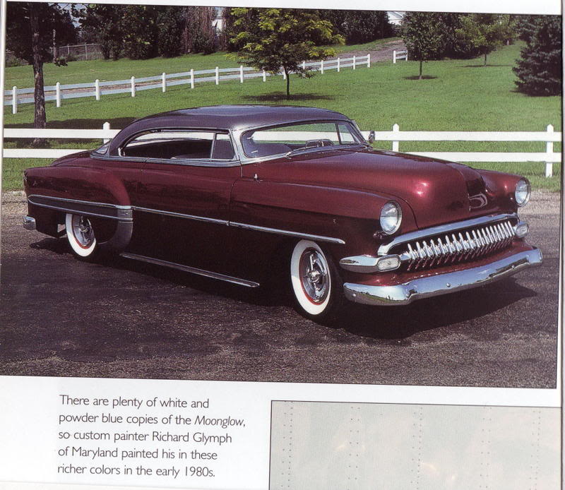

    Another thing has become apparent to me. with this side view of the Moonglow, , I notice that there appears to be a slight "bubble" effect at the top of the rear window, I think maybe the rear window needs to be slightly raised at the front and the sheet metal roof slightly de crowned to make a smooth top loft. I am NOT complaining in any way. just an observation.
    also
    another question arises with this view, the rear window upper channel is 'ahead' of the front door glass. so what happens? does the door glass get cut in a "slanted B post" effect? and if the front glass is cut at that angle what happens to the rear? it will have to get cut at the same angle and all the glass frames will have to be modified to that same angle. will the rear glass then be able to roll down? And if it does roll down, won't the part that is added and makes up the forward slant be above the window garnish molding?
    Why can I not find pics of any of the 53/54 hardtop chops with glass rolled up? (probably not looking in the right spot) I am pretty sure that IF there are any of the glass rolled up pics available, someone here will be happy to show me.
    These are the kind of questions I would like to have answers to before I start any cutting this car up...... 1954-moonglow-chevy-bel-air-passenger-side-1.jpg

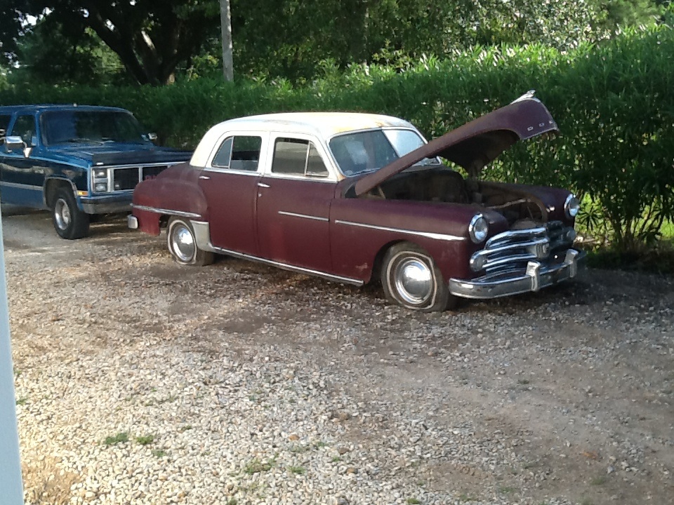

    I chopped my 52 Chevy and took a bunch of photos if it helps at all... I don't know how to put up my thread though. I think it's called "chopping a 52 Chevy". You can find it I'm sure. I also experimented with sinking the windshield on it. Good luck, it's worth the work... I love how mine turned out. image.jpg

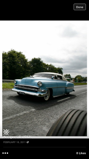

  28. ImageUploadedByH.A.M.B.1436148625.184157.jpg ImageUploadedByH.A.M.B.1436148651.140721.jpg ImageUploadedByH.A.M.B.1436148677.187030.jpg ImageUploadedByH.A.M.B.1436148698.030421.jpg ImageUploadedByH.A.M.B.1436148723.912453.jpg ImageUploadedByH.A.M.B.1436148741.835907.jpg ImageUploadedByH.A.M.B.1436148758.210903.jpg
    This car was built in Virginia by my Dad in the mid 90s. Chopped it and 56 Packard tail lights. It was sold and is now in Holland. The copper color was applied by new owner but he left the body just like we built it. I recently been in contact with him and he was happy to get pics of the build.
