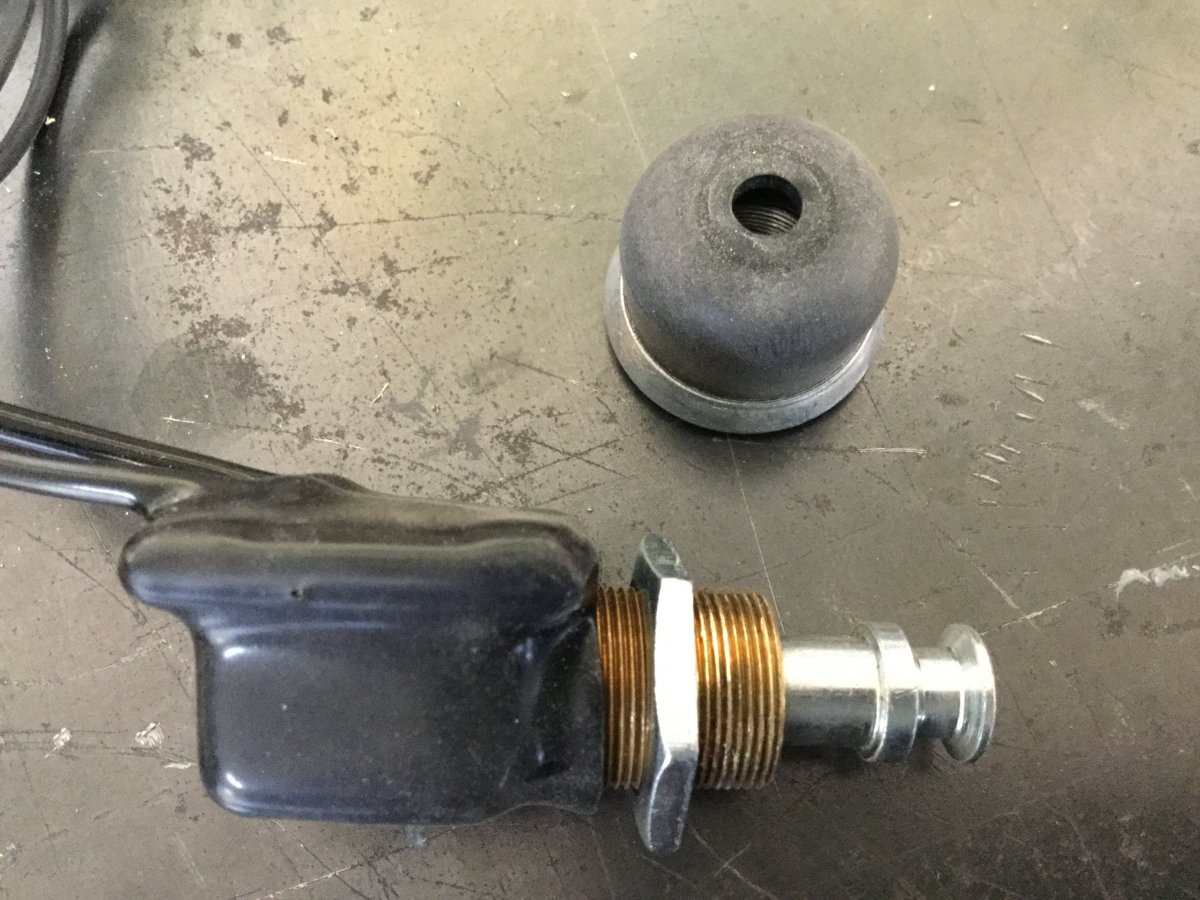

    Since the MC is mounted under the truck, I made a bracket to mount this waterproof switch to the frame. IMG_0378.JPG

    That's a nice switch !! What's the application ?
