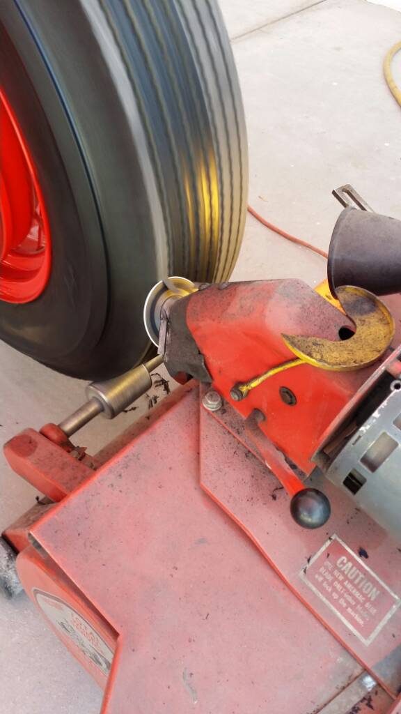

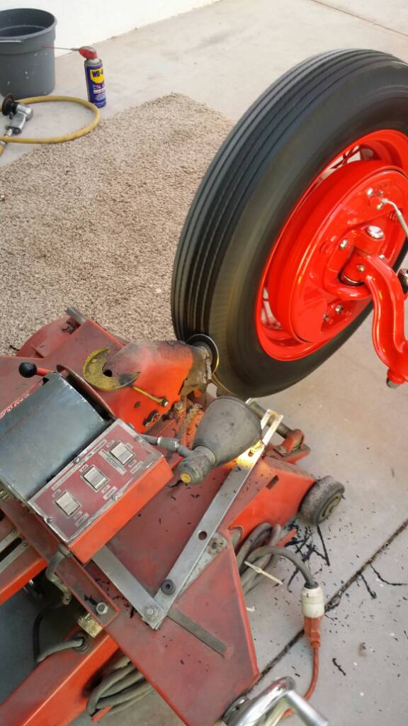

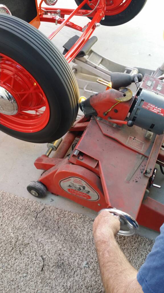

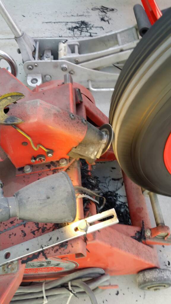

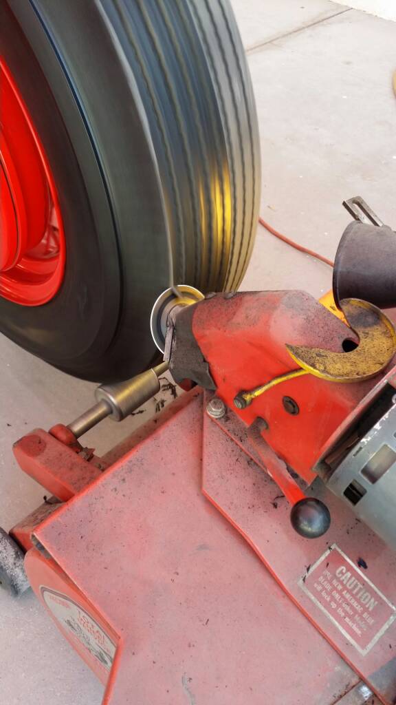

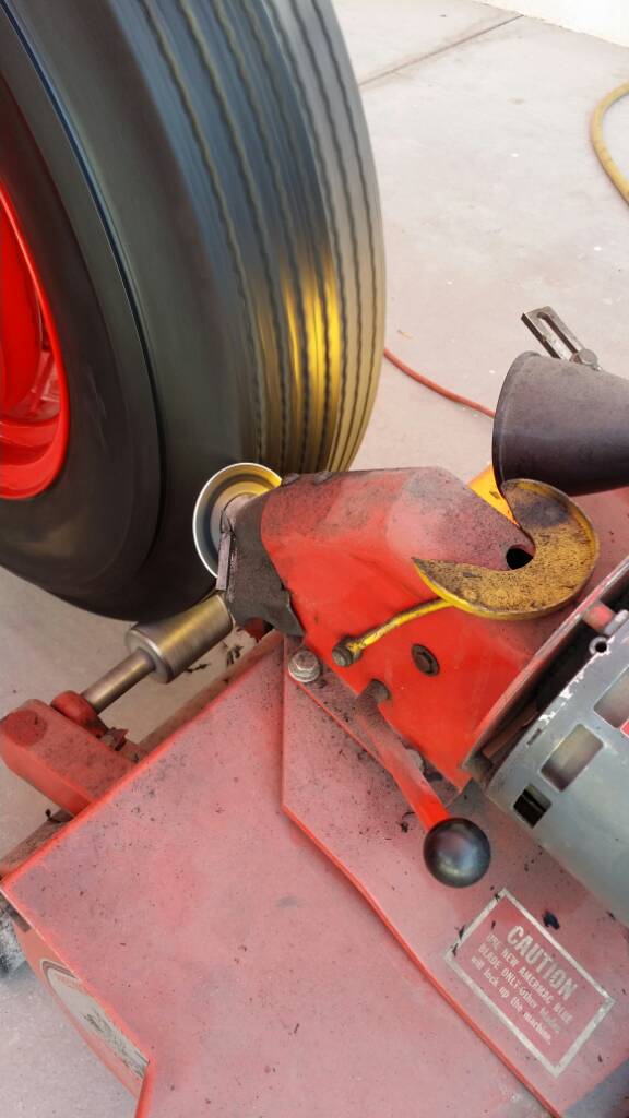

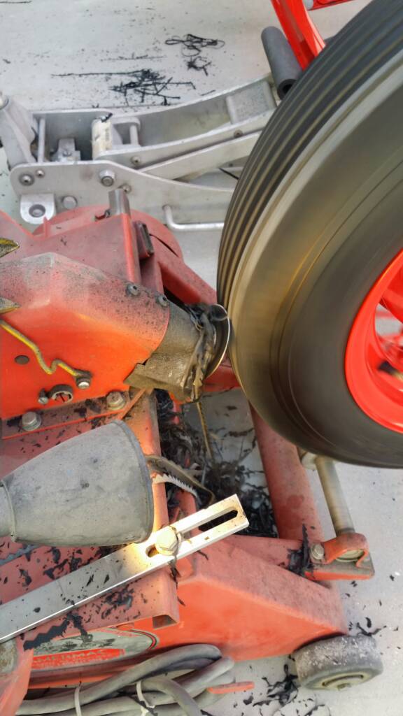

    Took the Modified to the tire shaver today, he said the tires were in good shape, rubber still soft, no noticeable flat spotting.
    Just not round!
    It didn't take long to shave them and didn't have to remove alot of rubber.
    I have 3 oz. DynaBeads in the fronts and 5 oz. in the rears.
    Ran the car up to 80 mph. and was smooth up to 65-70 then a little scary!
    Sooooo much better than it was and it got rid if the annoying hopping in the rear. I am pleased!
    Now to play with tire pressures to try to soften the ride some. I don't think a 1600# car needs 30# of air in the tires. 20180901_090335.jpeg 20180901_090439.jpeg 20180901_091355.jpeg 20180901_091401.jpeg 20180901_094111.jpeg 20180901_094113.jpeg 20180901_094119.jpeg
    Sent from my SM-N900V using The H.A.M.B. mobile app

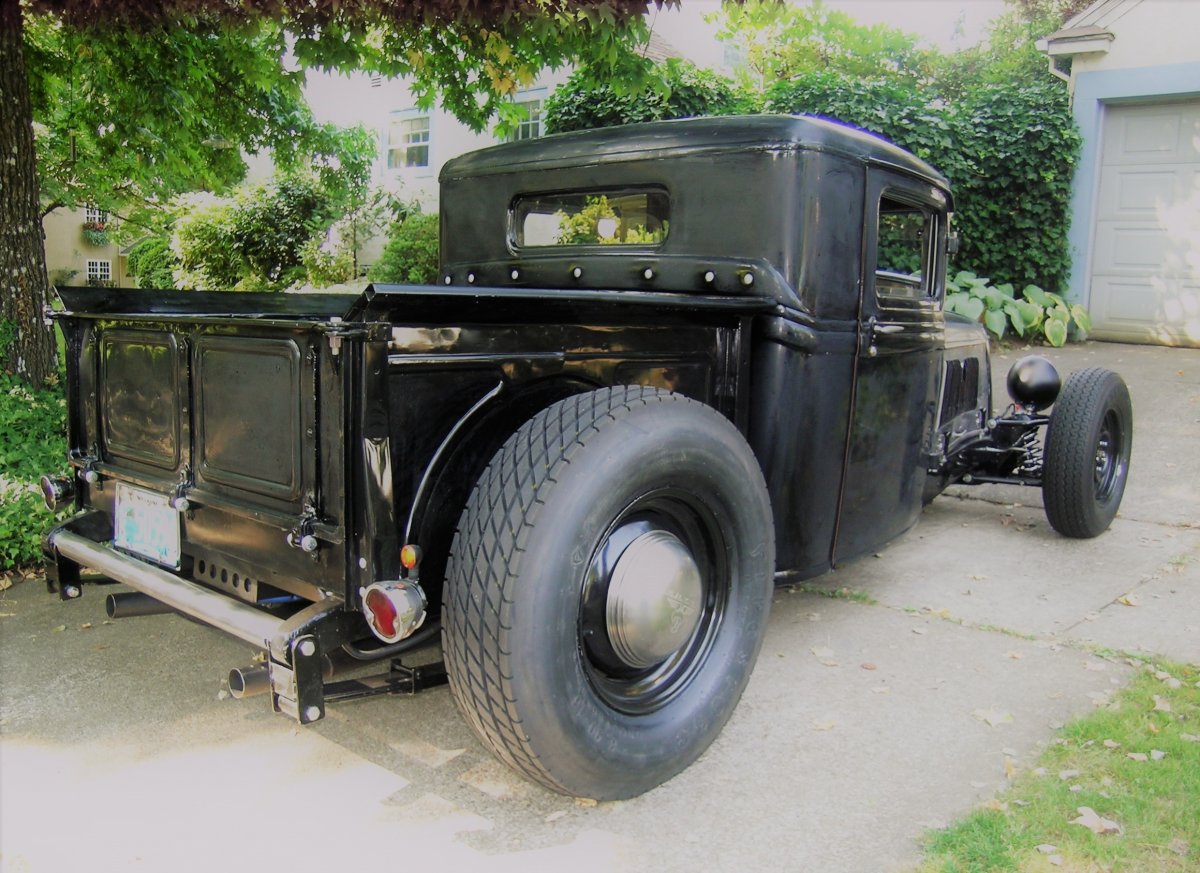

  20. DennieC
    Joined: Jul 25, 2018
    Posts: 38
    DennieC
    I bought my Firestones mounted and balanced on steel wheels from Coker and they also shook the front end at about 65 to 70 mph. A local rebalance solved that problem. The rear tires on my light weight 34 Ford P/U have been an ongoing problem per transmitting bump shocks to the people in the car. I tried different shock absorbers and went to softer parallel springs with no great effect. I have concluded that the ratio between the sprung weight and unsprung weight is such that the inertia of heavy tires and the heavy Ford rear end moving up over a bump cannot be totally absorbed by shocks and springs and the rear of the car jumps. If the car was heavier that would help but I want my car as light as possible. I finally sold my Firestones and another set of wheels and tires and got a set of Excelsior radials (for a few dollars more) DSCN1976 (3).jpg which give a softer ride and get around corners better.
    dwollam, GuyW and modified like this.
  21. modified
    Joined: Sep 21, 2006
    Posts: 326
    modified
    Nice pickup!
