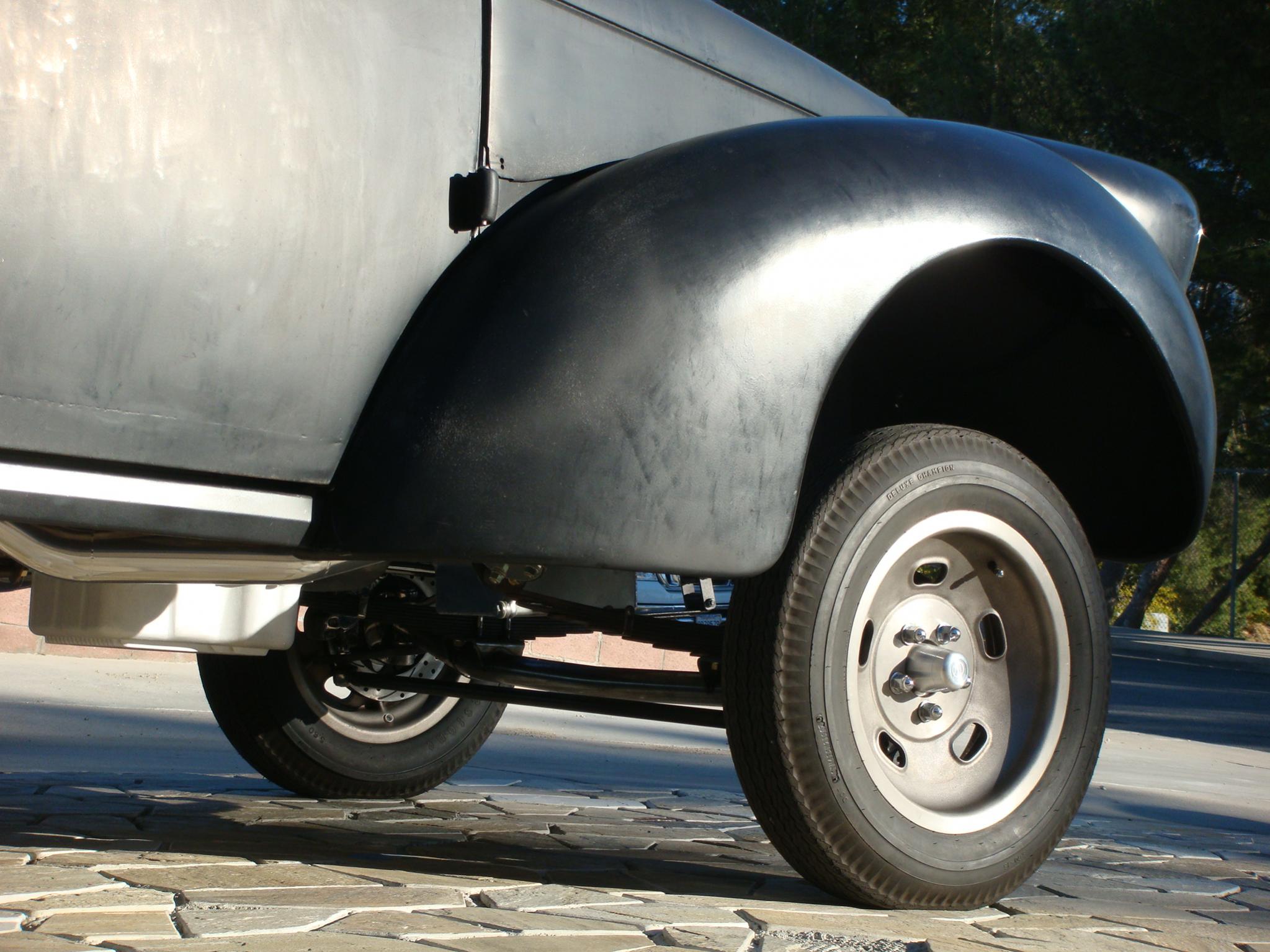

    What size front rims would be my best bet for my gasser? 14", 15" or 16" I have 16" with 500/16 on it right now.

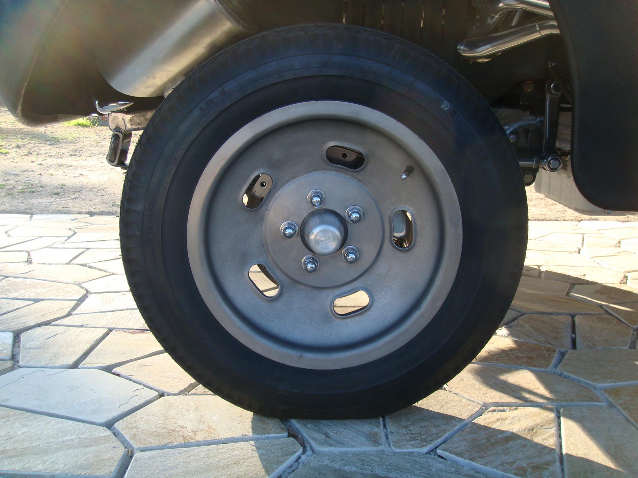

  5. Wheels: 15" x 3-1/2" or 4"
    Tires: 165R15

    165's are kinda big, 145's are a much, much better fit on a 4" wheel.

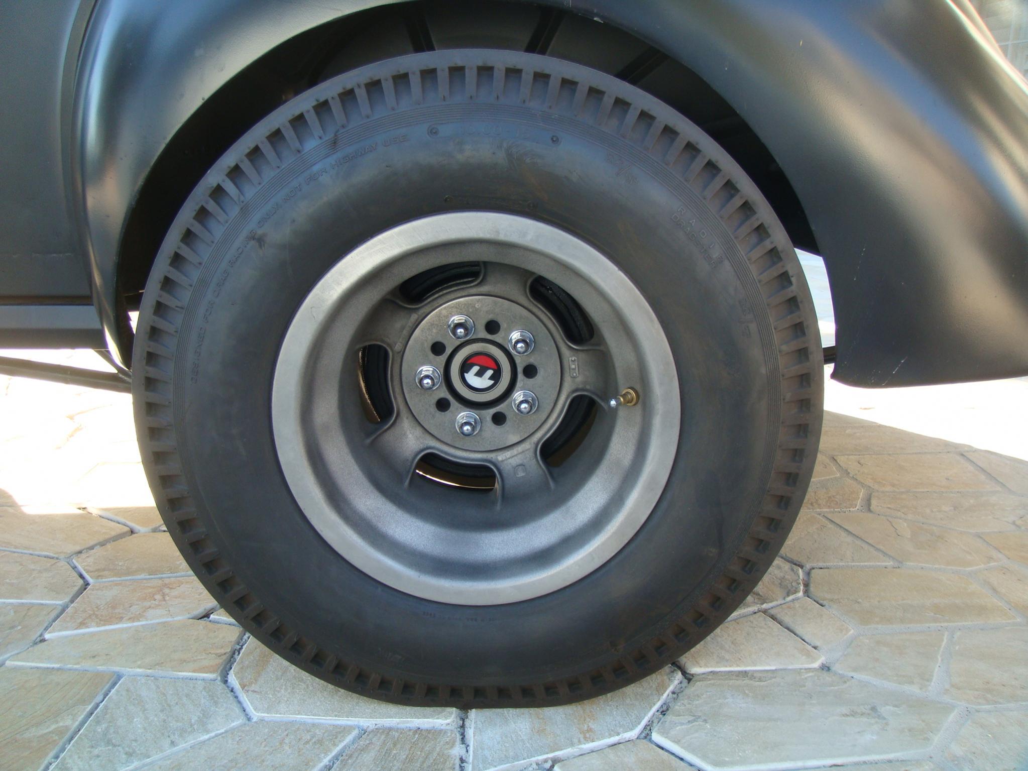

    The best size and the best tires to buy are 5.60 x 15 Firestones from Coker Tire.
    Don't buy recaps they will come apart one you and they will never balance.
    Radir wheels has brand new vintage pie crust tires.
    They are made by M/T for Radir. Check out the attached photos.
    They are the best!!!

    Wow great info. Thanks for the responses. Kmember I will be checking with Cody but I am trying to determine what to pick up some rims.

    I plan on running it to close by local shows, with trips to Nostalgic events. It's is only going to get a 8 gallon tank, combined with 4.11 4 speed and the built olds it will definately be a fun ride.

    165 is actually closer to 6.50" wide while a 145 is close to 5.60" When I switched from 5.6's to radials, the 145's were nearly exactly the same size, which is why I now run them to achieve the same look.
