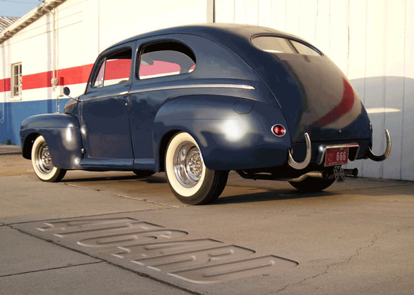

    5.50 or 5.90 for the front, and 7.00 firestone bias piecrust with chrome reverse would look awsome! THis pic comes to mind.
