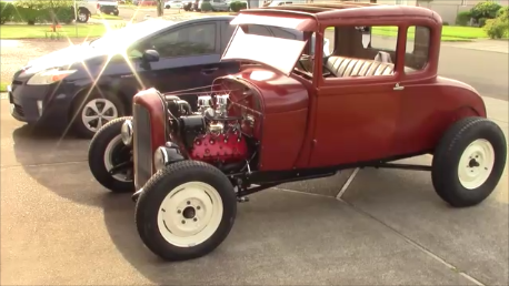

    I have just fitted a set of Excelsior Stahl Radail tires to my Model A coupe,this has made a unbelievable improvement to the handling ,
    the car weighs around 2600 lbs,
    Running 6:50-16 on the front and 7:50-16 on the rear
    I can't find any tire pressure recommendations,so I'm asking if anyone running a similar deal,what pressure front and rear are you running
