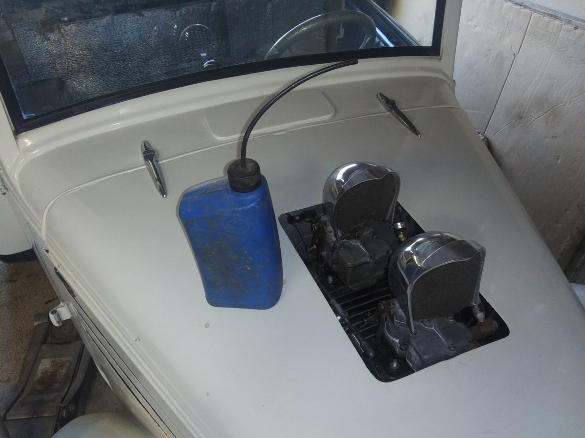

  29. Harv
    Joined: Jan 16, 2008
    Posts: 994
    Harv
    from Sydney
    Only in Australia would this be an actual product... works damn well on dry float bowls :cool:
    Cheers,
    Harv
  30. 1940Willys
    Joined: Feb 3, 2011
    Posts: 804
    1940Willys
    On them Plastic squeeze bottles to prevent barometric pressure from weeping them empty. Just remove the tube that goes to the inside of the bottle. Invert the bottle to use.
