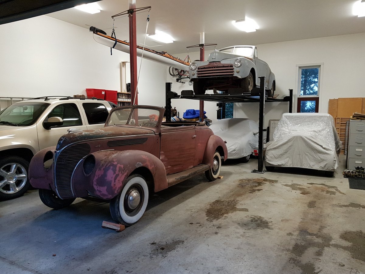

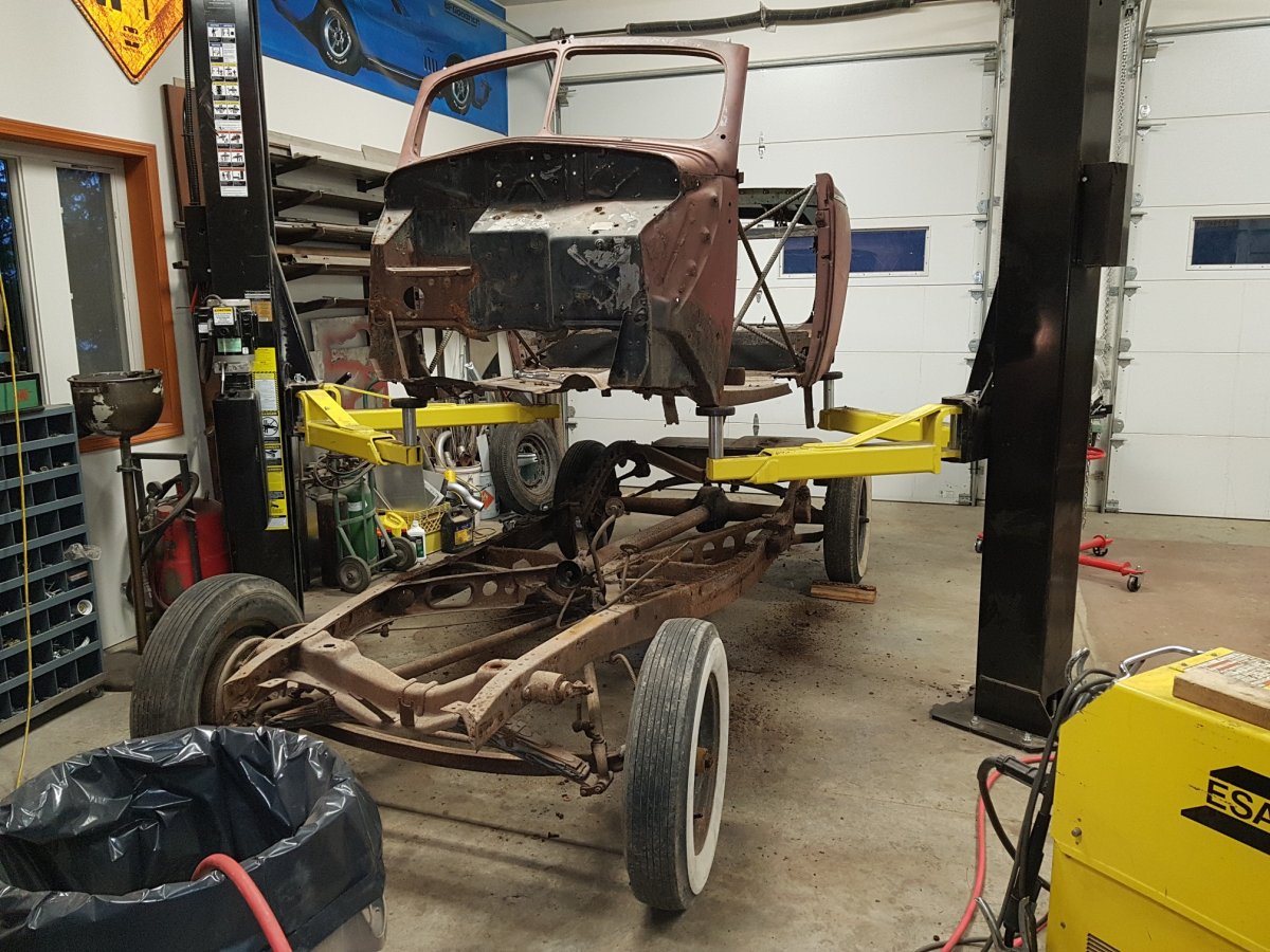

    I'll start with a picture of the car in the garage waiting its turn to get into my shop...and one of the photoshopped versions thanks to @themoose on the photoshop thread. 20180112_153646_resized.jpg

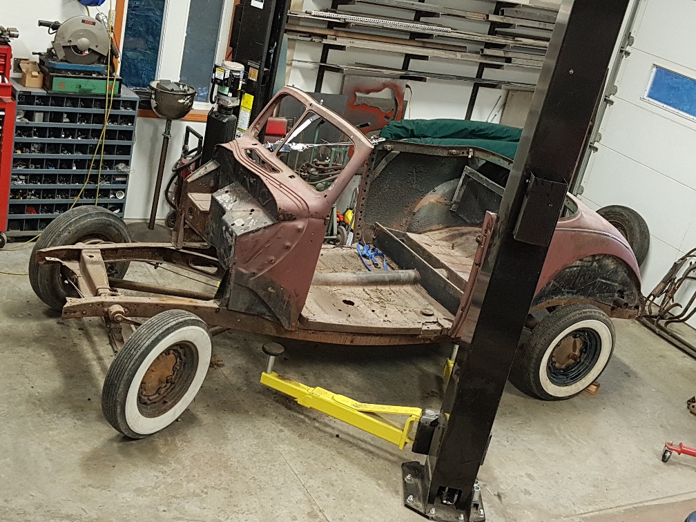

  2. Next, I need to say that my shop and house garage have about a 100 foot elevation difference with the shop being located down the hill. The car has no brakes and my wife was not sure of my genius plan. I figured, gravity would provide the rolling encouragement and my truck would provide the rolling discouragement, my wife would provide the directional inputs...what could go wrong?
    Fortunately, the plan worked...and my nervous though ever willing wife's worst fears did not come to fruition.
    Once in the shop...tear down began.
    and continued...
    Some bolts loosened, some broke, others were cut...but after a long day the body and chassis were separated. I should add here that before the body was separated I spent some time fitting up the doors and once they were right, I added body bracing (re-bar I had laying around) to hold the body secure as the floor was weak.
    Then the same fastener drill continued until the running gear and frame were completely separated. The bare frame was moved onto my frame table where a center line string was drawn. After much measuring, it was determined the center of the frame needed to be pushed an inch (or so) towards the passenger side. Out came the porto-power and chains...some time monitoring the center string, carefully measuring and pushing with the hydraulics until everything was where it should be...and then it was tacked solid to the table so it couldn't move.

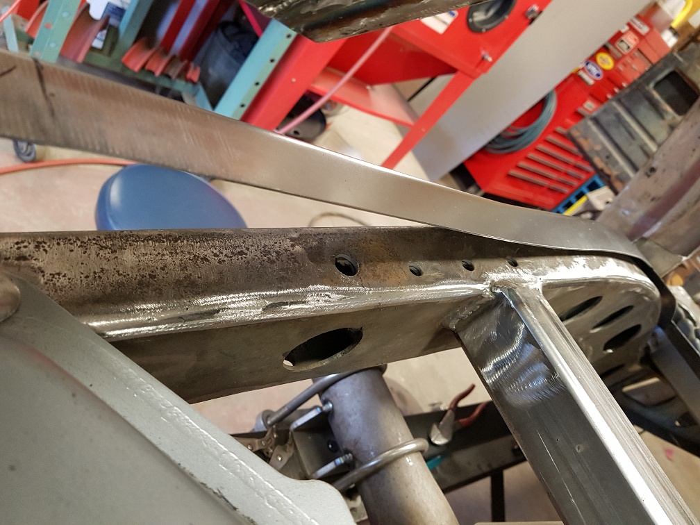

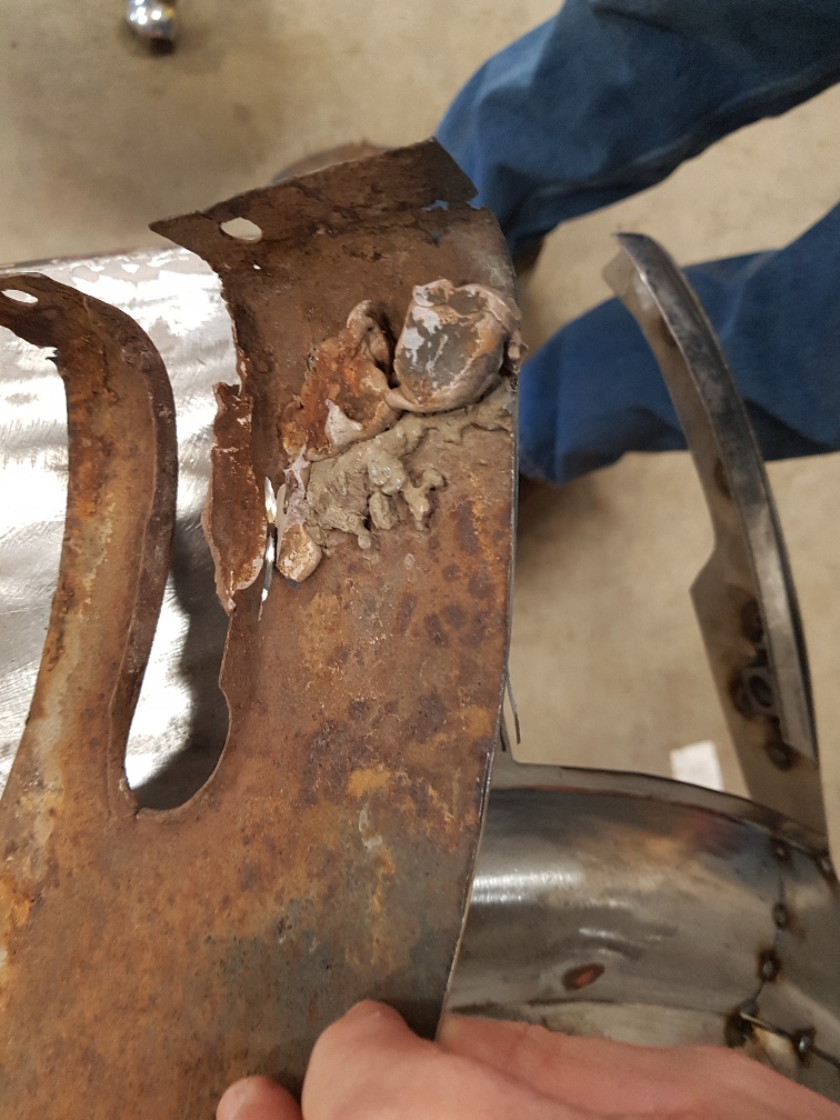

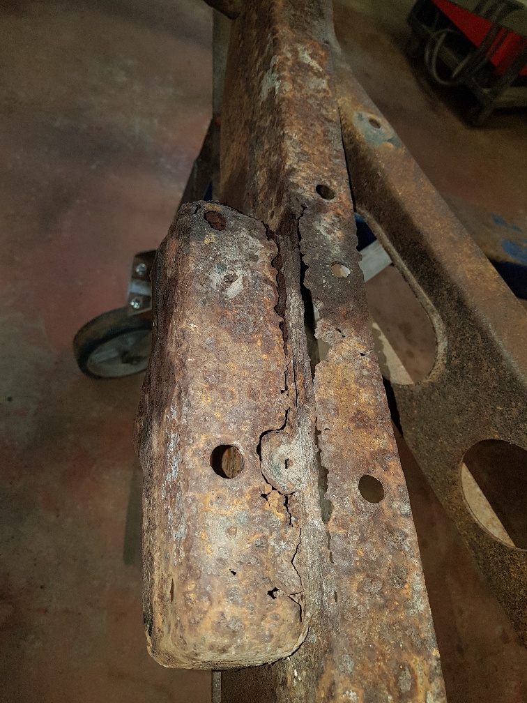

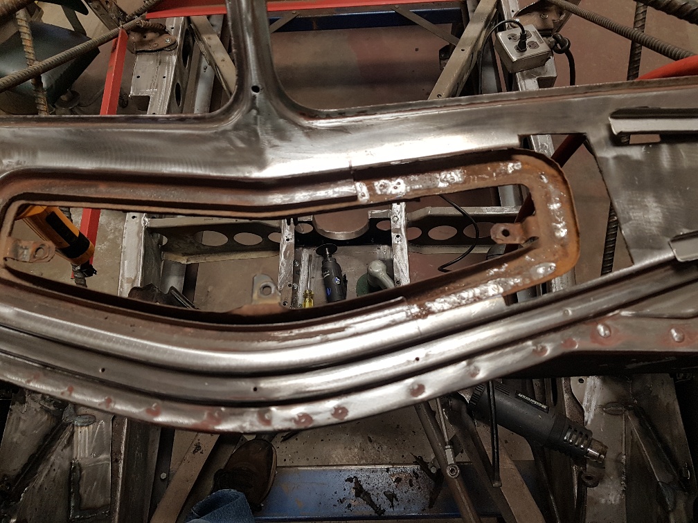

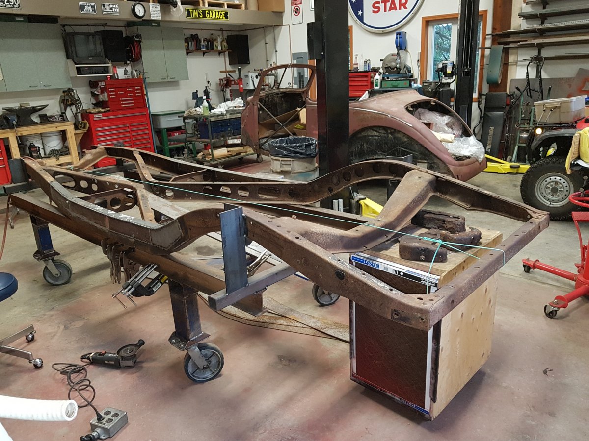

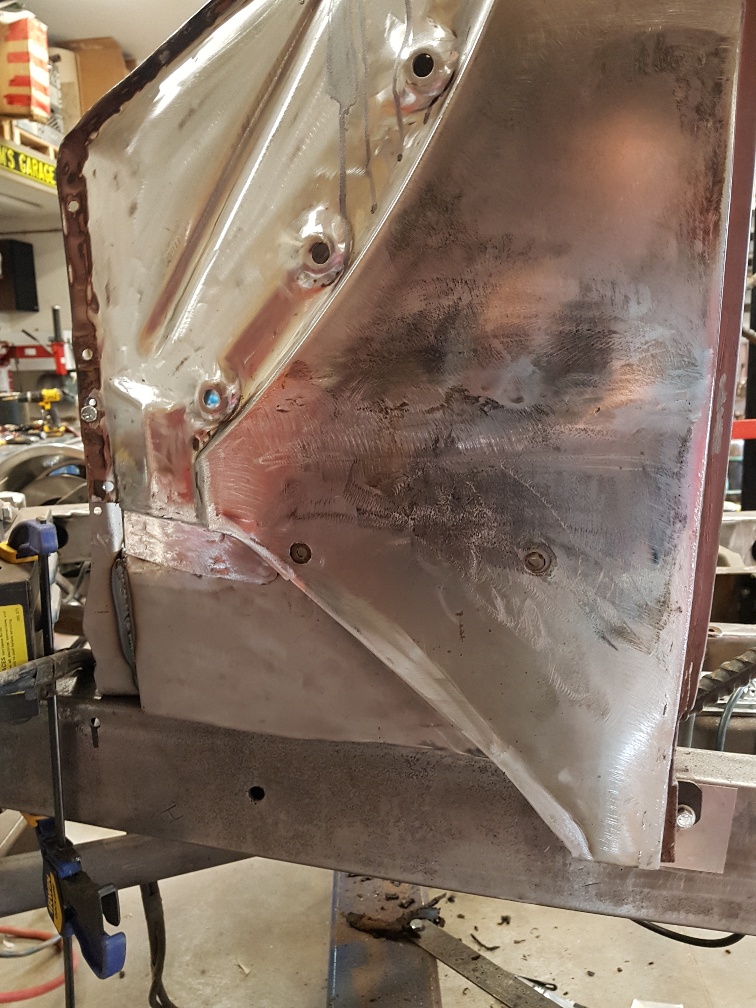

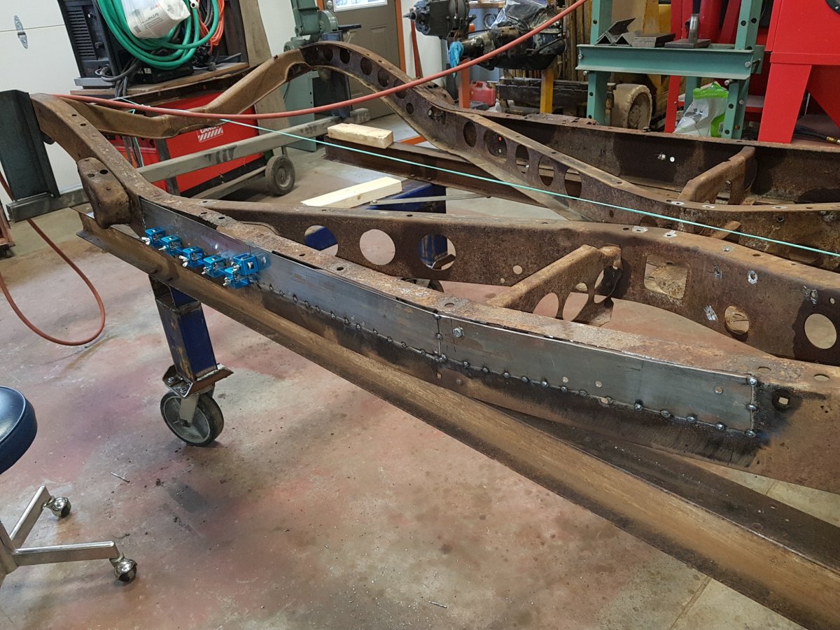

  3. Once everything was where it should be...time to assess what we're working with...it's a convertible...from mid Canada...so there was rust. These photos are the passenger side rail, but suffice to say the driver side was equally eaten away.
    So, small bites with the side rails being first, I determined where the good steel met the rusty steel, cut out sections of the the rusted steel, made new steel replacement patches and tacked them in place, repeat (noting that the center string remained in place for constant measurements to make sure nothing was moving with all the cutting and replacing going on). For ease, and to take advantage of steel I had in hand, I worked in relatively small sections. Once welded, it becomes all one piece.
    And then the top rail...weld solid, grind, blend, smooooooth and make repair invisible. Repeat on driver's side rail.
    20180127_162605_resized.jpg 20180127_164332_resized.jpg 20180128_140328_resized_1.jpg

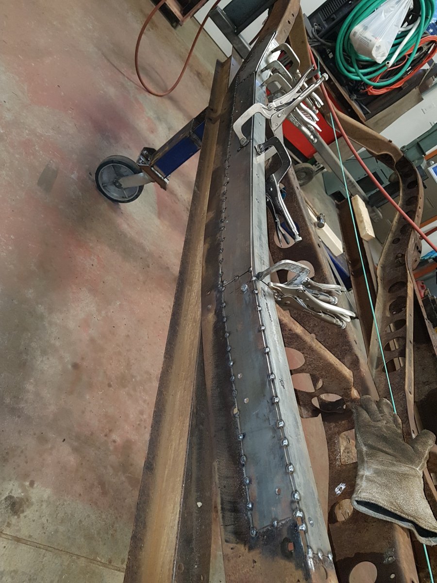

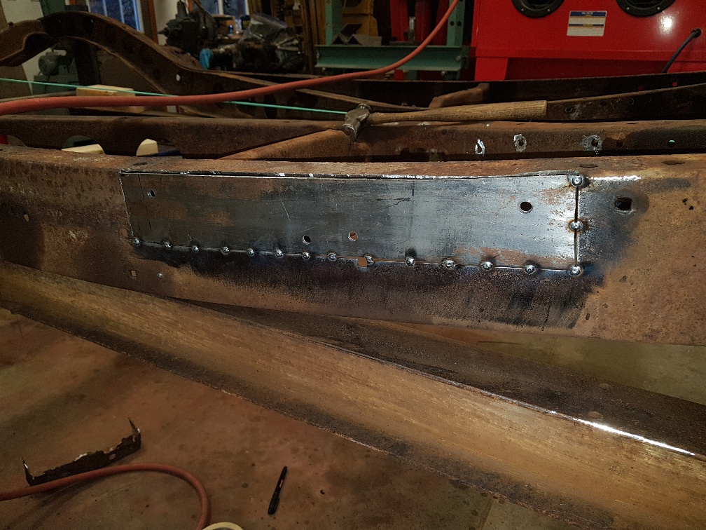

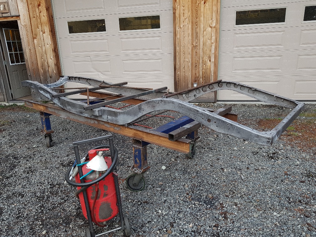

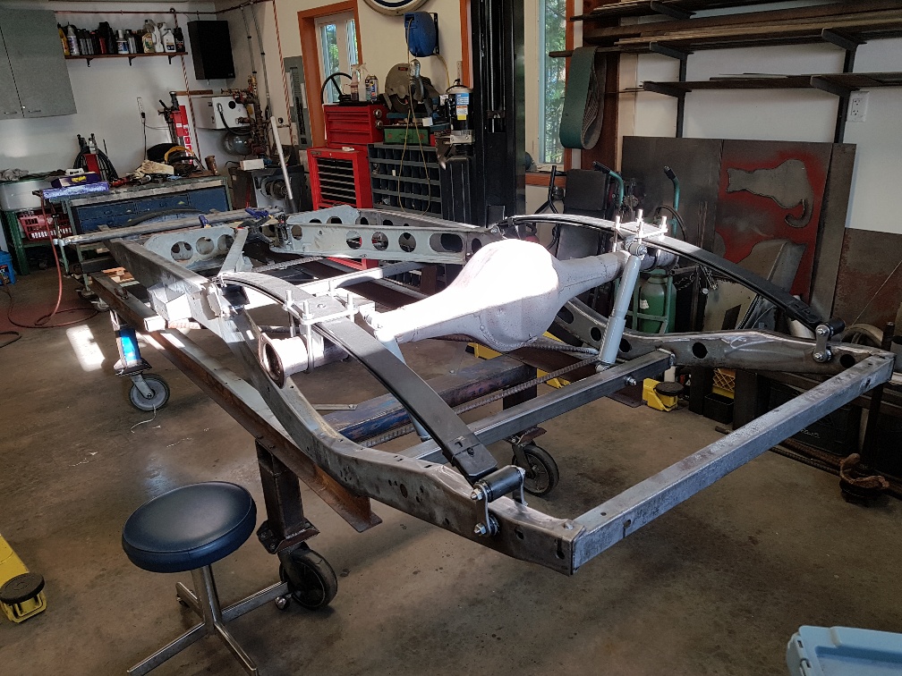

  8. Next up, I decided I wanted to box the entire length of the frame to help make it sturdy (given the convertible offers no body rigidity to speak of). I removed the center crossmember (with temporary frame bracing holding the same shape), and rolled it outside for a round with the HF sandblaster (dry compressed air and filtering the media through a screen when filling the unit helps to prevent these units from clogging).
    I whipped up some boxing plates with strategically placed access holes cut with my plasma cutter. To ease access for tacking the plates in place I broke the frame free of the table and positioned it for convenience (I hate welding upside down, overhead, or while laying down...I have the burns on my chest hair to attest...I am a girly man, I'm ok with that).
    Once the boxing plates were fully welded in place, the chassis was rolled onto it's back. The original crossmembers were trimmed to fit, welded in and the rear suspension/9" was put in place. This was the speedway rear leaf spring suspension kit, though strangely it came in TCI boxes and had TCI instructions. I didn't use the rear shackle mount that came in the kit. Instead I simply bored a hole in the frame/boxing plates and welded in a tube for the upper shackle bushing. For my friends and family back east, note the light and dark portions in the photo...see...we do indeed get sun in the Pacific Northwest! 20181230_124503_resized.jpg
    vtx1800, cactus1, bchctybob and 10 others like this.

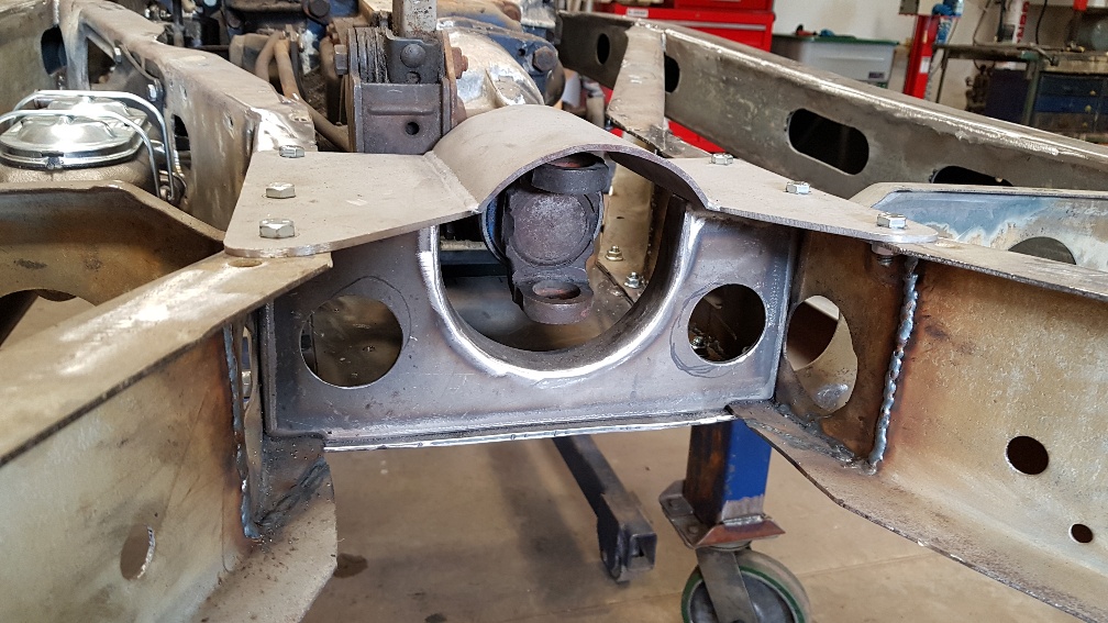

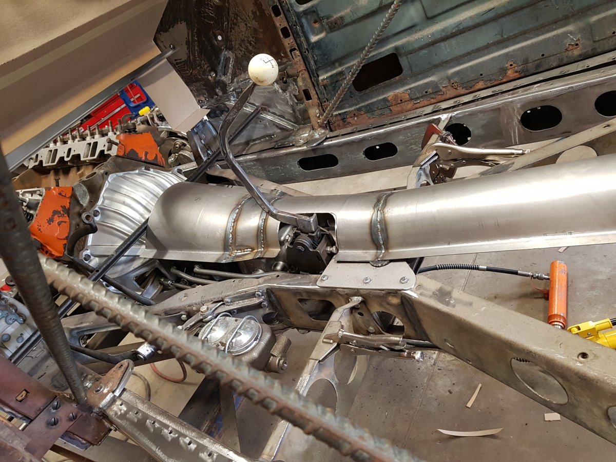

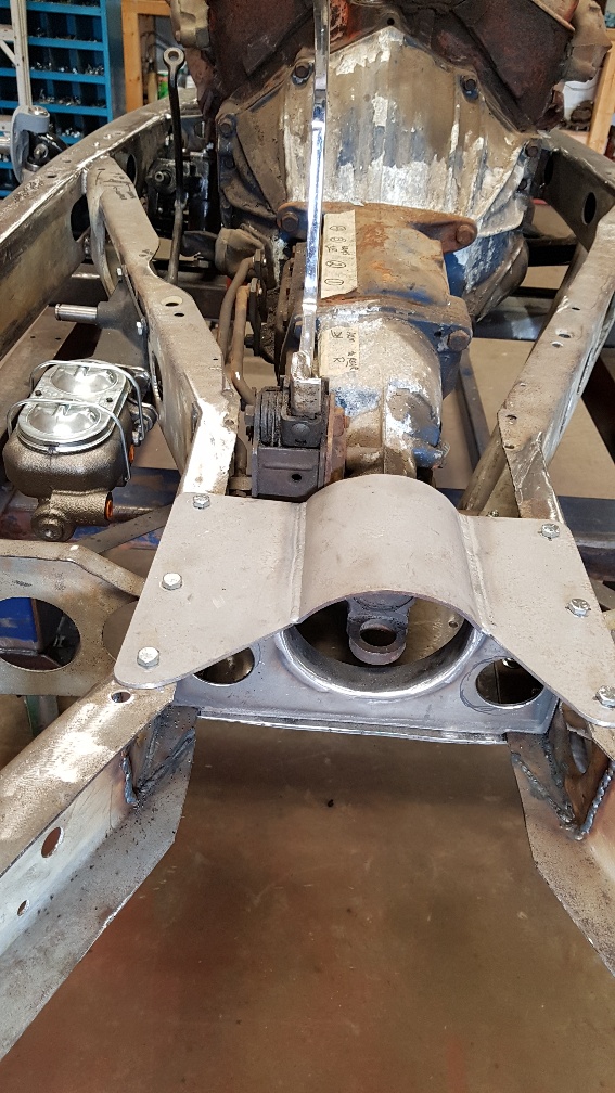

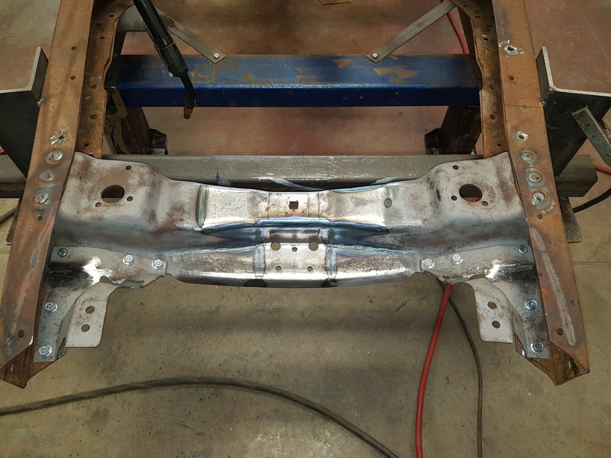

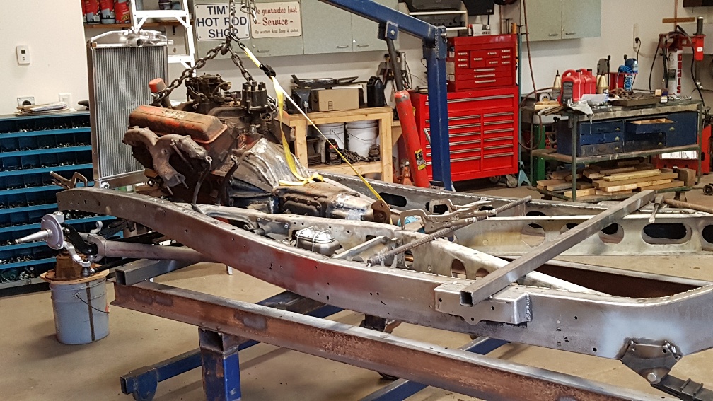

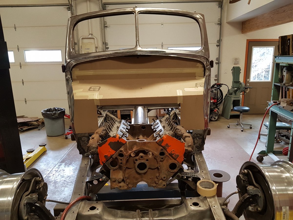

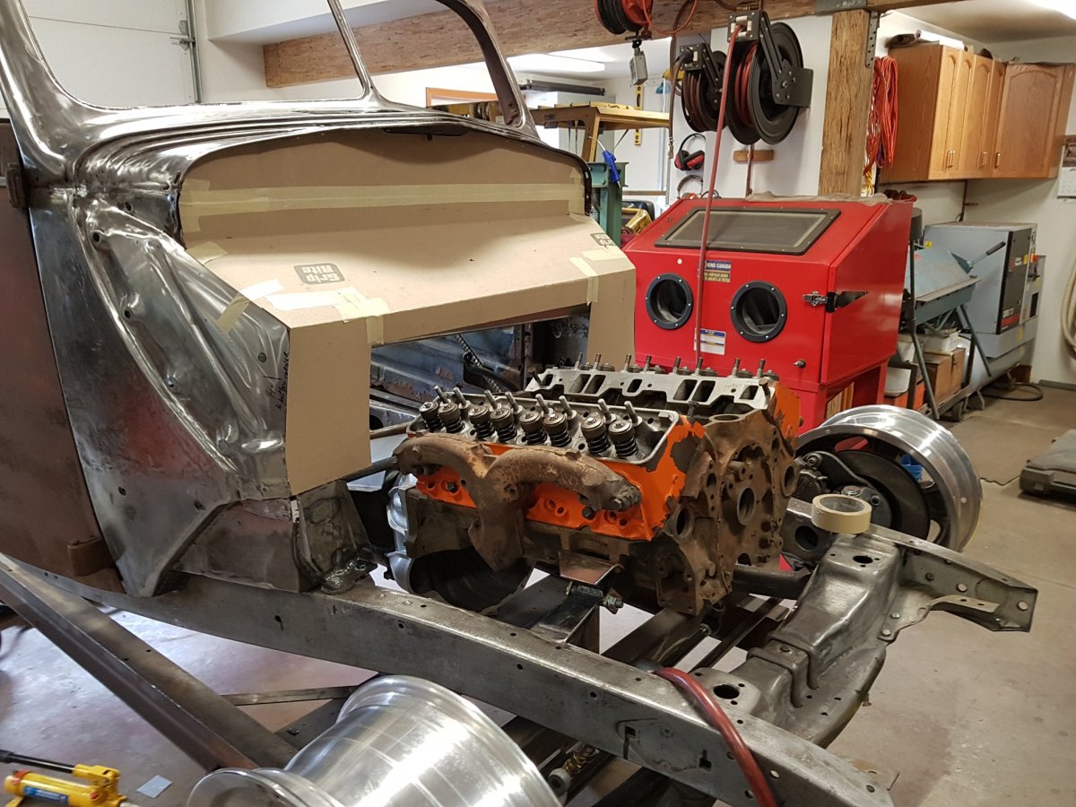

  10. Next up...locate engine and trans.
    Which helped me realize I was going to need more clearance in the center crossmember area. I wanted to use the steel from the original crossmember...it just needed some adjustment. I made the same changes to both sides, and of course, this meant I had to remake the plate that picked up the rear of the front split bones. I've never built a car that I didn't need to re-do something (and sometimes many things!) along the way). Lots of room now.
    This was when I realized that my axle had way too much positive camber on the driver side after being dropped. I used some box tube I had laying around and chain to strategically anchor the axle. I used a hydraulic jack and my angle finder to bring the camber back into spec. I hadn't done this before, so it was a learning experience...it's surprising how much "spring back" a forged axle has before it bends and stays. I put the kingpin in upside down so the jack had something to push against, without distorting the king pin boss. It also gave a good surface for the angle finder to rest against. (I've since purchased a digital angle finder...that old plastic gravity swinger got pretty close!)

    I'm not following how the blower box works. Does all the bad stuff end up inside the box somehow?

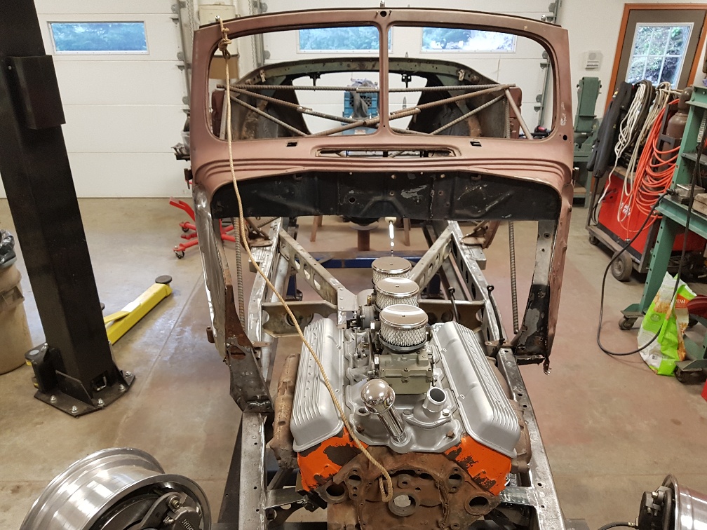

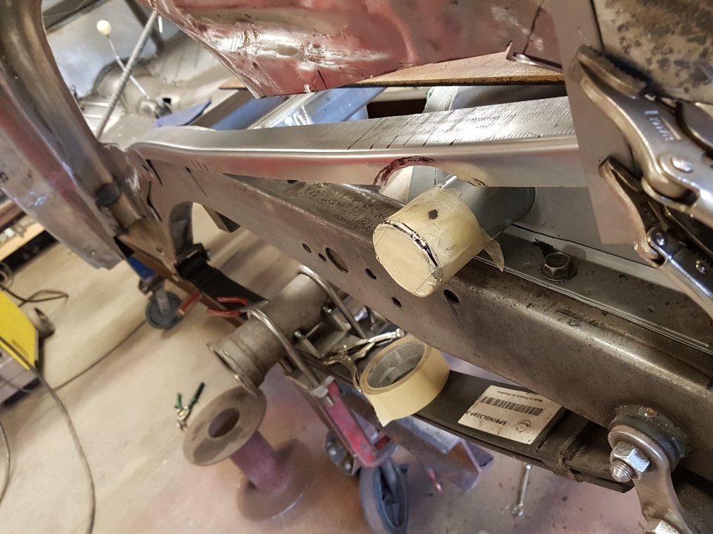

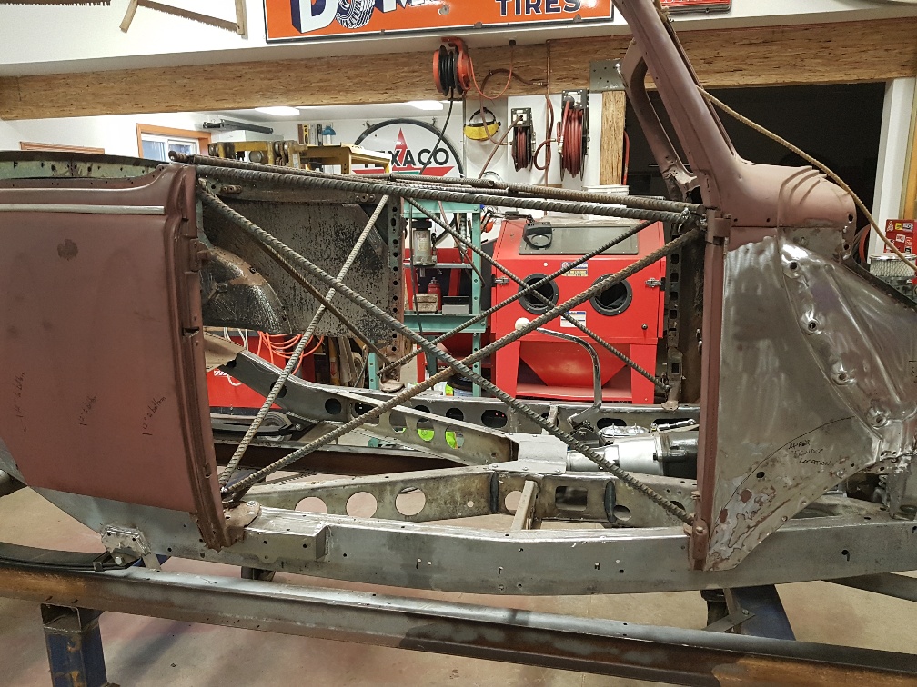

  13. I think that pretty much brings us to the end of the chassis build for the time being...though the master cylinder and pedals are also mounted but I apparently didn't get any good photos of that portion of the task.
    I needed a bit of a break from the big picture stuff...and decided to spend some time putting together the tri-power set-up (assembled from bits and pieces of about 10 carbs and an old Offy Manifold all of which were sourced at the Portland Swap Meet, lots of reading about setting up tri-power carbs etc. I also rebuilt the Borg warner Super T10, but strangely don't have any pictures of the process...musta been concentrating too hard.
    So now it's time to hang the body back over the frame, but first, I cut out some of the rough and rusty parts, and added additional bracing to secure what was left using some old re-bar I had lying around.

  14. All the dust and stuff gets capture in the furnace filters. The fan draws from the face you see, with the filters in front and blows out (filtered) of the side you can't see. I can take a few more photos of it...it's very simple and works great!

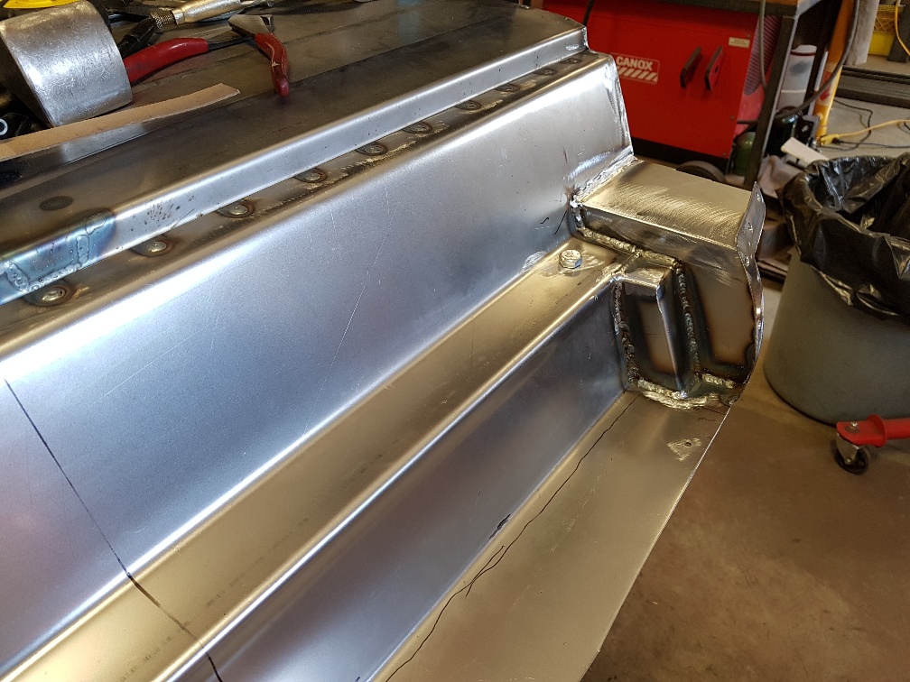

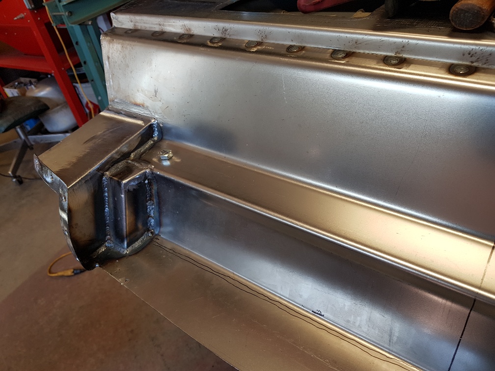

  19. With the cowl mostly taken care of, I turned my attention to building the rockers and subrails that the floor attaches to. I don't seem to have pictures of just the rockers at the door sills, but trust me they are there. I also took this opportunity to recess the rear wheel wells, though you'll see later that I end up re-doing them.
    20191229_161545_resized.jpg 20191229_161554_resized.jpg 20191229_161628_resized.jpg 20191230_130621_resized.jpg

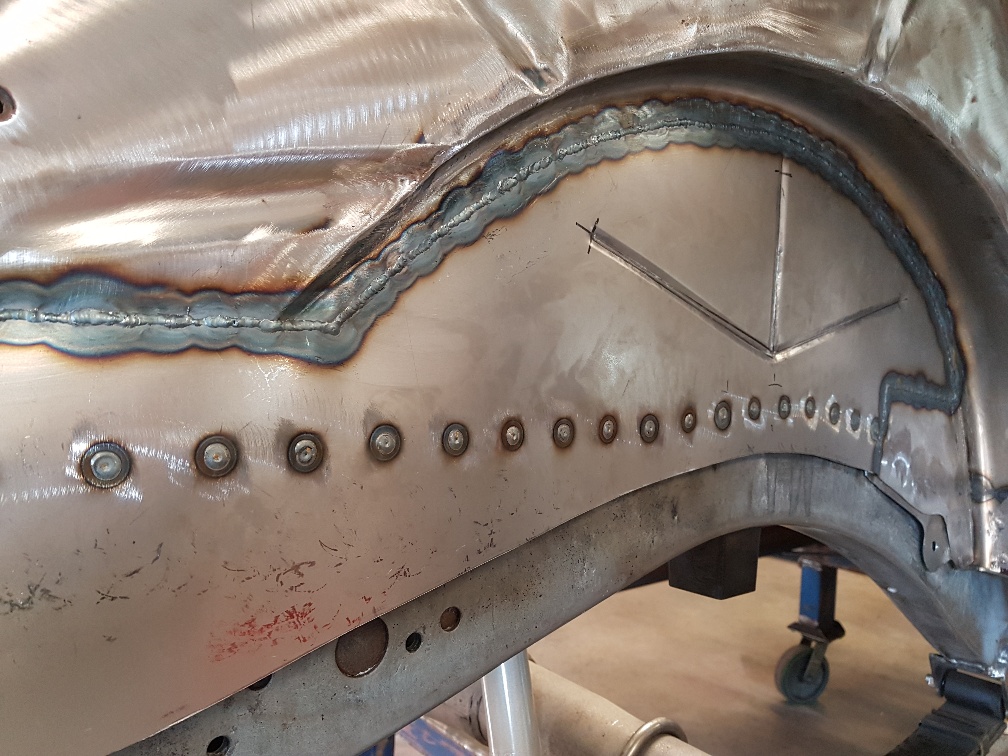

    And the quarter panel patches for both sides...the floor was plug welded with the mig, the quarters were tig welded in order to aid metal finishing. The quarter panel patches got a slight roll/shaping on the English wheel, and some flanges along the lower edge that were folded with the brake.
    If you look at the bottom of the quarter patch in the last picture, there are 3 small raised areas. I hand punched 3 mini louvers for drainage (open side of the louver to the rear).

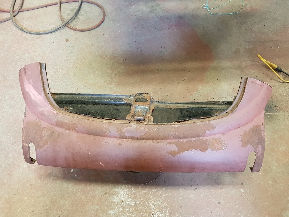

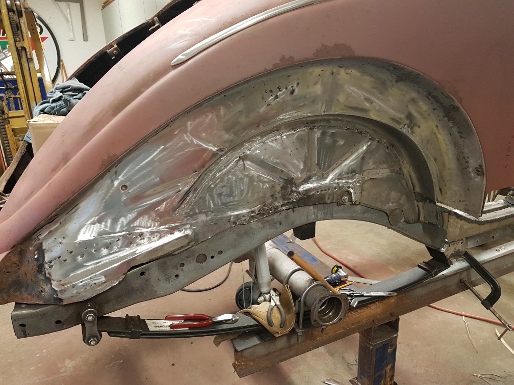

  23. As I was working towards the rear anyway, now seemed to be a good time to remove the rear of the car. This gave better access for the floor replacement and allowed me to cut apart the tool tray to see what I was up against there. I decided it was better to replace than repair it. I decided to include a floor access panel for the gas tank sender.
    20200323_144635_resized.jpg 20200323_144640_resized.jpg 20200326_130333_resized.jpg 20200327_161748_resized.jpg 20200327_161806_resized.jpg

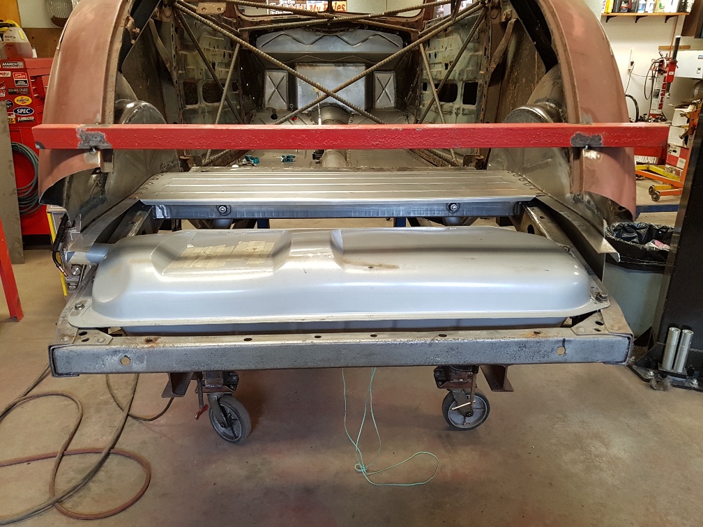

  29. Carrying on with our story...while the tail pan and tool tray looked pretty good in place, once they were off the car, and apart their true conditions became clearer. This is just a few of the problem areas noted.
    20200412_105628_resized.jpg 20200412_105637_resized.jpg 20200412_110030_resized.jpg
    Hence the decision to start over on the tool tray etc.
