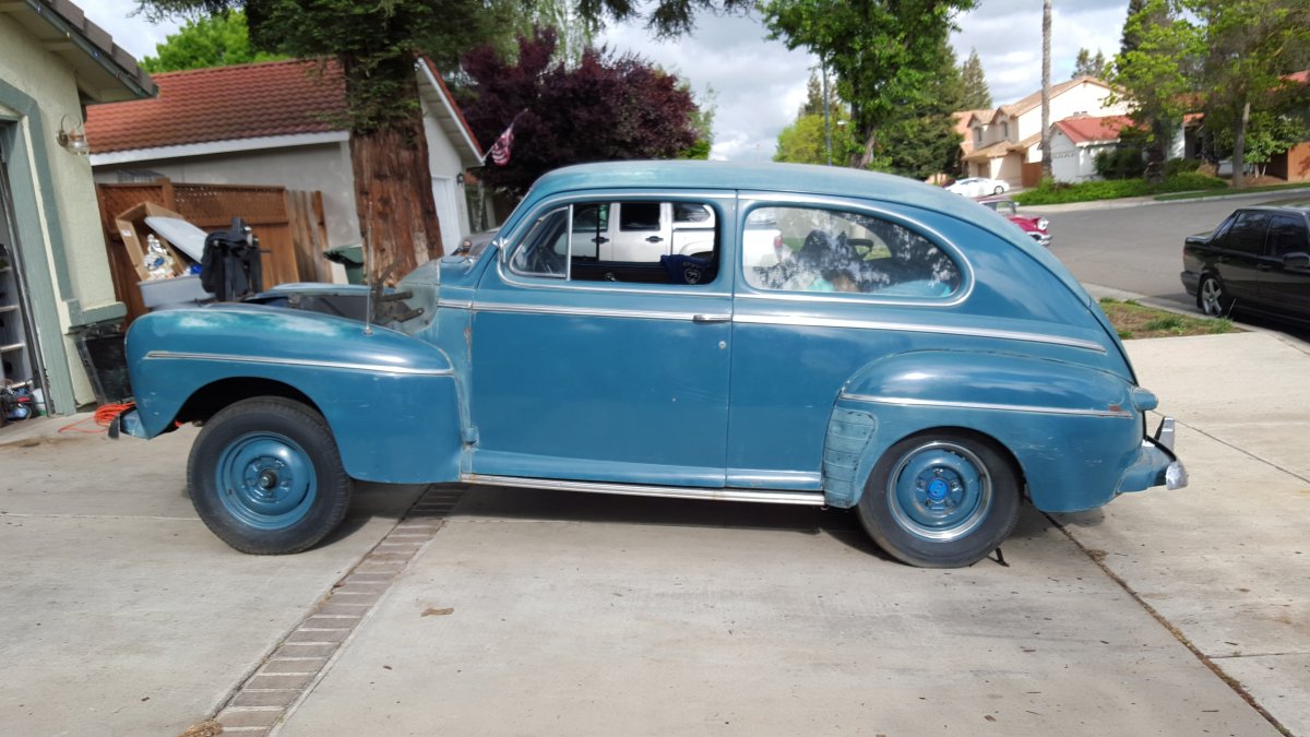

    image.jpeg image.jpeg image.jpeg So I had this follow me home a while ago and after months of saving doing side jobs here and there and putting in some overtime I have gotten some money together. Believe me not easy when you've got a family and parents who also need help. Now it's time to get this fat girl back on the road. The flathead does turn but driver side water pumps doesnt and according to the previous owner it had a knock in it. Truthfully yes flattys look great sound great but I need something cheaper and more reliable. So here come the questions and yes I've researched and yes I've got through other threads some were clear others not. I've had many other cars but nothing this old so this is a first for me.
    1) Is there a bolt on kit for engine swaps? I really want to run a 350/350 combo
    2) Tranny tips?
    3) Rearend tips?
    4) How to slam the rear? Lower the front?
    5) Brake up grades?
    Budget build here.... I just want something where I can get my boys and wife in and cruise around town. I will post pictures of the progress and give credit to those who helped thanks to all beforehand.

    try speedwaymotors.com for mounts - want manual or automatic? - Ford 8" rear with 2"-3" pre-lowered parallel leaf springs w/tube shocks - up front de-arch/reversed eye springs - can get tube shock kit that will let you use stock sway bar / panhard bars - how low you go depends a lot on size tires/wheels - use a disc brake kit - check chassiengineeringinc.com for stuff too

    Nice! I want auto for the tranny. And how low? Not slammed just lowered.

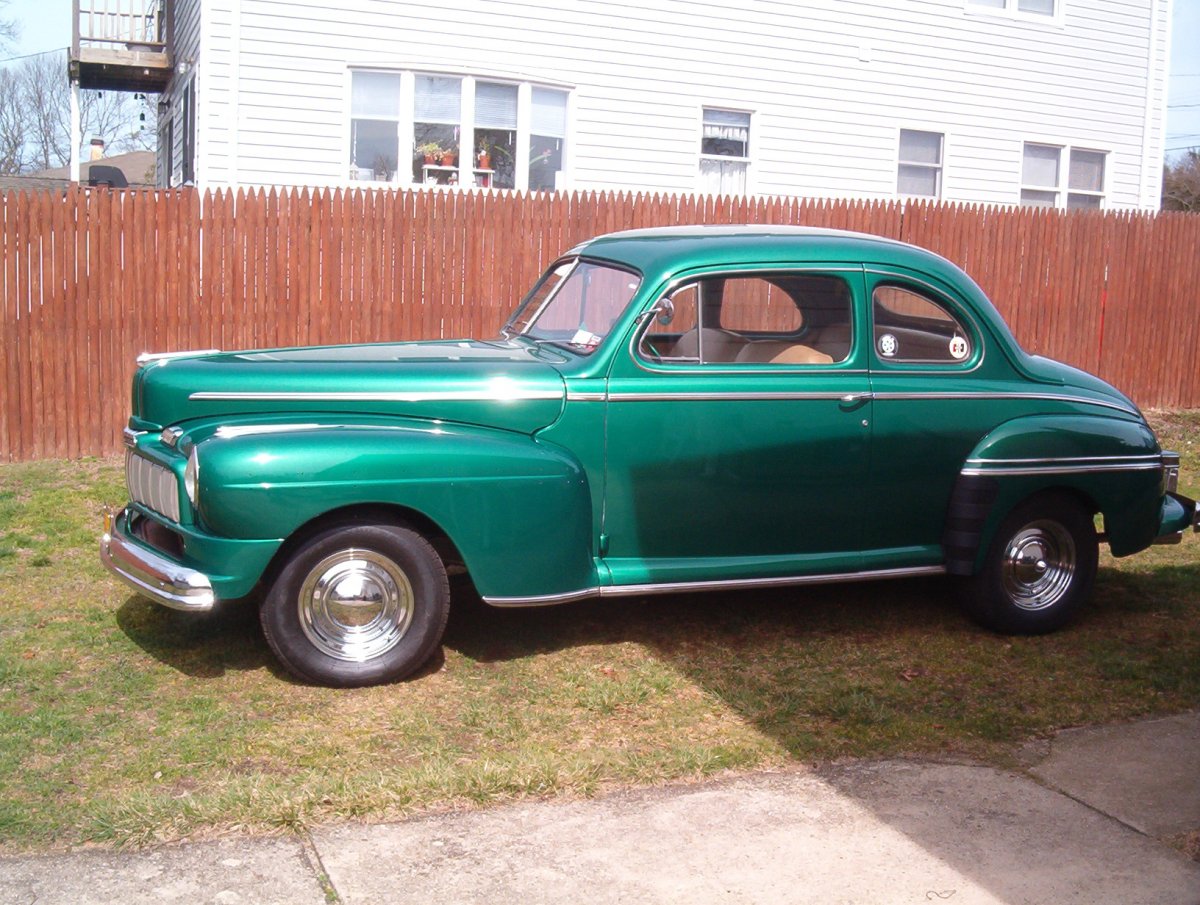

    chassis engineering has a bolt in swap for a 350/350 using a 68-76 nova rear don't get much easier than that...I also have a merc its a 46 with a 1950 303 olds engine

    my Mercs a 302 Ford and C4, love that little engine
