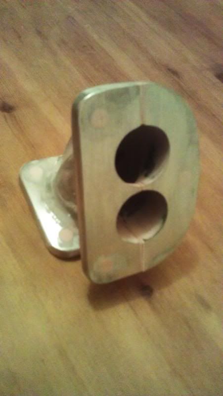

    A bit back I showed the SU carb adapters. I spent a fair bit of time fettling the piece before taking to the local casters.
    So when three of these were cast I wasted no time in making the linkages and fitted the carbs to see what they looked like.
    If this works there's a bit of video of me playing like a kid with a new toy.
    Pete

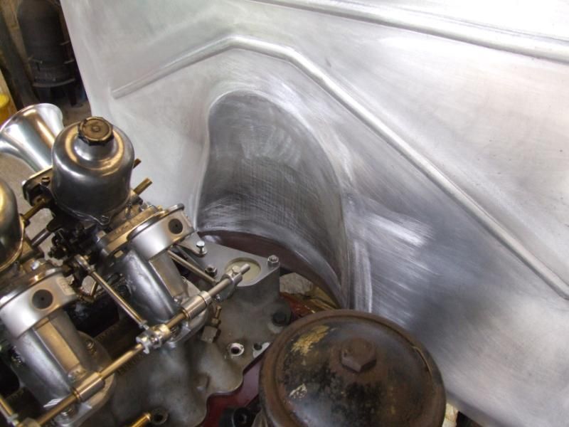

    Taking a slight step back I've been doing some of the smaller jobs during the week, easier to get stuck into the body etc at the weekend, and this week I started to fit a bit more of the throttle linkage. Just needs a straight rod through the fire wall to the pedal now.
    Pete

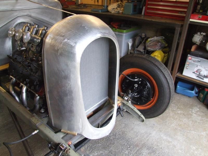

    Spent some time bashing out the start of the radiator grill shell. Not being totally sure of what I wanted, I just set about some ally with the mallets and sand bag.
    I knew I wanted it shorter and deeper than a standard A/B shell and also wanted it to be more rounded but didn't want the normal track nose style. Sitll wanted it looking 30's, upright with a big opening with the rad sat behind a mesh grill.
    The drawn on opening is just a doodle, I will wait to cut out the opening until I have a moment of inspiration, maybe!!
    It took a little while before I cut the hole. I did re-shape the shell a bit too.
    Happy with the cut out I welded an angle return around the inside to hold the grill later. I also bought an aluminium radiator core. I will make the top and bottom tanks later.
    Pete

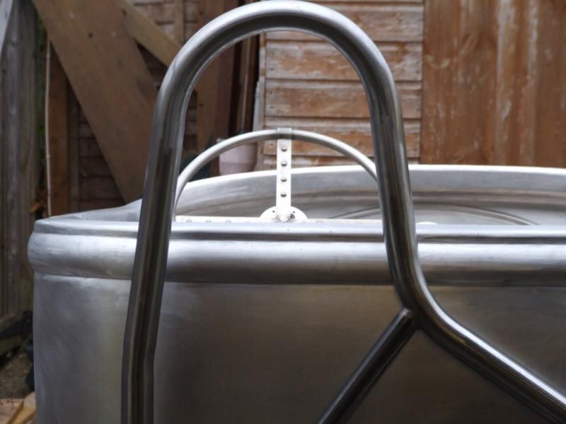

    After racing at Wiscombe and seeing a couple of cars get wrecked I thought it prudent to fit some kind of roll over hoop. I didn't want anything that would look too modern so made a simple loop, bolted to both chassis rails with a diagonal brace. At a later date, when the fuel tank is mounted I may have another brace that runs backward.
    Also at the same time I made up the rear top section for the back of the body.
    The seat is just a quickly made item just for mock up and won't be used in the finished car.
    Pete

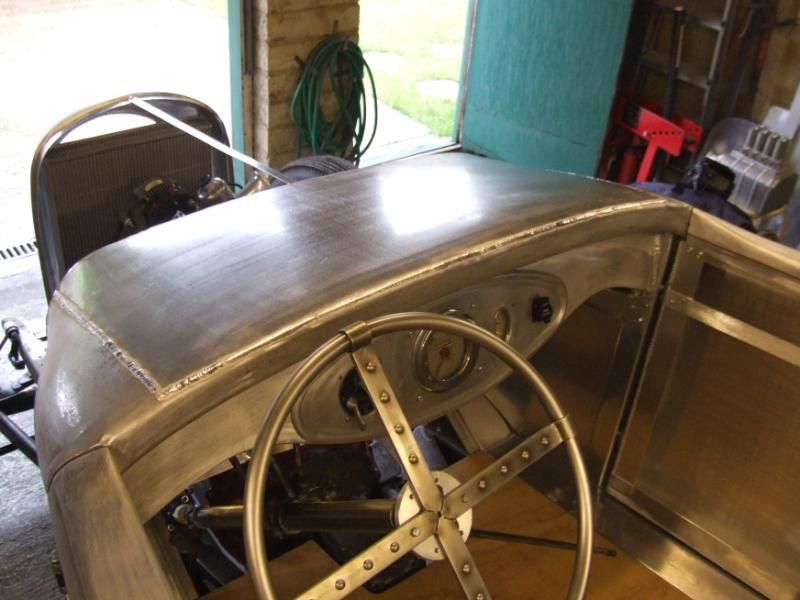

    Next bit was to make up a mock column drop so I could sort the column and steering wheel boss. The steering shaft is 3/4" bar with a DD milled into one end and the splined section of the quick release welded to the other. The steering box now has a UJ so the column can be adjusted down for that racing stance. All still needs to be finished, but again this can all be done on the tear down before the final build up.
    And lastly I managed to weld in the cowl top after sorting the internal bracing for the steering column. I only got as far as welding it in place and still have to flash the welds off then panel beat it all flat.
    Pete
