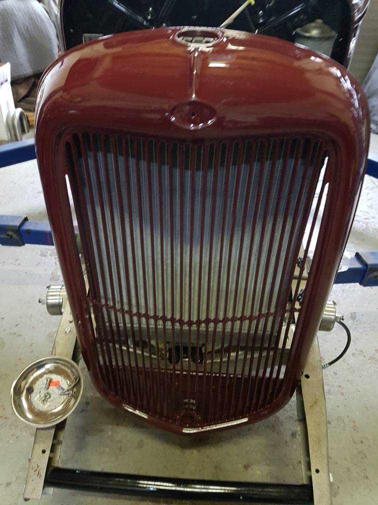

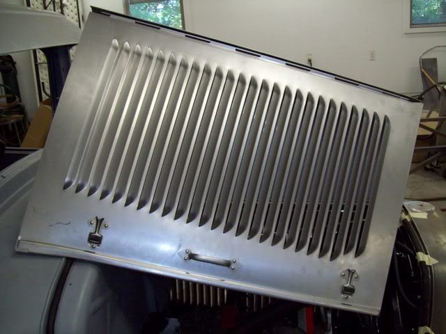

    This is the grill shell which came with the body. It looks very deep. Can someone tell me if this is a 32 or a 33?
    I'm pretty Sure it has to be a 33.
    Also are the 32 and 33 hoods different? And how can I check my hood is a 32?
    I've enclosed a picture of one of the hood sides. It sure looks like a 32.
    [​IMG][​IMG]
    Sent from my SM-G935F using The H.A.M.B. mobile app
    juan motime and Stogy like this.
  12. alchemy
    Joined: Sep 27, 2002
    Posts: 13,088
    alchemy

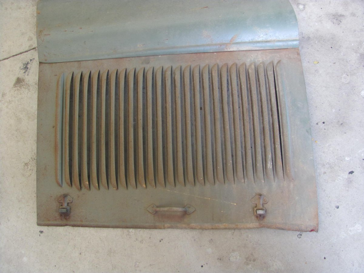

    Grille is a 33, the hood is a 32. You are right that the grille is deeper. It is also supposed to mount with a slant, so the top surface has more slant than the 32 would. The repro UPAC 32 pickup grilles look really nice if you can't find a reasonably priced original.
    The 32 pickup hood is the same as a car hood. You have what looks like a repro 25 louver hood. A 33 pickup hood looks very similar, but I think they have 23 louvers, and the front edge is slanted (not too much) to match the layed back grille. The bottom bead also has a slight kink in it because of the 33 frame's matching arch.
    haring and Runnin shine like this.

    Thanks for confirming what I suspected. You're right. I think my hood is a reproduction. It looks too new.

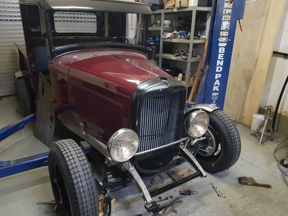

    So here's a little update.
    Finding somewhere to mount the battery wasn't easy. The chassis strengtheners take away all the space under the frame. We decided to keep the engine bay clean to I ended up making this battery box which mounts on the rear crossmember. It means the battery is still easily accessible but isn't visible under you crawl under the truck. It's placement also helps a little with weight distribution.

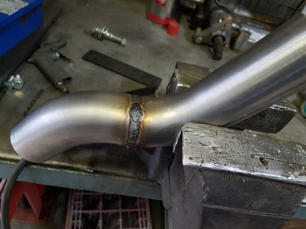

    Three images showing the stainless steel exhaust. The last shows a stainless steel weld before grinding smooth. I'm going to have the sections polished so they'll look like chrome.
    This bracket attaches under the bed near the battery towards the rear. It holds the marine stainless steel cut off switch and the starter solenoid.
    Here's the F1 steering box turned down and fitted with a stainless steel flange and an outer frame embellisher.
    Here it is fitted to the frame. I mounted it a little further forward than stock. This means that the steering wheel sits in the correct position and it just clears the Speedway economy header.
    This is the '40 wheel I bought from Limeworks which is splined to fit the F1 column.
    Normally very hard to find. Someone just started repopping the '32 steering column drop. It's a beautiful piece. Bought on eBay.
    Running fenderless but with a hood presents a little problem. No where to attach the rear hood catch. So I used these Model-A brackets bought from Macs.
    Making the headlight stand using a set up bar to keep everything straight.
    It's a cut a modified original 32 Truck bar.
    Welded up and blended to welds smooth.
    Notice the new repro '32 truck grill shell. Luckily just become available. I see a big demand for this item not just for trucks. At $650 it's cheaper than a shell with insert and looks great.
    A warning to all. The Thomas Brice radiator is at least 1" too short!!! So I decided to take the plunge and order a Walker.

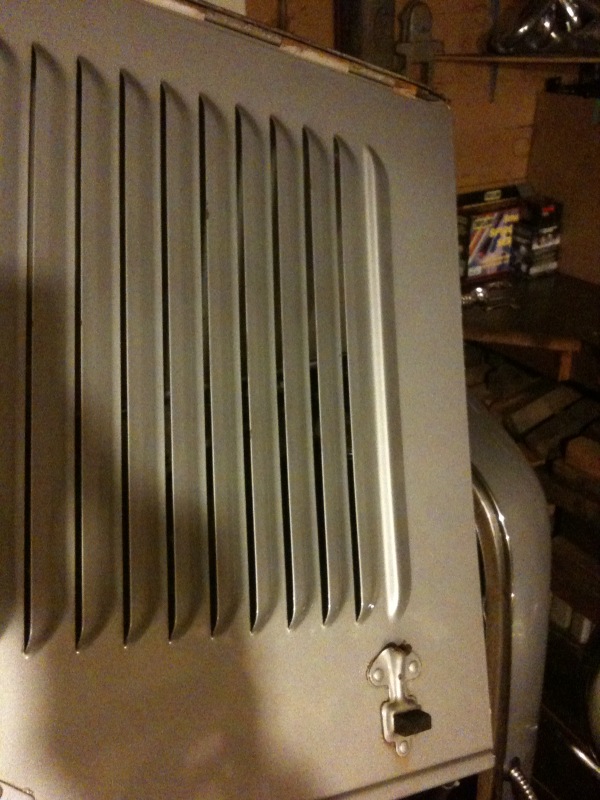

    Your hood is the early repo, but nicely done 25 louver. Original 25 had the very front 2louvers shorter above the front hood latch, both of these are repo but the original very first louver is not punched. IMG_1960.JPG newhood2.jpg hood side 1.jpg
    mgtstumpy, kiwijeff and Runnin shine like this.

    Well it's available new now. That's what I'll do next time.

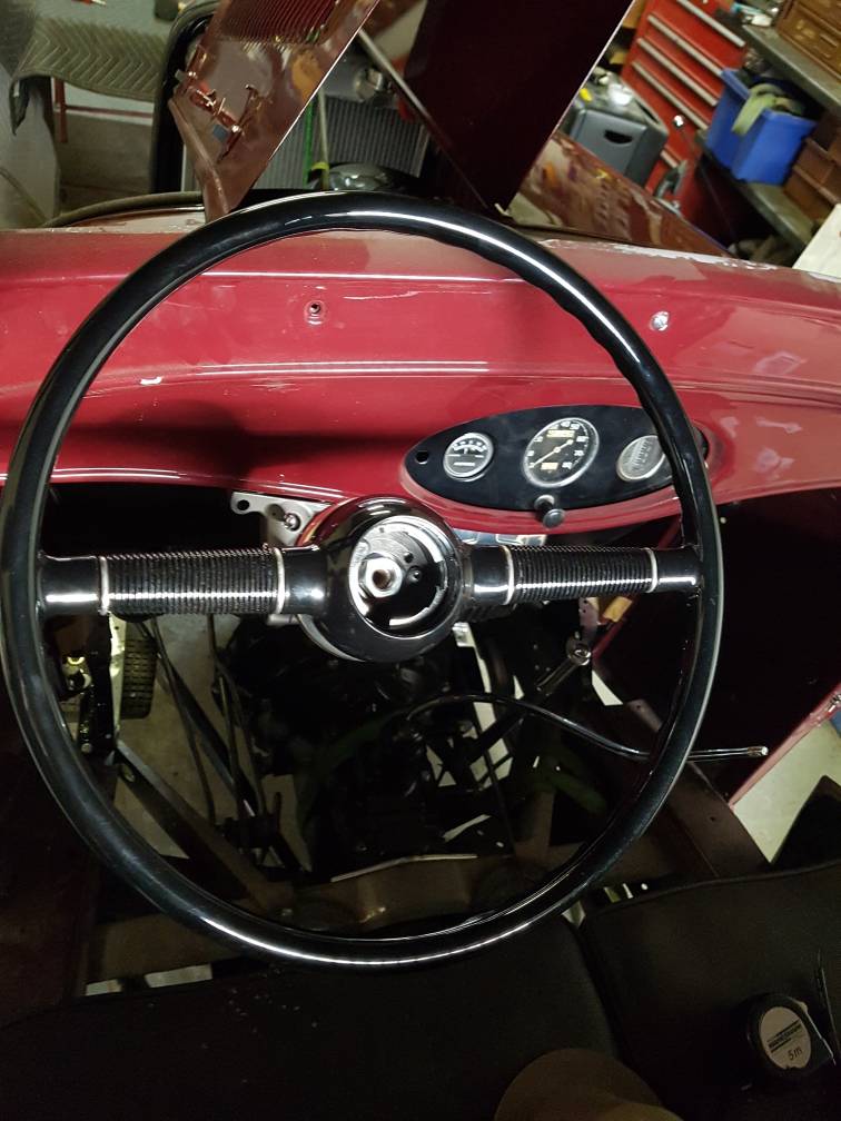

    I wanted to fit a tach, water temp and oil pressure gauge but there was no way I was going to cut holes in an original 1932 Ford dash.
    Hanging them below it looks cluttered and there's little enough room in the cab anyway.
    I have fitted dual electric wipers and the motor protrudes into the interior so it needed covering up anyway.
    So I made this header panel out of a metal shelf which already had textured paint on it similar to the fiberglass headliner.
    It holds the three instruments and the wiper switch.
    I'll paint it black later.
    It's easier to tip the cab over, when fitting the headliner, windlacing and header panel. That way you're not working above your head.

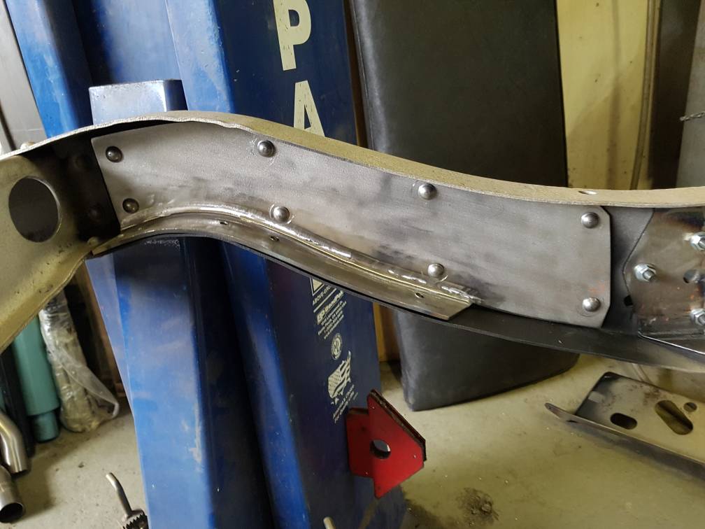

    This is an early frame without the factory fitted frame reinforcements over the kickup. These frames started failing in this area in 1932 if you overloaded them.
    This frame had been repaired here before. Anyway, you need to reproduce factory reinforcements and rivet them in place. So here they are. Painted the inside of the sandwich and riveted in place. Still another 4 rivets per side to be placed alone the bottom.[​IMG][​IMG][​IMG]
