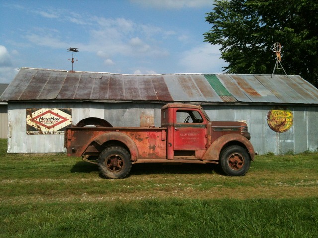

  13. Barn Find
    Joined: Feb 2, 2013
    Posts: 2,318
    Barn Find
    from Missouri
    The Willys garage looks great. We talked about adding a false front to this old milk barn for years.
    We never got around to adding the false front, but we did add on to the back of it, so we could store two more cars under roof.
  14. Barn Find
    Joined: Feb 2, 2013
    Posts: 2,318
    Barn Find
    from Missouri
    We put old signs, a gas pump, and even a yard-ornament-Model A in front of the new garage, but it still looks like a new garage.
    It's hard to beat and old barn for appearances, even if its a substandard unit for storing cars.
