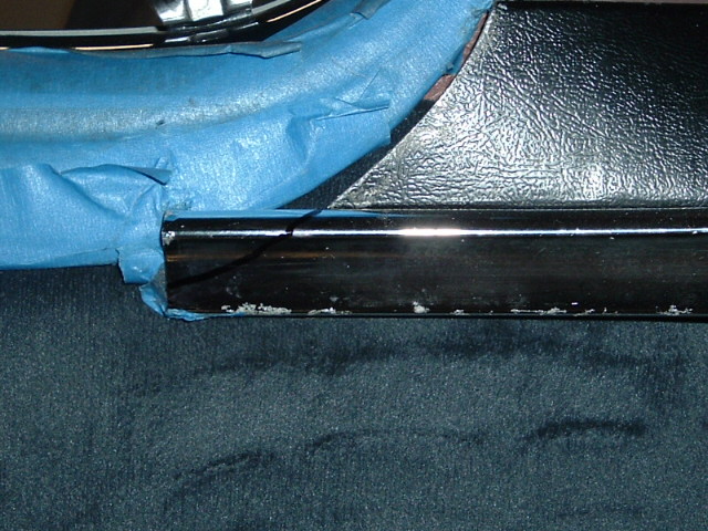

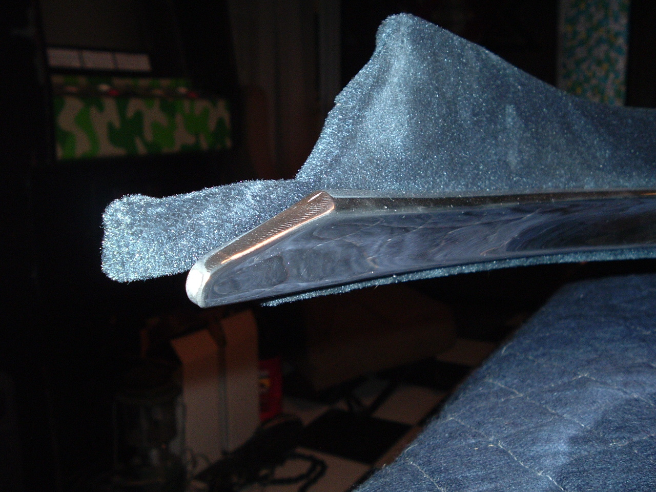

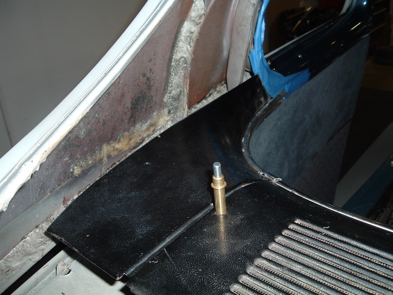

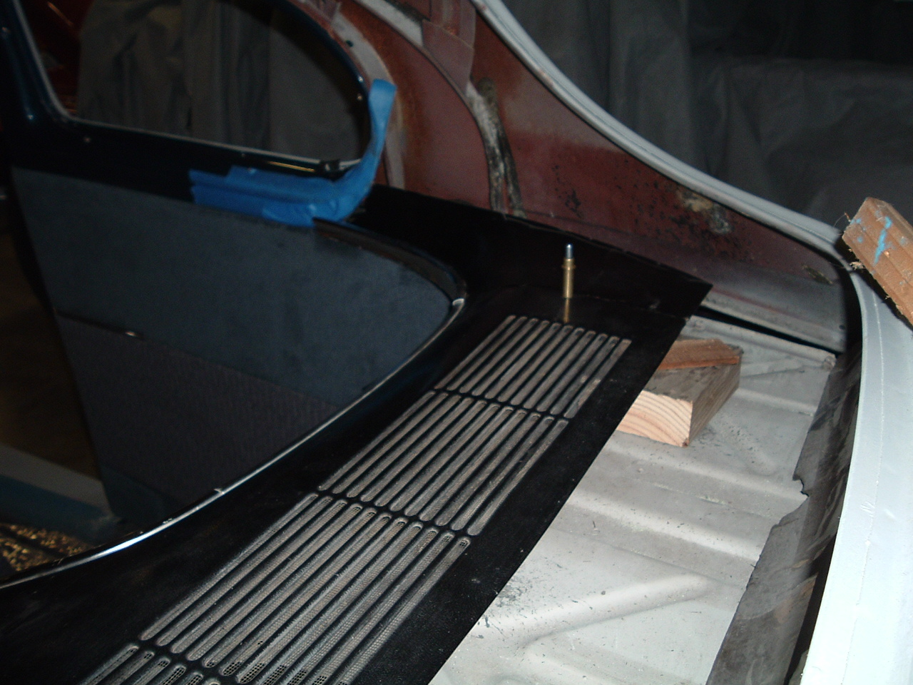

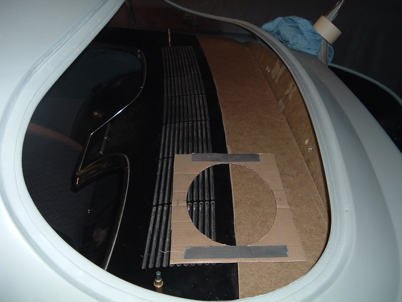

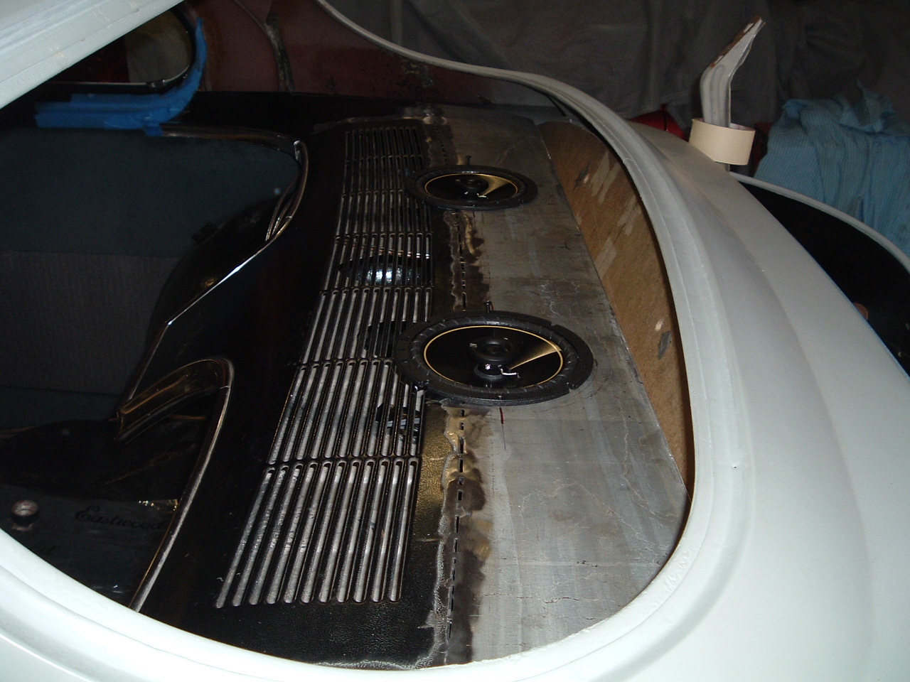

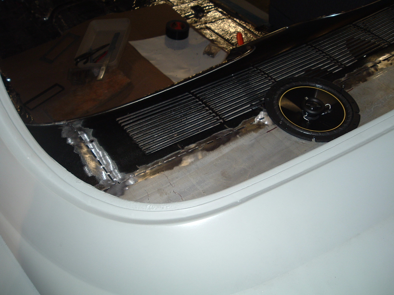

  9. I'm just finnished with the install=finnal assm,so,here's my crap...... I believe mine were 65. After fitting the tray to where I wanted=seats in/out numerous times,I did this> Instead of having the tray end,then add a filler,I contured a sheet to form with the back window.Also trimmed around to match the headliner contour.=So now all one piece. I wanted tunes,so I lucked out 'cause the tray sit's about 2 1/2 above the factory shelf,and didn't have to bore through that as well for speakers. They are serviceable from the top. So far so good....
    Factory trim is just that,and designed for a 'bird,so improvising..... cut and contured the trim to match the curviture(spl) to the 1/4 garnish moulding.
    When all assembled,looks good(at least to me).
    And- gotta come up with a one off emblem,and ditch the bird....I give that to people regularly,so I made my own.
    Just have to think it out,and fit a bunch of times,but in the end,it's worth it.
    Pics..........

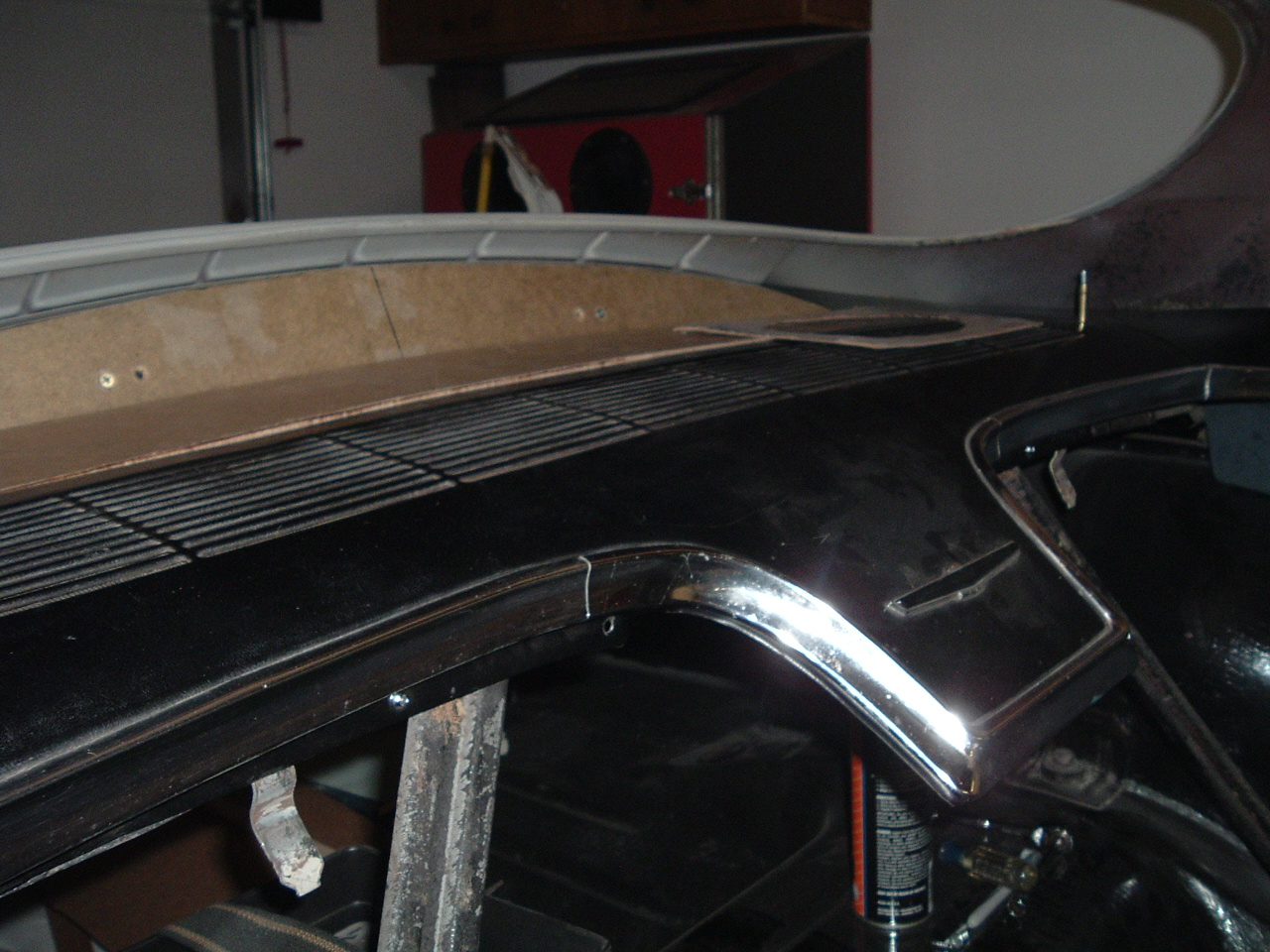

  10. A few more......

    Nice install!!! Thanks for the details on the fab! What kinda car did you put it in to?

    Nice job Invisiblekid, now I do the job for mi 51 Merc, can you show us how did you atach de back of the seat to the body of the car, thanks
