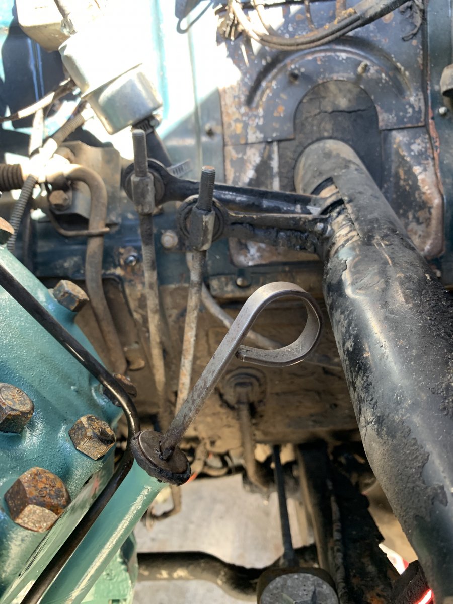

    Hey guys so I have a 51 merc and just reinstalled the 3sp manual trans.
    My questions is what’s the proper way to adjust the linkage. Someone had mentioned that the levers coming out of the colum need to be even when in neutral, is that true?
    This is what mine look like in neutral now.

    Make sure the column levers are even by moving the shifter forward and back. Then make sure the transmission shifter arms are both in the middle (neutral). Then reinstall the rods without moving any of the shift arms.

    Okay, can you explain in further detail how to do that? Like I understand the finding neutral but does the rear arm need to go down or does the from arm need to go up? They should both be even correct?

    They should both be even, and when they are, the shifter in the car should move in and out (not up and down) smoothly. The tube inside the column has a square block on it that slides in and out of both shift forks on the column.
