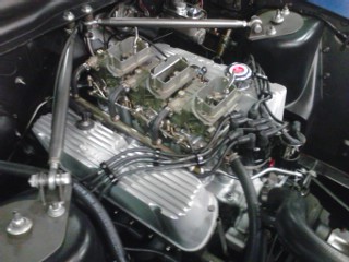

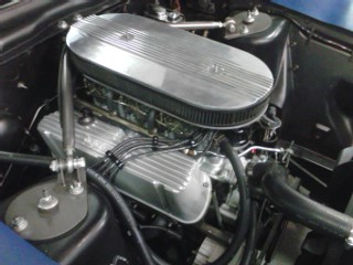

    Spent the last couple of evenings installing the Tri-Power that I bought from fellow Hamber dickster. Just have to button up a few things and reset the T/V pressure on the AOD then flog it! 00y0y_ccuIirSdhfE_50x50c.jpg get-attachment.jpg get-attachment.jpg SBF tri power 5-14 001.JPG
  2. Looks good,,looking forward to the running video. HRP

    Just changes the whole attitude.
    Hope she runs as good as it looks.

    Nice. Particularly like the linkage. Simple and neat.

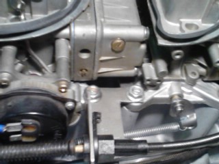

    Well, we had a major tragedy in our family three weeks ago so I never really finished up the install until this week. Got the AOD cable bracket fabbed up and started playing with the T/V pressure. Before I ran 5 psi at idle and 33 at wide open. I thought that it wouldn't hurt anything to bump it up a little so this time I set it at 40 psi wide open. Only a 7 psi difference and the trans was sluggish and wouldn't hold 3rd gear. These tranny's really are finicky! I backed it off to 33 psi again and it works just fine. I have included a couple of shots of the bracket that I made for the factory cable in case someone else needs the info and a finished shot. By the way, the red vacuum cap is going away. I have the manual choke set-up for it. 3163i83.jpg 3163i83.jpg get-attachment.jpg get-attachment.jpg
