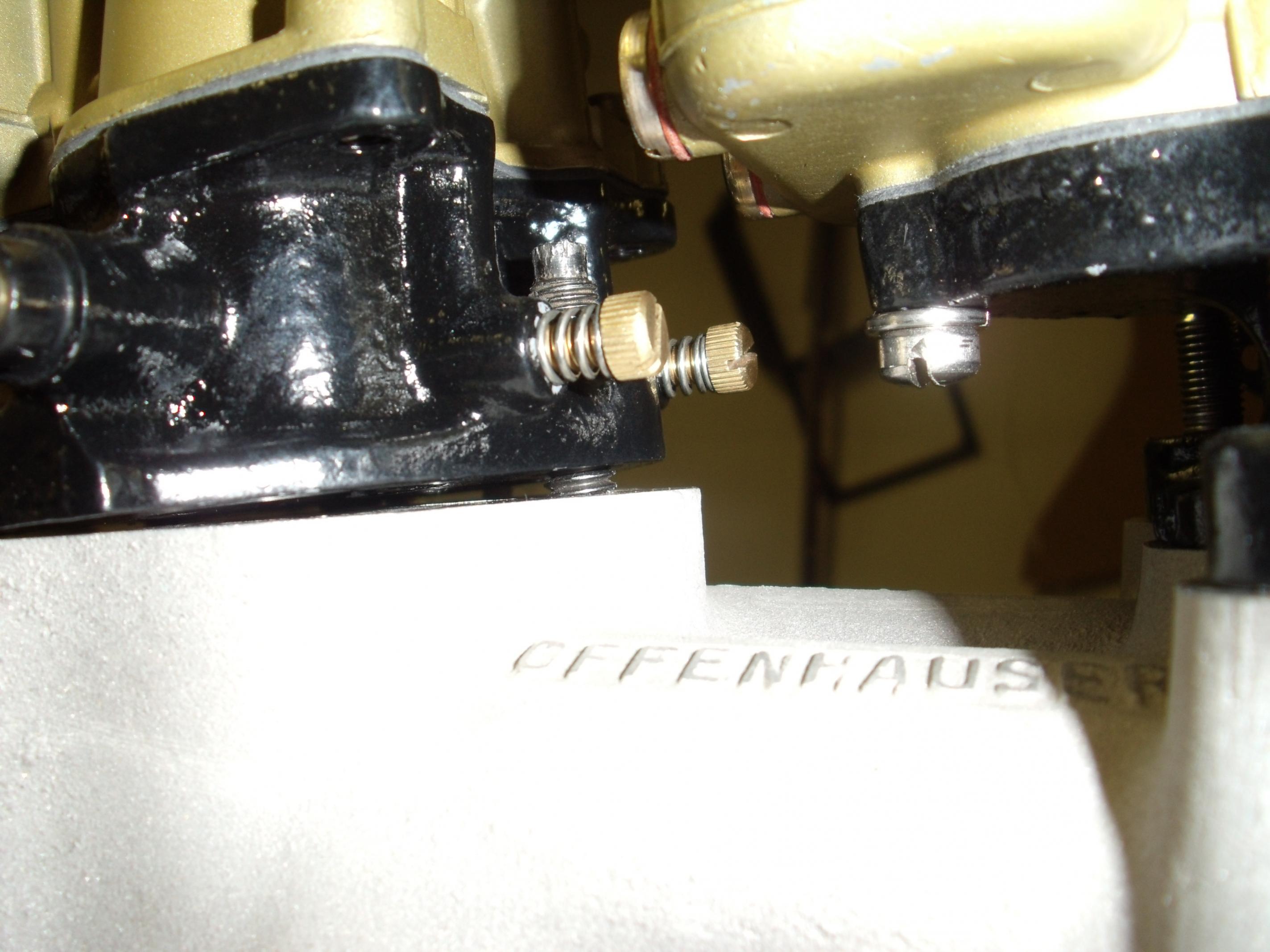

    Just finished building three 91-99 model Ford carbs and thought I'd put them on my Offenhauser three duece intake to see what they looked like and they don't fit!
    The bowl screw protrusion by the inlet is hitting the next carb and this ends up making the base of the carb tilt outward and leave a gap at the base.
    What am I missing here?

    Here's the pics.

    looks like you might have enough meat to grind off the screw boss enough to clear and maybe a little off the opposing carbs bowl? or you can run 3 spacers and extend the mounting holes on the front and rear spacers enough so the carbs will clear.

    If you grind 'em like a couple have said, they will fit.
    I ground the bowl screws a little and ground clearance grooves in the back of the second and first carb. Just go a little at a time and keep testing the fit.

    If memory serves me correctly, the Edelbrock, Sharp, Fenton, and Weiand, all common and will accept 94's without having to grind the front bowl boss off. 2002P51 has the best procedure for making the 94 fit to your intake. This way you will still have the front screw to maintain bowl seal.

    I just ground mine off. you can't see it,and it won't leak. Mine has been running for 11 years with no problems. Spacers double the use of gaskets, move yer linkage around, and add unwanted costs........ unless you like the hi-rise look. Just my thoughts. Norm
