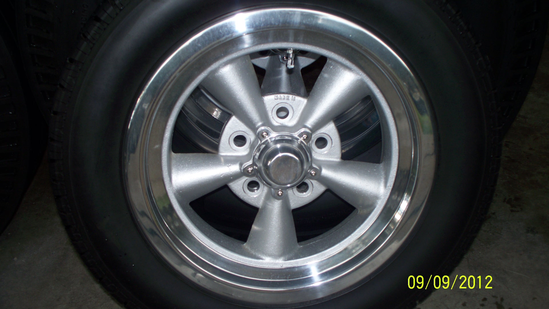

    Hello could anybody help with this question? I have some vintage ET torque thrust aluninum mags probly 60s or 70s,I need to know the thread size of the center cap holes,i have some broken screws i need to remove and need to know the thread size oif these holes Thanks

    I can't take it, I have some original drawings we used in the 60's and 70's, notes say 8-32 for 5 spokes , et super -#6 & #8 pan head self taping screw or 8-32 depending on stock. Et-IV said self taping or 8-32 pan head. The self taping could have been a thread cutting screw or a sheet metal screw. The hole size was #29 drill on all wheels.
    In the bigger picture drill out the bad rusted screws, if the hole is now too big then use an aluminum plug and redrill or use threaded insert , but that is the harder way since you will need to make a jig to drill the new holes on location.
    Bottom line now one will know or care which screw you use, but if purist is the goal then no stainless just zinc plated steel slot head.
