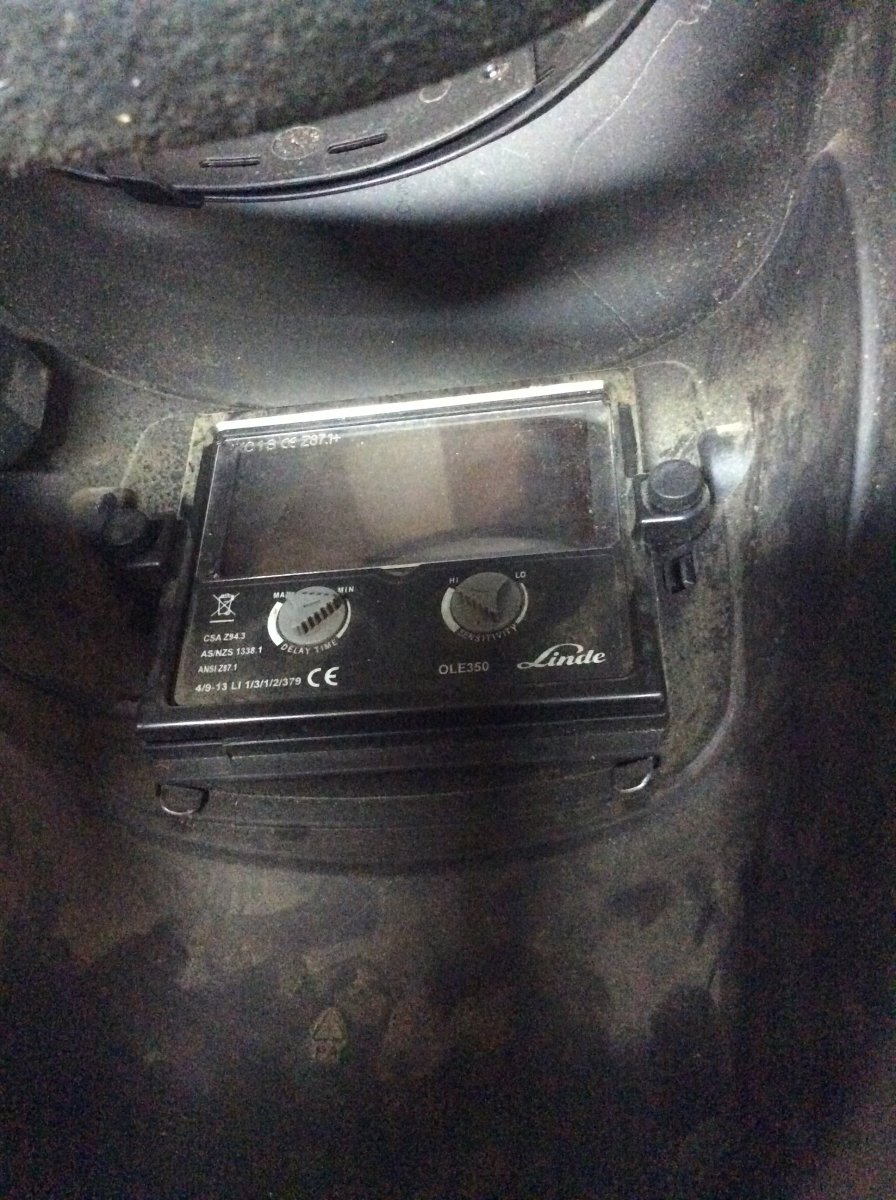

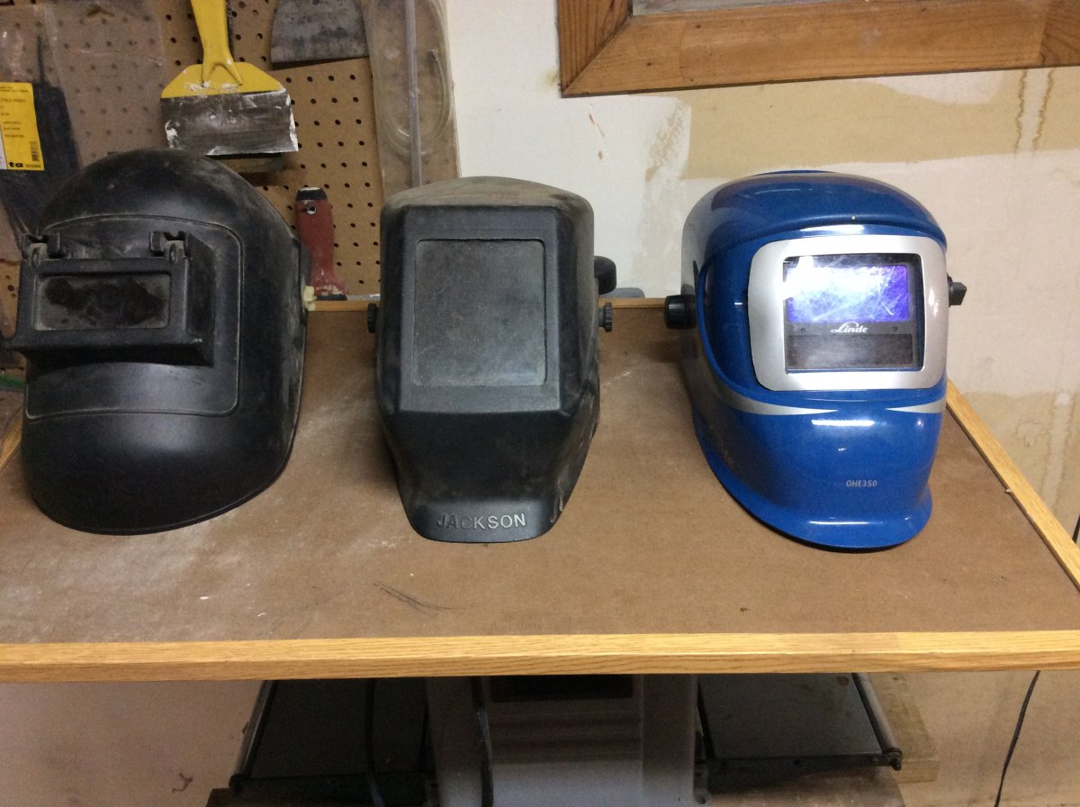

    Here's what I have as far as welding helmets. The one on the left came with the welder. No name, no auto darkening. After not liking it, I went back to the BOC store I purchased the welder at and they sold me the second one. It has a much larger field of view, but no auto darkening. After not liking that one either, I purchased the Linde helmet, as the store changed owners from BOC to Linde. It has a "sensitivity dial" and "time delay" dial inside the helmet and a outer "darkening" dial.
    The outer and inner lens are marred with light scratches for sure which on their own do obstruct the view somewhat. I find the Linde helmet cheap, as the head adjustment mechanism is not working properly, causing it to come loose easily as well. I think it is time for a proper helmet.
    The spec sheet on the Linde. It says a helmet for the "industrial" welder who welds "infrequently". Lol...

    You should be fine with the helmet you have. You said that you have trouble seeing ahead of your weld and getting off to the side of where you wanted to go. I think some type of auxilary light will clear that up. (I do that too).

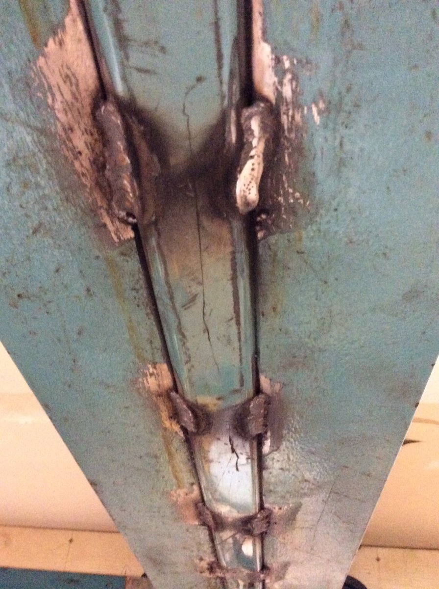

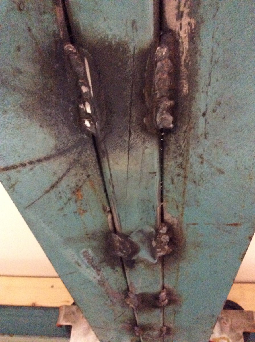

    I did sixty of these 2" long stitch welds every 6"-7"on my transverse beam for my overhead crane. Probably way too many for what I needed, but it felt safer. I did quite a bit of weld prep to make sure I had bare metal, and cleaned everything with brake cleaner, but I still had some issues as you can see. I have the argon CO2 tank and not the flux core wire. The outer pieces were 1/4" thick angle irion, and the center section was a thin walled box section, perhaps 0.100". In a couple spots I actually burned through the box section, and had to go back and carefully close up the holes. On the second pic you can see my weld wander off the joint a bit. This was welded in my garage with the door closed, do ageism lighting was not optimal.
  23. ekimneirbo
    Joined: Apr 29, 2017
    Posts: 4,280
    ekimneirbo
    Two questions: Did you weld the beam on the ground or overhead? How fast do you move your hand side to side. The reason I ask the second question is because I was showing a friend of mine how to mig weld, he weaved his hand back and forth "extremely fast".........so fast that he didn't really have control. My hand completes a back/forth motion about every second. I would guess he was going 5 times what I do. Another way to do it is with a short push/pull.......like you are just pushing a little metal forward and back. Very short strokes.
    Get two thick pieces and practice on them. At least 1/4" thick. Have someone "slowly" rotate the amp control "while" you weld. Then do the same with the "wire feed". Watch your weld change as they do it and try to find the best setting. You need thick metal so you have sufficient range for adjusting.
    When welding thick to thinner, point the gun more toward the thick material and put most of your heat into it. Kinda like you are putting almost all the heat in it and the thinner metal is drawing heat from the thick side. Then quickly move the gun to the thin metal and back to the thick again.
    One other thing you might do just to do it........multiple spot welds spaced closely together so they overlap and look like a single weld. Turn the amp up a little to get penetration. You can make a pretty strong weld that looks decent. Anyway give it a try,.......

  26. After seeing those pictures, my suggestion is find a buddy who IS A GOOD welder and have him show you how to set YOUR welder up(heat range, wire speed, etc). Then watch and listen as he shows you the proper way to lay a bead. Let him watch you do it, and listen when he tells you you're screwing up. Once you get the basics down, all you'll need is practice. YouTube shit is good if you're gonna weld with your phone, but out in the real world, hands-on is still the best teacher.

    I welded the beam in the horiztal position at waist height, so welding position was ideal. I do make small "Cs" when welding, but if the tip is not in the "ideal" position, things tend to go south. I'll double check the recommended settings, but I tend to ignore them and play with it until I find the "right" combination. For sure, I need more practice, and a few pointers from a pro would likely go a long way.

    Quit saying that shit! Probably half the people on the HAMB don't weld any better than you do. If your wire speed is correct and your amp range is correct you should get decent welds. Its really not that hard, but it gets ten times harder when you make too big a deal out of it. Its like your first time driving a vehicle. How hard was that? Nowadays people are driving their cars as an after thought while they fiddle with everything else in the world. Quit looking for alternatives and just practice. Turn the amps way up and see what happens. Turn the amps down and see how it looks. But quit saying you don't have the skill............I'm telling you that you do have the skill but you have to practice a little.
    Contact that welding instructor and see what he would take to come to your shop and spend two hours with you. Or bite the bullet and go take his class. If you think you are proud of your crane, I guarantee when you get comfortable welding it will be one of the most rewarding things you ever did......and you will realize you can do anything.
    You can do it if you just make up your mind to do it !:D:D:D
    One last thing, try holding your gun more vertical and start welding.....then start leaning it and watch the weld change.
