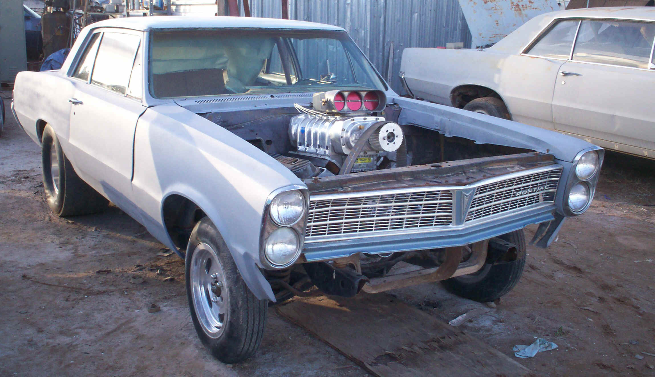

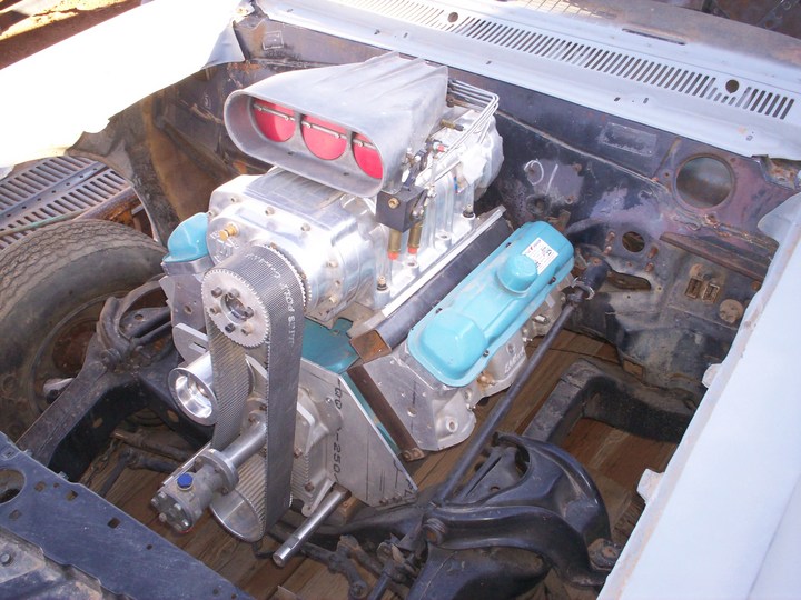

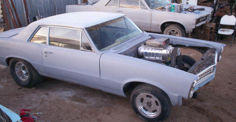

  11. I'm building my blown '65 AWB Tempest with stock a arm susp to compliment my AA/FD and have a 2 car team ( as money allows). It will see some street use. Nothing wrong with using stock, or nearly stock, front suspension and many of the AWB cars of the day also used them.
    AWB cars are just plain bitchin'!
    my .02
    Steve

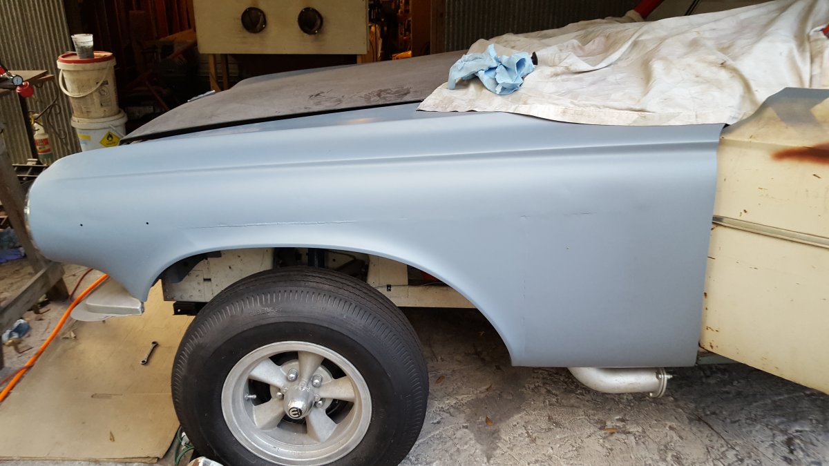

    iam going to try my hand at an 63 dodge 330 awb car i have had no luck at locating a straight axle so i purchased so 50" torsion bars and i am just gonna move the k member forward on some new frame rails
  13. That blown AWB Tempest is badass, any more details?
    -Dean

    IMG_2194.jpg IMG_2193.jpg 63dodge 016.JPG 63dodge 015.JPG update on the 63

    63 004.jpg 20161224_164111.jpg 20161224_164128.jpg 20161127_123557.jpg 20160617_103132.jpg 20161117_183115.jpg
