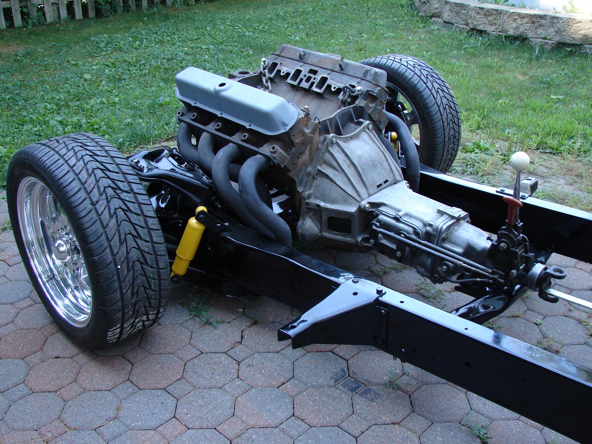

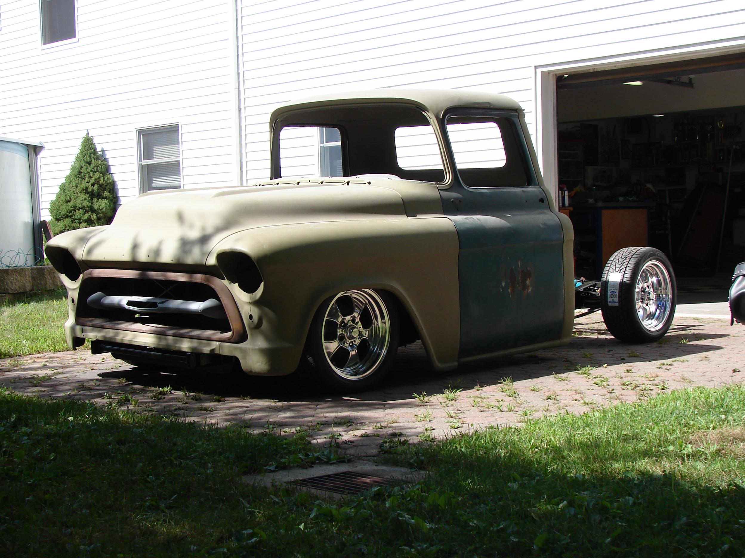

  9. TOYBOX
    Joined: Oct 28, 2007
    Posts: 158
    TOYBOX
    1970 472 caddy going in my 57 chevy pick up.
    KCsledz likes this.
  10. theHIGHLANDER
    Joined: Jun 3, 2005
    Posts: 10,264
    theHIGHLANDER
    For how we really use our cars, you can get an unlimited amount of smiles per gallon with a big Caddy. The earlier ones with higher compression are a 1st choice. That 57 PU install looks good. From 0 to 80 MPH that thing ought to knock yer head into the back window every shift:cool:
