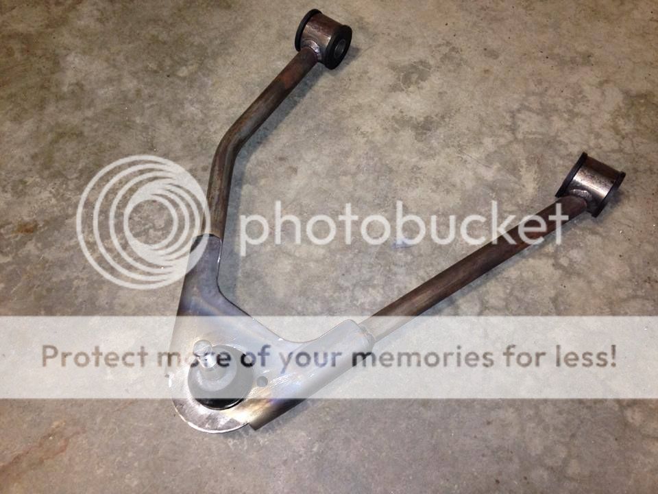

    Sorry for the build thread delay but I recruited my buddy to help me redo the suspension. I wasn't happy with the way it was done before and learning that you can;t hire people to do stuff for you is a costly lesson. I wanted to go with bigger tires and bags so we decided to make everything we needed.
    Gotta love the craigslist powder coating kitchen oven. Thing actually does a killer job with the Summit Powder Coating Kit

    Front End looks Killer now on to the back!
