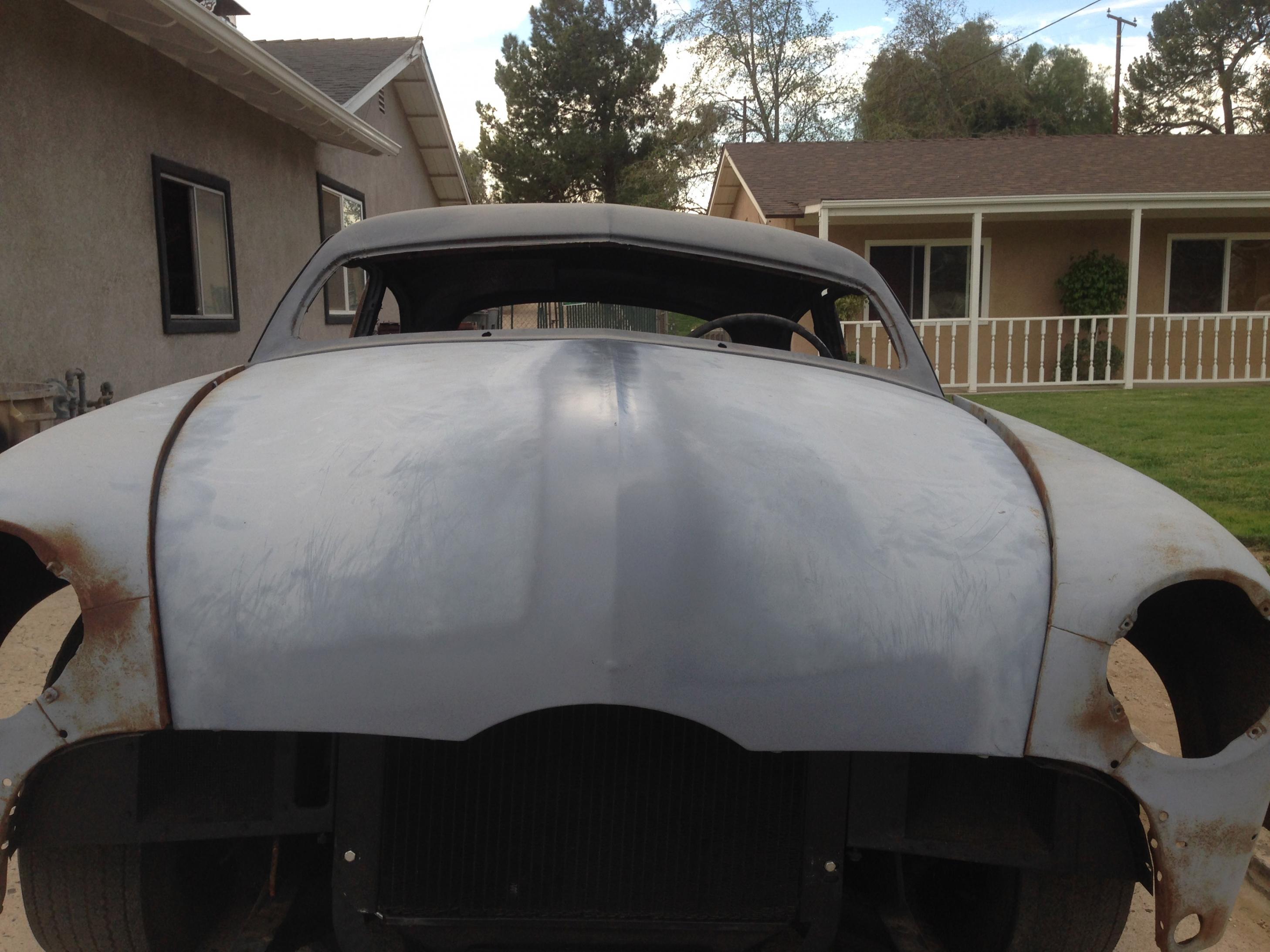

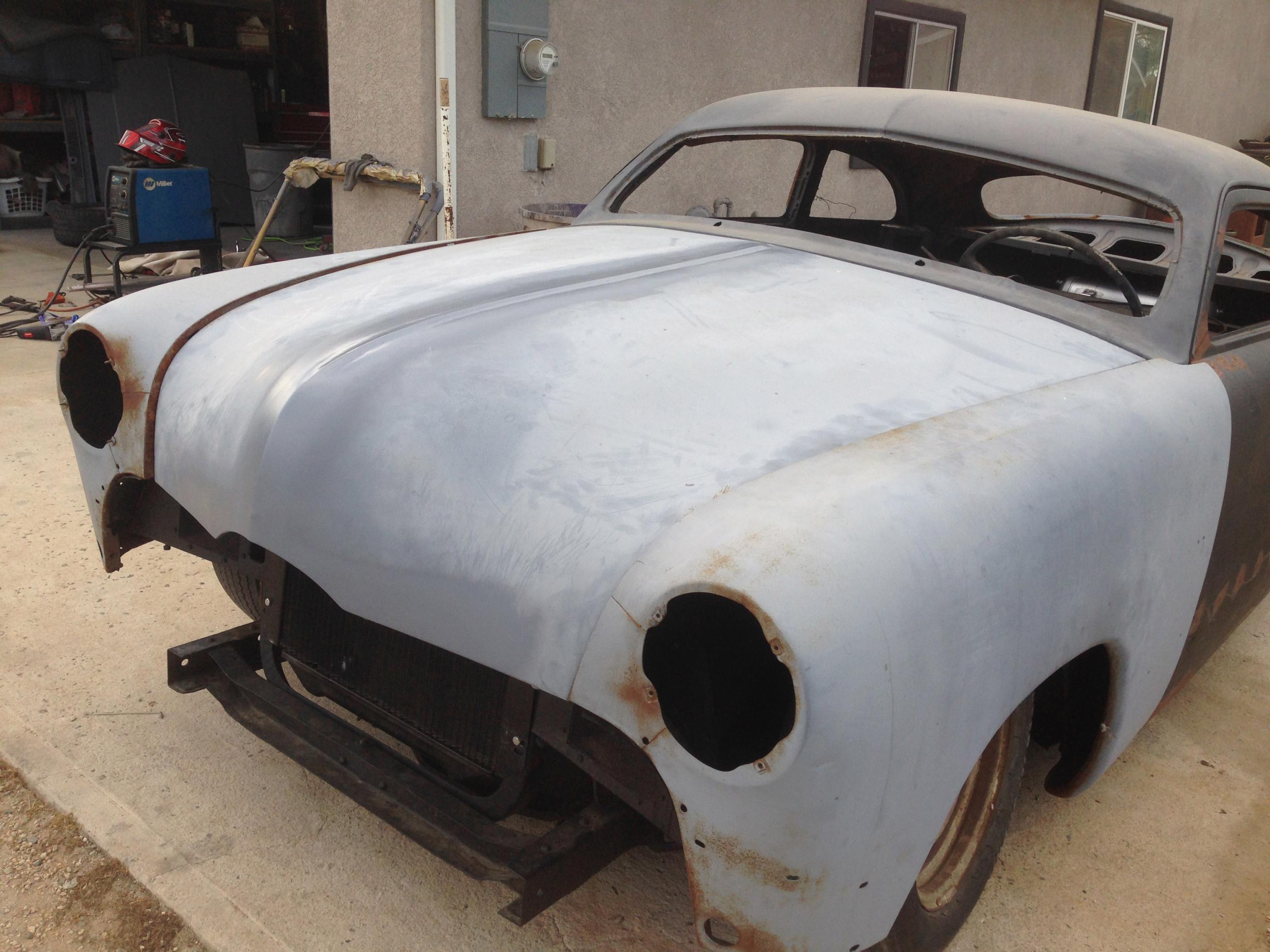

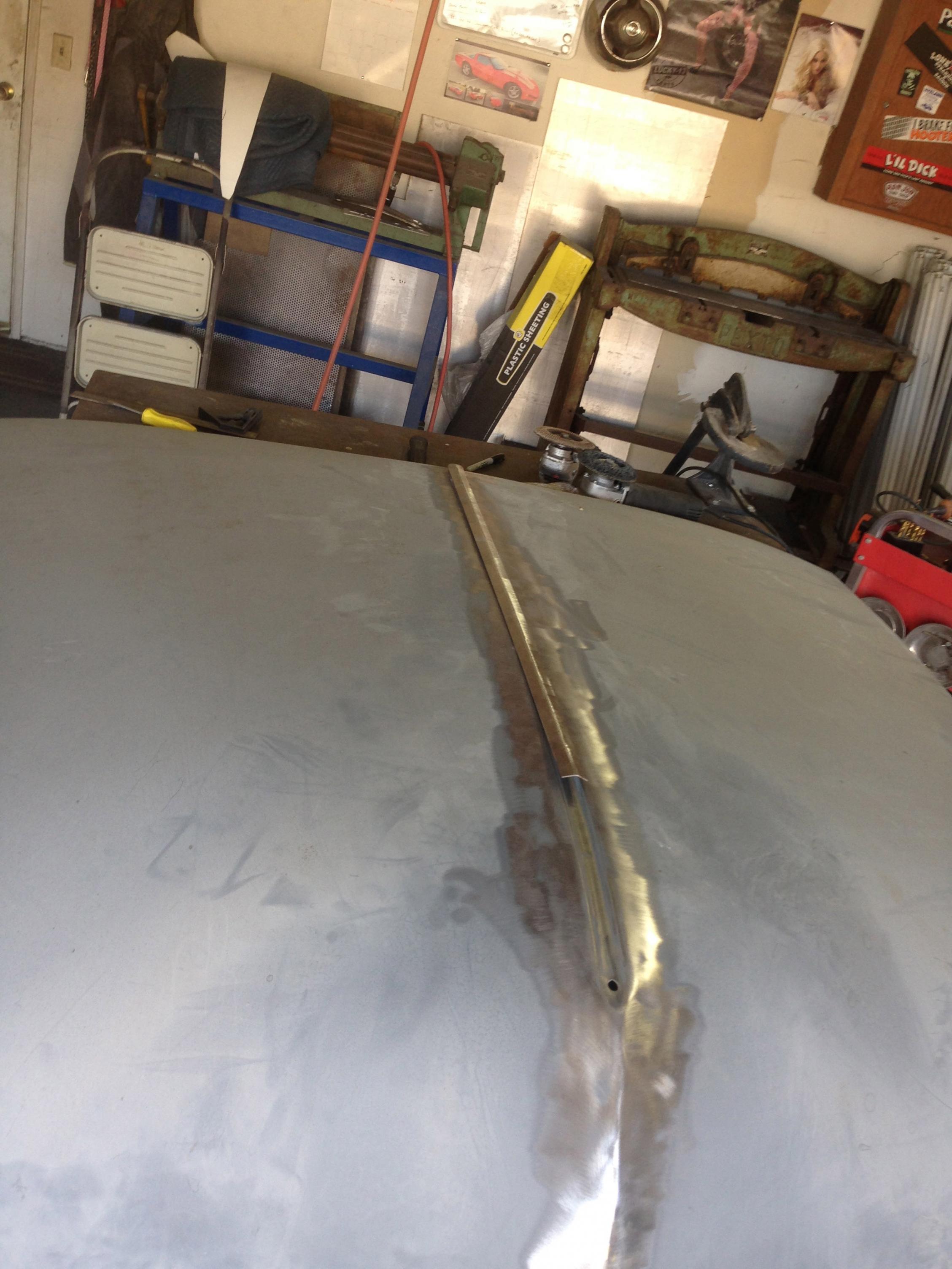

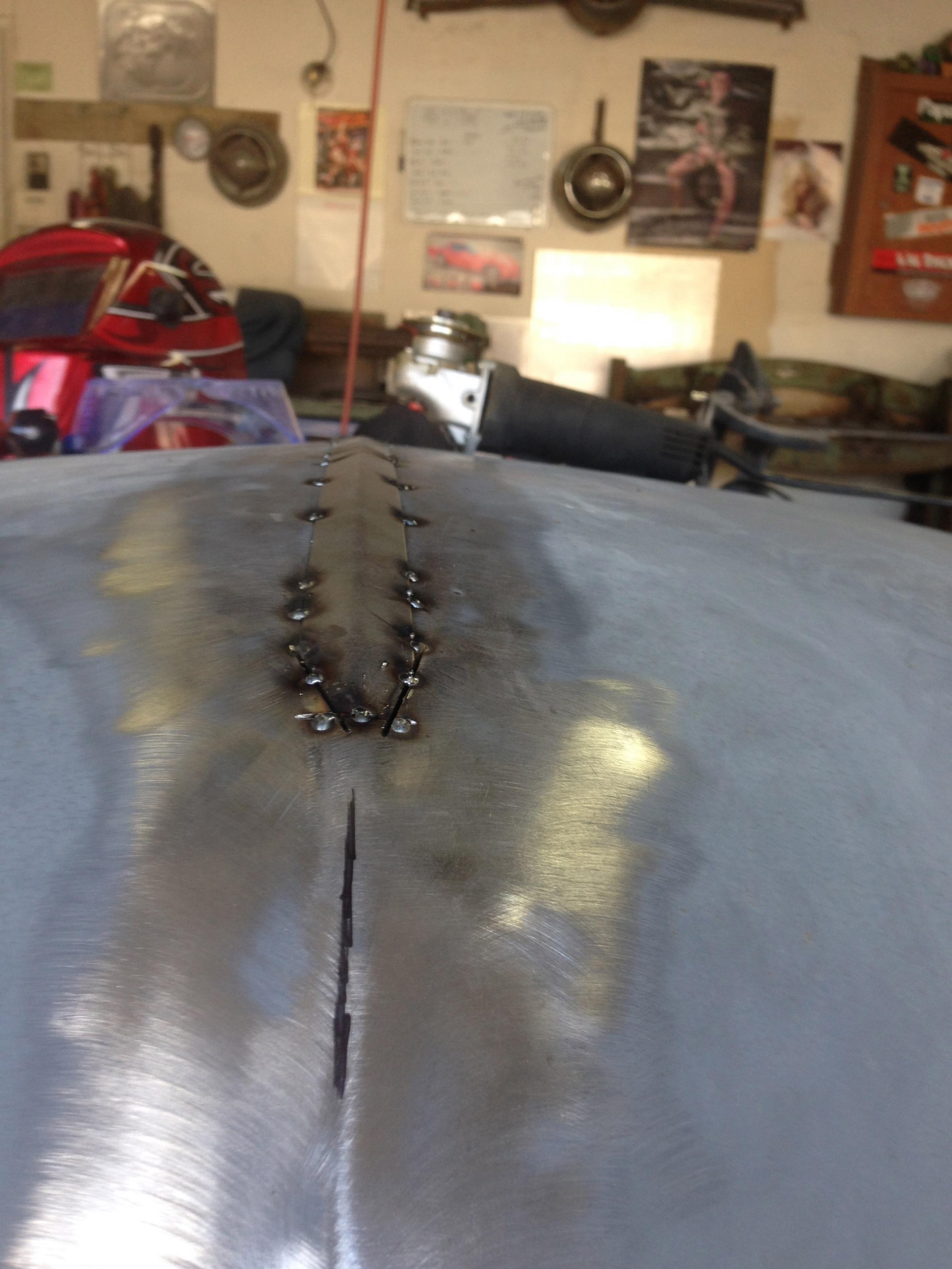

    Here is a little progress this afternoon. I filled and peaked the hood. Its not a flat peek and if I decide I don't like it I can do a little filler work and make it flat. So far I like it as its a little different than I'm used to seeing.I still have to finish the grinding,fix a little rust spot, and bang out a few dents, then the hood is good to go. I also picked up some copper tubing for hard line for the air ride and had my air tank mounts moved by a buddy of mine today so the petcock will face down when I mount it where I want it. The tank is aluminum and I only have a mig welder and steel skills at this point plus it only cost me a six pack.. Thanks Travis!
  3. el diablo

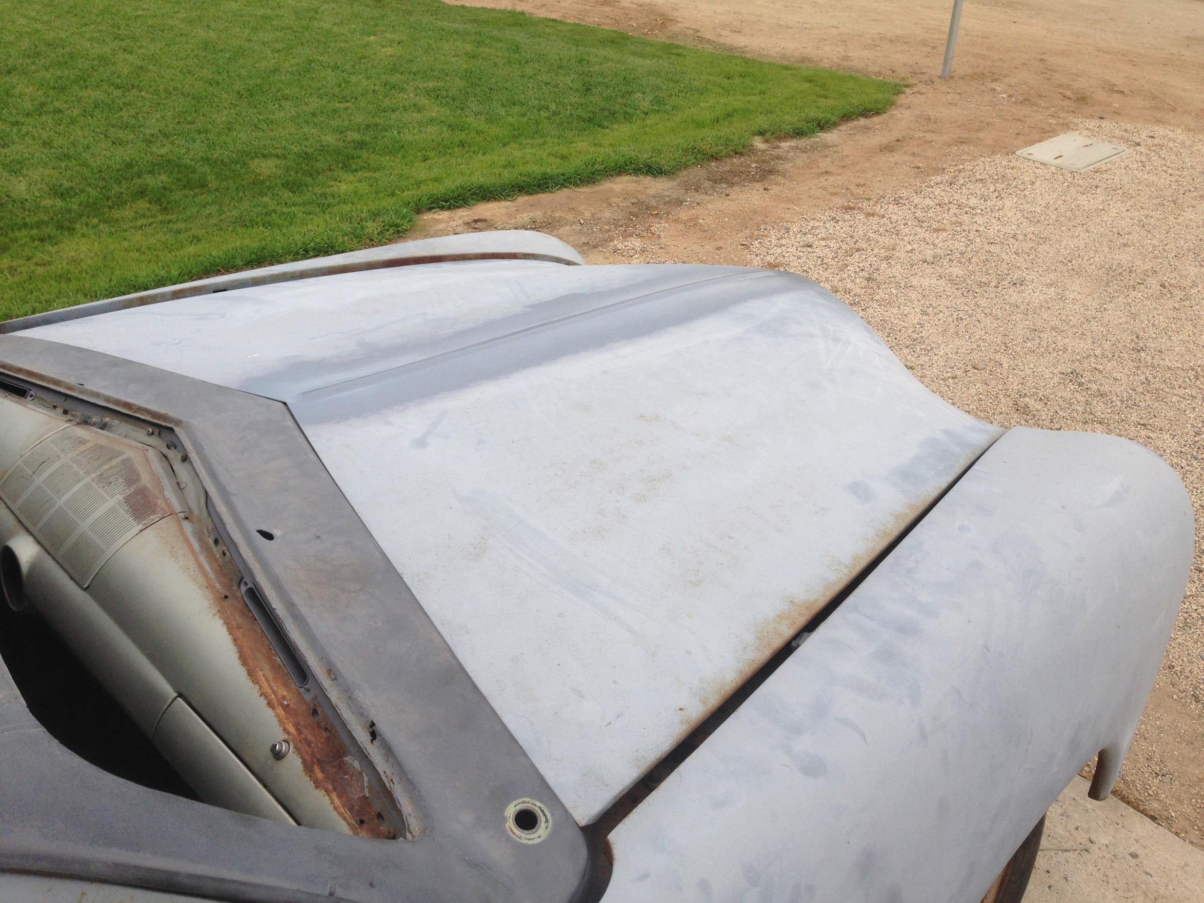

    Peak is done. Its a little higher than just a V but i figure if I grow to hate it before bodywork is done I can just fill it and make a V. I also just started mock up on the air tank and what not in the trunk so I will post pics when I figure out how I want shit.

    I did it the same way! Great job moving a long on your ride! ImageUploadedByH.A.M.B.1393250475.016342.jpg

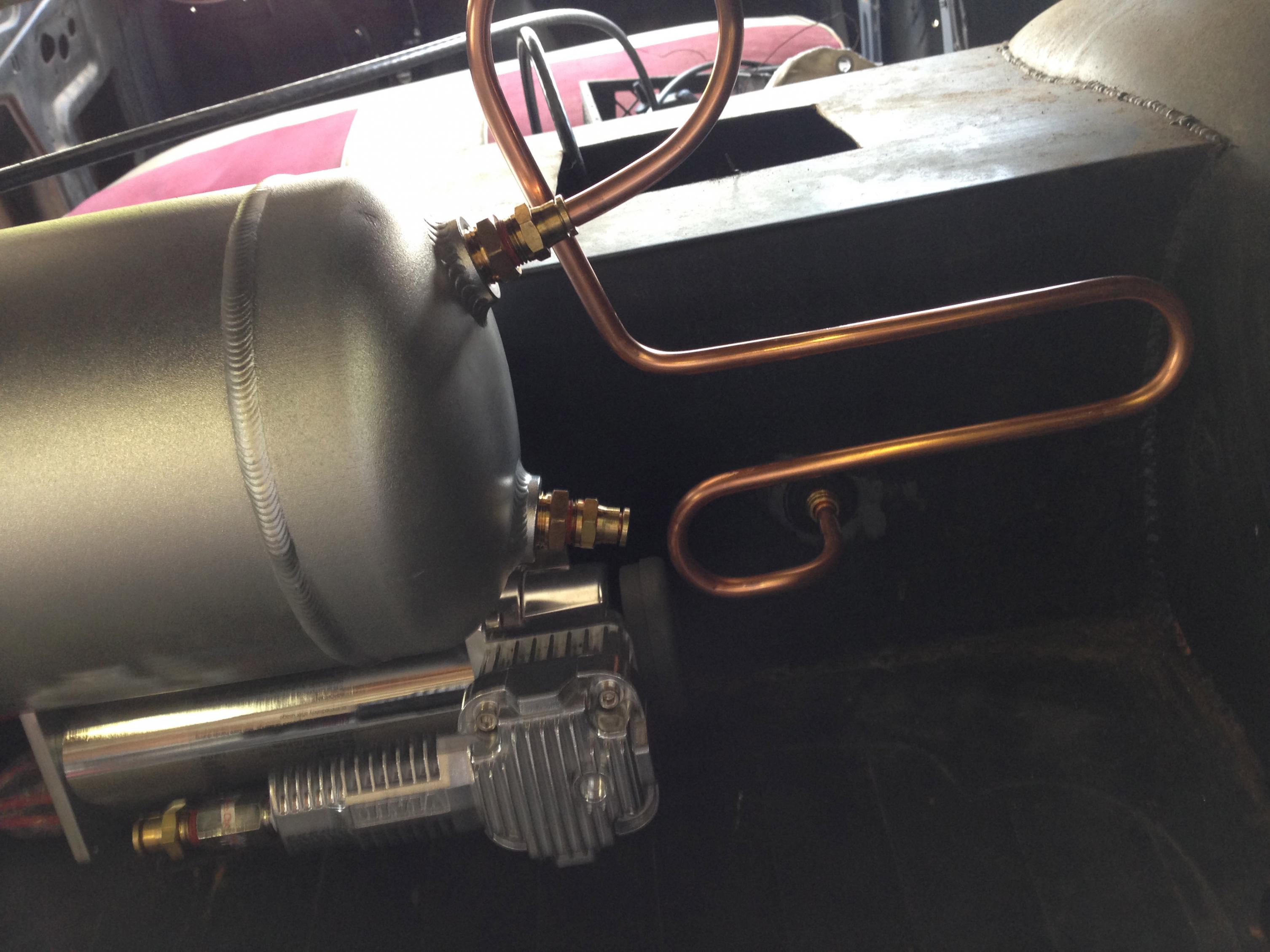

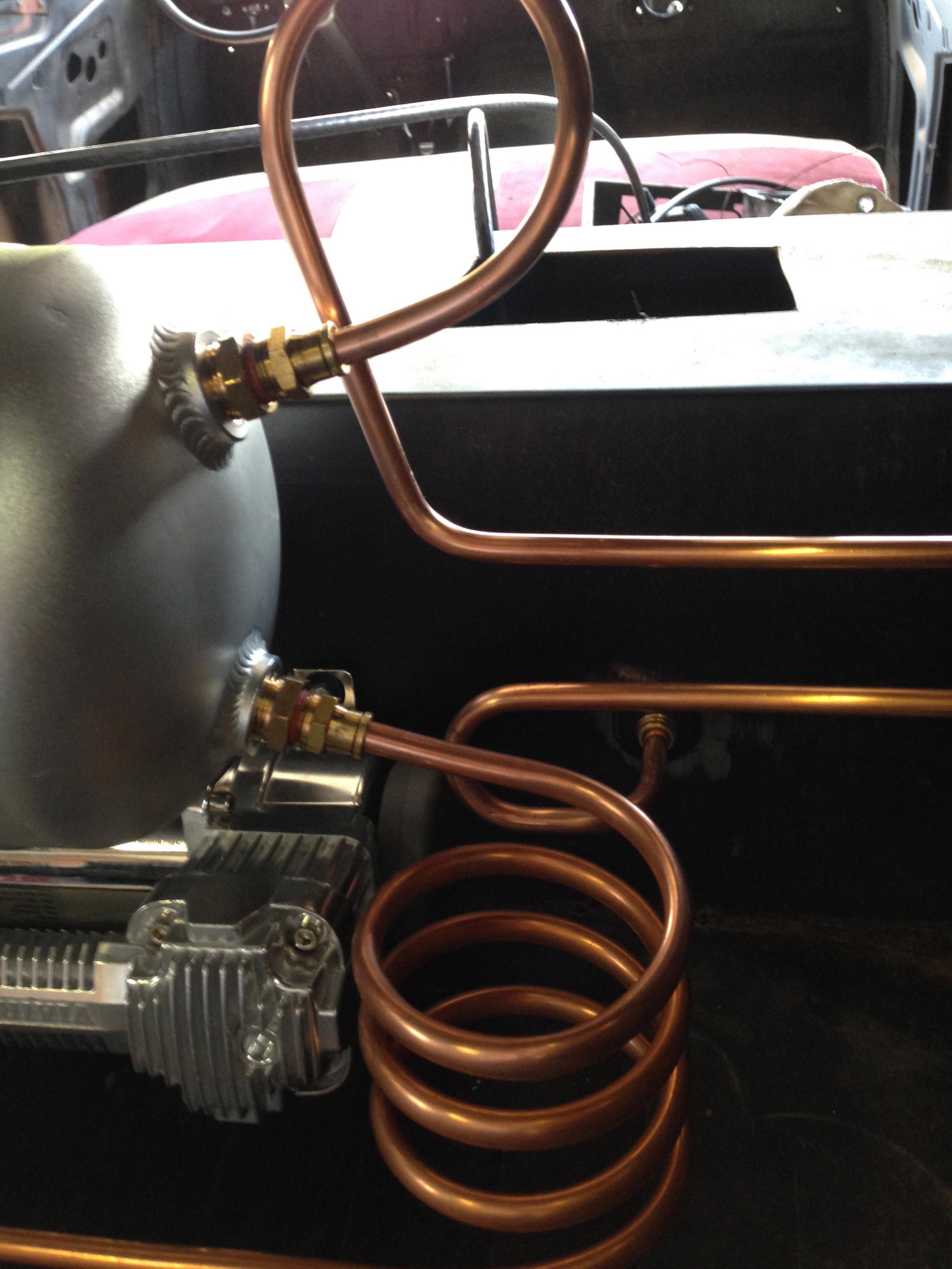

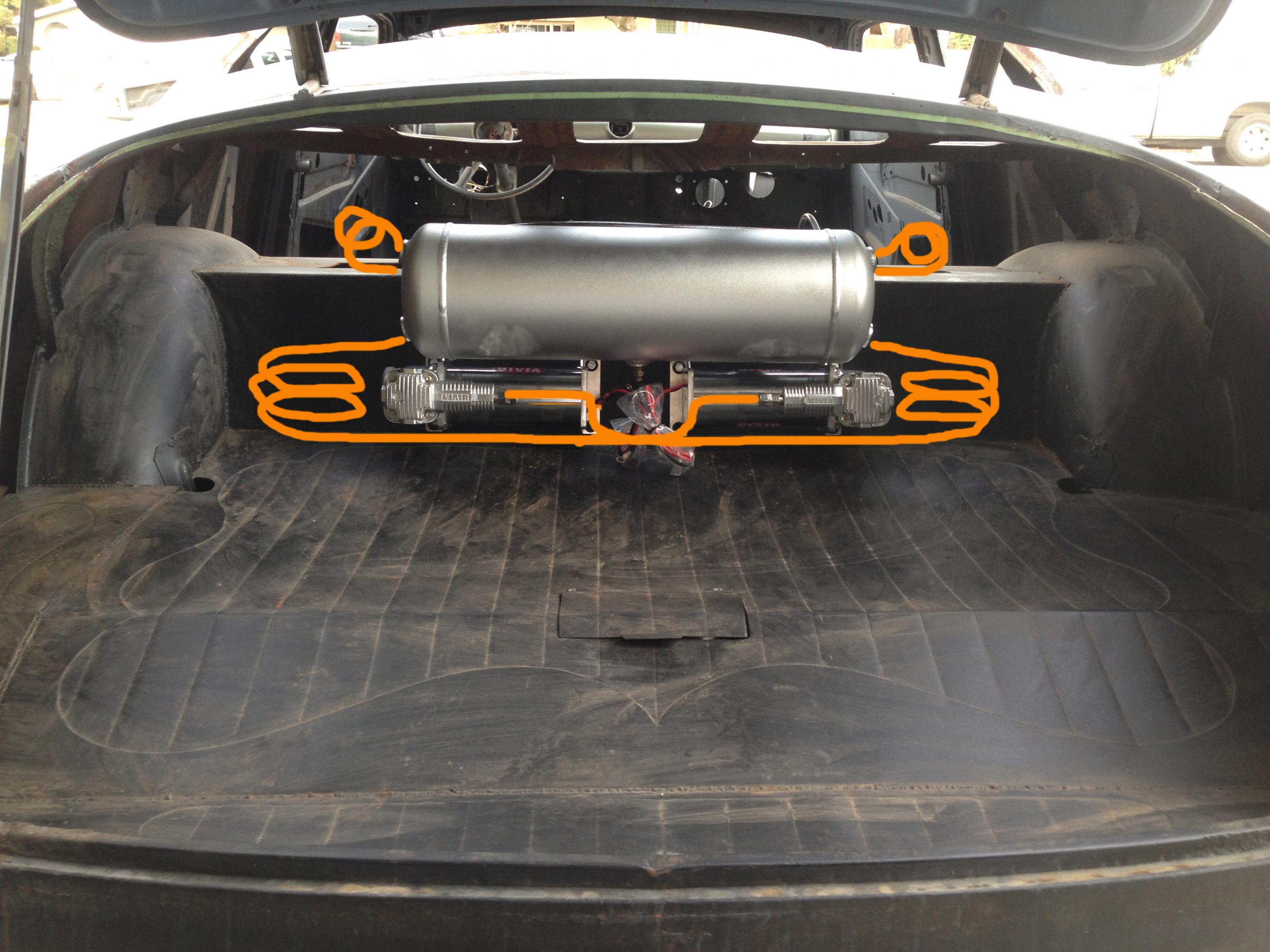

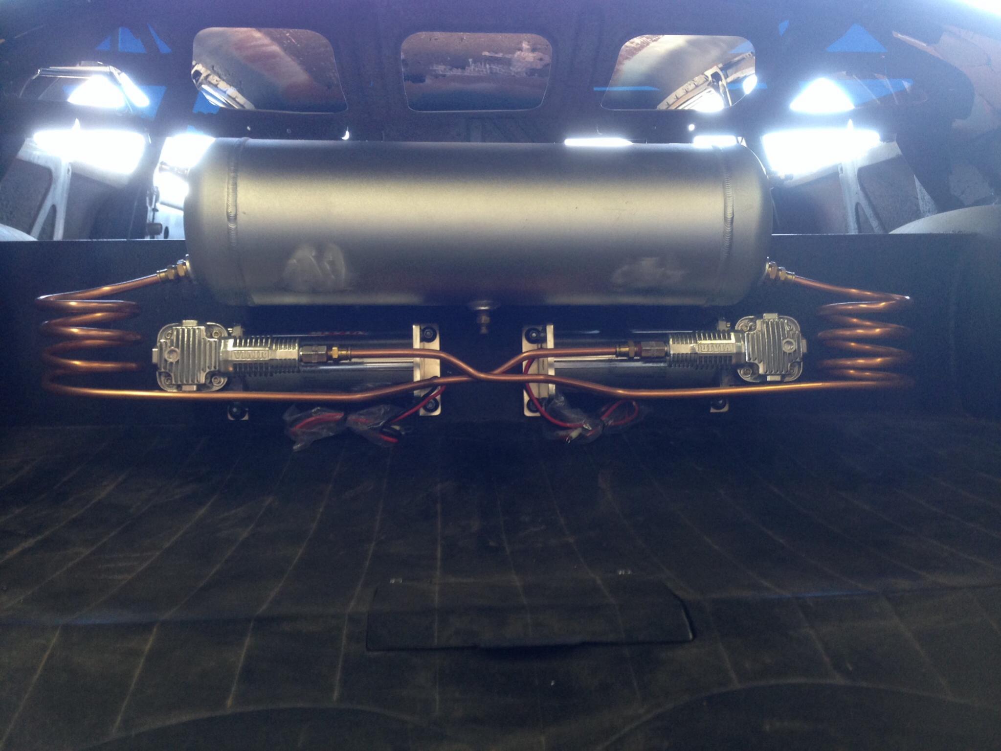

    Started mock up on the compressors for the air ride this afternoon. I moved them all over the trunk and liked this the best. I think I'm gonna ditch the stainless braided lines so all the lines in the trunk match. The big square holes up top are for bag access in case something happens on the road and I can't get under the car I can access the lines to the bags from behind the back seat. Im gonna make inserts that I will cover the holes with and also make a beauty panel in the trunk so you won't see them.

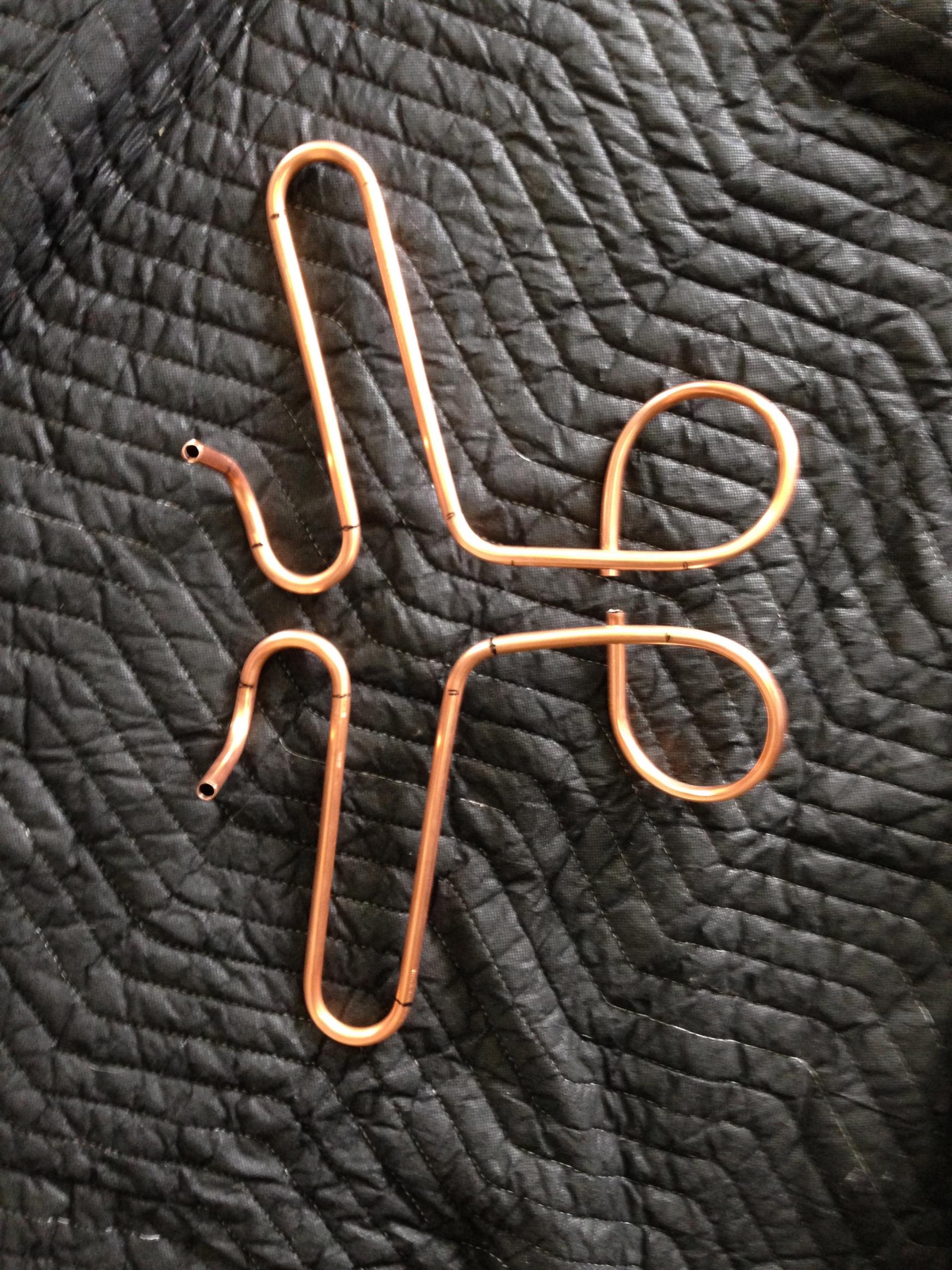

    Well the guy that owns the car I'm working on ran out of money:mad: Guess it happens when you media blast something and a good portion of the car turns out to be worse than expected..(basically the whole rear section of the car minus the trunk lid) So I figure while I finnish up some little side work and find a new car to work on, I'm gonna work my shoebox as much as I can before I run out of money to pay bills and the wife throws me out. HAHA.
    Here are my efforts from today. I wasted half the day running around this morning but any day I get to work on my car is a good day.I should be able to finish up in the trunk by tomorrow I hope, and then move on to the rest of the air install. I attached a picture of my idea that I photoshopped for the lines and what I came up with. Its nice to have a plan.

    The copper lines look good. I'm diggin them

    That is Clean !! I like the copper lines.
    Its hard to tell from the pics, but are the compressors off the trunk floor ?
    Only reason I ask is mine get pretty damn hot and would melt the floor if I run them for a long time.

    Thanks guys. I'm doing conventional style tubing to the manifolds but I wanted to do something cool in the trunk. Yeah the compressors are mounted to my notch cover and are off the floor.

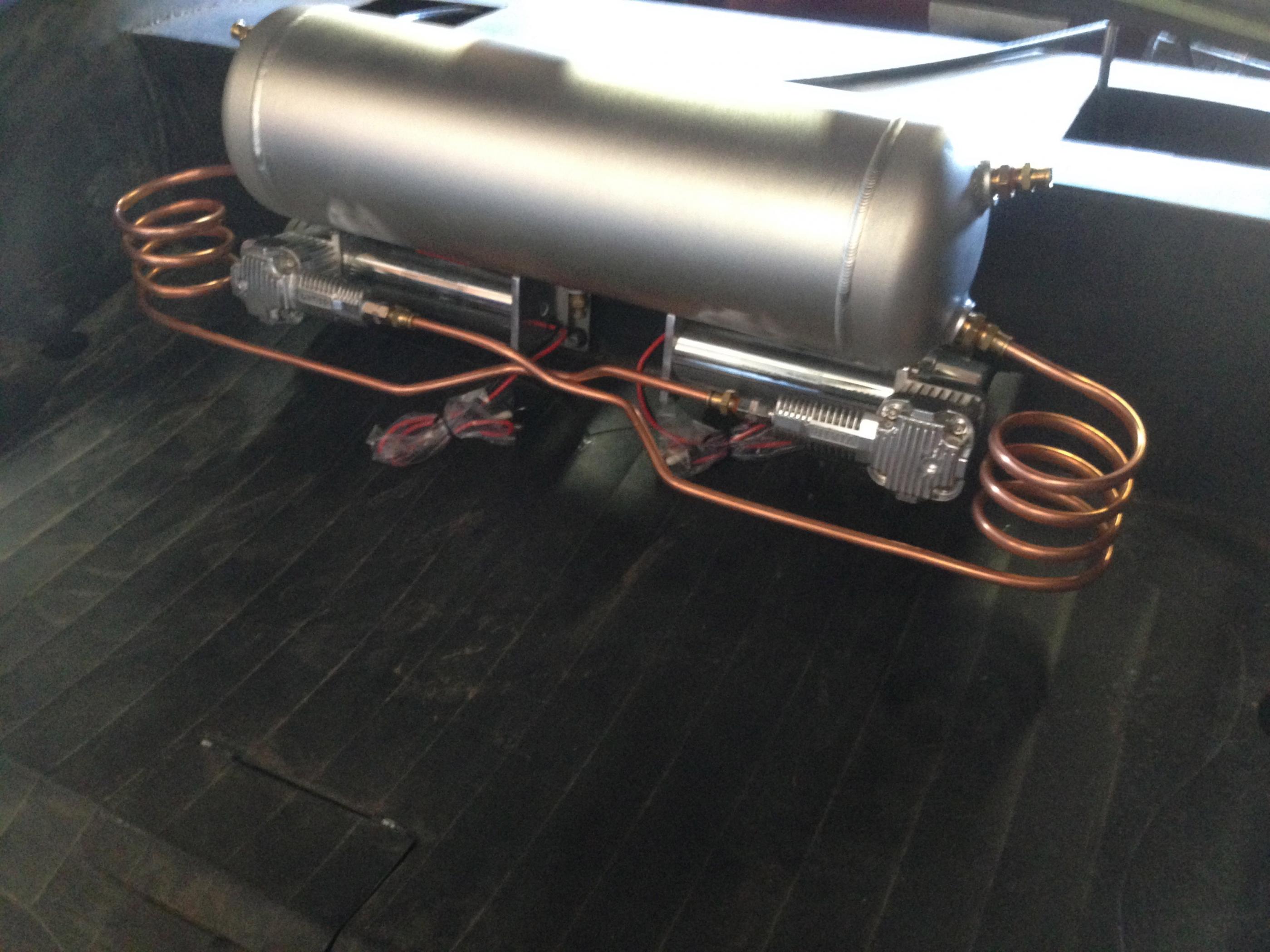

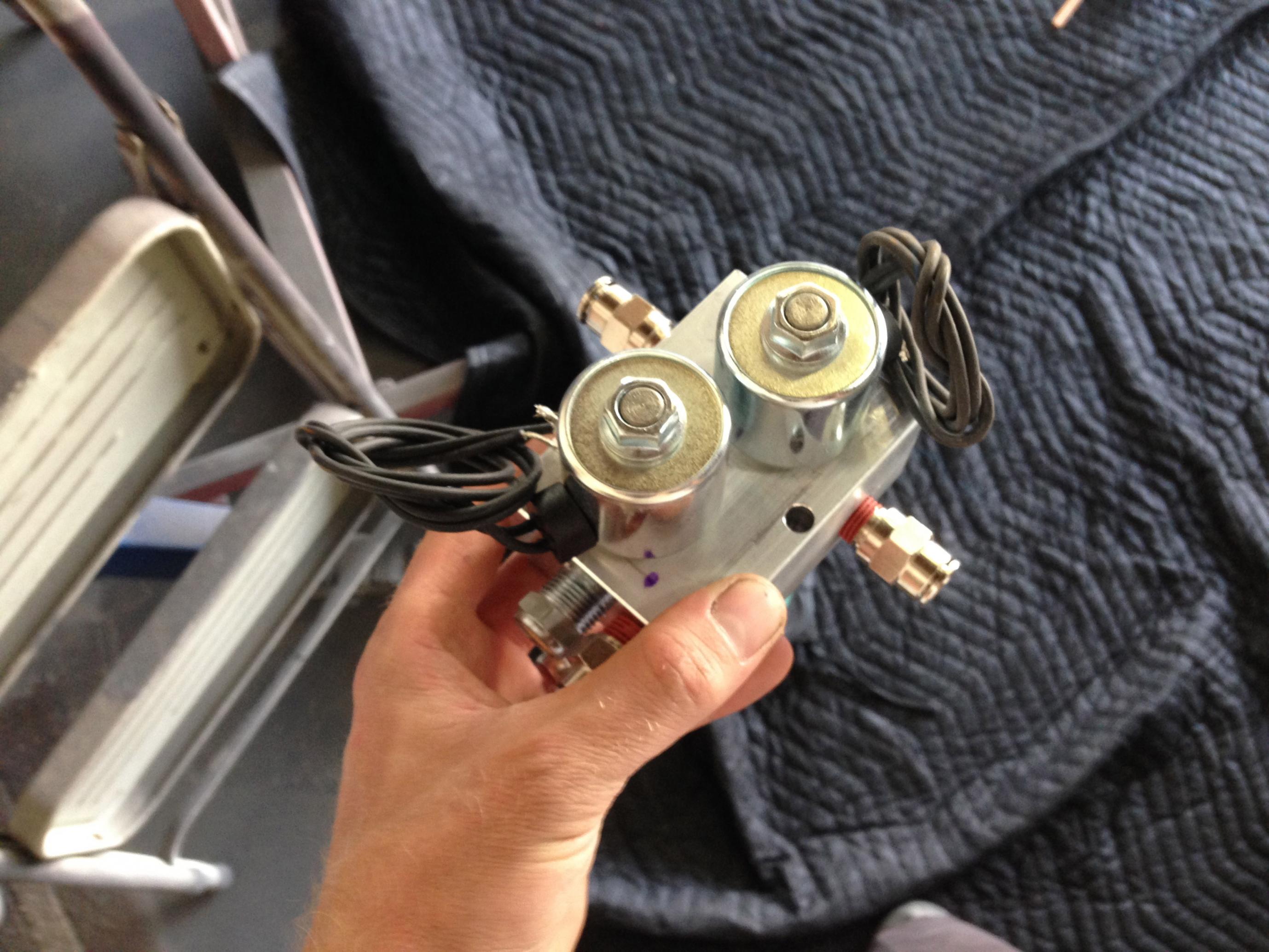

    Im using manifolds for just front and back. I figure if I wanted to I could add two more and have fbss later on. Here is a pick of the ones I'm running. My local guys sells them for 75 I'm sure you could find them cheaper if you looked.

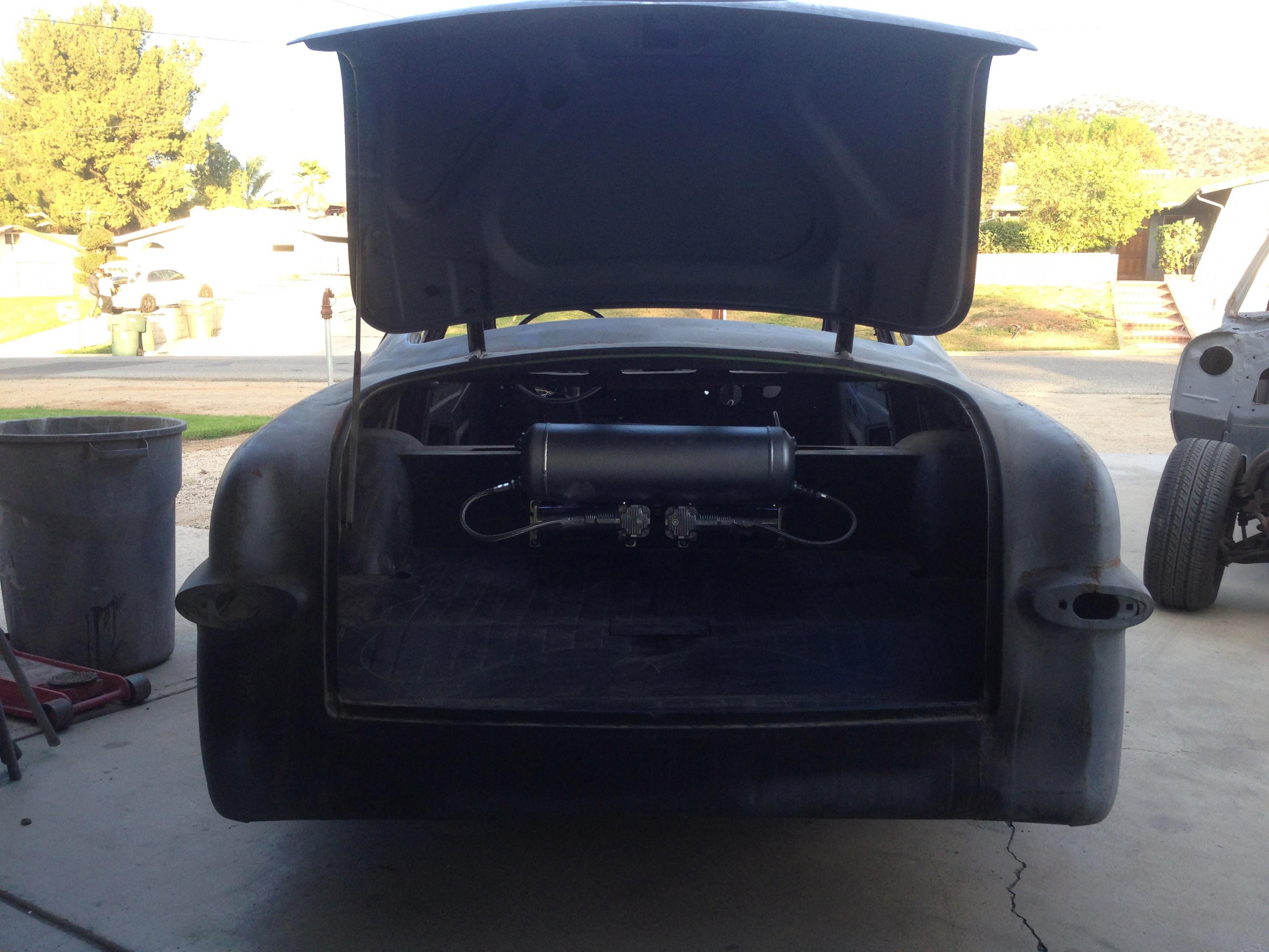

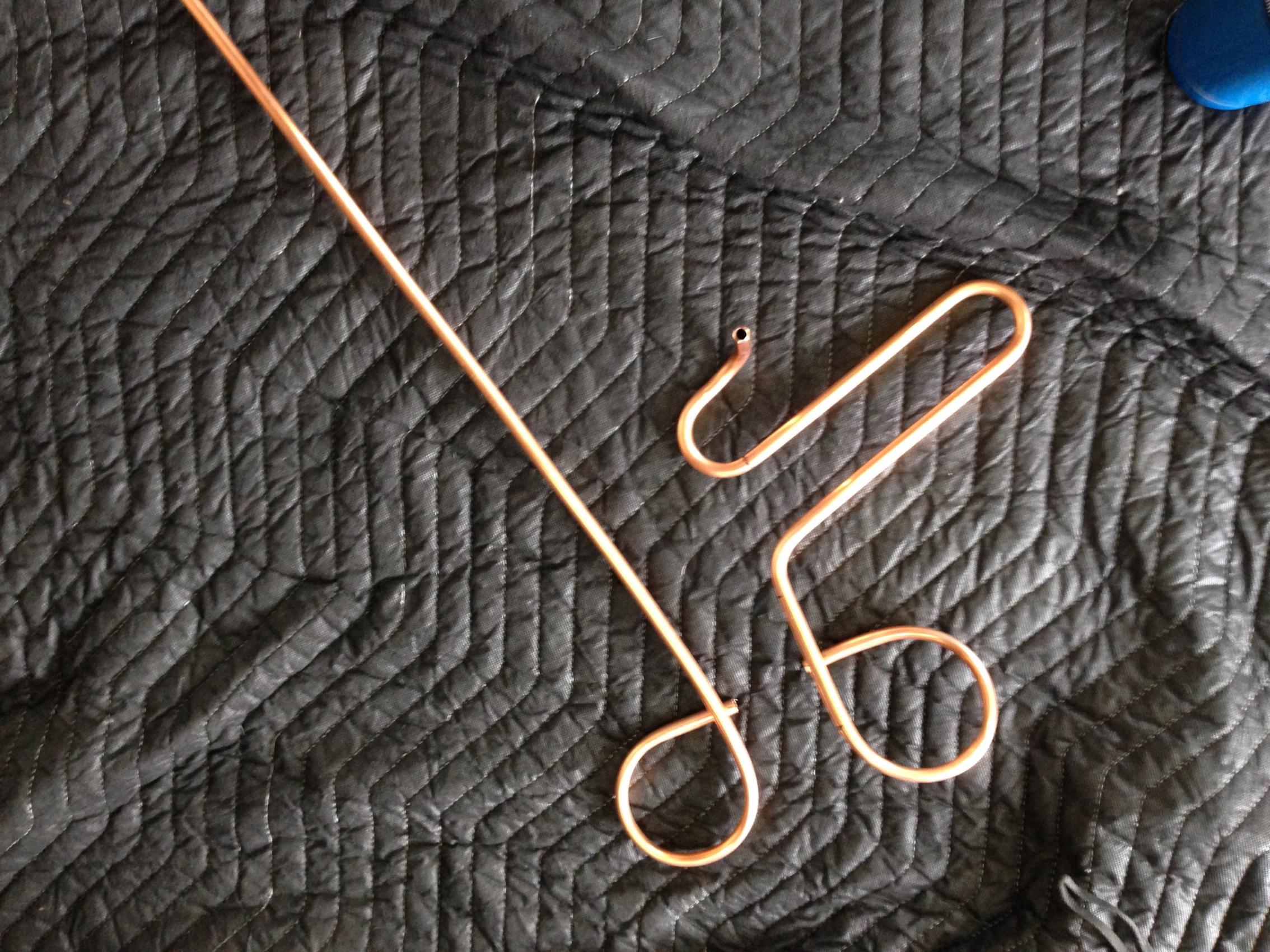

    Here are my finished trunk hard line pics with some progress pics. I changed it up a little form the original idea. I bent up a line with a big roll on top and it just looked wrong so I went back to the drawing board. I also wanted to hide the pressure switch but putting it behind the tank looked like I put it behind the tank with lines to nowhere so….. I bent up some new lines and made them "plug into the car" so to speak so the lines go somewhere and I can hide all the rest of the crap on the back of the cover.:D The brass fittings are heavy and I have no idea if the line would support the weight of a fitting hanging out in space after a few good bumps on the road so I used grommets that the fittings fit into to pass it through the panel. The grommets will hold fittings and keep the line in place. I have no idea if any of this shit is gonna work but it sure looks cool!HAHA.

    Damn I hope that works because its looks sick !!
    Very cool set up

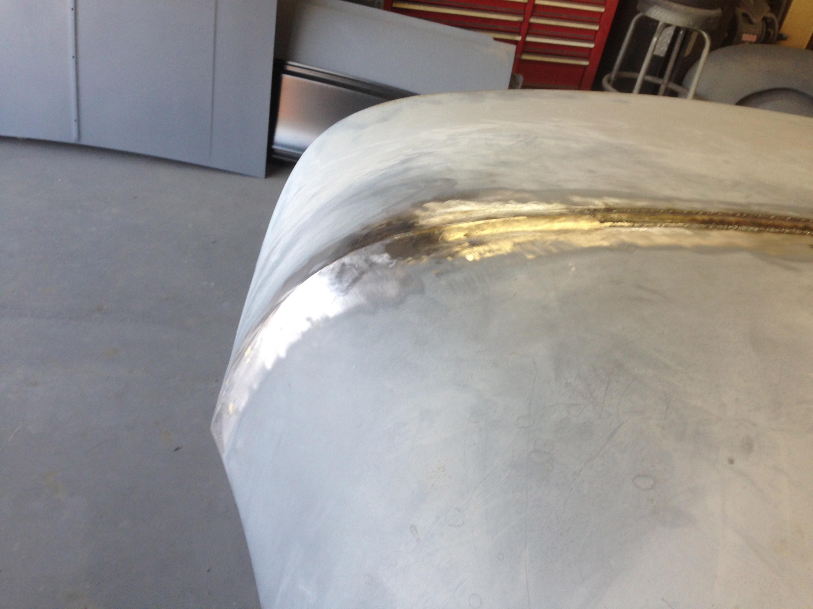

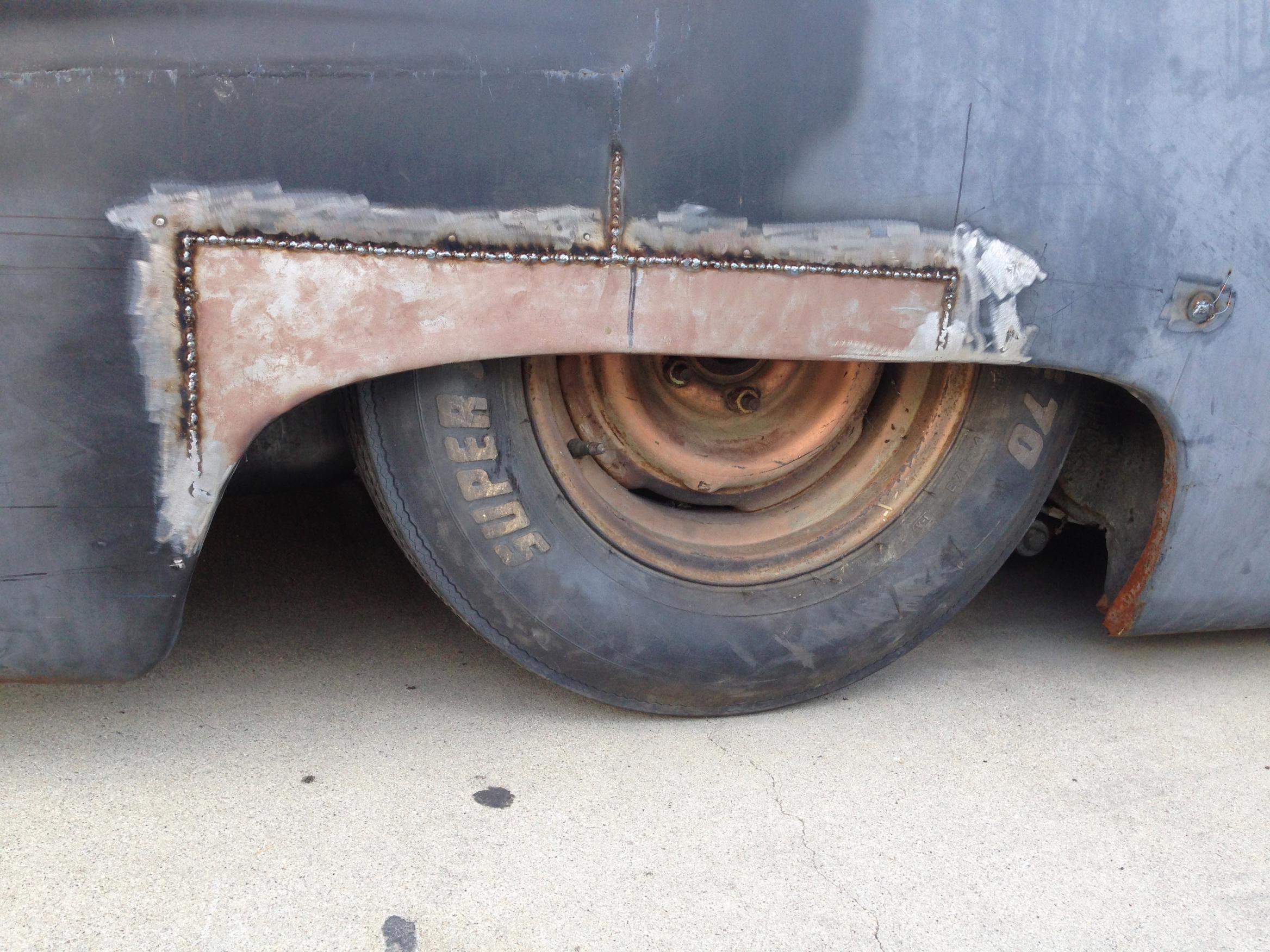

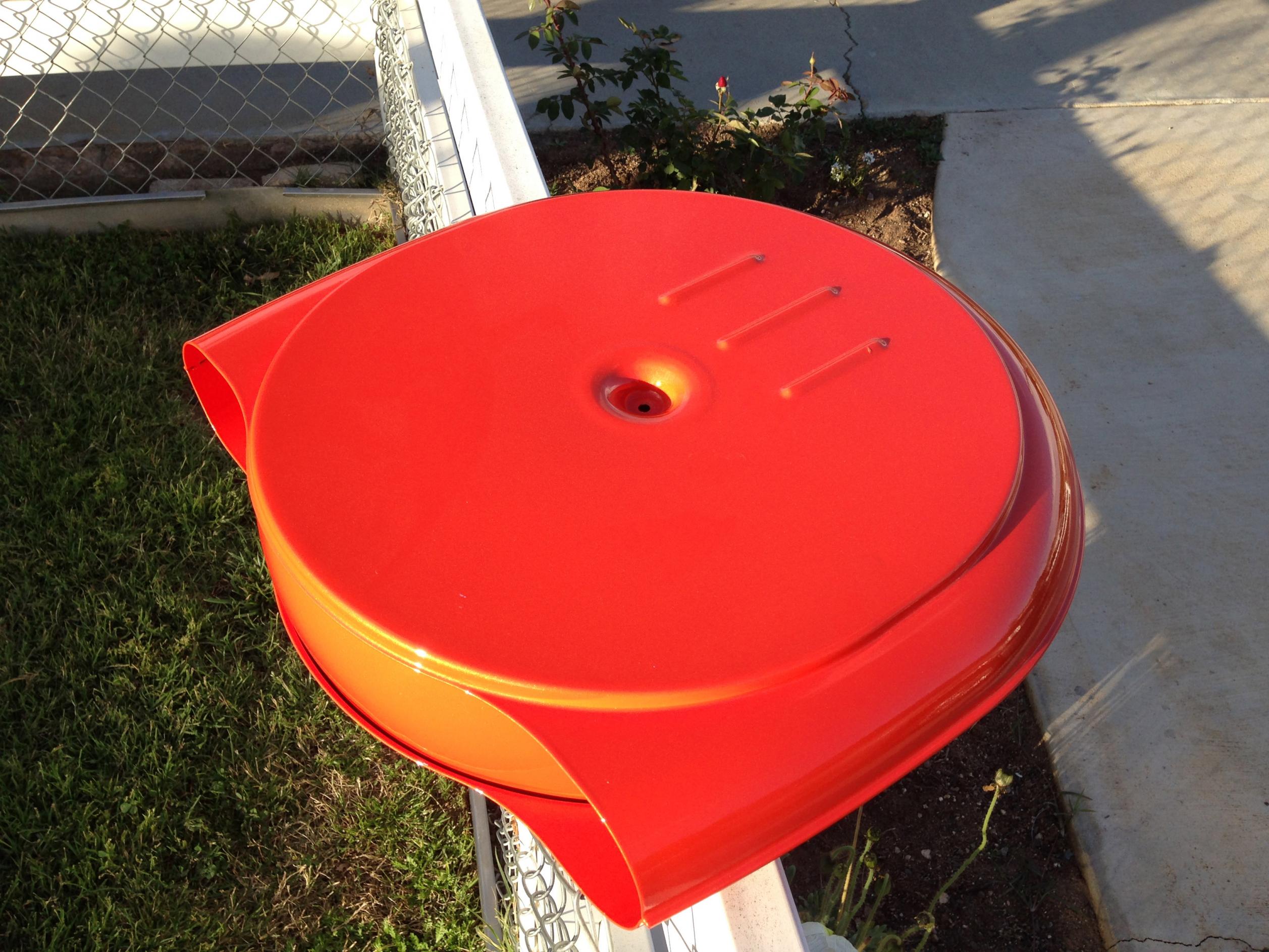

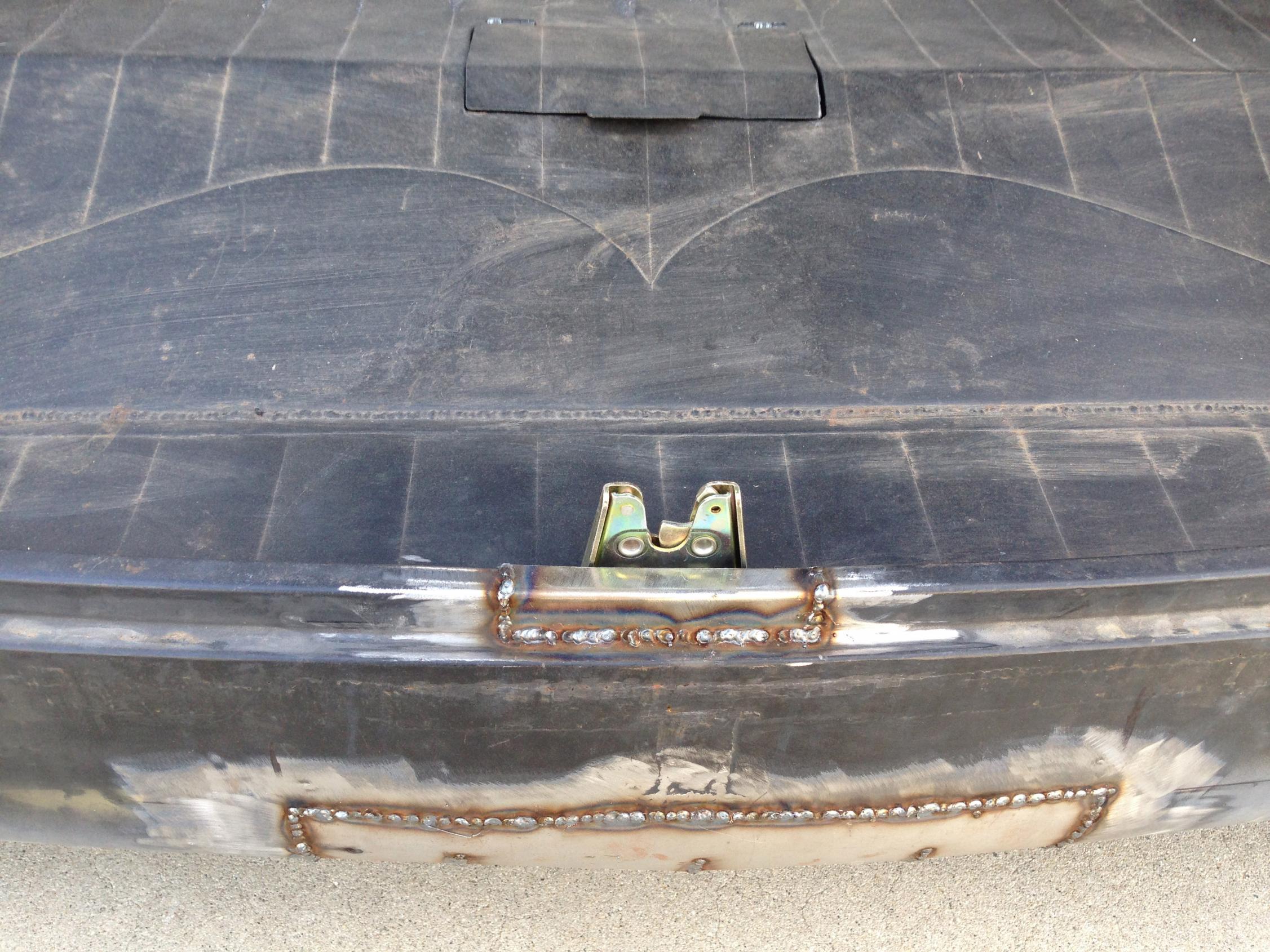

    Here is a small update on my car. I mounted the trunk latch (Thanks again beyond static!) and welded up some damage on my roll pan and fixed some old patch work that I did a few years back…. its nice to have tools now. I have to figure out my grill situation and fit the sheet metal better before I can brake stuff down and start any sort of body work. I will also have to blast my parts again and strip the car for a re-prime as well…. wish I had a larger garage and my car could stay in doors till it was done.
    I also went down to the paint shop and had my local guy mix me up some color so I shot my air cleaner with it as a tester. It's the second orange color I have tried and I dig it. The first one was too dark and fell flat with out sunlight. I have a long way to go before paint but I want to make sure of the color before I wast all that money and then hate it in a month… HAHA.

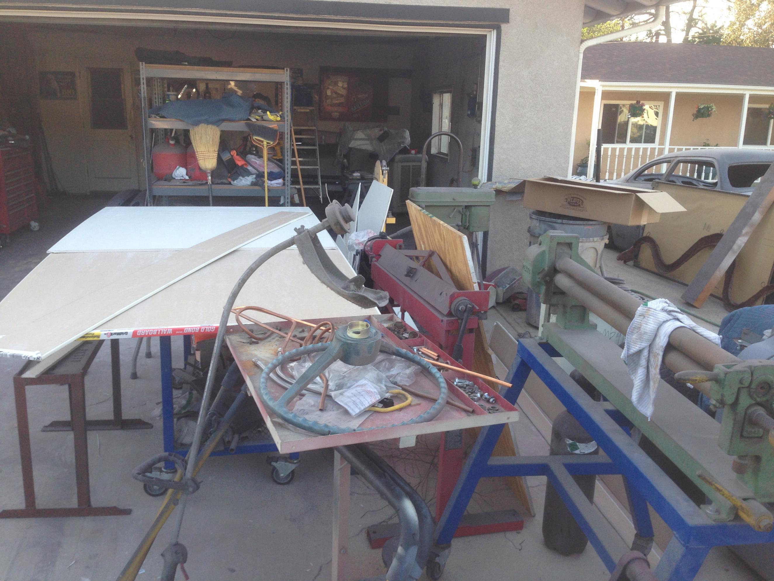

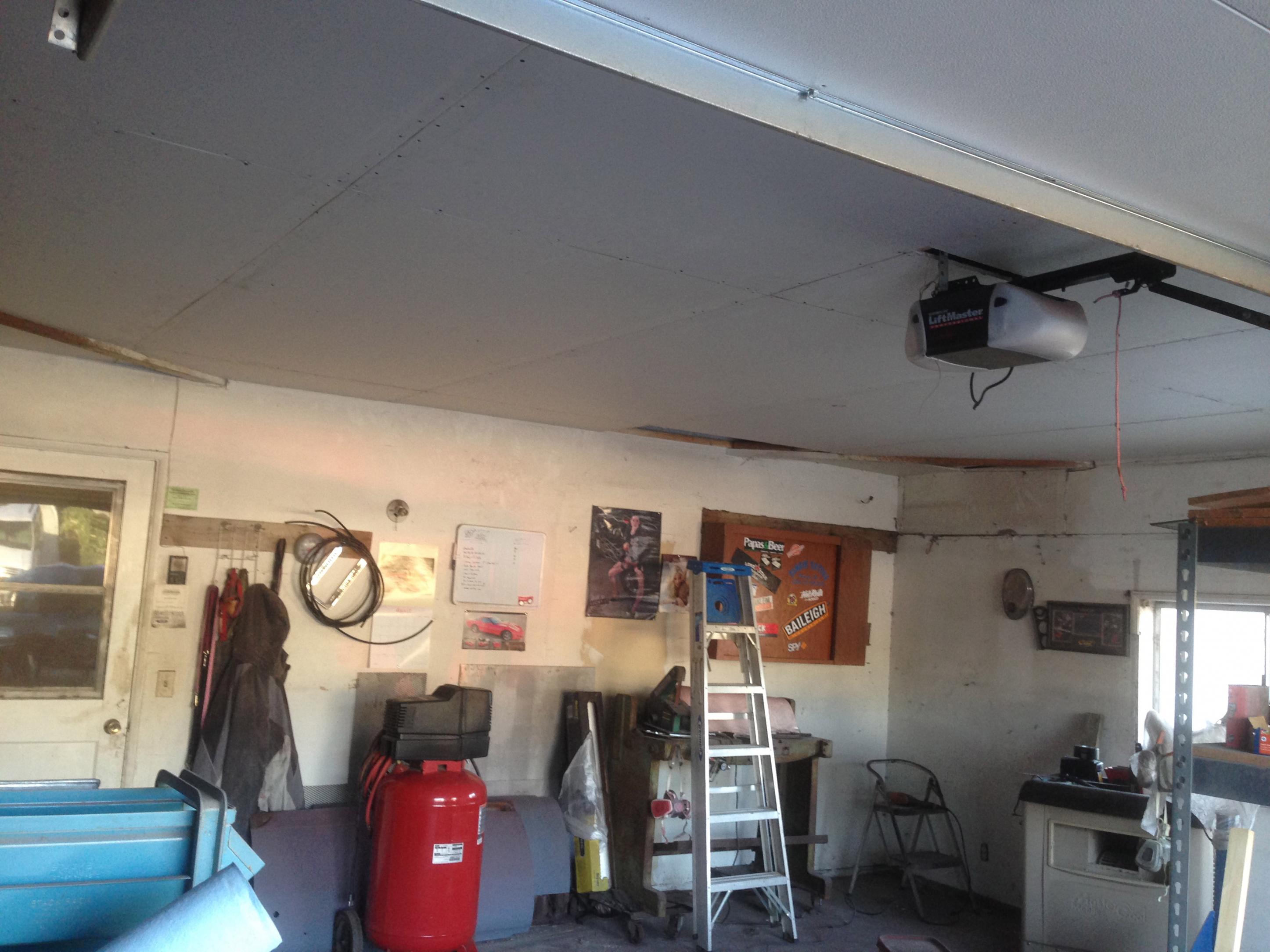

    So my compressor blew up (120 gallon 1943 westinghouse monster) and I'm in the middle of drywalling my "shop" till my new compressor gets here. Man I like drywall a lot less than working on cars thats for sure, so if you do drywall for a living my hat is off to you!

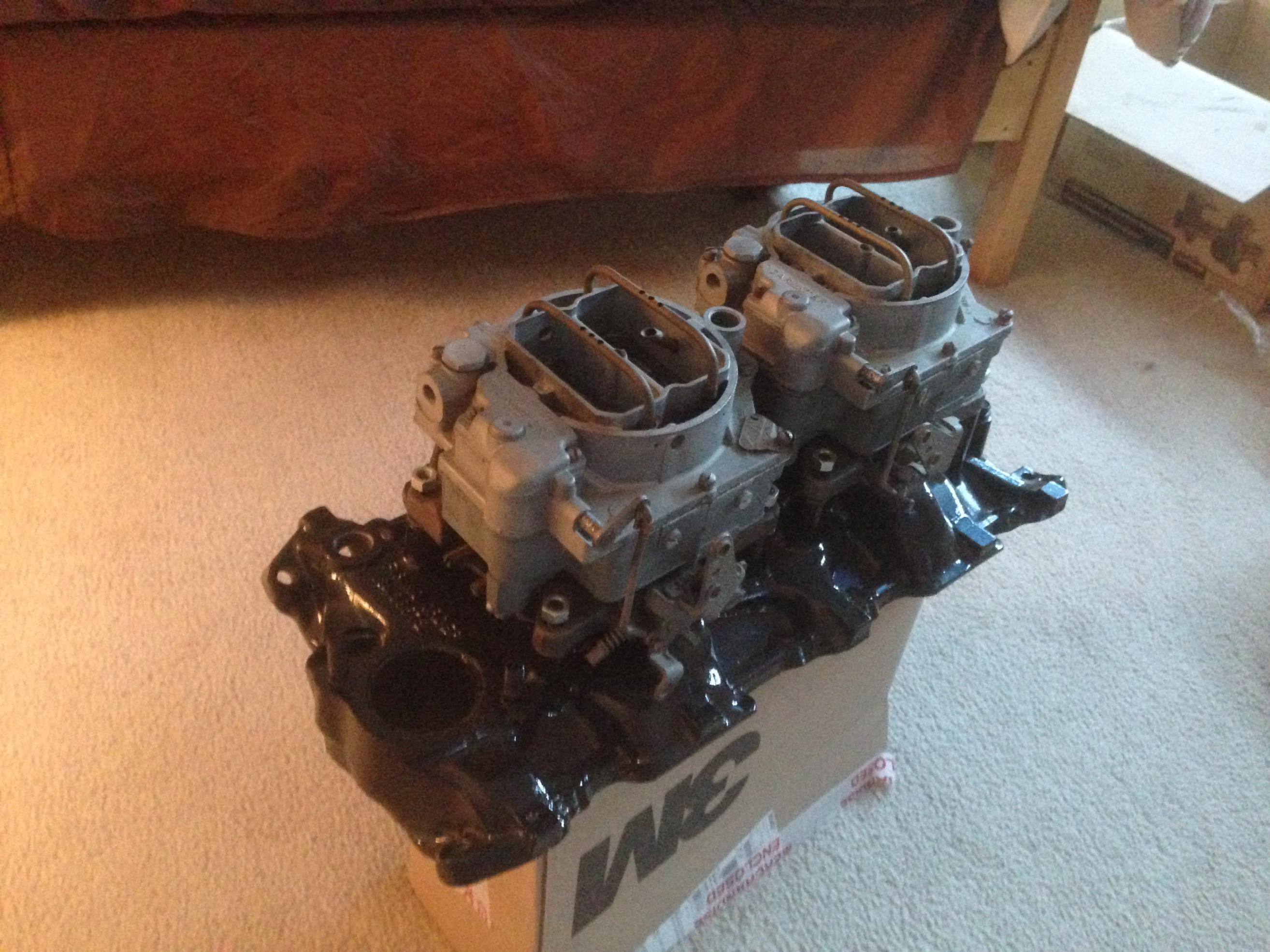

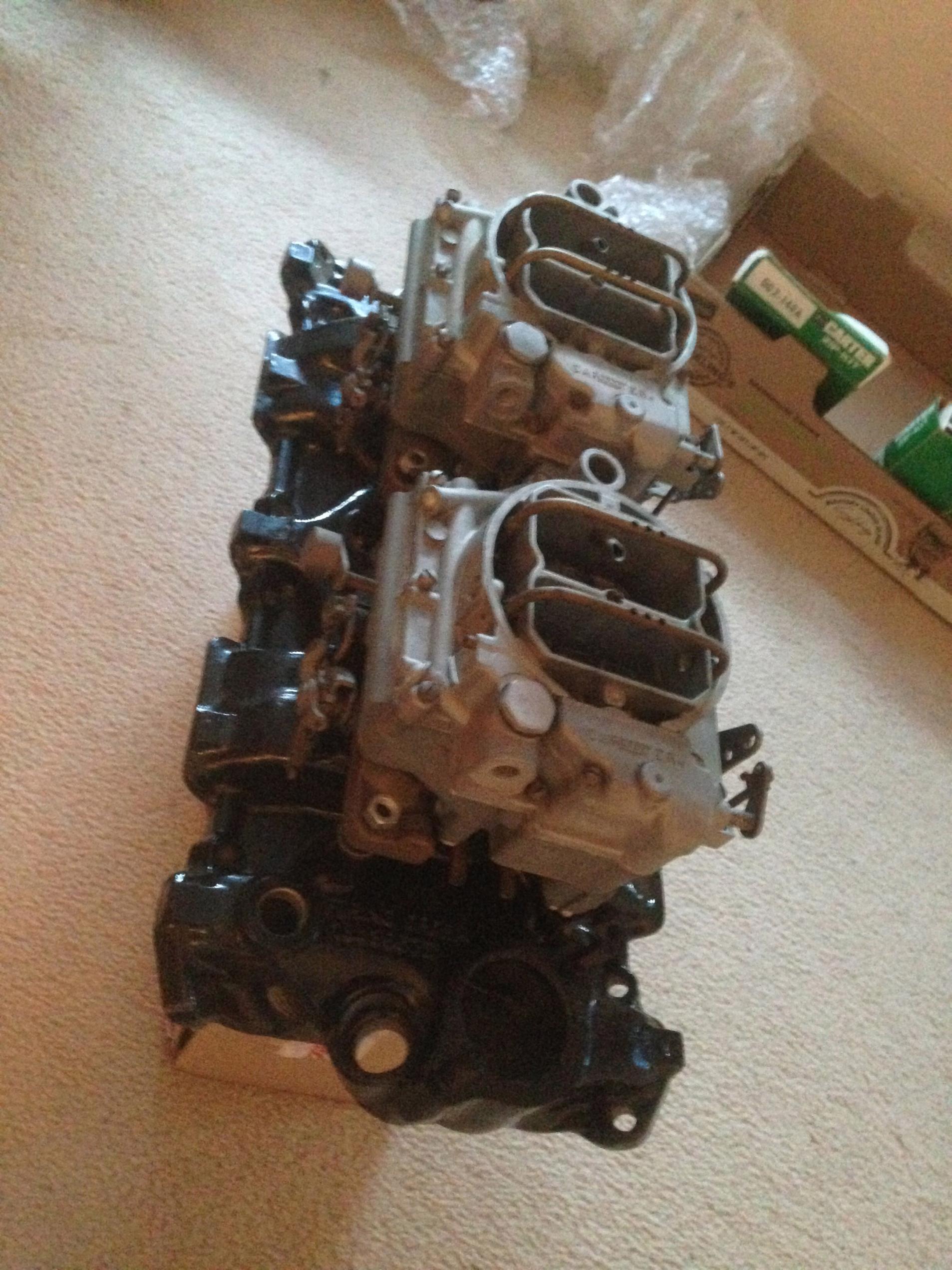

    I also got the dual carb set up I did work for about a year ago…. I was going to run them on the shoebox but might just bag them up and shove them in the closet till I can put a model A or some sort of hot rod under them??? I need to rebuild the carbs at some point as well. Yes the manifold is black but its the original.
    Should have the drywall up by tomorrow and the new compressor as well. My friend Rick is gonna come over sunday and wire up some new lighting and my compressor so I should be up and running by Monday fingers crossed.
    I also got a hamb friendly car to build (51 studibaker) but the guy wants billet wheels and such so I wont be dong a build on it but maybe one of these days ill talk someone into letting me do a traditional style custom for them and its on.
    Thanks for the support guys and I will post more on here when can get back on the shoebox.
