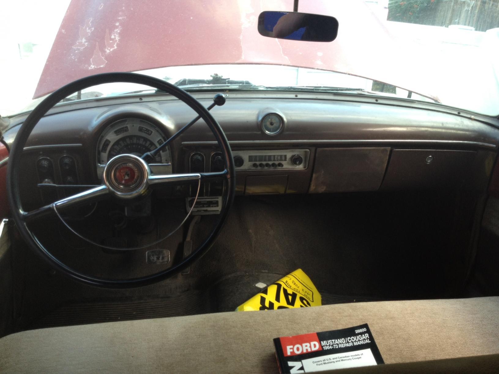

    3) Nothing on the dash works so I need to install aftermarket gauges to see if the engine is overheating mainly.

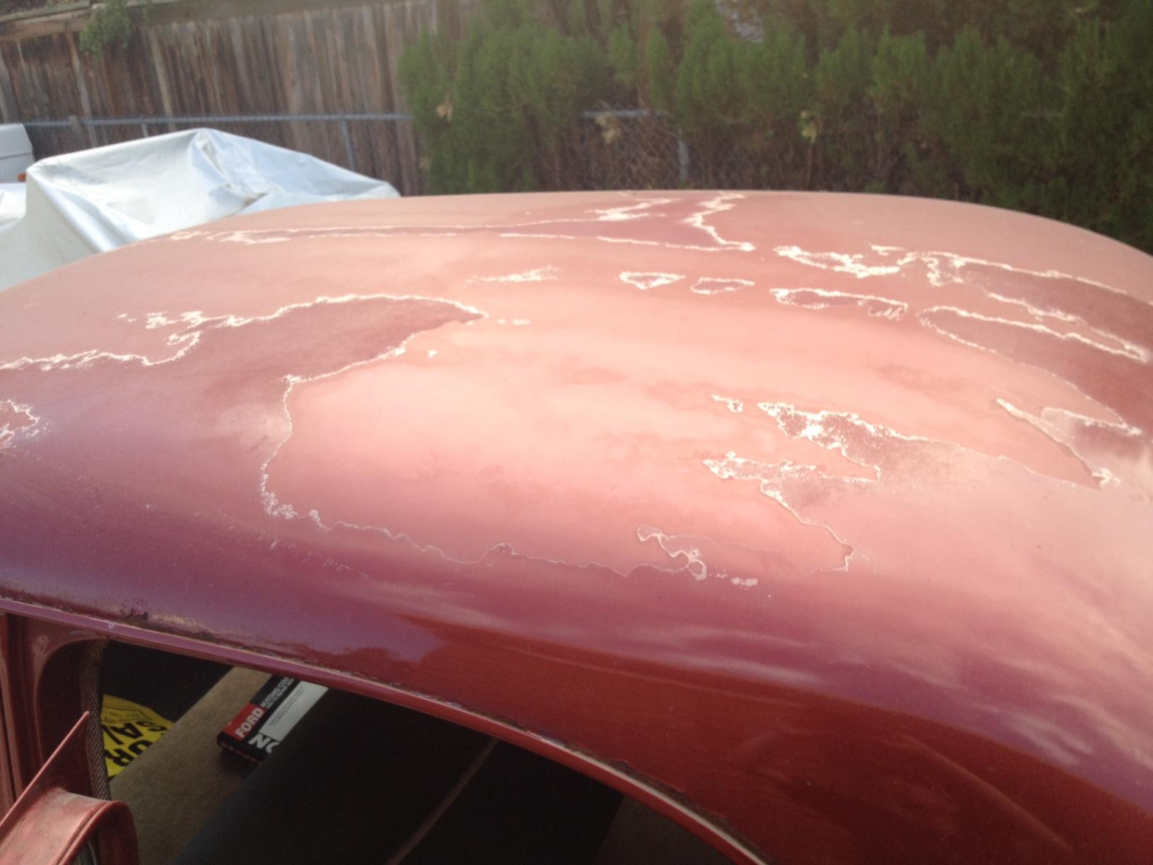

    1) Figure out how much rust there is: I signed up for a beginner auto body class that starts in 2 weeks. The instructor should set me straight.

    4) clean up wiring, try to get some or all things in dashboard working. Try not set the car on fire.

    A more realistic view of the paint job:

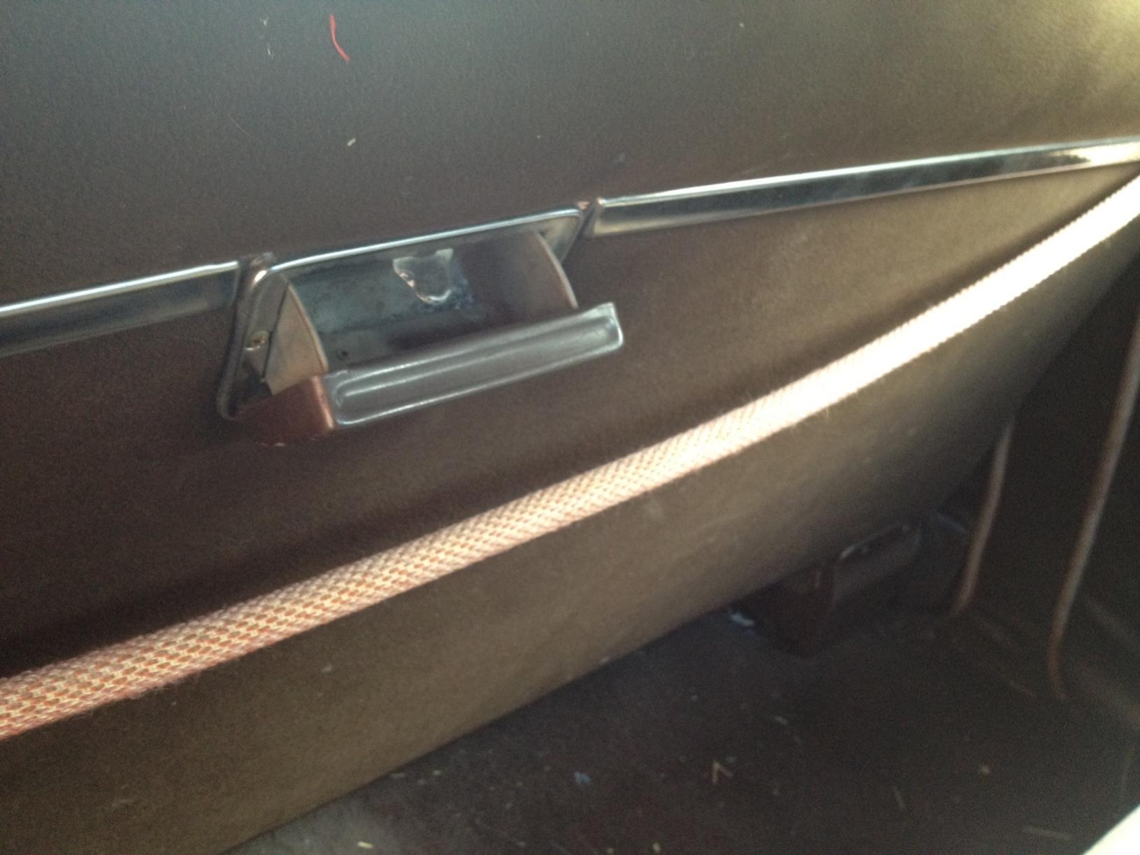

    Did the original cars come with a rope like this on the back of the front seat?

    So what am I missing on my to-do list? Or even a check-it-over list for a purchase like this? Any advice is awesome, and any cracks at my inability are deserved! Thanks again, here goes nothing...and sorry about the pics I'll do better next time. Can't fix them for some reason.

    first of all; don't jump into trying to remedy everything at once. that's probably what killed it for the LAST guy!
    and, what you're calling a restoration is NOT what they did to it. it might be called more properly resto-rodding, or street cruiser in those days.
    it's good to have a list of areas/things you want to address; but keep your bites small and chewable. tackle one thing at a time.
    BTW, that's called a robe rope and it was intended to hold a "car robe" or blanket in cold weather. most cars didn't have stock heaters in those days. good luck with your new toy and keep us up to date!

    'Street cruiser', I like it! Funny to hear the rope is for blankets. I thought it was an 'Oh Sh*t Rope'. And thanks for the advice on small chunks, I'll keep that in mind.

    The rope is where you hung your lap robe.

  10. heaters were an option until 64/65, the rope was for the kids standing in the back to hold on to. keep it simple do what's needed to turn it into a driver safety first then upgrade from there.
