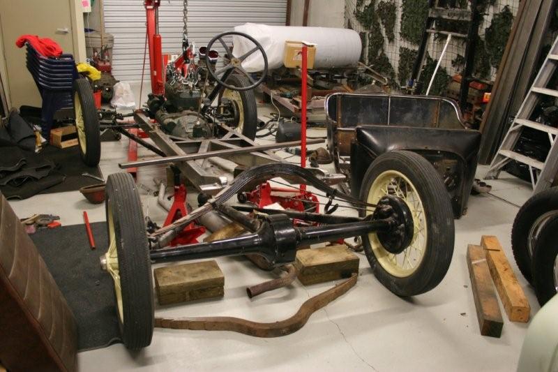

  2. Tonight was the first night back on the T
    I tweaked the pedals and got the steering box in
    Pedals need more tweaking then I have to make the throttle fit
    Note the tight confines where the exhaust port is
  3. Yup - I've had similar dilemmas trying to fit it all in with a RHD steering box. Guess that makes us TWO awkward cusses...

    You probably said and I missed it. That’s the Model A spring, isn’t it? I’ve been told that if you use a T spring on an A axle, that the additional spread required lowers the rear end about an inch.
    -Dave
  11. Not sure if I am using the T or A spring yet
    Here are a few more shots of the steering in.
  12. Well, yep I used the T spring and yes it is about an inch lower.
    Also extended chassis to pick it up on top of diff.
    Rear quick up is now about three inches
    Also been doing the tabs to mount sheetmetal to frame and about to go out and fold up the box to mount the turtle deck.
    Stay tuned!

  15. Thanks guys, tonight I made the sheetmetal work for the turtle deck to sit on.
    Just need to finish mounting it.
  16. Today I finished a few more things to get the T complete to store at my Dad's place as my place is over filling!
    Front end bolted in - still to lengthen wishbone
    Rear turtle deck mounted
    Still gotta chop the screen and fit the door
