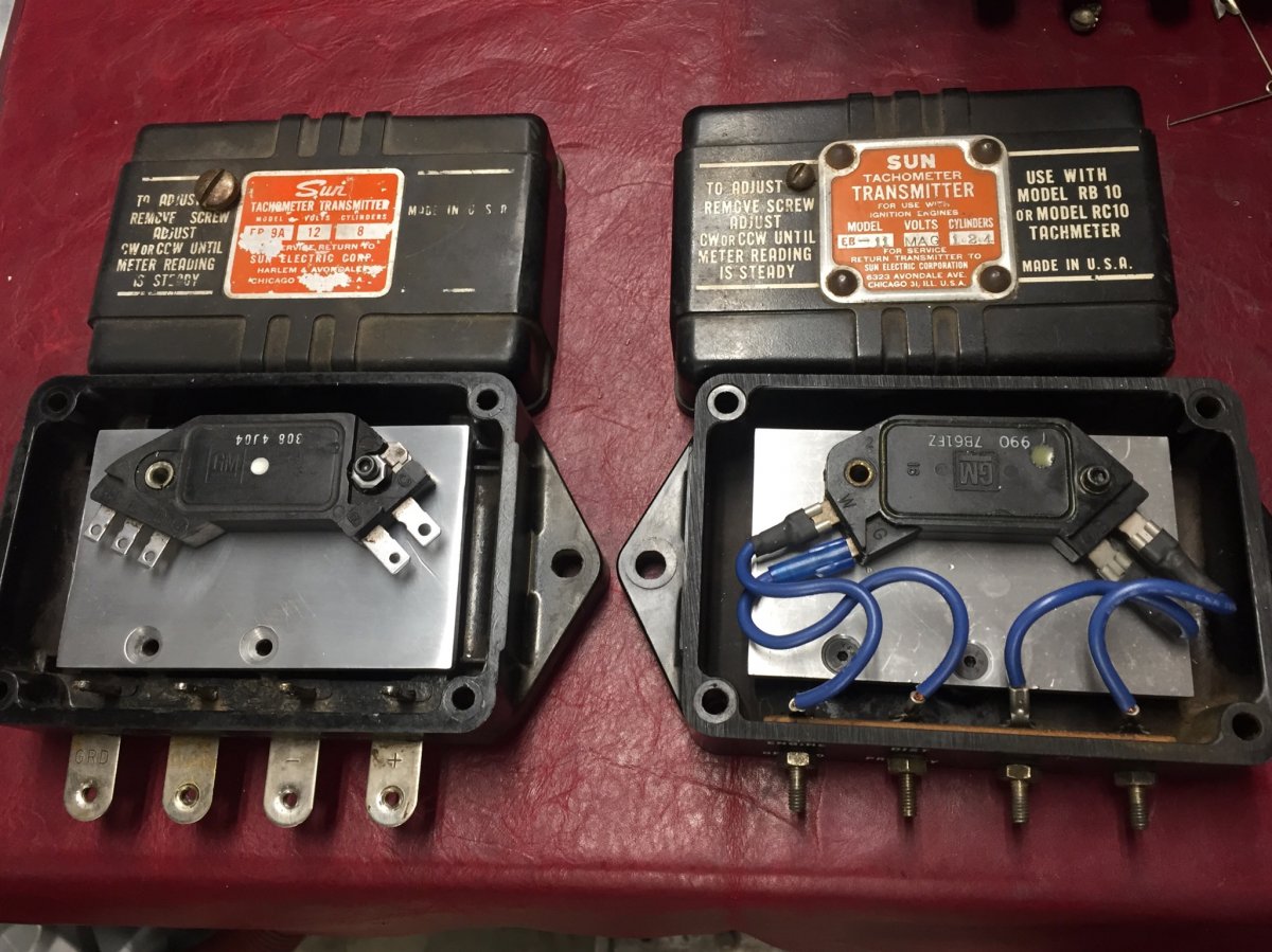

    My old truck had one of these old Sun Tach boxes (didn’t work) and I thought it was cool and I wanted to keep it - and NOW I have a use for it. For those that remember my Homemade HEI distributor - this will be a nice way to hide the ugly “modern” electronics if you can call a HEI module modern. 73487442-D502-4185-A1FD-9E1C70E15F11.jpeg

  3. Hnstray
    Joined: Aug 23, 2009
    Posts: 12,355
    Hnstray
    from Quincy, IL
    @HemiRambler I also like it...….one question though, NOT a criticism, just a technical question.....in OEM installation, is the module inside the HEI cap or on top.....and does that affect cooling (longevity) of the module?

  4. HemiRambler
    Joined: Aug 26, 2005
    Posts: 4,208
    HemiRambler
    @Hnstray, That's a great question. In a factory application the HEI module is mounted well under the cap - it bolts directly to the aluminum distributor housing where points normally would be - and for good reason. Between the module and the aluminum there is Heat Transfer compound to help dissipate the heat from the module. If you notice my adapter plate is made from aluminum for this very same reason. The question I have yet to answer is - how much heat exactly are we dealing with? I plan on setting this up on my distributor machine and running it for several hours to see if there's any heat rise within the module. Just gotta find my thermal probed and a couple other parts. It ought to be interesting.

  8. HemiRambler
    Posts: 4,208
    HemiRambler
    I ran it for an hour and a half and the last 30 minutes it rose 1 deg or less every 5 minutes. Using a "K" type thermocouple inserted into a hole in the aluminum heat sink the final temp I measured was at 186F. Admittedly the test was a tad bogus since I couldn't find any heat sink compound - I hilbillied it up using some silver antiseize. I'm gonna rerun it soon, just need fresh batteries for my hand held temp gun which I was using for case temps. Somewhere I have a HEI - I may run that was well to get a baseline.

  10. HR could you ventilate to cover with small holes, perhaps around the perimeter, to allow for venting?
  11. Mr48chev
    Joined: Dec 28, 2007
    Posts: 33,979
    Mr48chev
    Shouldn't need vent holes if the piece of metal works as planned for a heat sink. Figuring what the temp is inside the distributor on some of the engines that the module was on originally.

  14. HemiRambler
    Posts: 4,208
    HemiRambler
    So that's the question really. I am kinda breakin' the rule's here as I have no ventilation thus far. I've run these modules on a finned aluminum block in the past but they were always exposed to air. The question here is can it live inside the sun box. Right after I ran this test my distributor machine got UNHAPPY. It's kinda buried next to a car in the garage so I have to move a couple cars to get to it. BUT! I have to move my truck tomove those and wouldn't you know my truck takes a dump!!! It's a 12V cummins and I am a newbie to diesels - I tracked it down to a bad grid heater relay set. Parts came TODAY - so the truck's running but its raining so not pulling the hot rods out - dang I really wanna run some more tests!!! To Be Continued!!!!

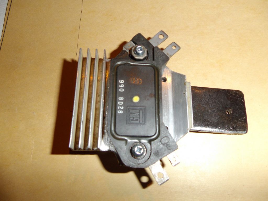

  19. I used a heat sink from the late 90's Vortec engines. It was part of the coil/module bracket bolted to the intake. Had to cut one fin off, and drilled relief holes for the nubs on the back side of the module. Used a steel bracket to bolt it to intake for now. It's in the wind by the SBF distributor. GM heat sink.jpg
    Hnstray and loudbang like this.
