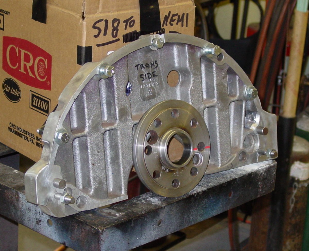

  18. I know very little about MOPAR, patterns, but a close friend of mine adapted a 518 tranny to a 392 Hemi. This adapter, as well as being a plate, also has an adapter for the crankshaft. If it will be helpful, I have a couple of pictures of this adapter that I can post.

  23. This is a picture of the 518 to 392 adapter.
