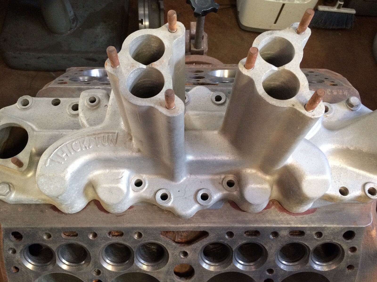

    Does anyone have any historical info on this intake? Seems to have mixed performance reviews but is unique and satisfies the LCES factor. None the less i will be running it on a mild 59 motor.
    Some have PM-7 embossed on them, this one does not. What is the difference?
    Any tuning considerations with the “ high rise” configuration?
    KiWinUS likes this.
  2. That intake appears to be an earlier Thickstun. The PM-7 was a later design and had more rounder intake runners.
    stillrunners likes this.

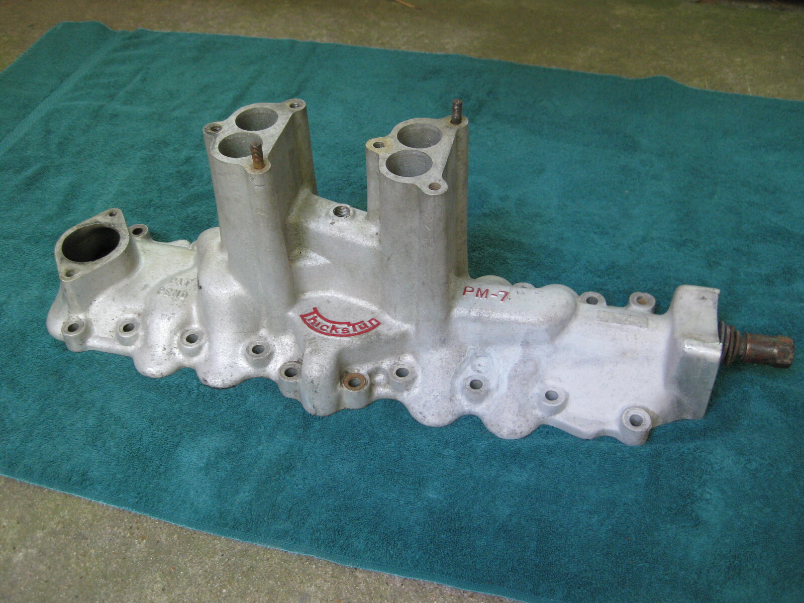

  3. Here is a picture of a PM-7. They were produced after WWII. The earlier ones had been produced prior to the war. PM7.jpg

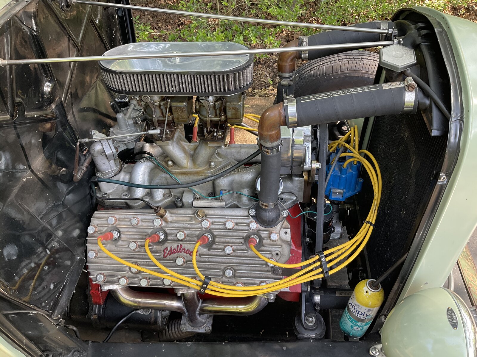

  5. The thickstun is a cool looking intake but a very POOR performer. I have extensive dyno tests of a strong “mule” flathead running 10-12 diff intakes in Hot Rod mag. The diff from a thickstun and Edelbrock slingshot was 18 hp . That is about 20% on a motor(stock around 100 hp). If you want a thickstun just for “profiling” but if you want a better performing flat,the Edelbrock slingshot is a better choice. The best performing intake tested(no 4 carb intakes were used) was the 3-2 Navarro that made about 20 hp over the slingshot. Flatheads Forever!! A328A7B2-49D9-48AF-A264-B6003A083A77.jpeg D3423512-AE2F-4371-8A3A-57AF6FC1EE9E.jpeg 934F4F61-6DA8-4DF0-A9F5-25C7484B4EEA.jpeg

    While dyno test on a “built” motor shows impressive results, I am skeptical that there would be the same improvement on a mild motor.

    The PM-7 has a very cool historical factor. So by relation the early version intake should also be historical. And maybe even more cool.
    But the guys are right about it not proving to be a great performer. If you can stick your finger into a port and feel a square corner, it's not going to perform well. Air and fuel mixture doesn't want to turn hard corners.
    I have one of the Thickstun earlies, like yours, as well as a PM-7. I haven't installed either on a running engine yet. I am currently using an early Weiand hirise that has a couple hard corners in its ports. I wouldn't call it a top performer either. But it sure is cool, and by some accounts one of the first hirise intakes made (1939), so it is historical.

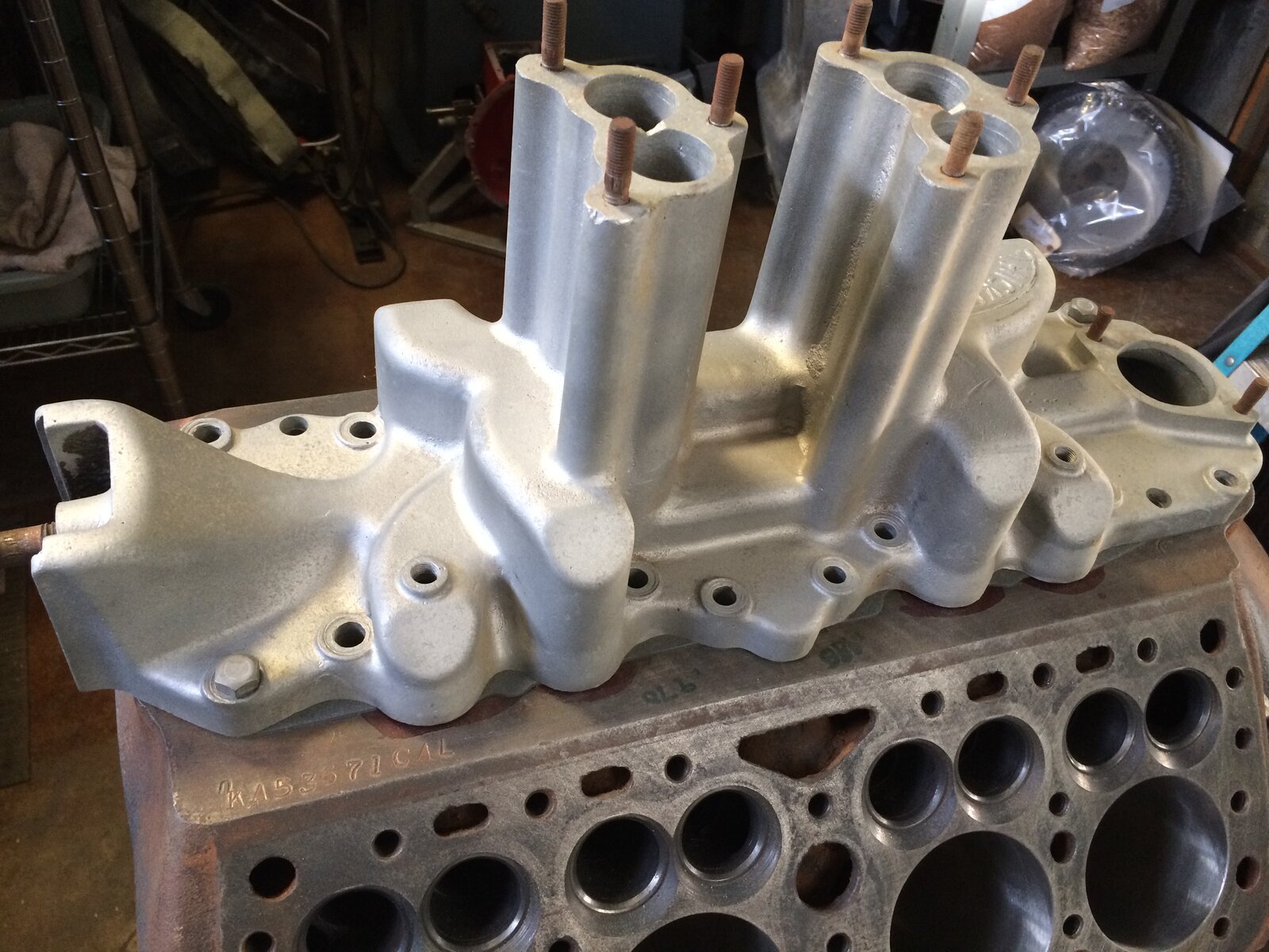

    My suggestion would be to go to myflatheadford.com for a wealth of information on practically every piece of flathead speed equipment with lots of pictures DSCN2933 (1).JPG . DSCN2948.JPG That's where I found out that my short Thickstun, which a number of folks on here kept saying was a cut down PM-7, was indeed a pre-war PM-6 and was more desirable than the PM-7. Look at the differences in the runners from yours to the PM-7. You may have something really rare.
