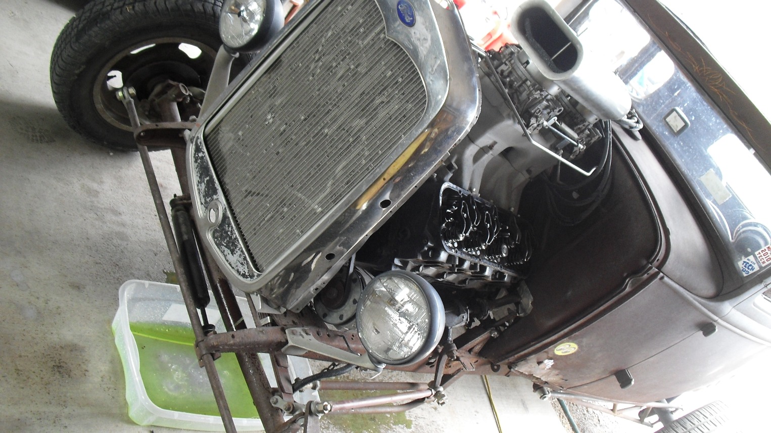

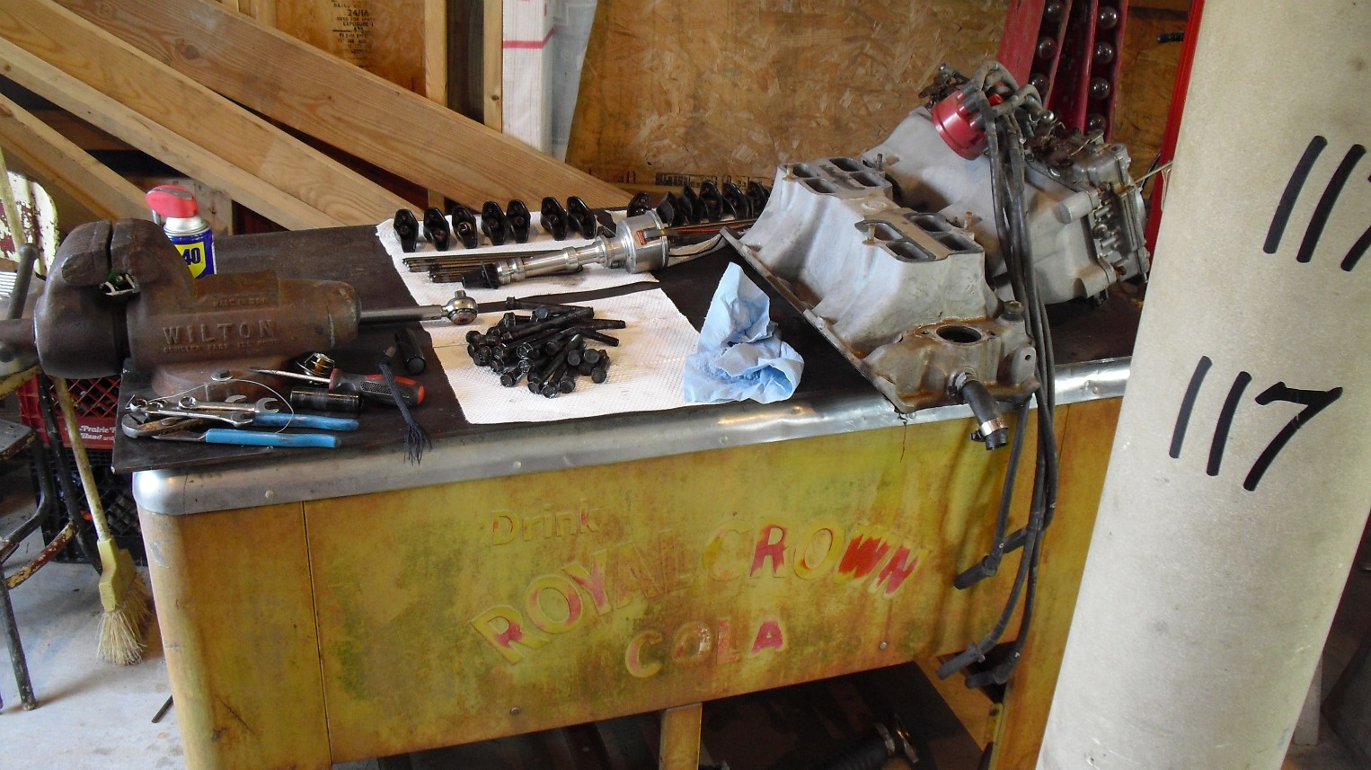

    well....a little fly in the ointment! i thought since i built this motor 9yrs ago and i've never pulled the valve covers off(except to change them once) i might ought to check the valves and maybe adjust them for the "big road trip". well was i surprised! i had 1 ex valve stem in each head just beat all up smooth and 1 push rod was bent on another ex valve! i don't see how the keepers were still keepin'. that was at 5:15 this afetrnoon 1st pic then at 6 it looked like the last pic. well...plenty to do before we head out thur morning, just thought i'd show you what was going on in my world! lol....glad i ck'd the valves!

    Yikes! All those fucking wheelies haha!
    Stock length pushrods? Hyd. or solid tappets? Slap that bitch back together & run the valves....win cup. In that order haha!
    Go Reggie!
    Lookin good Jason! Burn that midnight oil.....drive her there and run her hard!

    ya stock pushrods hyd. camshaft stock rockers...it's really hard to compete with you high dollar guys! lol. i'm just about back together. i had to get 4 intake pushrods that were bent...no wonder this things been popping at the top end so bad. with all this fixed i may be able to break into the 11's!...11 mpg! i'm still having a blast and can't wait to drive off thur am.
