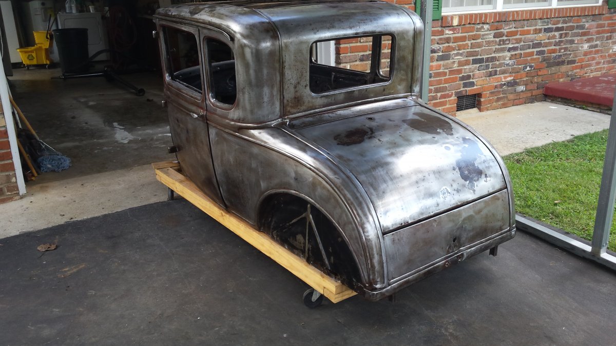

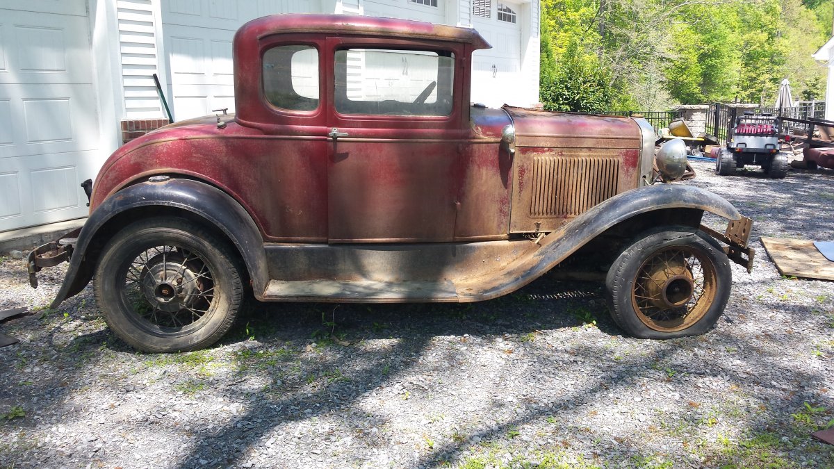

    I am starting with a solid and complete 31 Deluxe coupe. After about a week of tear down and a week of wire brushing to see what I had, the results looked very promising .

    3-1931 Model A coupe project.jpg 5-1931 model A coupe body.jpg 6-stripped project body.jpg

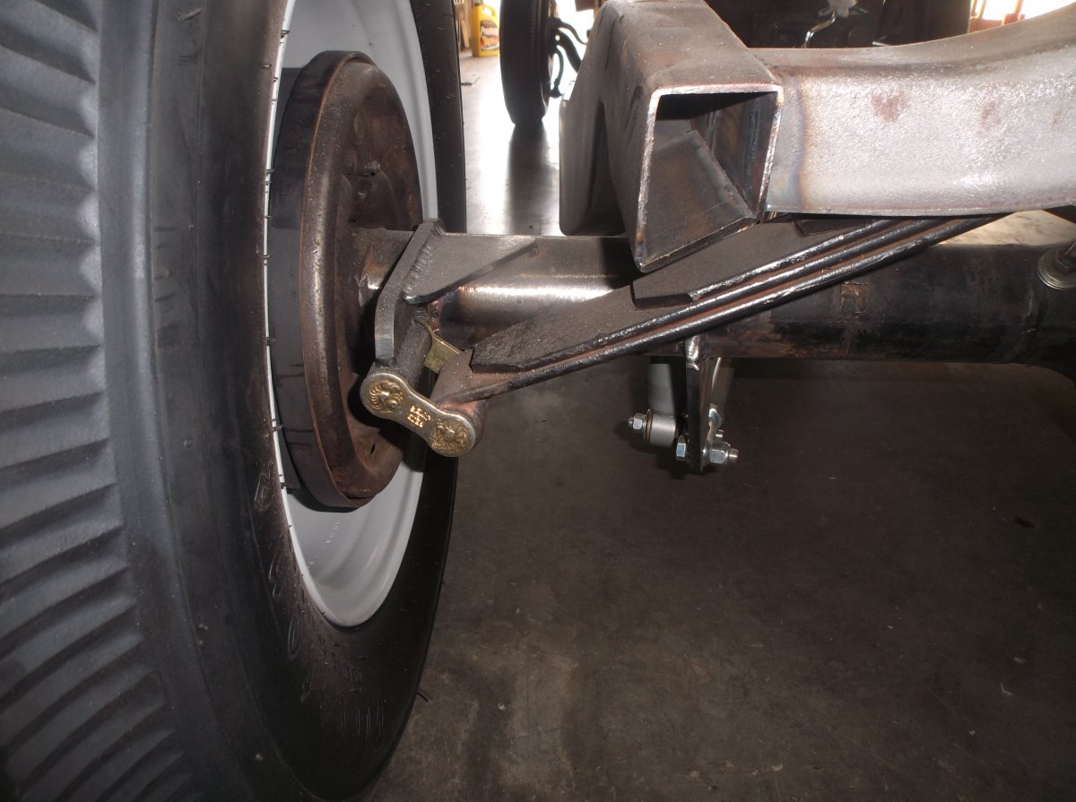

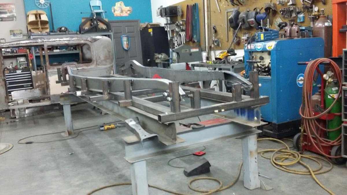

    Got a few more photos to post of progress on the coupe. The frame rails on the jig and boxed, Jim B. installing the front cross member, and the nearly completed perimeter frame. 2-boxing the frame rails.jpg 3 setting front cross member.jpg 8 front C notch.jpg 12.jpg

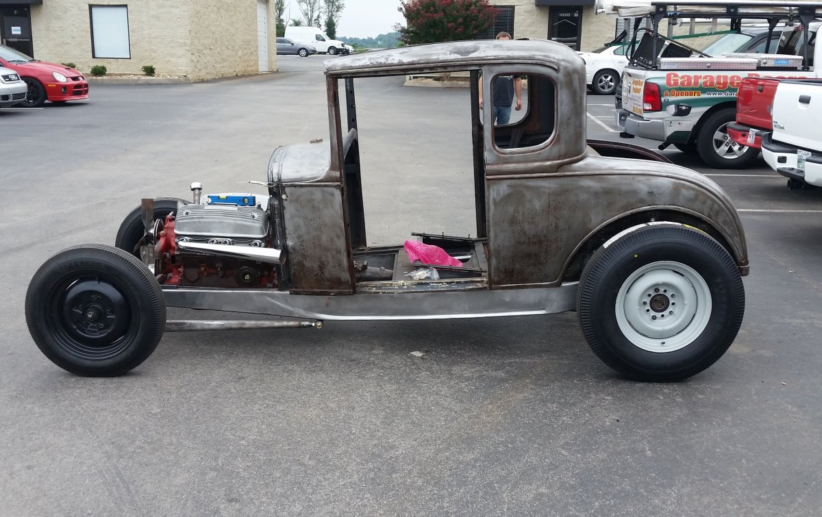

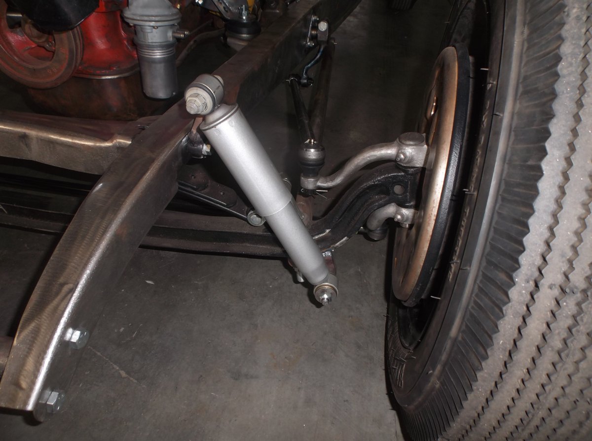

    Lets put a few more parts on chassis. Could not wait to see what the body looked like sitting on the frame. I think that 5" drop in the axle and the flattened cross member is going to put this thing in the weeds once all the weighty bits are added! Thought I would throw in a preview of the engine that's the namesake of this project, it was supposed to be the last picture, but refused anything less than top billing! Also I could not keep picture of body on frame from posting twice. 61-292 Ford Y Block.jpg 7.jpg 7.jpg 27.jpg

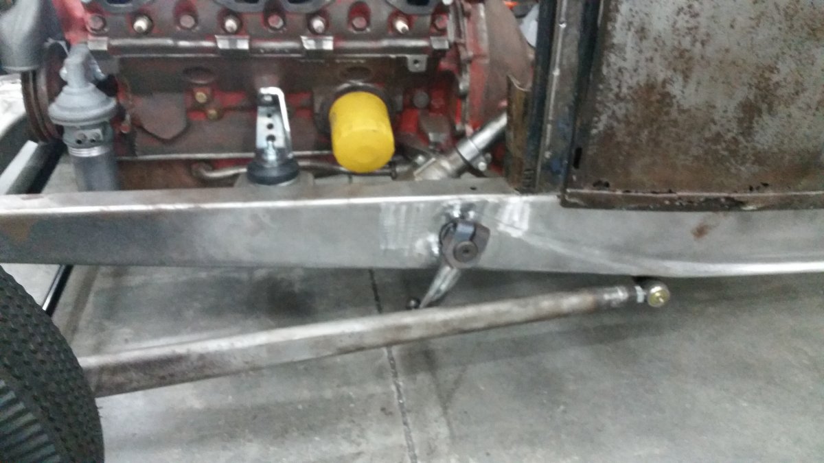

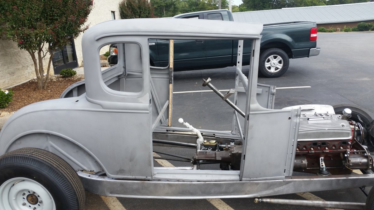

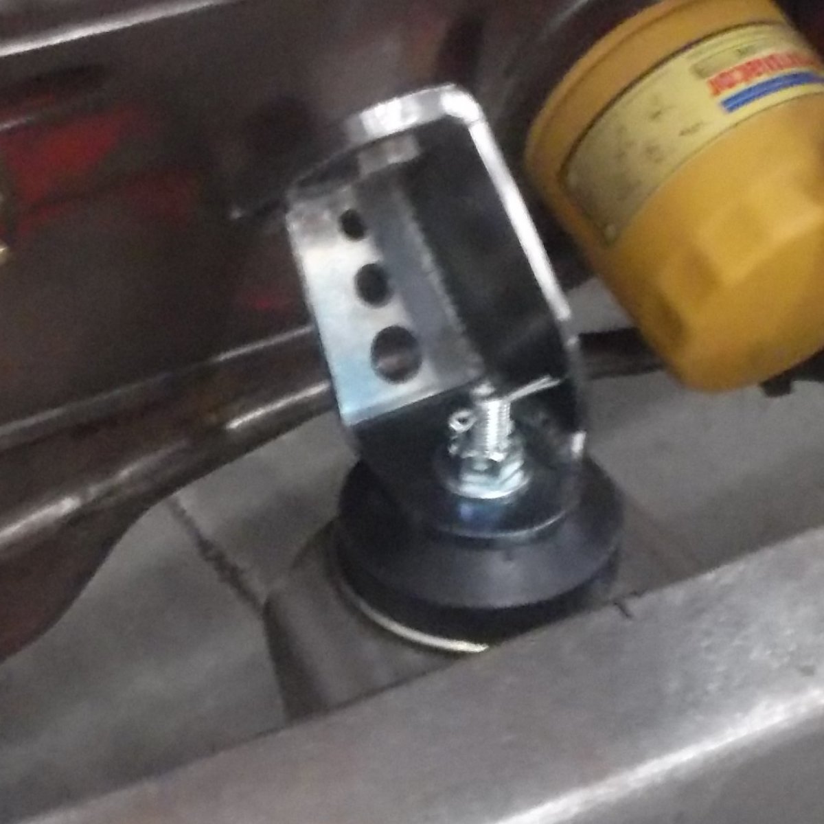

    A few more pics of last weeks progress. The motor was mocked in place and Mike B did a kick ass job of fabricating some motor mounts. The original seat is going to be used so the seat pan was cut loose and moved back a bit to allow clearance for the shifter. The next task will be mounting the steering box, drag link, and pedal assemblies. I'm also including a photo of Mike Barillaro's belly tanker that he built for this years TROG. Kudos to the Mike and Jim for being chosen to participate in TROG for the third time, probably would have been four years, but they were not aware of the event until the second year! 29.jpg 008.jpg DSCF6038.JPG

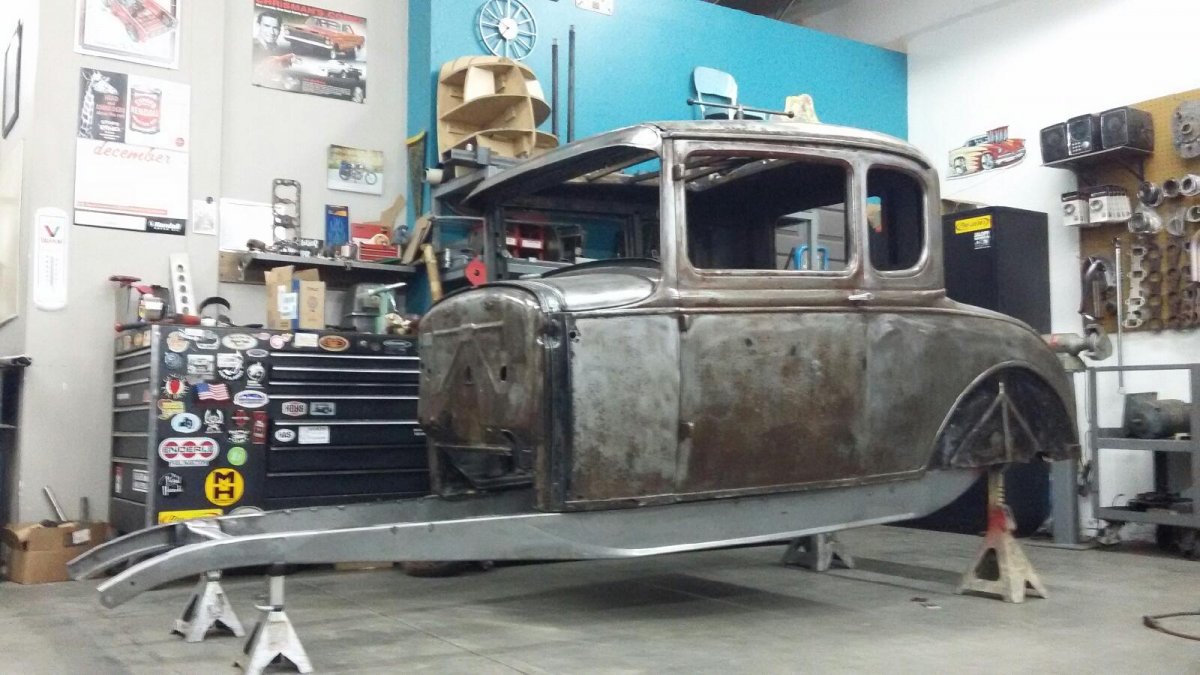

    Stopped by the shop today to check on progress. Jim had mocked up the F-100 steering box and the front shocks. Also got a cool shot of the shop interior , (taken by Mike B.) My coupe on the right, also a 32 five window with a cool 60'S vibe, and Mike's belly tanker which will be competing at TROG next month. The O T beast on the lift is getting a set of mike'S awesome custom fabled headers. 20150902_163159.jpg 20150902_163128.jpg IMG_0470.jpg

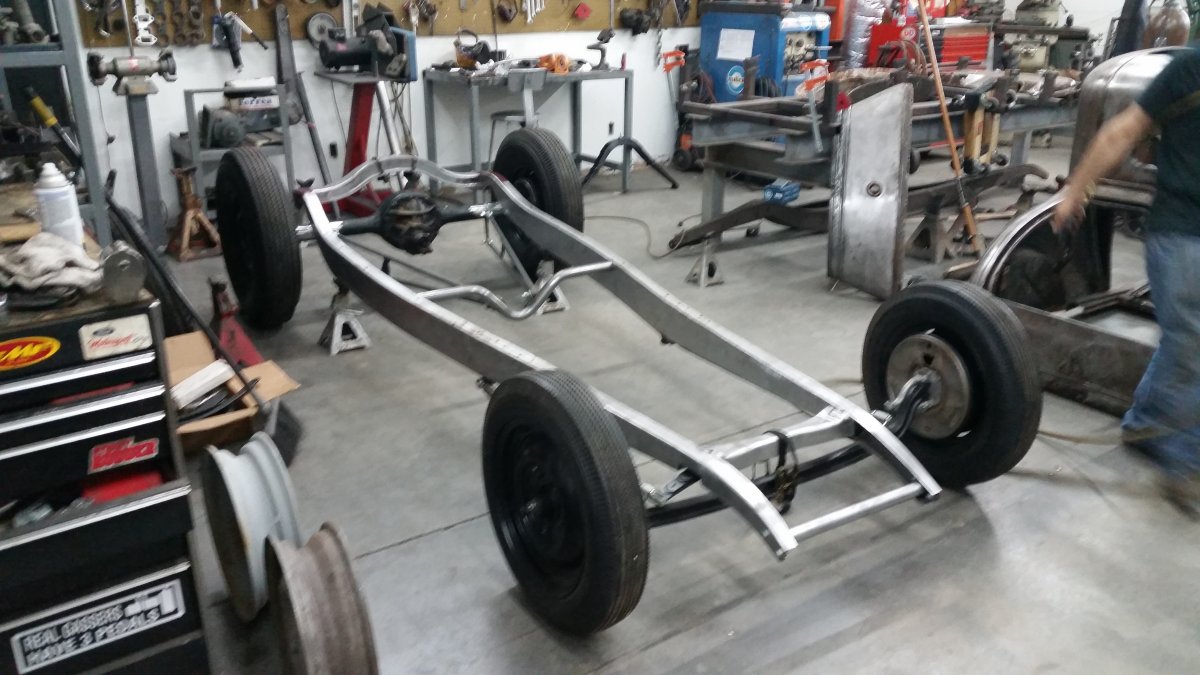

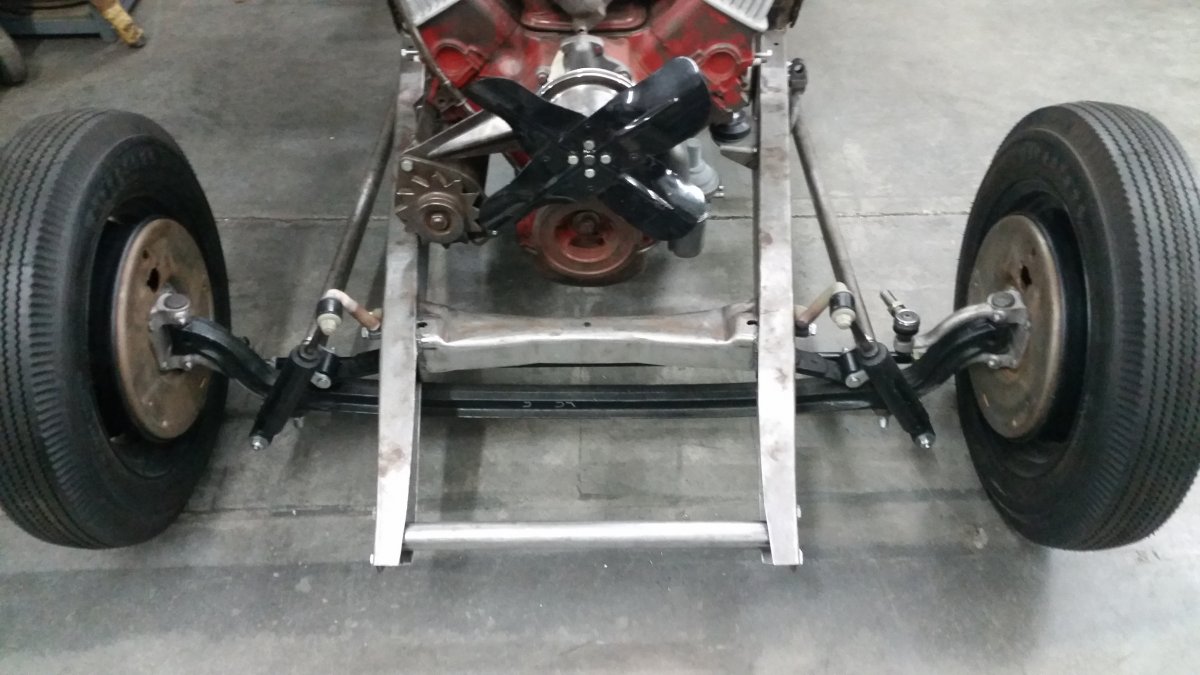

    029.jpg 028.jpg DSCF6160.JPG 049.JPG A lot of progress has been made on the Y-BROCK Coupe chassis over the past few weeks, chassis fabrication is about complete. I'm posting a few photos of the outstanding work, by Jim Barillaro on the chassis. I took the body to media blaster yesterday, when it comes back, Mike Barillaro will work his wonders on the sheet metal that needs attention and lower the lid.

    002.jpg 004.jpg Got the body back from the blaster late yesterday, turned out great no surprises. I don't which is more exciting, one step closer on the coupe or knowing that in less than two weeks I will be on the beach at Wildwood watching the Barillaro belly tanker ,and all the other TROG cars and bikes blasting down the sand! Hope to see many of you there.

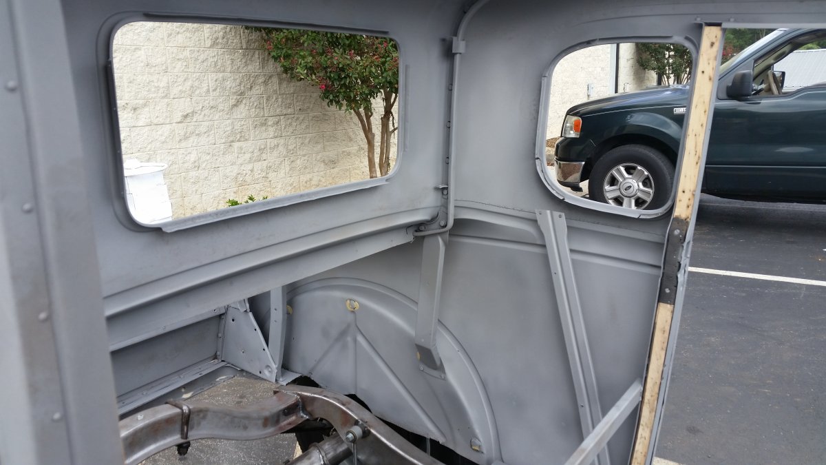

  22. Body is etch primed and ready for sheet metal work and a haircut!

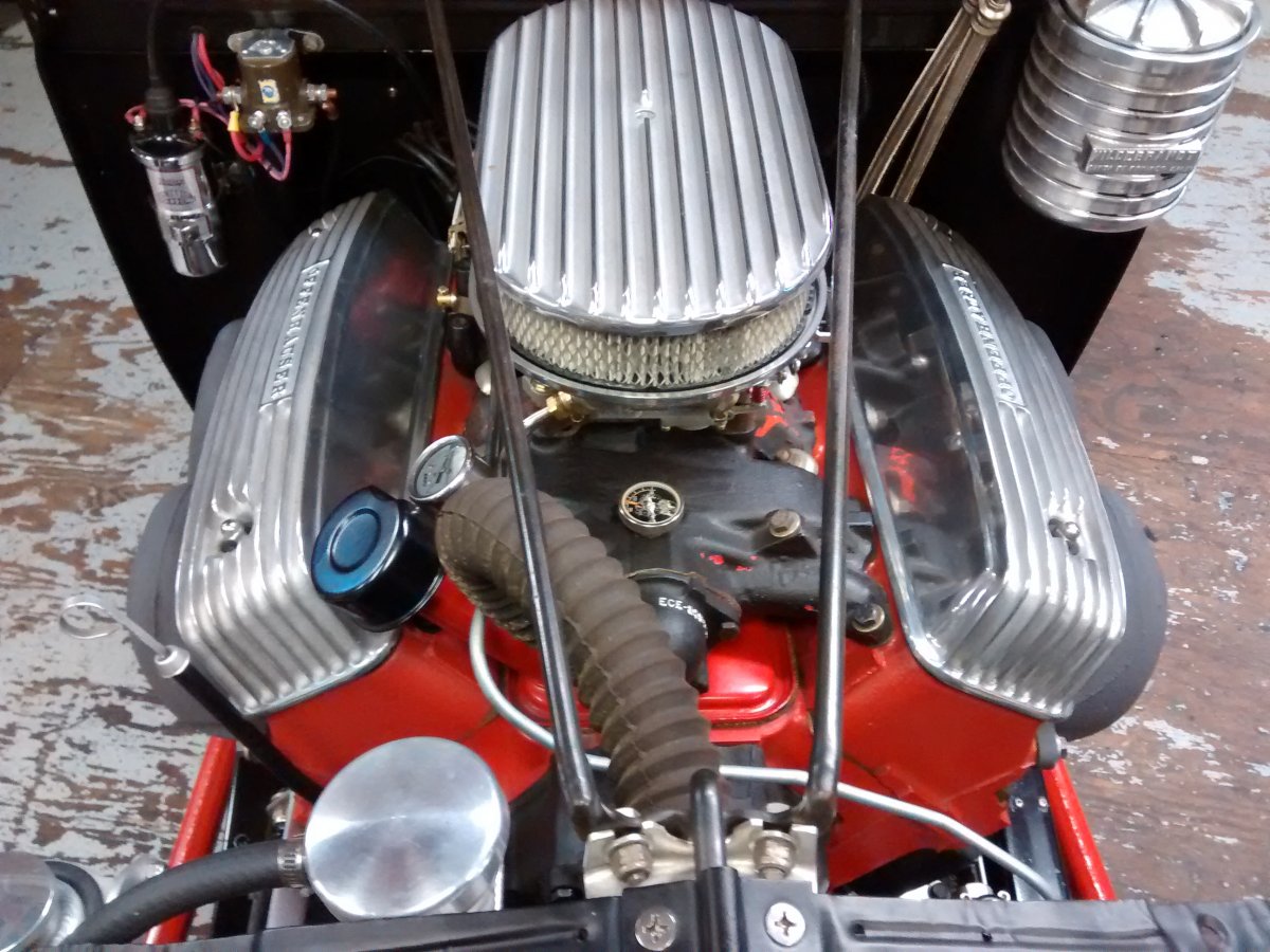

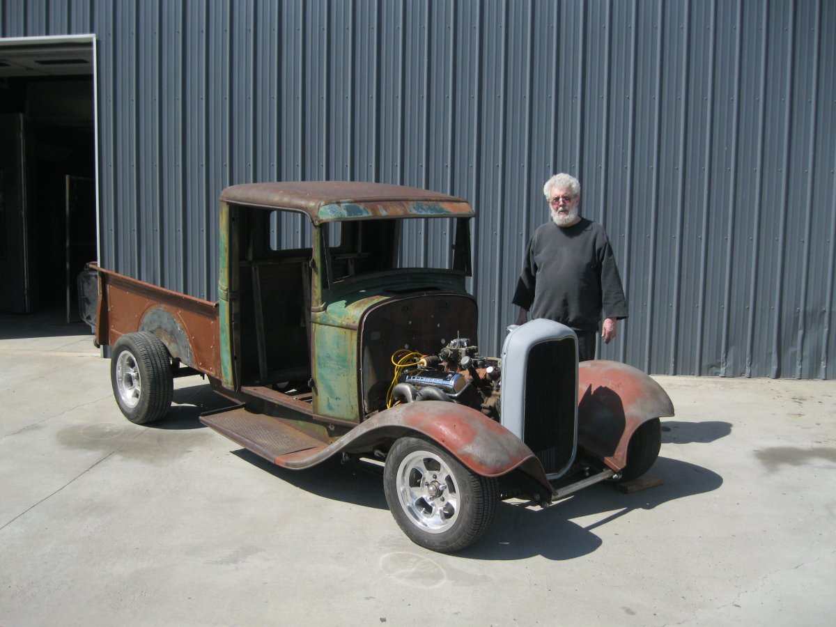

    Very nice build here is mine IMG_20150929_130014567.jpg IMG_20150929_125958668.jpg IMG_20150929_125642955.jpg
  24. garage2small
    Joined: May 25, 2012
    Posts: 660
    garage2small
    that Y block is looking good 32owner is that a 34 Chevy radiator shell?
    lothiandon1940 likes this.
  25. 32owner
    Joined: Nov 30, 2009
    Posts: 470
    32owner
    1935 chevy tried to be a little different
