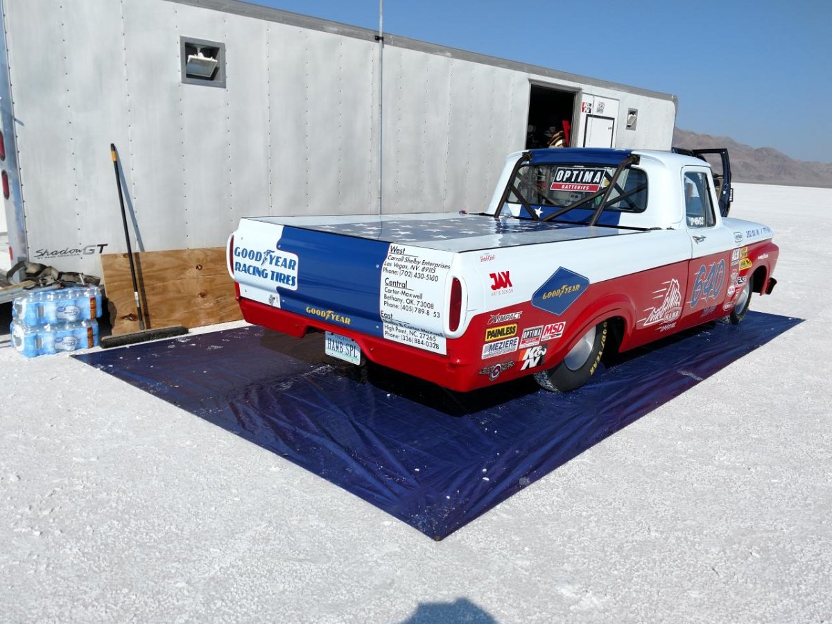

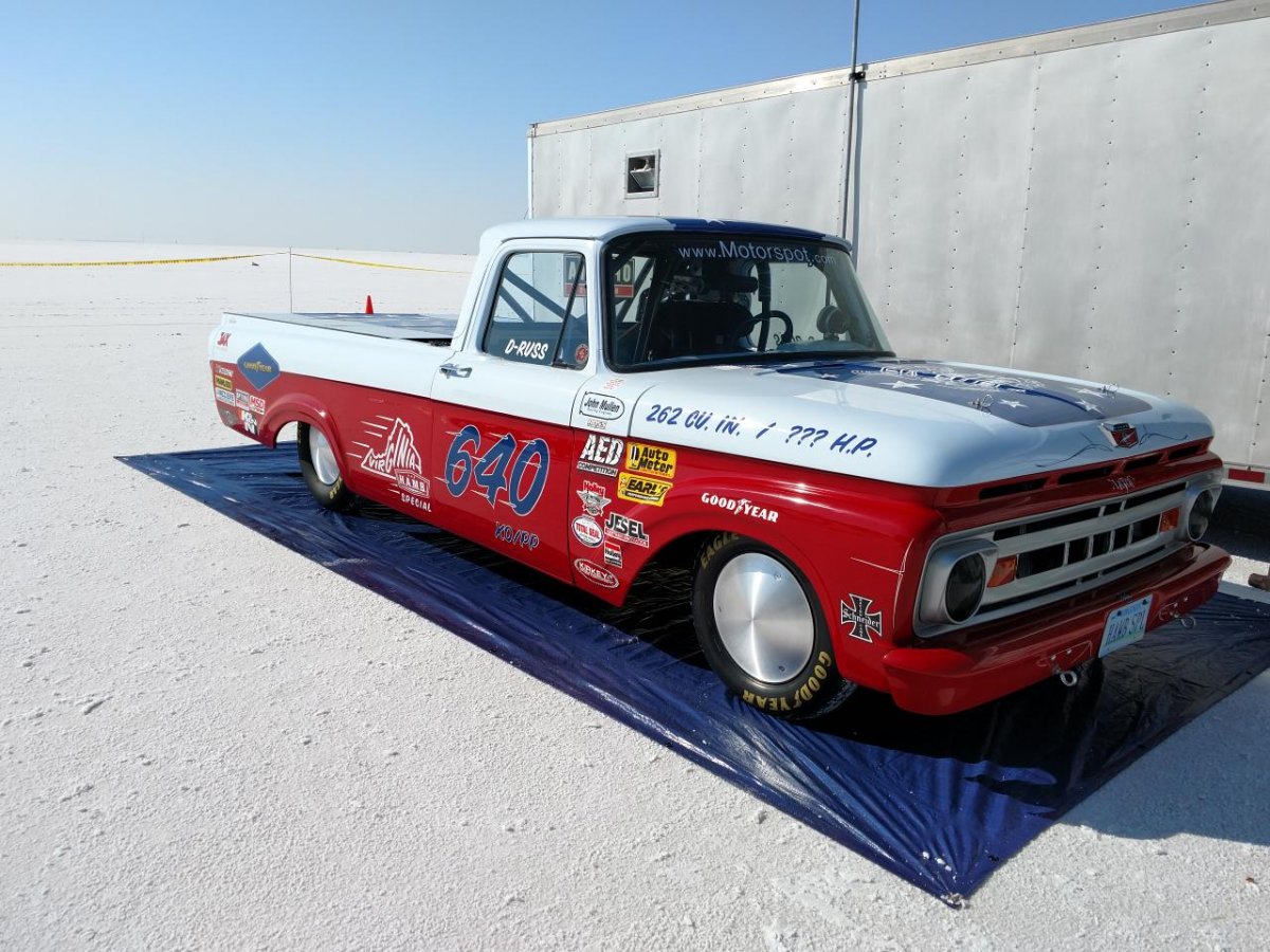

  1. Got ready for tech inspection this AM ...
    .... and the HEAPS logo got installed, the group that has worked along with johnrodz to get this all together ...
    .... and she heads out ....
    As far as we know, we needed a cut off anti-roll over switch for the electric fuel pump. We found out a guy had them here, we purchased one, and brought it to tech inspection. That's all we know so far - fingers crossed!

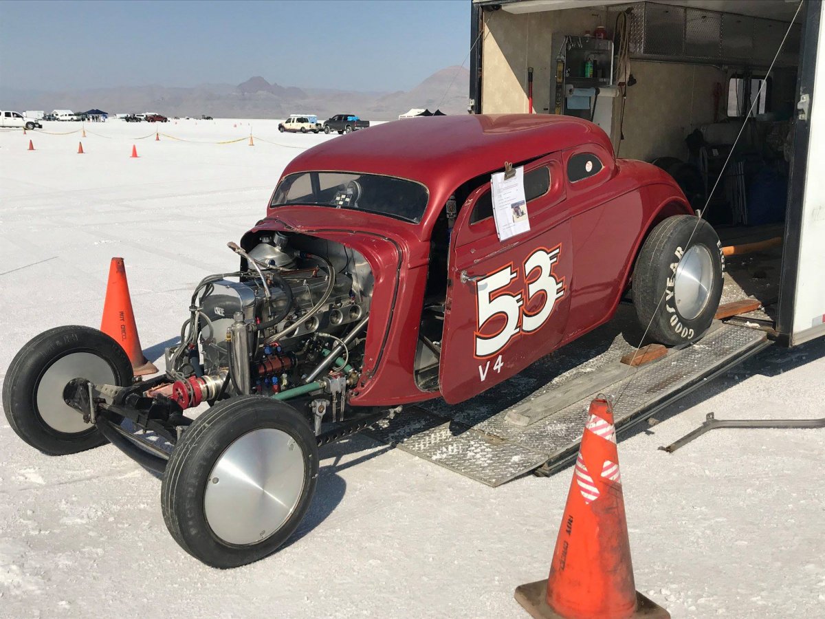

    Could I ask... How does this beast cool itself? That green hose seem like water, but I'm confused.
    It's like a train wreck, I can't stop myself from looking one more time!
    Tom, Thanks for making the room in the, well, you don't have a back seat, but you know what I mean!
    [Edit to add:] What powerplant are y'all using? Straight six?

    The car is the same as most. A rear mounted water tank and suitable (Not garden hose) hoses to a pump to circulate the water. There is usually no radiator used.

  12. Well, we had a few things to fix ...
    1 - we had to plug up any cab holes - floorboard, cowl, firewall
    2 - the tonneau cover has to be installed even with the bed sides - we are on top
    3 - we had to cut holes in the race seat so the upper belts cane in at about better angle for Dave - big job
    4 - we had to install a roll over switch for fuel like in the Ford broncos,
    5 - we have to have a real tailgate, not something made up like we have
    6 - we had to ups tape the side windows top to bottom, inside and out because they were not safety glasses
    Doesn't seem like a lot, huh? Try doing it all in a mad scramble! But, we will make our first pass tomorrow, as we then PASSED TECH INSPECTION!!!!!! Woooo hooooo!
