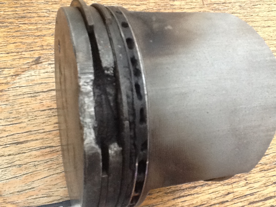

    Some genius decided to install the top ring with a piece missing (must have broken it when putting it on the piston). The motor ran fine for a while (it was in the car when I bought it), then it started missing. Nothing in the cylinder or the sump, so the missing piece is probably on the floor in the previous owners shed.

    from Australia
    more likely out the exhaust port, that's damage from detonation, doesn't look like that engine received any love recent to its demise.

  6. I run a lot of the older engines. And I burn ethanol gas. What I do is add a pint of diesel fuel or 2 cycle oil to every ten gallons of gas. The 250 in my 66 GMC gets hard use hauling wood and pulling my trailers ect. I have a old motor minder vacuum guage and try to drive in a manner that keeps the guage in the green zone. I had a 250 in a 65 chev Pk that recessed the valves and burnt a piston. It developed a vacuum leak on a trip to Dallas Tex. I think vibration caused the manifold bolts to get loose. I first noticed it wasn't idling properly. Then It started smoking. I found the loose bolts and tightened them. However the damage was already done. Probably less than a 100 miles of driving with a vacuum leak. The old engine made it home. However It was really puffing smoke and had plenty of blow by.
  7. That's a burnt piston . It can be caused by lean fuel mixture or incorrect timing. The burnt part of the piston and the missing part of the piston ring went out the exhaust

  14. That's what I thought too, but I figured that that those bits of ring would make their mark on the top of the piston, and on the valve and seat, but they were all un damaged.
