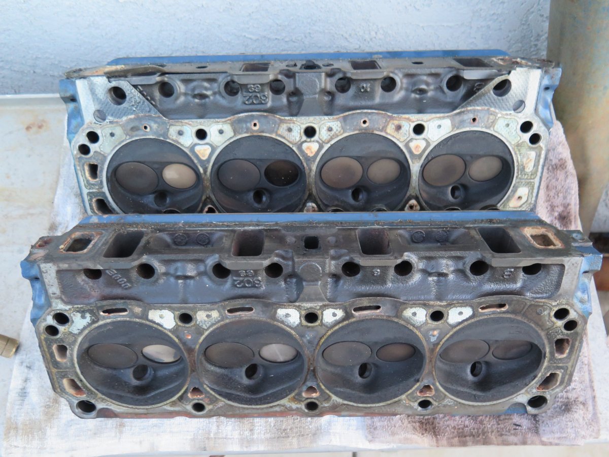

    In the process of prepping for Eagle Field, I attempted a quick tune up on my tow vehicle; a mild custom '55 F-100 with a 302/C4. I found two dead cylinders, very low compression apparently due to burned exhaust valves. So off came the heads. I couldn't believe my eyes.... It looks like they put 260 exhaust valves (1.39" valves) in 302 heads (1.45"). They are sunk an average of .090".
    I had a spare set of heads in stock so I disassembled them for inspection, lapped the valves and stuck them on. I also took the opportunity to upgrade from the crappy Ford manifolds to a nice set of stainless shorty headers. So far so good, I got my good old workhorse back.
    Has anyone else ever pulled apart an engine, trans or rear end to find someone else's finest work? Have pictures?

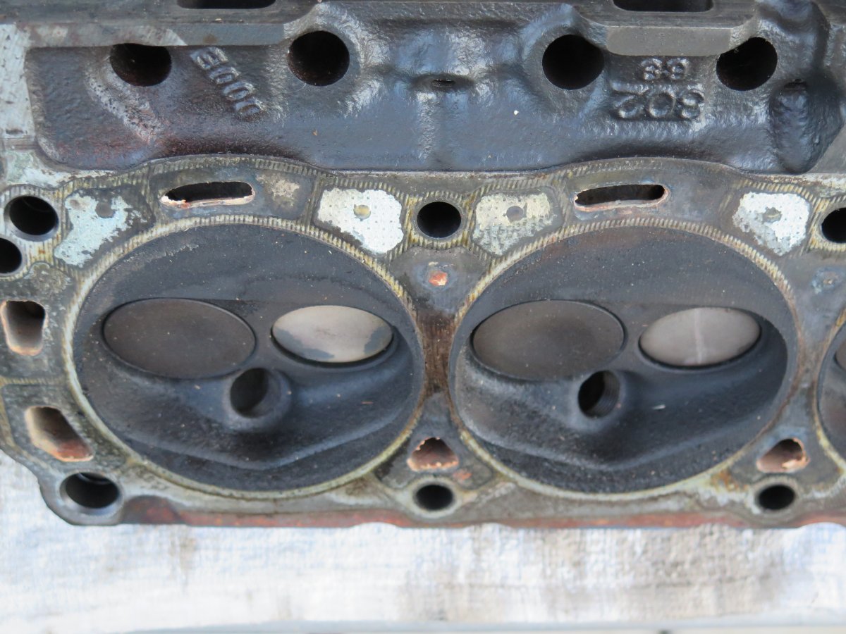

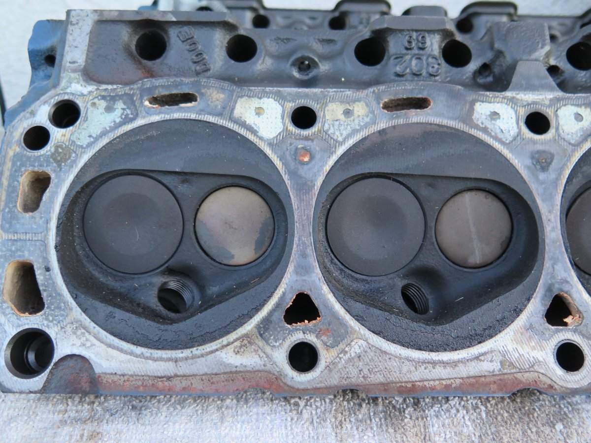

    It's hard to be sure until you take the valves out and look, but I'd be inclined to blame the seats, instead of the valves. If you run unleaded fuel in heads that were built in the days of leaded gas, the valves will recess into the seats, just like what you see in these photos. If you want to run unleaded fuel, you need to install hardened valve seats.

  4. At first, I thought about the valve seats not being hardened too, but those valves are really sunk in there quite a ways..
  5. Im gonna agree with cowboy ted. It looks like recessed seats.

    I have never seen the results of unleaded gas on old seats before but I find it hard to believe that they would all recess so evenly. Who knows. Funny thing is, it actually ran OK except for at idle, it shook a bunch - like a booger in the carb, that's why I started looking at the tune up. Doing the old "pull the plug wires one-at-a-time and see what happens" revealed two dead holes. It was all down hill from there.
    The new heads have hardened seats, 3 angle valve job and good stem seals. With the exception of the new headers, this was a "no dollar" fix - luckily, I had everything in stock to fix it - even the engine paint.

    OK, Cowboy Ted hit the nail squarely on the head. I pulled some valves and they are the correct 1.43 diameter valves but it is pretty clear that they just cleanly hammered and abraded themselves into the iron. Amazing.
    This engine came out of a buddy's Model A. He bought the car with low miles on the build and a complete build book with receipts. He seldom drove it before pulling the engine and installing a SBC. I bought the engine and installed it about five years ago when my other 302 developed an ominous knock. I haven't put on lots of miles but they were almost all towing as I used the truck to move all my junk from L.A. to NorCal. Probably 12-15K towing and highway miles and the seats look like this, yikes. I wouldn't believe it if I hadn't seen it with my own eyes.

    wow. Gotta say, I have seen some sunk exhaust valves, but I have NEVER seen them like THAT, thats like 1/8"!! I have heard that recession is worse on motors that see a lot of load, like towing, but WOW...

    If you look at the photos above, you'll notice that the valves that are most recessed are all exhaust valves, and they are lighter colored, a result of the excess heat burning off the black carbon deposits, leaving them looking white or clean. It's possible that the cylinders that are most recessed are also running leaner than the rest. Some induction systems result in one or more cylinders running lean, and lean running cylinders run hotter than richer ones.
    It's an important reason why you should "read" your plugs periodically, to tell you whether you have one or more cylinders running too lean. If you do, you need to richen up your carbs, or that lean cylinder will fail first because of excess heat.

    I never had the heads off it but it had been rebuilt in a time frame that made me believe they would have installed hardened seats during the rebuild - I guess not. I always thought that the stories about running unleaded without hard seats were overreaction - again, I guess not!
    I've torn down some used up motors over the years and I've never seen that kind of recession, especially across the board, all of the exhaust valves were sunk. The worst was a little over .090".
