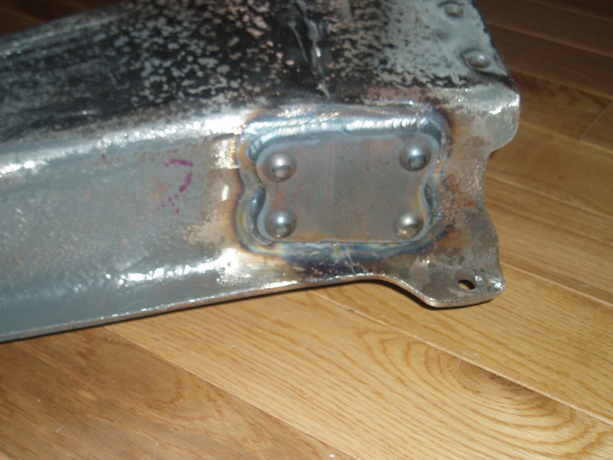

    I originally took mine out and did it on the bench, but a friend of mine recently did his in the car, from underneath, seems like hard work to me tho, all that welding above your head, hot sparks landing on you, my least favourite type of welding.
    I cut out little sections of the boot floor to get to the top frame rivets, the floor was rotten there anyway. Pics below give a rough idea of what i did, I made a jig to hold the crossmember before cutting anything, I decided that the ends where it sits in the frame, and the spring mount centre section were the important bits, with an adjustable jig center to get the drop I wanted, then made the rest fit. , I plated across the joints for some extra piece of mind, and added fake rivets, cos thats what you did back then. Slipped back in the frame easy. All changed now tho for the A rear spring.
