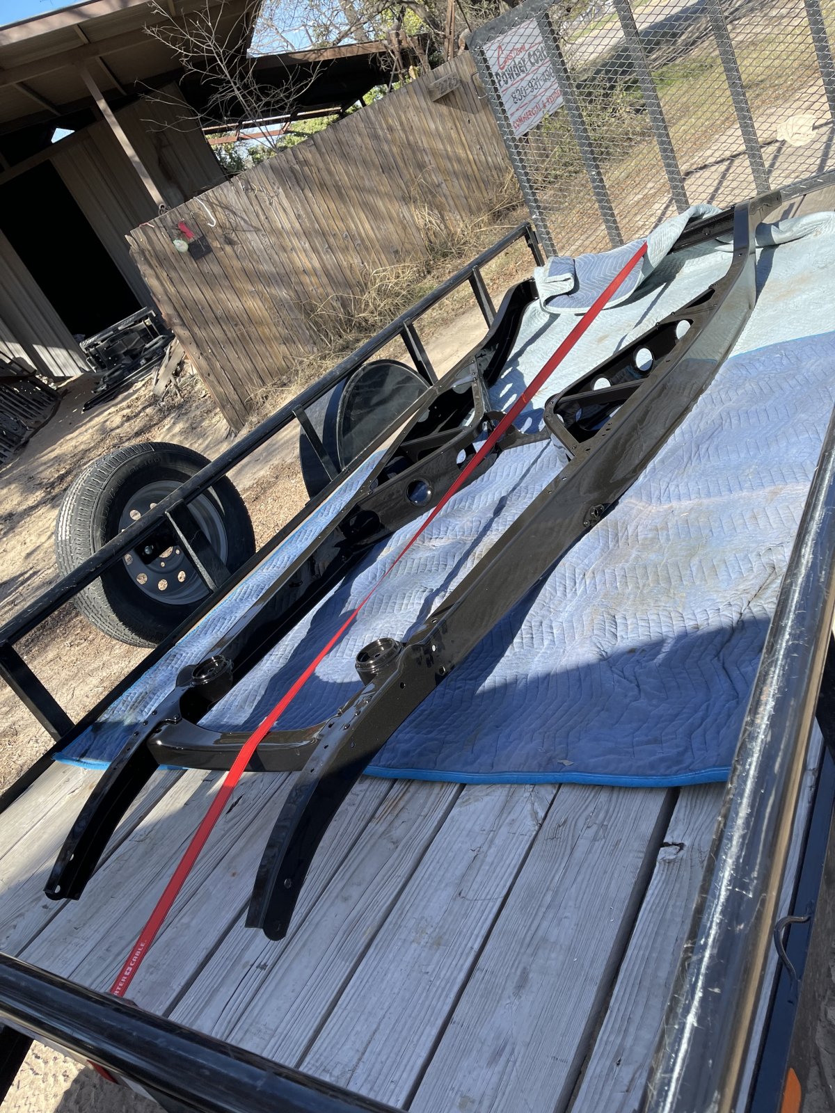

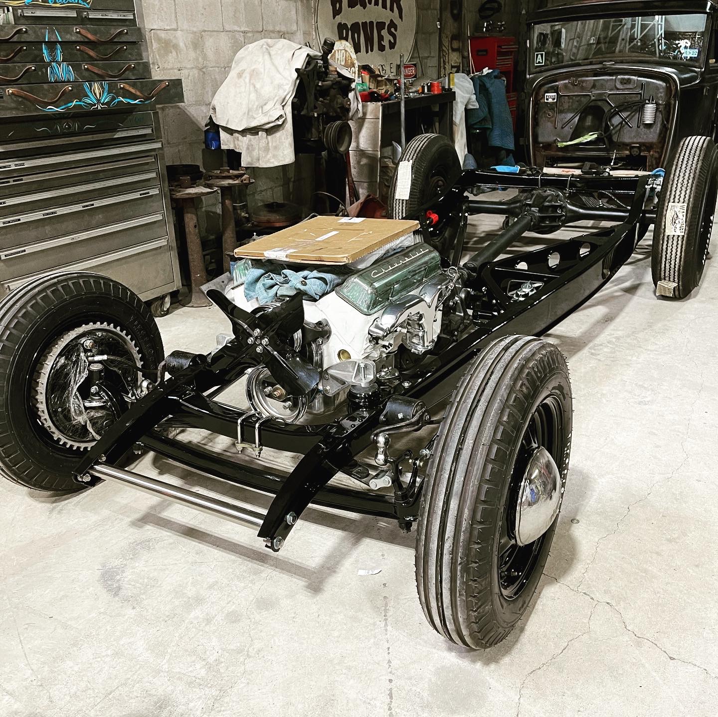

    Got Frame back from powder coat, now final assembly! Stay tuned

  3. gnichols
    Joined: Mar 6, 2008
    Posts: 11,146
    gnichols
    from Tampa, FL
    I remember my first frame back from powder coat. Part Nr. 1. Its all down hill from here, right?

  4. Joe Rosales

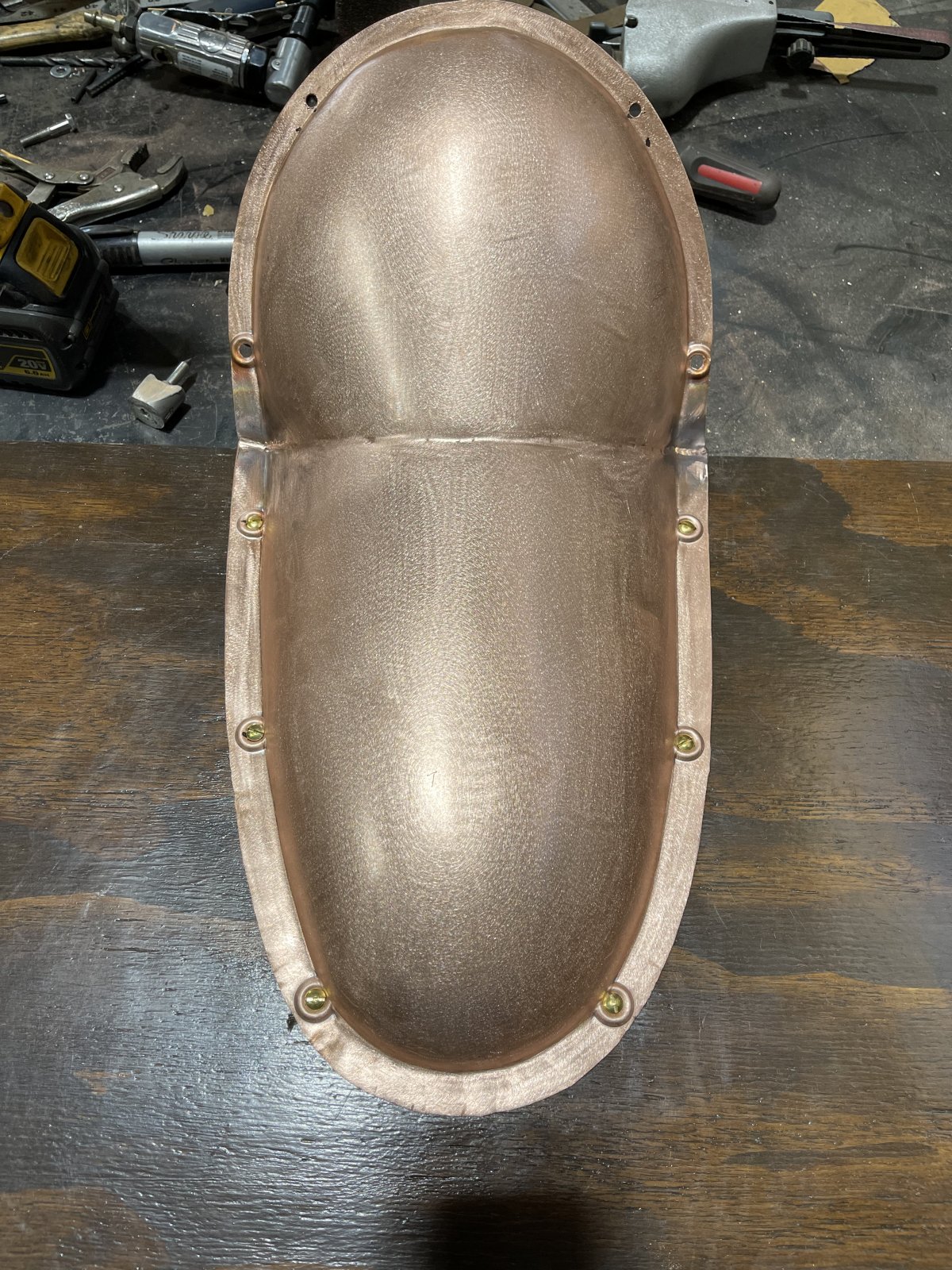

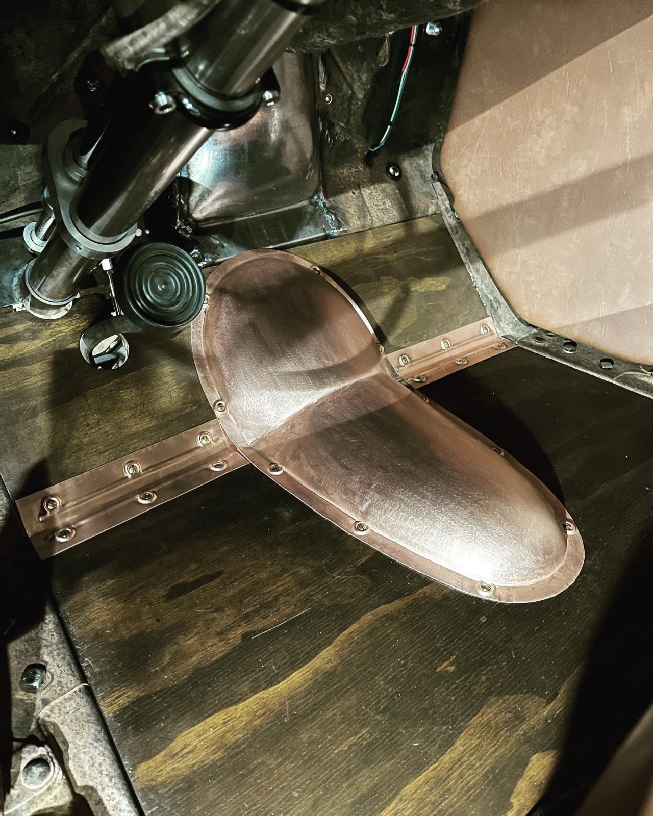

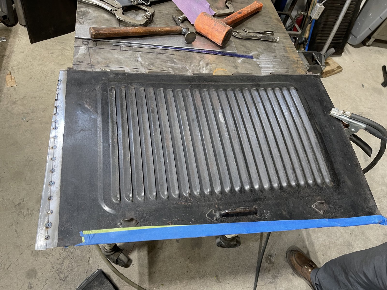

    Forgot to post some photos of the transmission tunnel cover. Copper seem to be a much better fit than steel. Wouldn’t you agree?

    Yes I agree...and the plaid is a nice touch too and the wood and...and...;)
    Did you solder the copper seam @Joe Rosales?
    v8flat44, brady1929, brEad and 3 others like this.
  7. Joe Rosales
    Joined: Jun 25, 2015
    Posts: 181
    Joe Rosales
    TIG

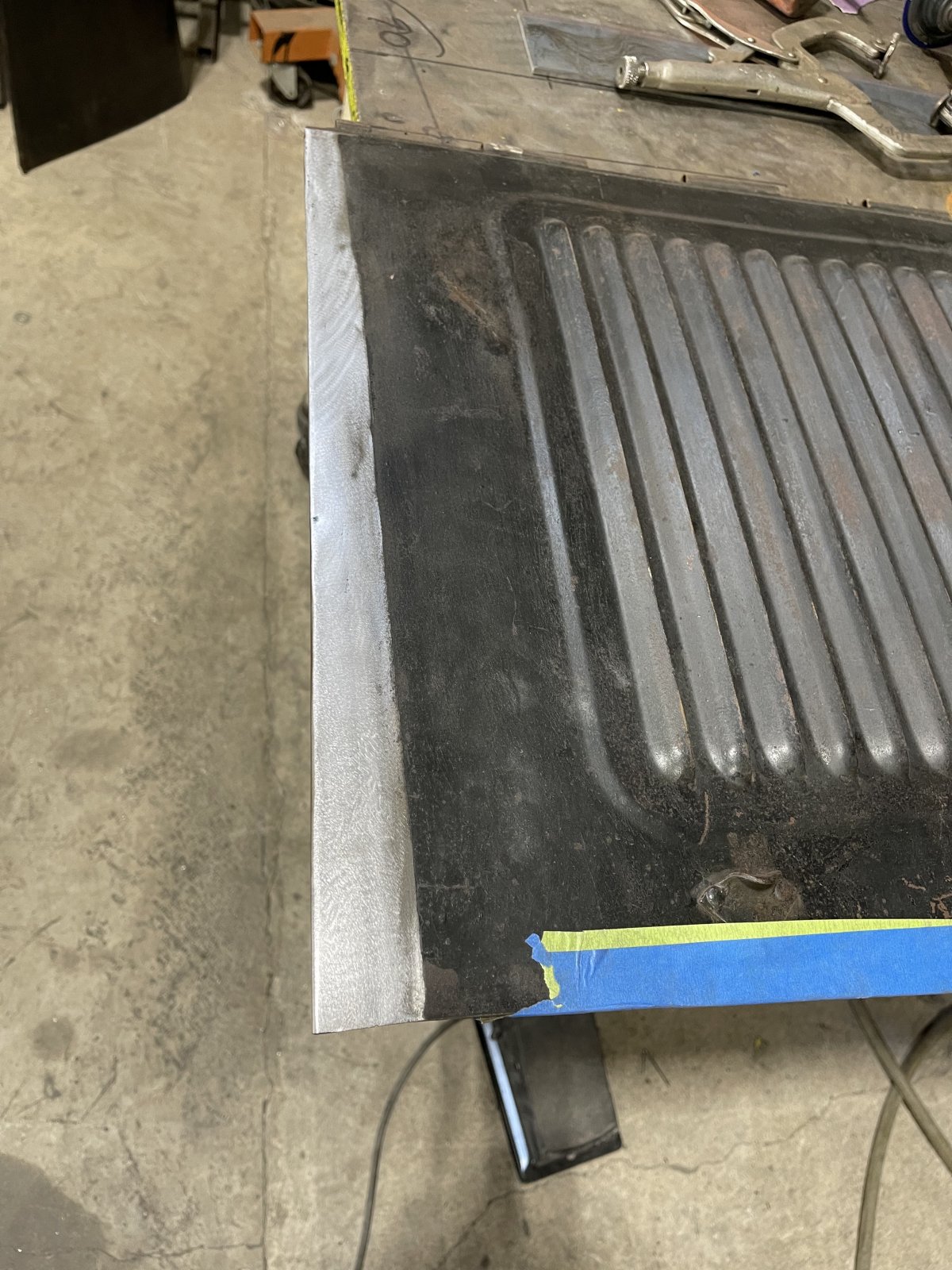

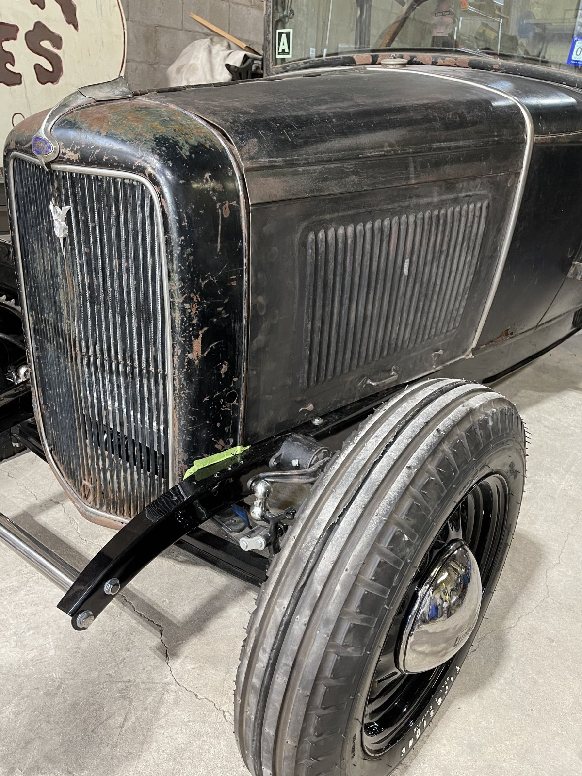

    Fitting a Model A hood to a 33 truck grille.

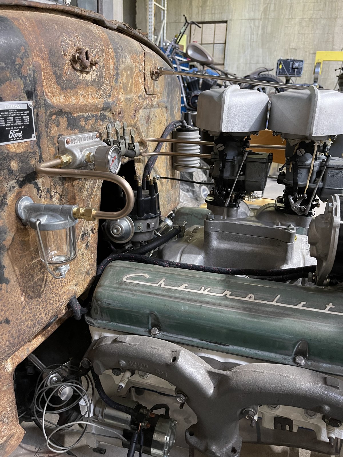

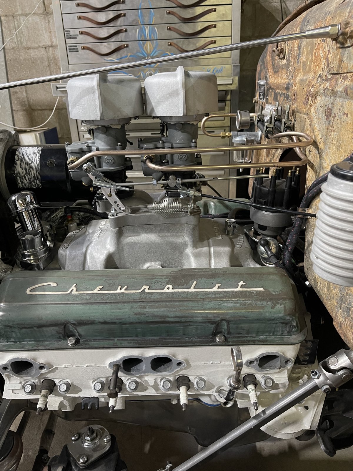

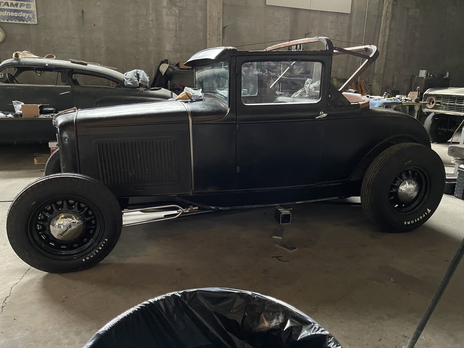

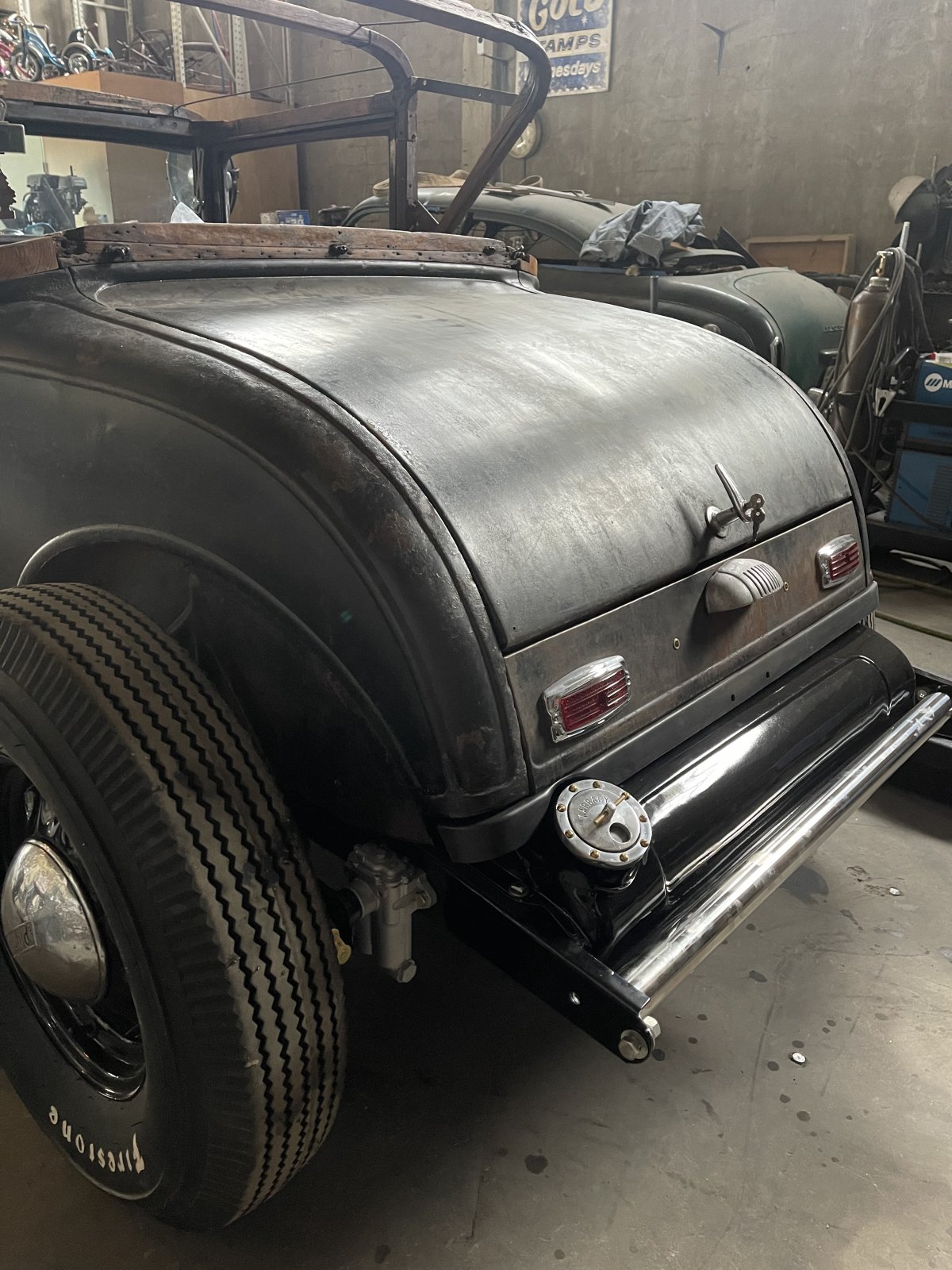

    Almost time to take her out for a spin, all that’s left is the exhaust.

    Steve Ray
    I've seen those rigid mounted fuel lines before, and I still think it's a bad idea. Vibration and movement of the engine will make them fatigue crack eventually.
  21. Tim
    Joined: Mar 2, 2001
    Posts: 13,831
    Tim
    from KCMO
    @Steve Ray take another look, they aren’t ridged. There’s rubber between the hard lines on the carb and the fuel block.

  24. Steve Ray
    Joined: Mar 2, 2001
    Posts: 686
    Steve Ray
    OK I see the rubber lines on the block. Good job on that and making a sport coupe look cool .
